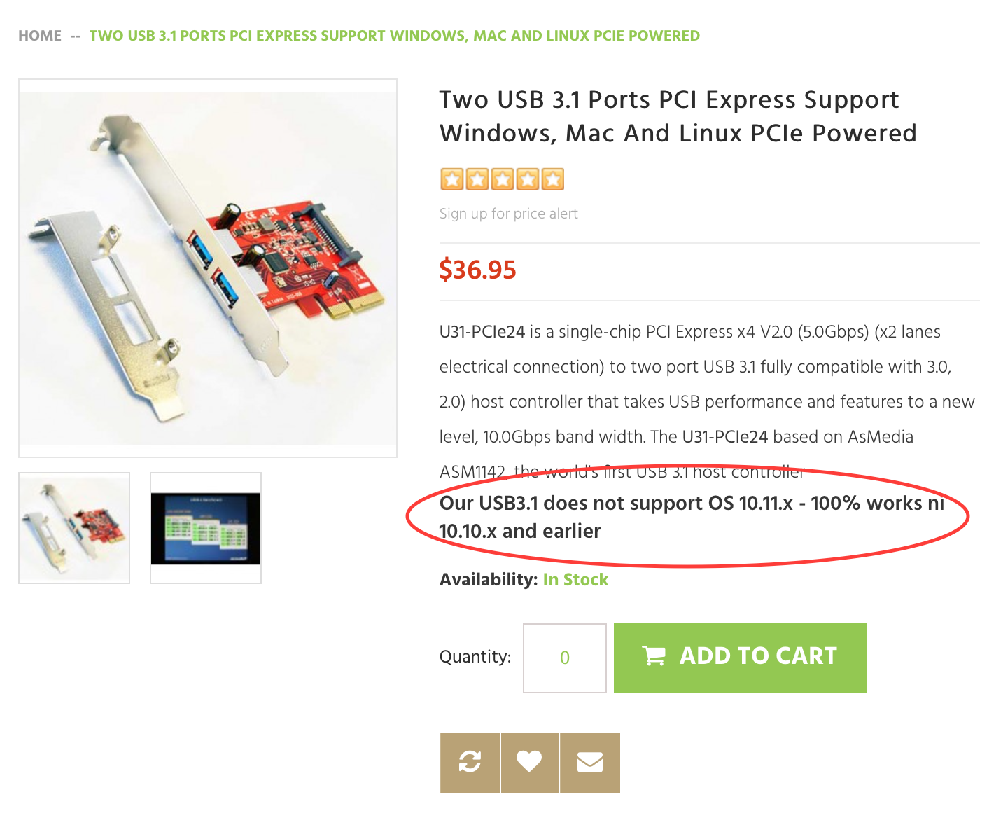

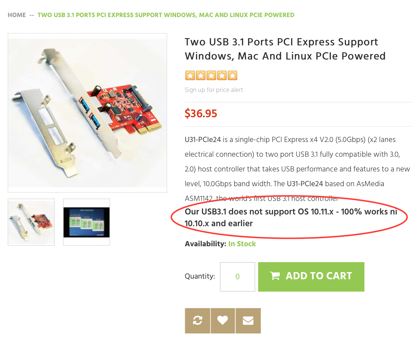

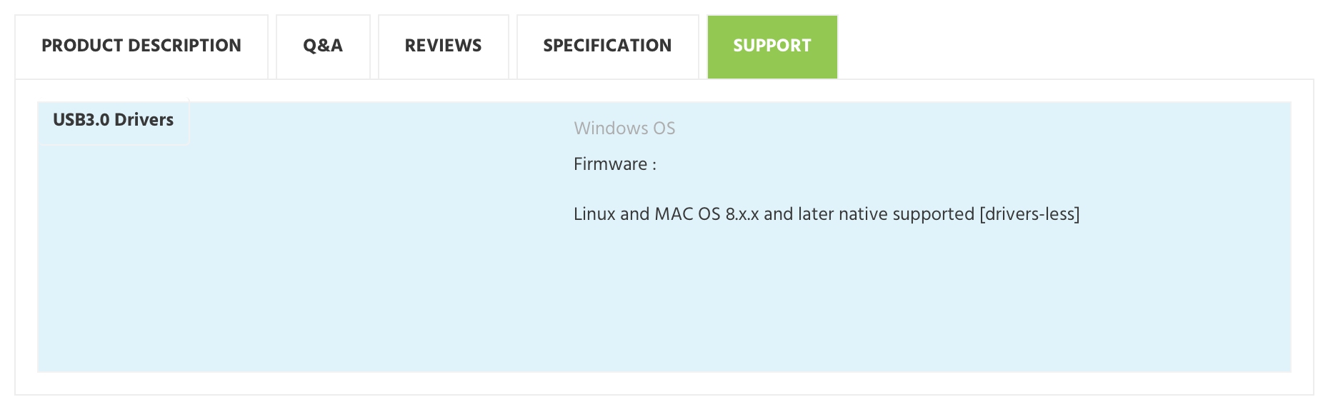

It says, "Our USB3.1 does not support 10.11.x - 100% work ni 10.10.x and earlier"... If I'm deciphering it correctly, USB 3.1 only works with 10.10.x and earlier...

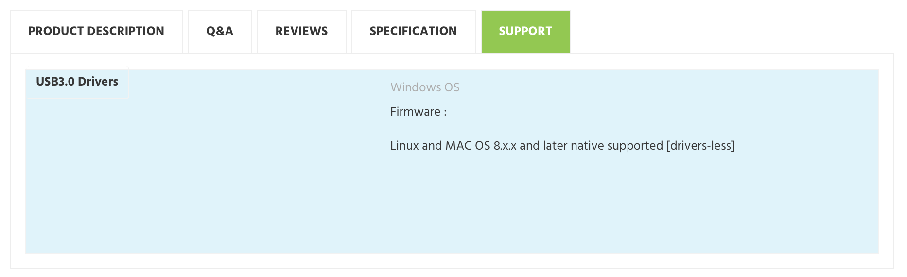

But when I click on support, they only mention USB3.0...
Yes, 10.11.x is a horrible OS to upgrade to. It's a major screwed up on USB.
I confirmed, these USB3.1 cards work with 10.10.x and 10.12.x, but not 10.11.x

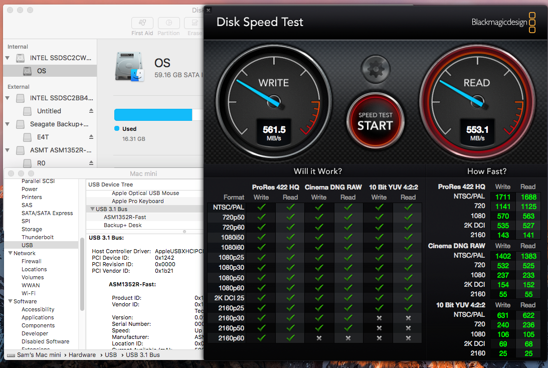

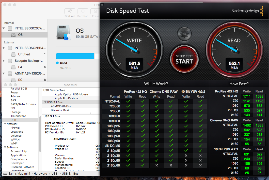

- How weird is that, but I'm glad my 3.1 is now fully function under 10.12.x
Nice. What USB 3.1 drive are you using? Thanks.
I figure the regular 7200 rpm or a single SSD wont saturate the USB 3.0. So I get this
http://www.datoptic.com/ec/usb-3-1-to-dual-msata-ssd-supports-raid-0-1-or-jbod.html and 2x mSATA 250GB create a RAID0 out of it
Yes it moves the data fast. Same card I plug in a Seagate USB pen while run the test i able to read and write to USB pen, as you can see in DU there is USB3.0 Seagate Backup + is connected too... So this card works perfect
I will transfer data from my Backup+ to my mSATA RAID0 and let see how the USB 3.1 hold up

With my set up, there is no issue with transfer from my Seagate Backup+ to my RAID0 USB 3.1
I was able to transfer roughly about 93GB, so there is no problem of mix devices USB3.0 and USB 3.1
