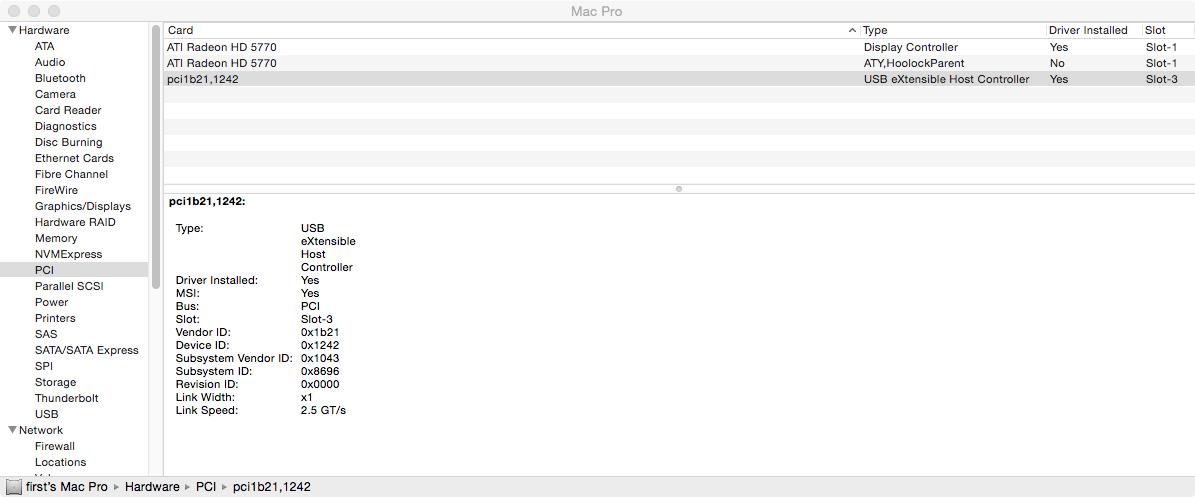

I just bought an Asus USB 3.1 (dual A-type connectors), and from what I gather from this thread, it does not work in El Capitan?!!
I have tried to plug in a couple of different USB sticks, but none show up in finder...

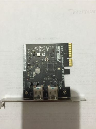

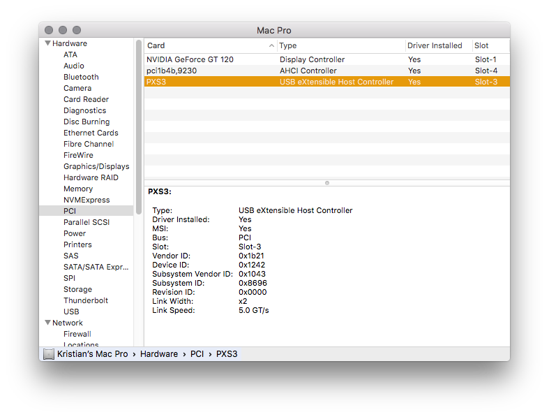

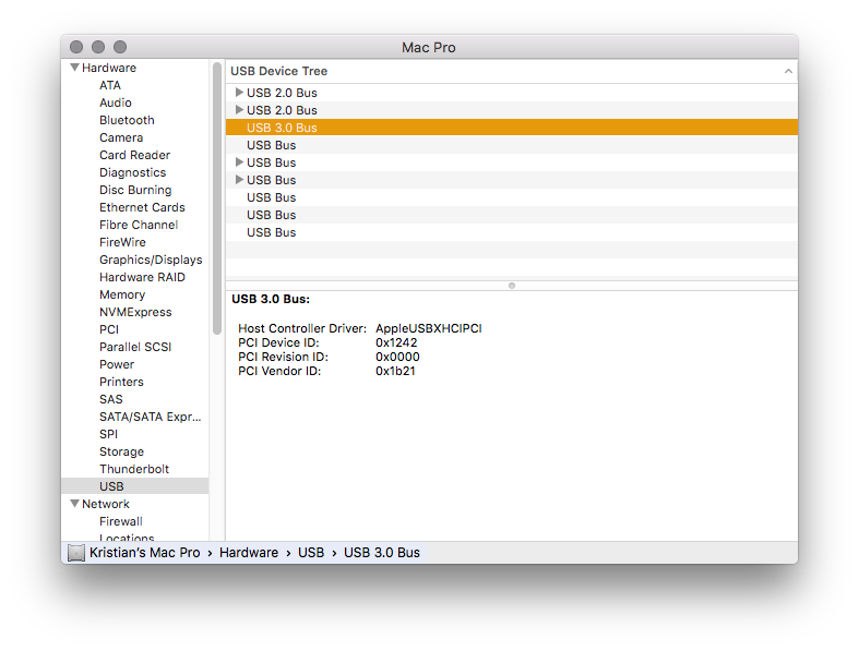

With the Asus USB 3.1 Gen 2 PCIe card installed in a Mac Pro 1,1 > 2,1 (2006), slot 3, running OS X 10.10.5 Yosemite , I achieved sequential reads and writes of around 170-200 MB/s . Drivers are found in the OS and the card does not , of course, operate at anything near its potential . But it is compatible . Card costs around 25 bucks used .
ASM1142 controller chip on the card and would probably get higher performance with ASM1351 connected devices .

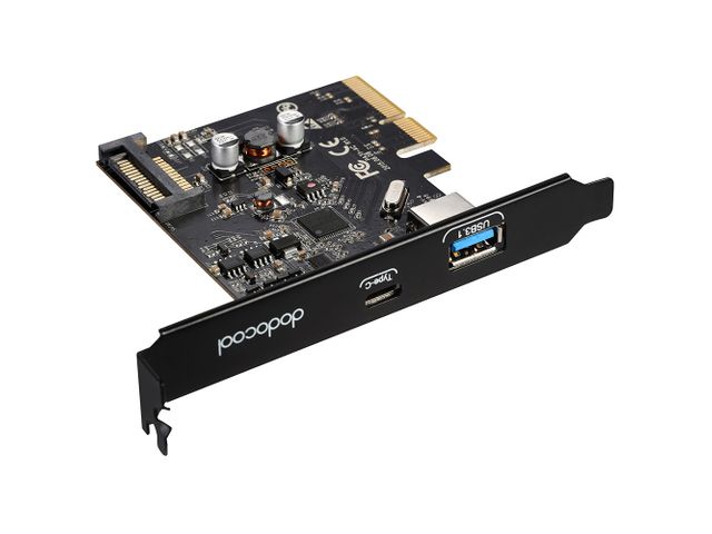

I'm wondering if this card will work.
It's sporting 10.6 and up mac drivers, and is a dual A+C style card.
dodocool USB 3.1 Gen II (10 Gbps) Type-C and Type-A 2-Port PCI Express PCI-E Card for Desktop PC
http://www.newegg.com/Product/Produ...e=Asus_USB_3.1_pci-_-9SIA1GK3X89706-_-Product
Providing both SuperSpeed+ USB 3.1 Type-C and Type-A ports, this dodocool USB 3.1 2-Port PCIe Express Card is a simple and economical solution for adding the latest high speed 10 Gbps USB 3.1 ports to any desktop computers or servers. USB 3.1 enables you to transfer videos, music, photos, data files between USB devices and the computer at enhanced transfer speeds of up to 10 Gbps.
I could not find a manufacturer website. Initially one would interpret the fact it includes Mac drivers for 10.6 and above as a yes, however I did find a user feedback on Amazon saying that it does not work in El Capitan.
This is inline with previous comments about other USB 3.1 cards which do not include Mac drivers and relied on built-in Apple drivers, however it could be down to the included driver not having been updated to be SIP compatible. If it is a SIP issue then the usual trick of disabling SIP might be sufficient to allow the driver to load even in El Capitan.
Most people are now I believe waiting for Apple to ship additional Macs with built-in USB 3.1 support and perhaps the next version of OS X (whatever it will be called) to see if Apple improve support for USB 3.1.
