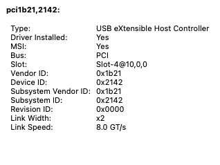

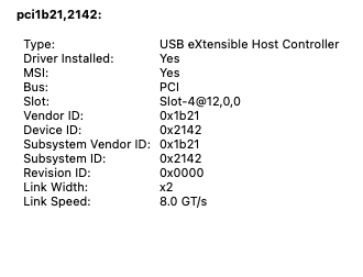

Hello i must have gooten this card HighPoint RocketU 1344A or 1344u 10Gbps 4 port card; is there a big difference to the ASM3142? or is it just function aswell? have not tested toroughly yet.

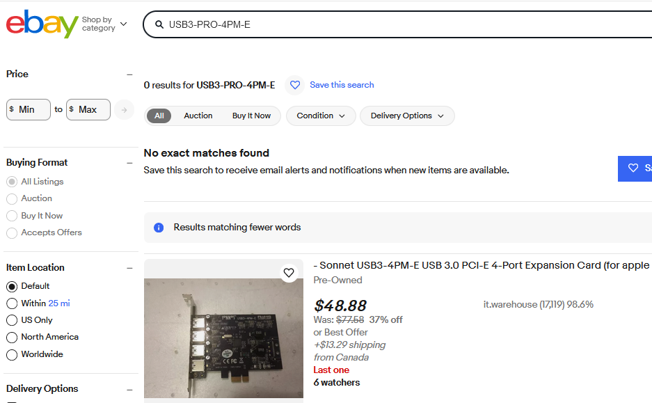

Yes thank you I would definitely grab the USB3-PRO-4PM-E if I could find one, do you have a link to one on eBay? I cannot find one on there for the life of me. This listing had them for sale but currently unavailable.

Just put Sonnet USB3-PRO-4PM-E in search on ebay, I see 2 right now going for $29, They are always on ebay for that price, Have been for at least a year all the time
Unfortunately eBay is still telling me there are no results and only offering me the USB3-4PM-E which is not the same card, would you mind just sending a direct link for a listing that you found?
I see 3 for $29 and about 8 more for more money Even 3.1

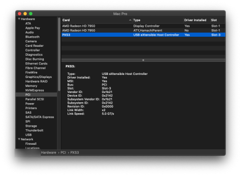

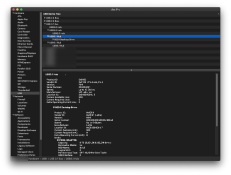

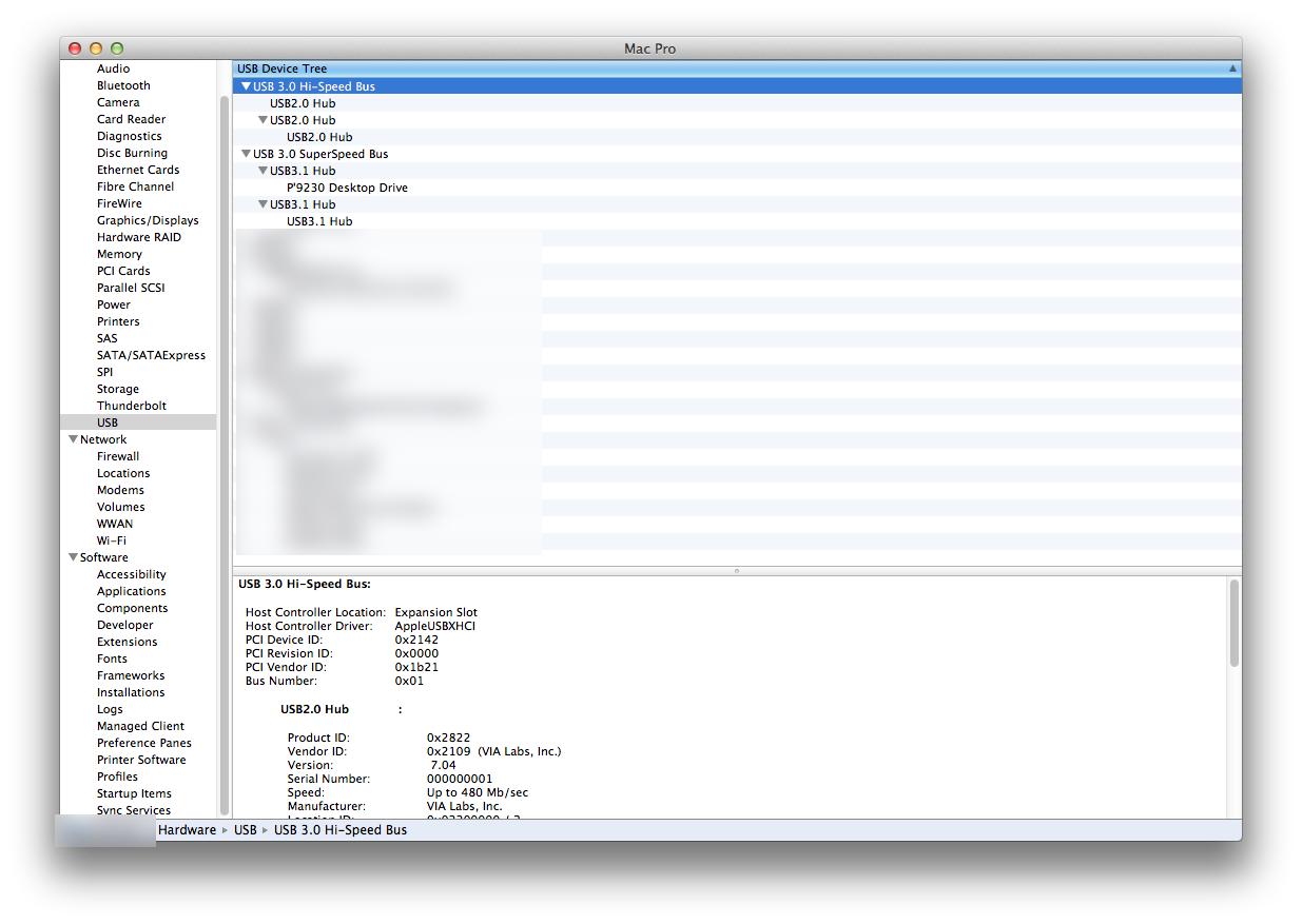

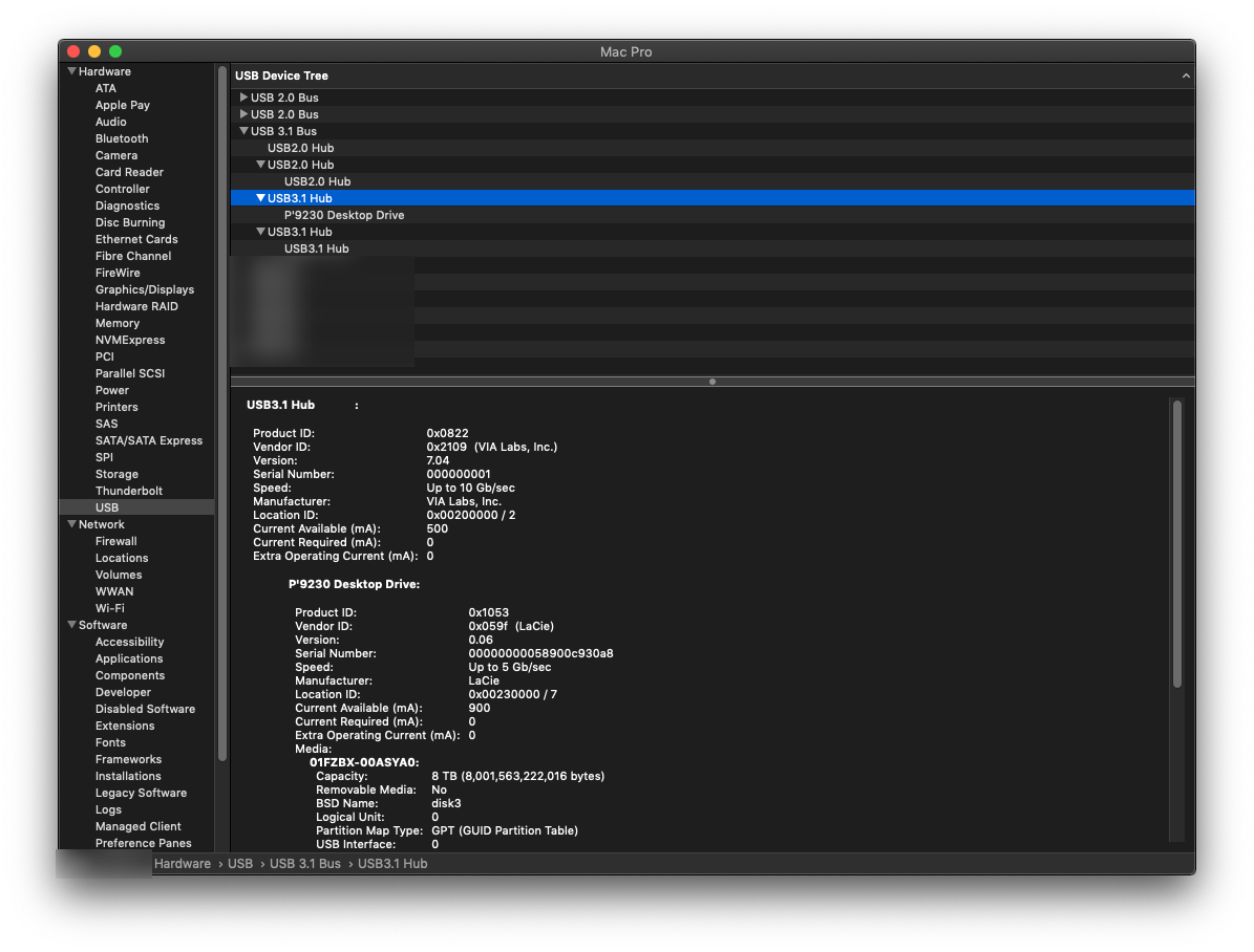

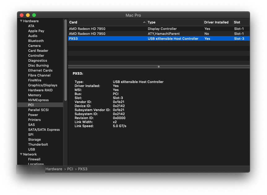

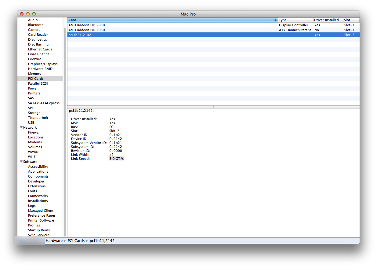

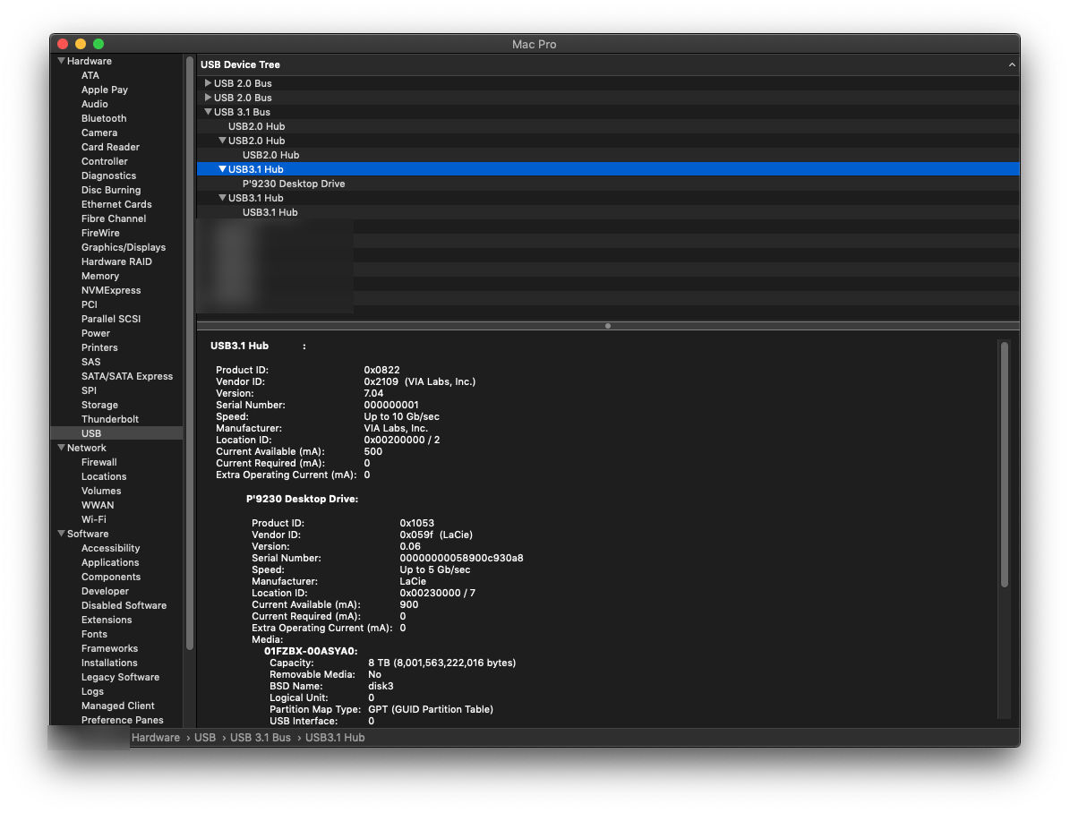

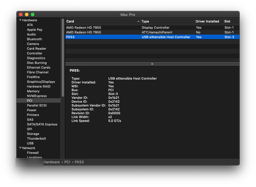

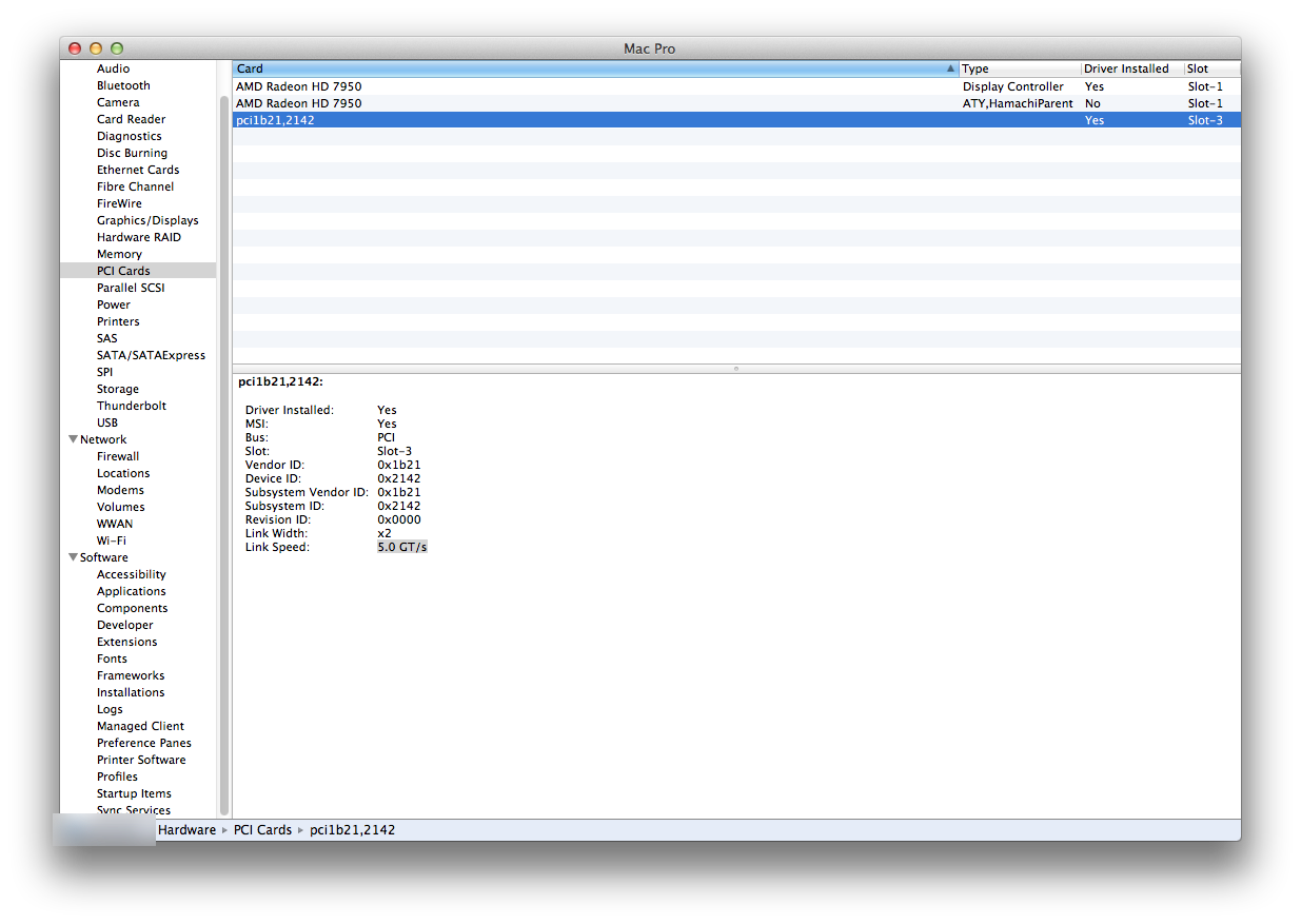

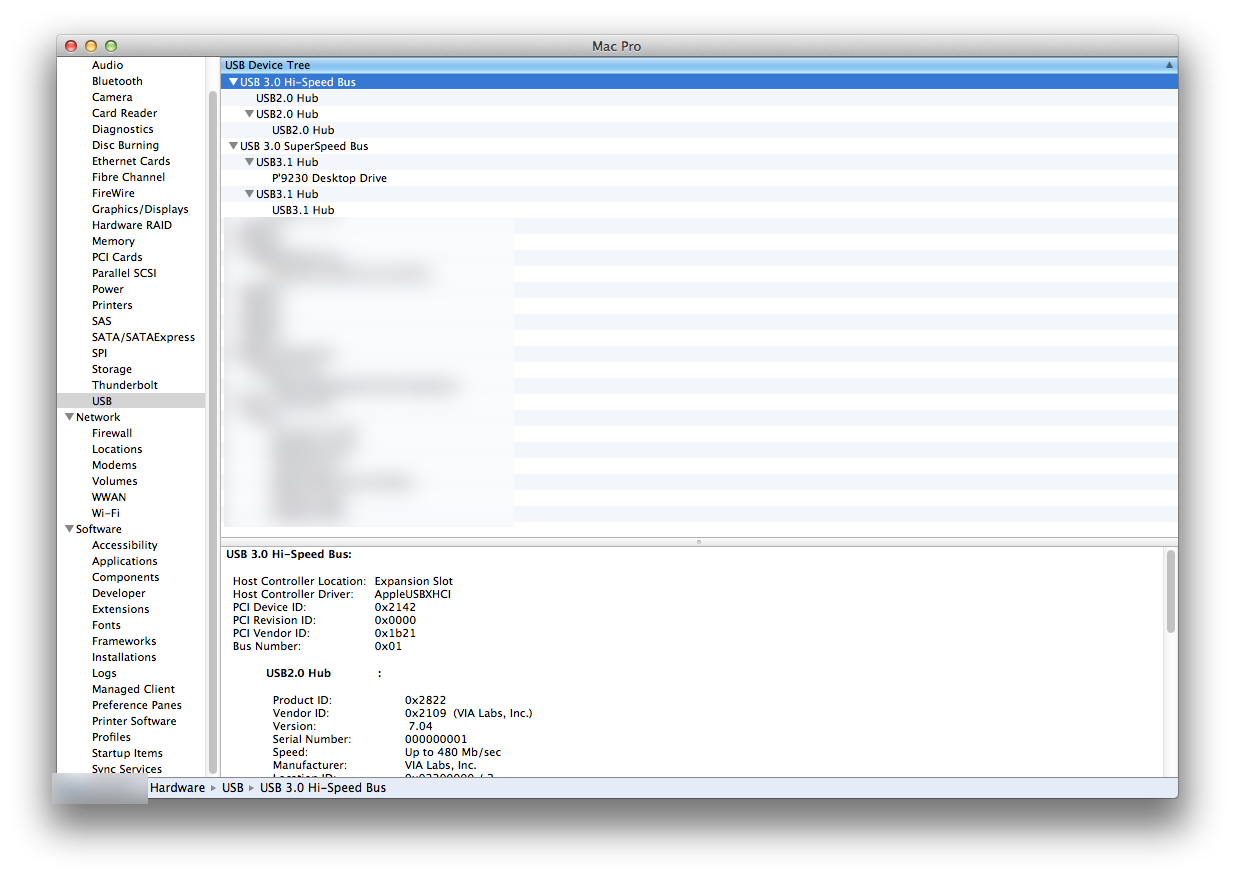

UPDATE: Leaving this here for reference in case this information is useful for anyone else.
I went ahead and took the risk and purchased the Inateck KU8212 card after speaking with support and them claiming that it did work with OSX 10.8.2+. After installation of the card, booted into 10.8.5 Mountain Lion and checked out the System Information. The card shows up as "pci1b21,2142" with no Type but the USB 3.0 hubs are now present as shown in the first and second images attached. An external HDD conected via USB 3.0 (5Gb/s max) was tested with Blackmagic Disk Speed Test and it was reading/writing around 200 MB/s which was the same speed as an internal HDD connected via SATA III on the same Mac Pro 5,1. When connected via a USB 2.0 port, the same external drive was only getting about 40-50 MB/s so that is a huge improvement in speed and it seems to be working well.
In 10.14.6 Mojave, the card is shown as "PXS3" with type "USB eXtensible Host Controller" (3rd and 4th photos).
-So far, everything is working as it should, with no noticeable interference with bluetooth function (Logitech MX Master 3s Mouse w/ Dongle currently in use).
-Some assembly required on the Inateck KU8212, the faceplate has to be mounted to the board with provided screws).
Still going to keep searching for a used Sonnet Allegro Pro USB 3.0 PCIe (USB3-PRO-4PM-E) and if I can find one will compare the two cards with 10.8.5/10.14.6 on the Mac Pro 5,1.
