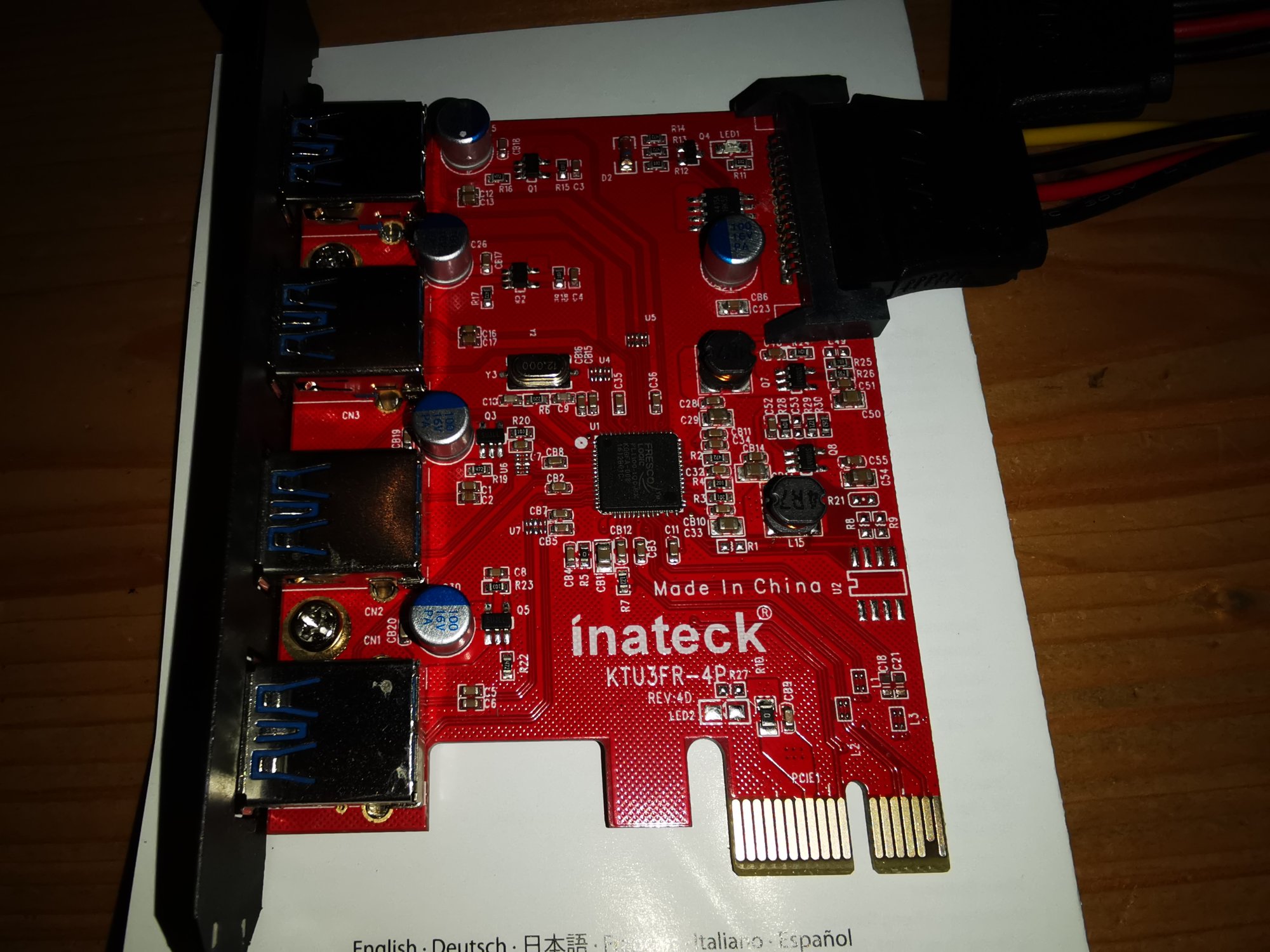

I think 200 MB/s will be enough for my usecase, and if not then i have to use the 2.0 slot if needed.
But, unfortunately it seems that the inateck kt4004 card is sold out everywhere, even on the inateck.com website itself and i think it is discontinued.
As it appears the redcomets u25/21 is not that great for a mac, so that leaves the inateck KTU3FR-4P (kt4001) as the only reachable option.
But now this, on the original inateck.com website as well as on amazon, it is advertised that the inateck KTU3FR-4P can only work on a pcie 2.0 slot (or higher).
As far as i can tell this card uses the same fresco fl1100 chip as found on the widely used kt4004 so what's the deal?
Well i have tested the KTU3FR-4P yesterday in my mac pro 3.1, el capitan.
Tried it in slot 3, and, slot 4. Power connected with a molex to sata 15 pin cable from the dvd slot to the usb card and unfortunately it doesn't work.
I have a second spare mac pro 3.1, running high sierra, will try the card in that system also and if not working i will return the card.
I just don't get it, i see multiple reports of the card working fine when power is conencted. Maybe it is because the card i have is a revision version 4?

Update,
Have tested the card in my spare mac 3.1
Tried pcie 2.0 slot 2 and pci 1.0 slot 3 and slot 4. It doesn't matter, the card does not work in my mac, nor does it reconize any usb device.
Also i can't find any info about the card in the hardware tab at pci or usb in "system report info" in "about this mac"
I tried with it power from the superdrive bay molex connector and from the 4th harddrive bay sata power with the 15 pin connector. A green light on the card itselfs comes up, thats all.
Maybe i have a faulty card?

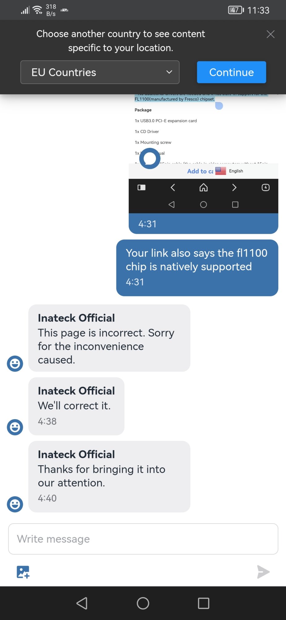

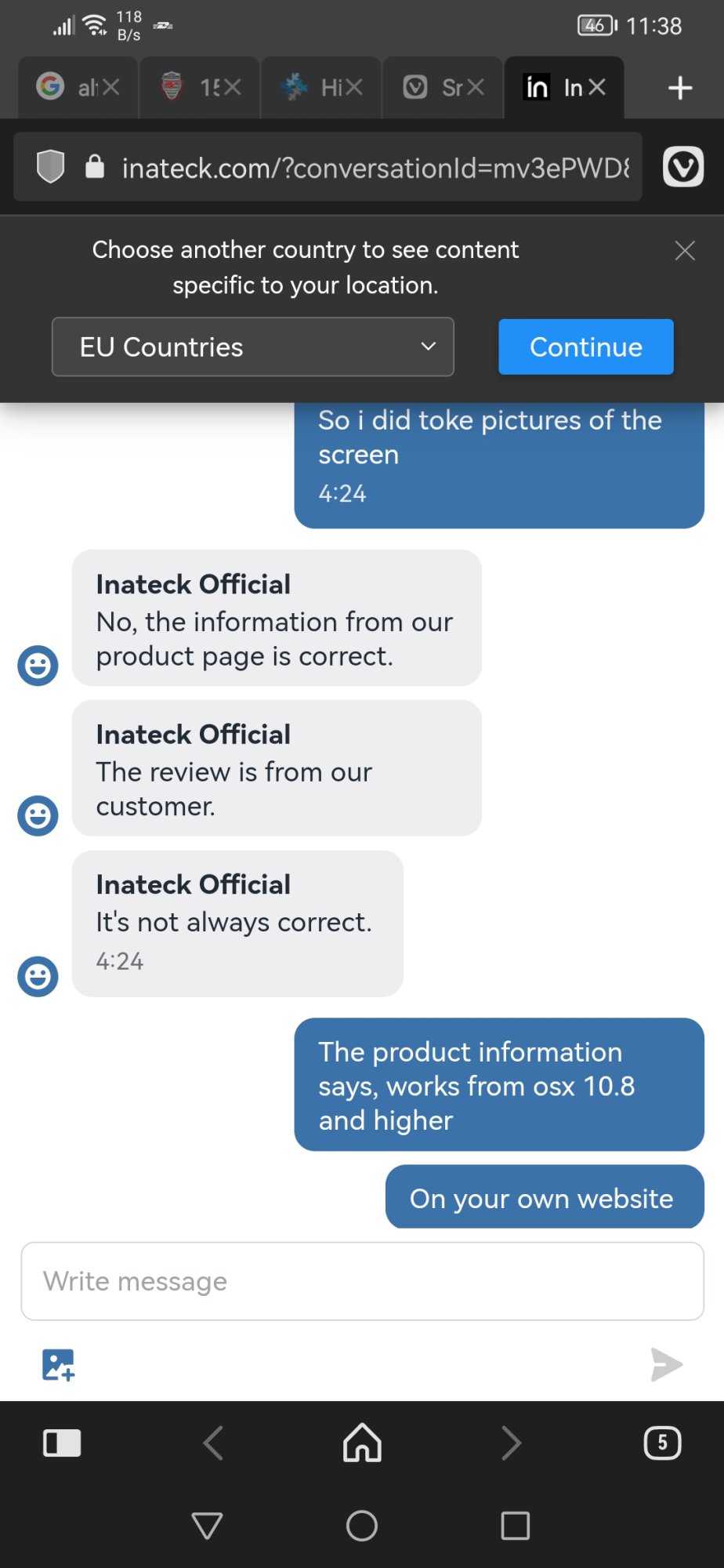

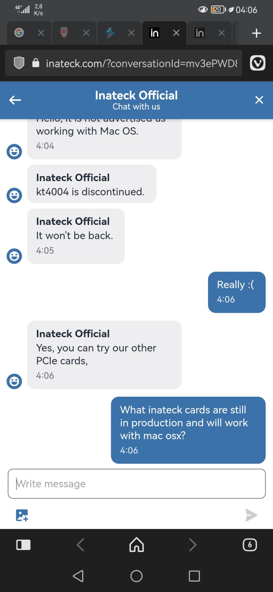

Seems so, it is a Fresco FL1100 chip, can you make a high resolution photo?
I did,
Anyway, the "official" chat guy said that the kt4001 or the ktu3fr-4p as i know it, isn't supported for mac.
I said him that it has the fl1100 chipset wich is native supported since 10.8, well according to him that's not true, so i sended him screenshots of his own website and other reviews where the kt4001 is advertised as a mac pro card.
He thanked me for pointing him to wrong discriptions on the inateck website, and that was all. A standard reply i think.
Anyway, ive seen reviews and youtube video's of the kt4001 card working in mac pro's, and since it is a Fresco FL1100 chipset i'm not done with this.
I think i have a dead card, i have a old self build 2004 pentium 4 with lying somewhere, so i can check if the card is really a win only card, or it is dead. If it doesn't come alive in the device manager on windows then i know for sure.
Anyway, I'm a little irritated at this, why wouldn't a pcie card with a fl1100 chipset not work in a mac pro? It just doesn't make sence.
Is there something else that sets the kt4001 apart from the kt4004? Both pcie cards have the same fresco fl1100 chip.
Anyway, here i miss interpretated the website
Oke and then after this when I'm point him out to the specs on the inateck website:
So, i have two options, i return the kt4001 and order a new kt4001 one, since I've seen video reviews with the card working.
Option two, i return the kt4001 and forget about inateck.
