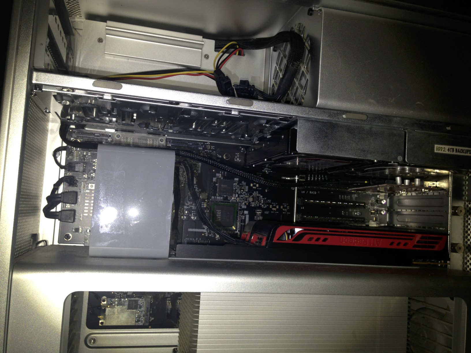

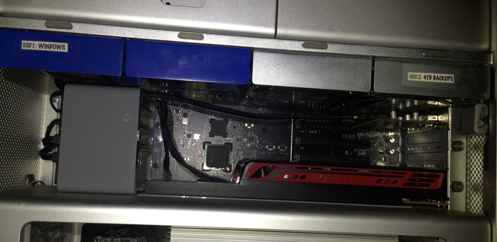

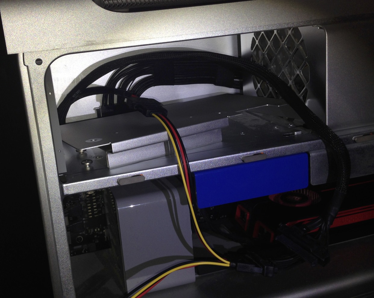

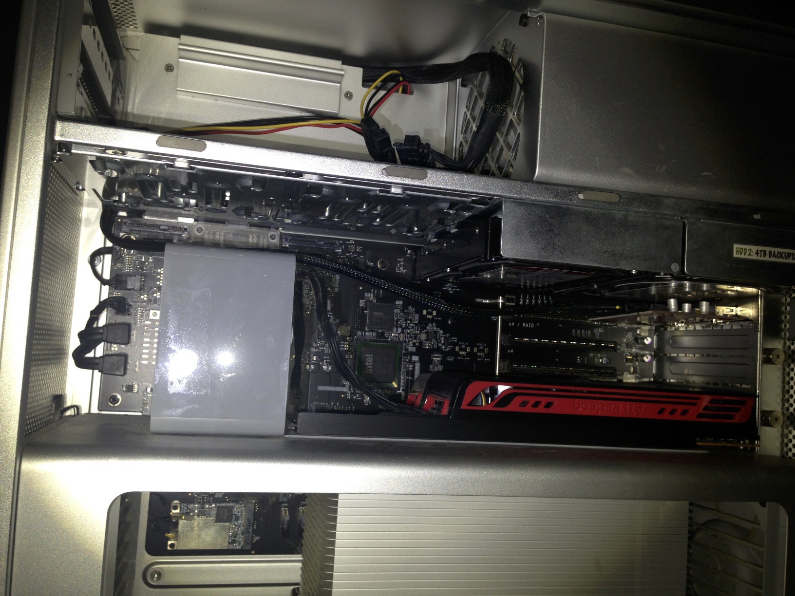

Finished my mini-review of the Inateck 4port USB3 card for the MP.
Very good card - performance is spot on (same drive r/w as the imac's USB3 ports). The card is simple enough to fit if you haven't filled all your drive sleds.

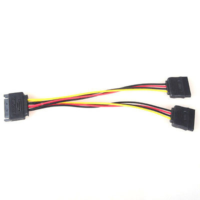

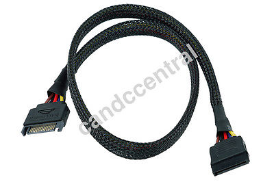

It comes with a wiring loom to take power from a SATA power connector.
There is a pass through on this loom, but I found it a bit untidy for my liking so I have fitted my own loom from the optical bay. I used the two cables as pictured below to make the loom and found the SATA connector does squeeze through the loom where the opti bay cables run into the main section of the MP.
Now it all looks nice and tidy indeed.
The card is working flawlessly (well as my use tells - which is mainly external hard disks (one bus powered)).
