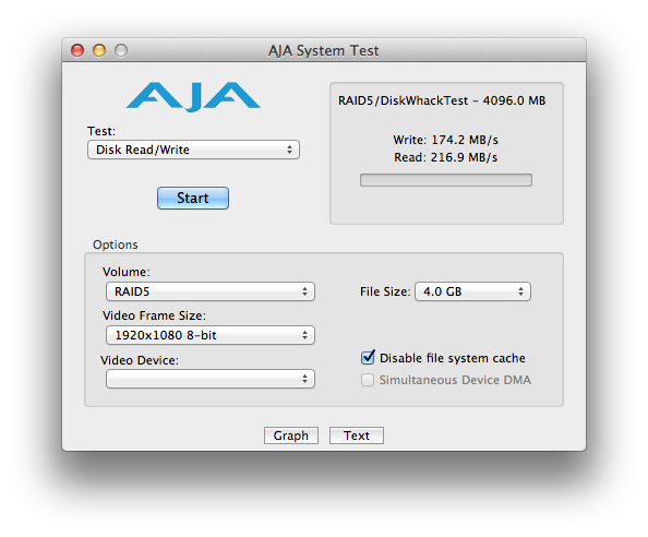

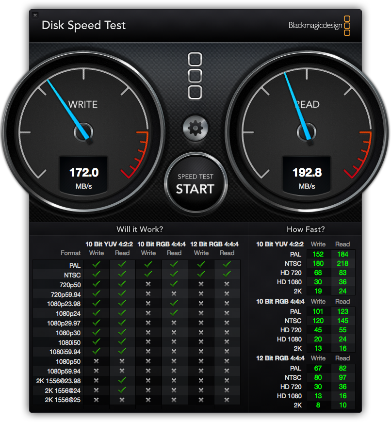

I just ran a test using the Caldigit FASTA-6GU3 card interfaced with USB 3-0 to a OWC Mercury Elite Pro Qx2 RAID-5 box with 4 Seagate 3TB disks.
http://eshop.macsales.com/shop/hard-drives/RAID/Desktop/
I thought the transfer speeds were pretty good for RAID-5 hard disks, especially considering the revealed capping of speed due to the Caldigit controller chip, but would there be any improvement if using the HighPoint RocketU 1144CM?
Here are the results (4GB test size):
-howard

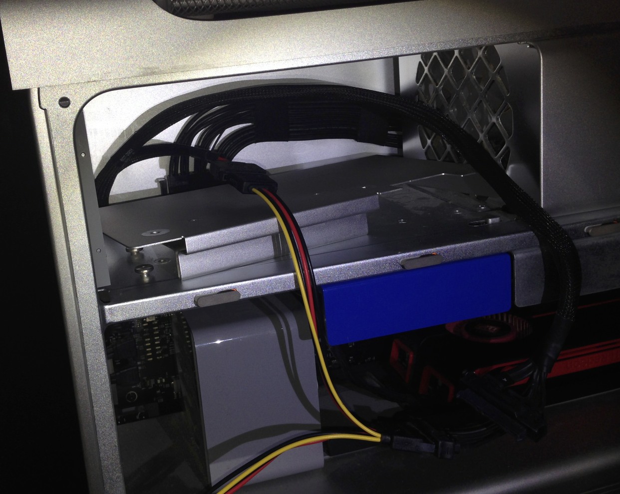

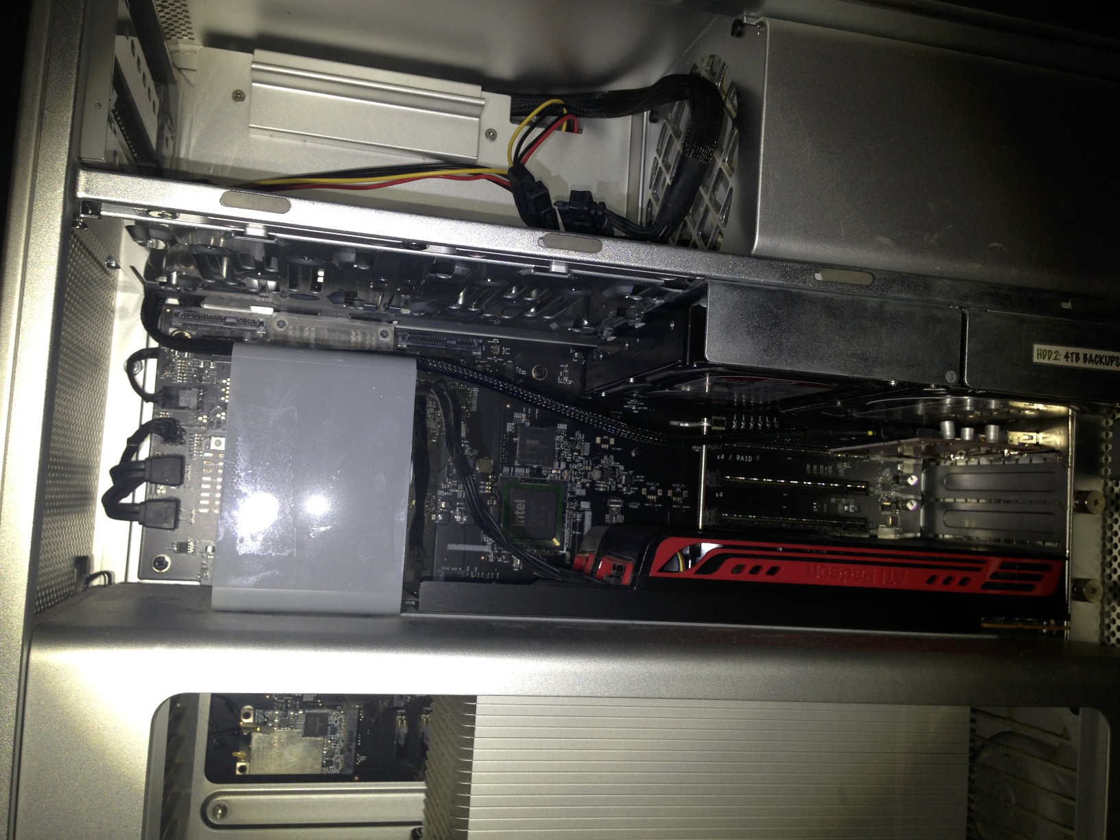

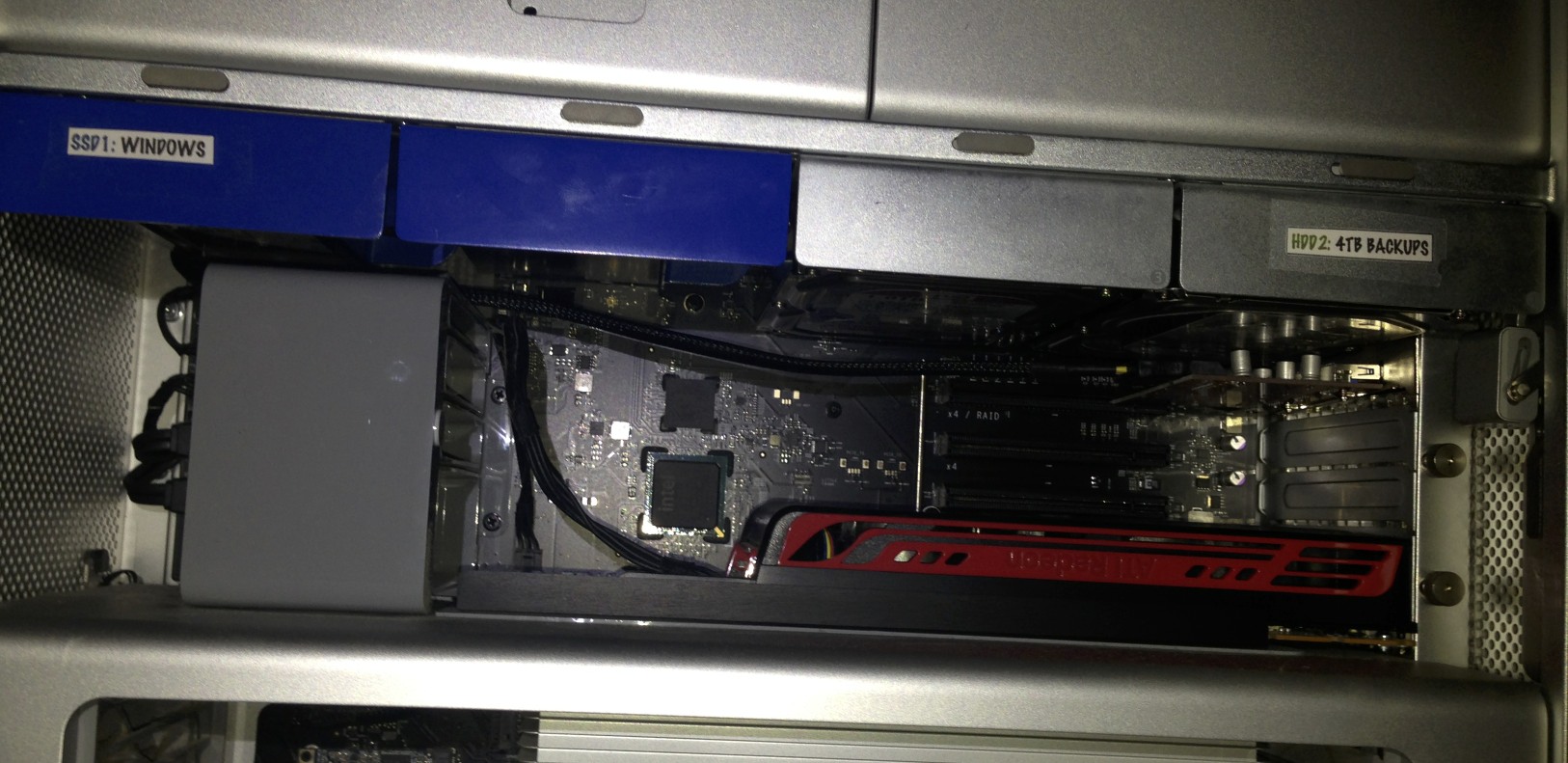

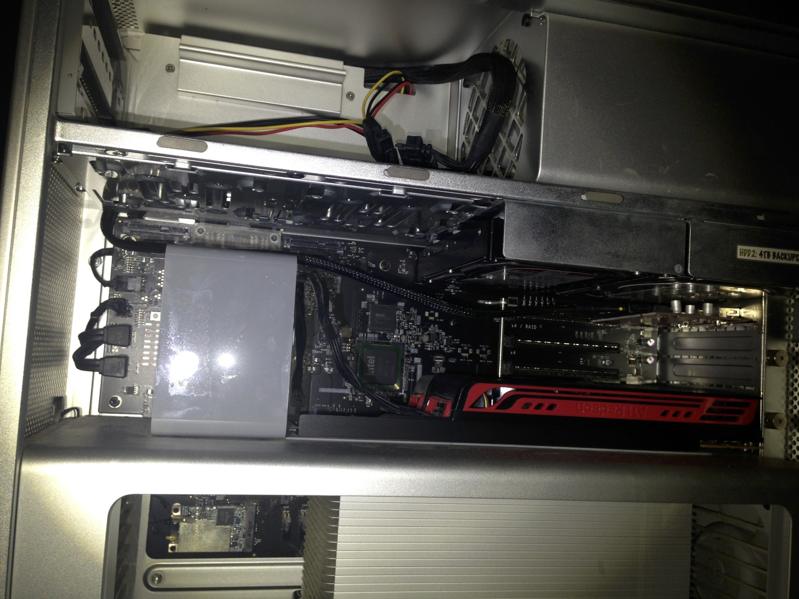

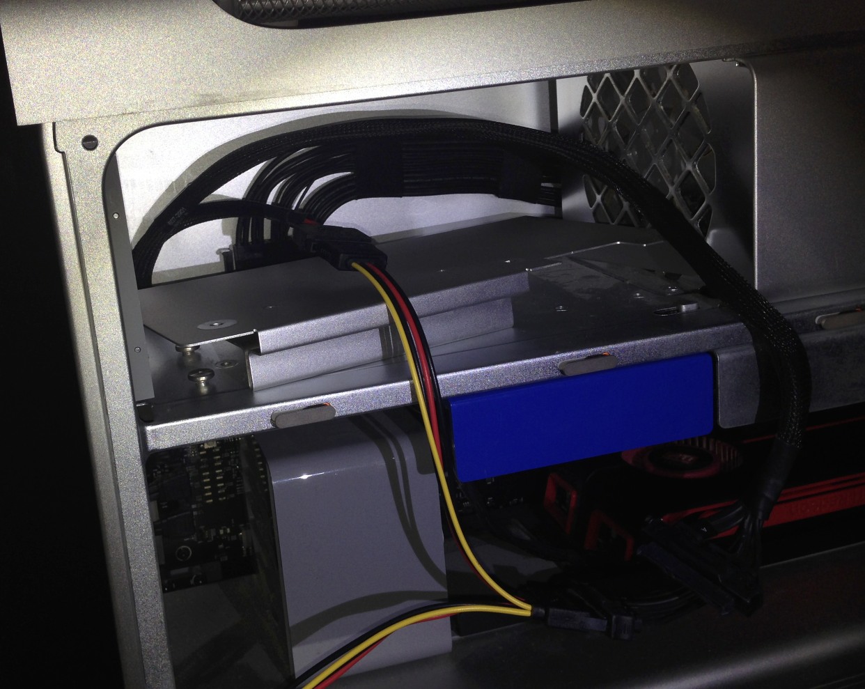

yep I have a power splitter (I have the Windows SSD in the lower optical bay and split to the USB3 Card).
The card I have came with a loom for this very purpose, I made my own purely for asthetics.
Edit - Added some pics for you :)
So you are all saying that you can have all 6 SATA connections taken up by devices *and* run a power cord to the USB3 card in the PCIe slot?
Is this some form of splice then? Because like I have said a million times, all my SATA connections are occupied by 5 internal drives and my internal DVD burner.
I think you have the Orico PFU3-4P, which has 4 ports and requires supplemental power via a molex connector. The first post of the thread has a link for hooking up supplemental power from the optical bay. The solution includes a Y-cable in case you are using both SATA connections.
For the most part it is fairly easy, but the one tricky bit is removing the molex connector from one end in order to snake the cables through the existing cabling hole.
