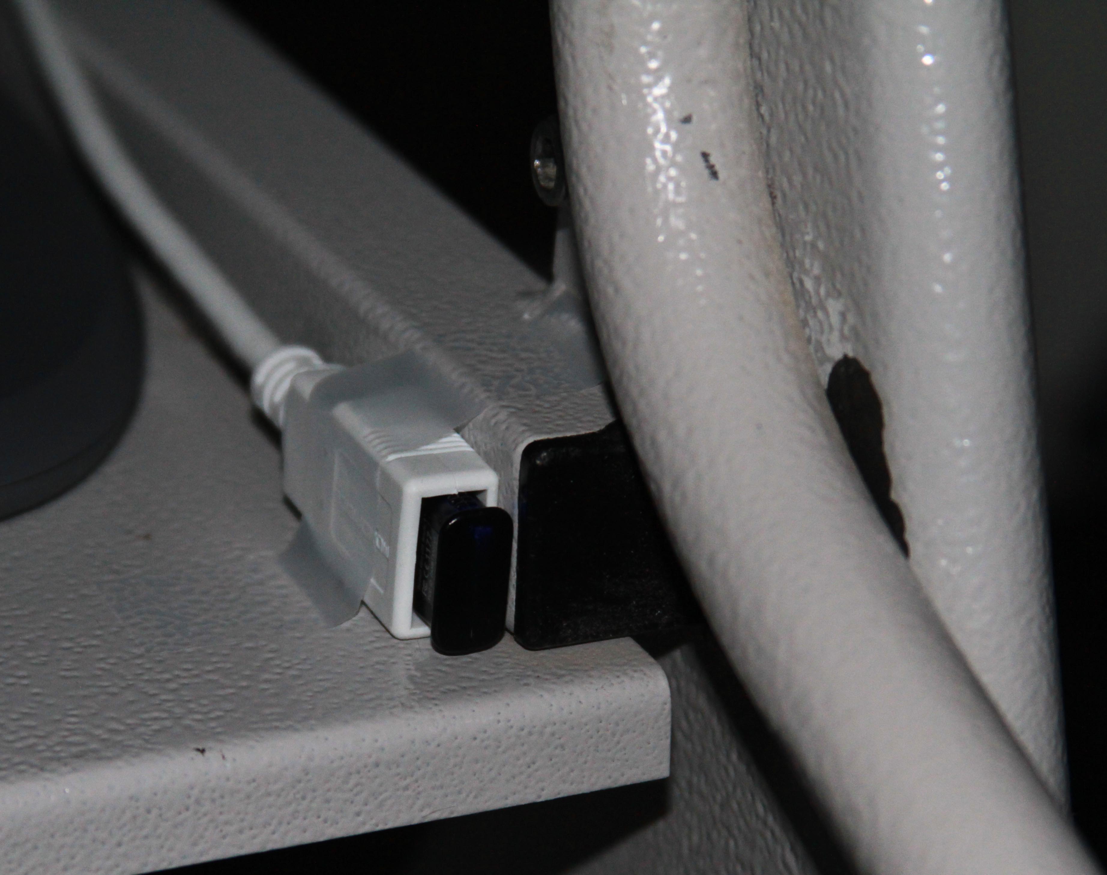

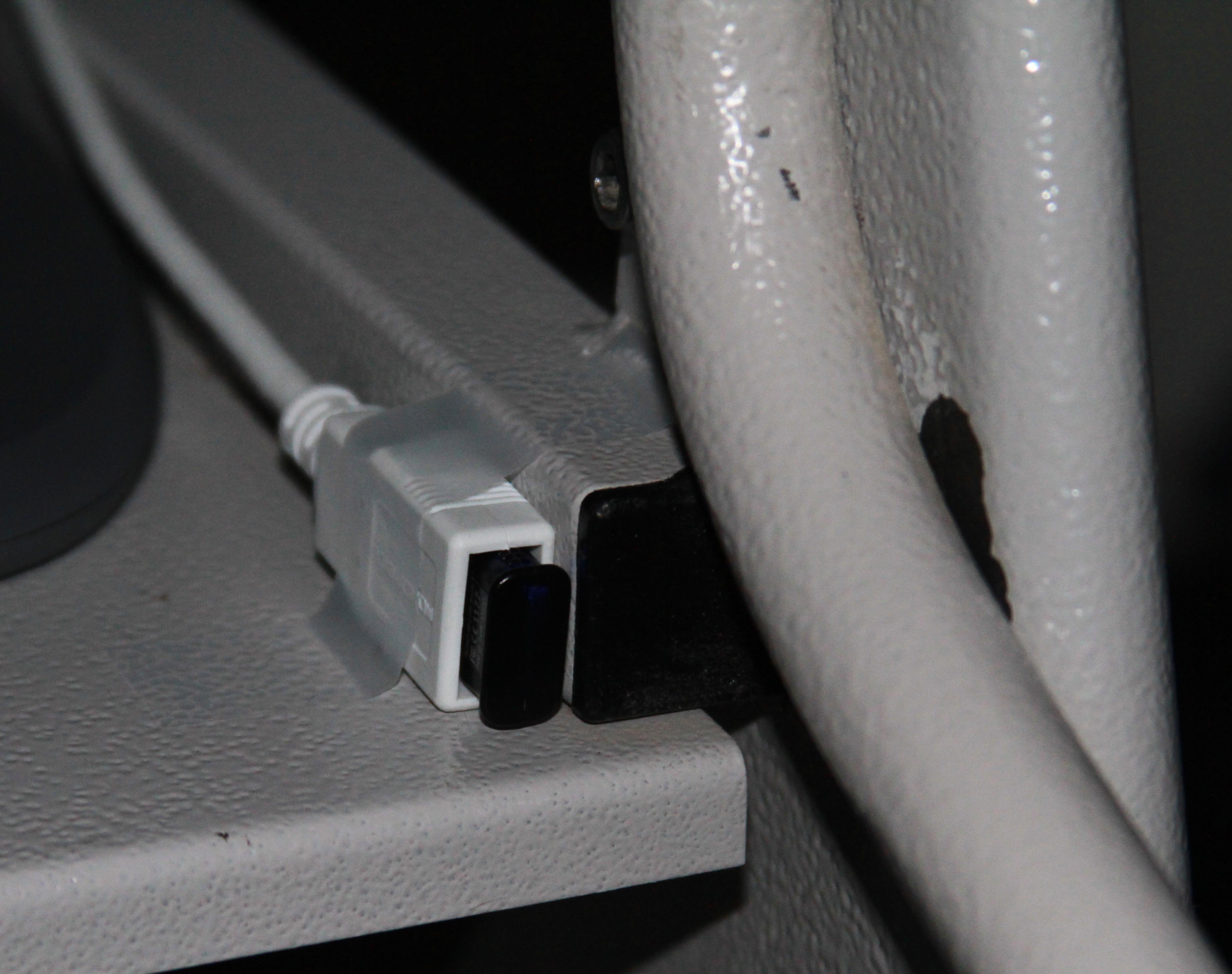

Glad you got that to work. I was thinking (an unreliable task for me, but hey, why not). I have a long USB extension cable that came with a dongle like the one you have. I wonder what would happen if you used something like this, and moved the dongle away from your rig.
Hey Jackson, Guess what? My USB 6' Extension cable came today. I plugged it in to the back of the Mac and moved the dongle to the female end of the cable. It's now only about one foot from the mouse. And it's been working GREAT:p Thanks so much for the idea.
Lou
Lou
That's GREAT news Lou! Maybe you finally got that cat skinned, and USB 3.0 will give your mouse some peace now. :D
Lou
Thanks Lou for sharing and for your efforts and patience. :) Good to know we have solutions to the BT problems.
^^^^You're welcome. The final solution is now working great. I can move cables around and no more BT issues. My mouse pointer is rock solid - AT LAST But, thank Jackson for the idea - A Genius!!!!!
