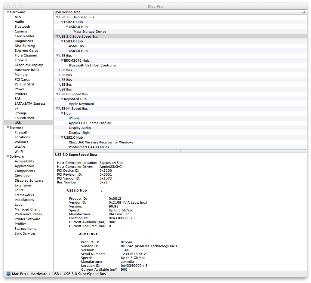

Forgive me if it's been stated in the 41 pages of replies, but I believe that the Inateck KT4004 does have a dedicated USB 3.0 controller for each channel. From the Fresco Logic web site:
Fresco Logic's 4-port USB3.0 host controller, FL1100EX, equips hardware-based multi-stream, multi-threaded parallel processing engines that deliver full bandwidth to each USB 3.0 port, and have been further optimized for multiple device operation simultaneously.​
This four-port controller diagram shows each of the four ports as a root port.

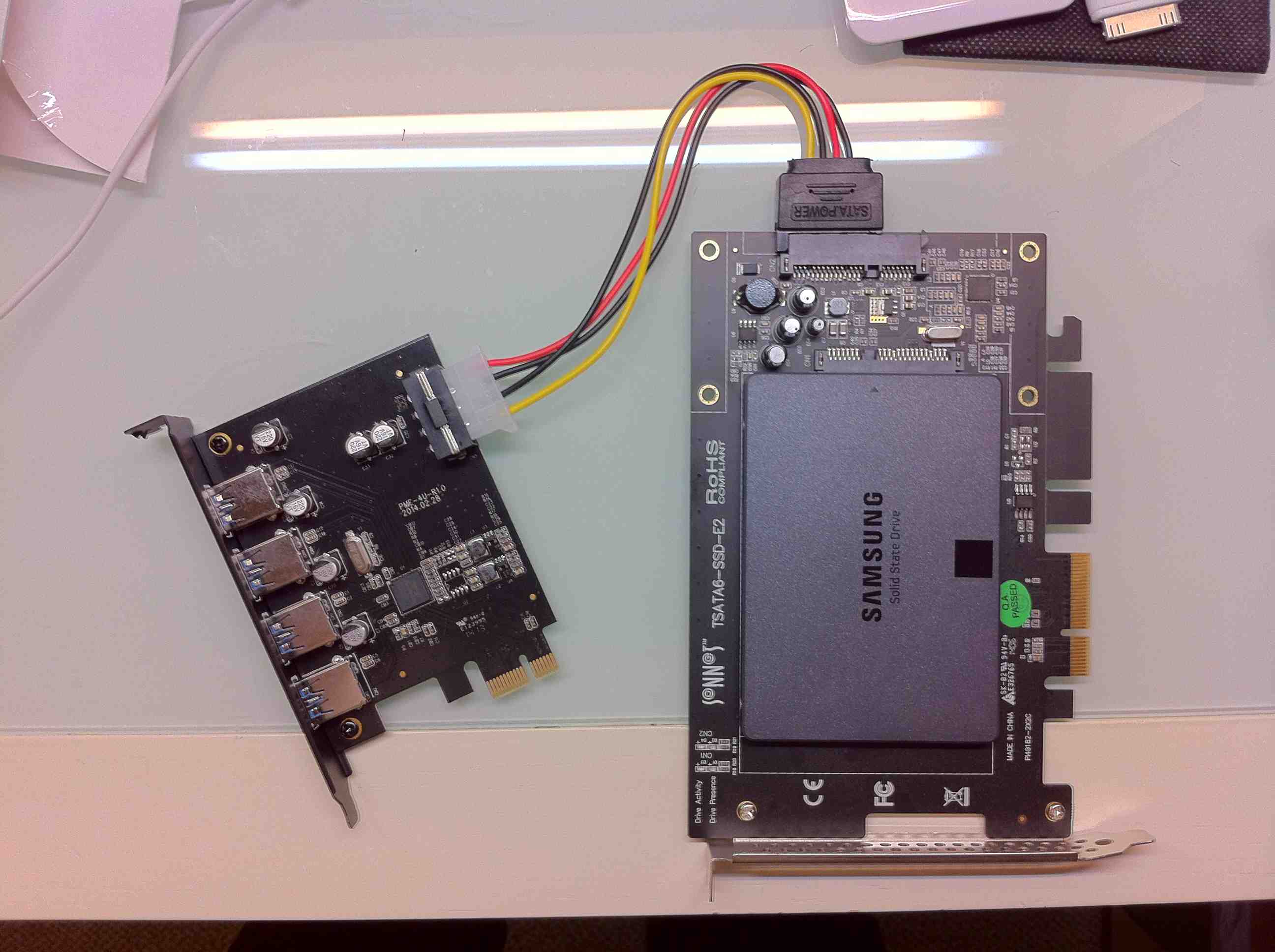

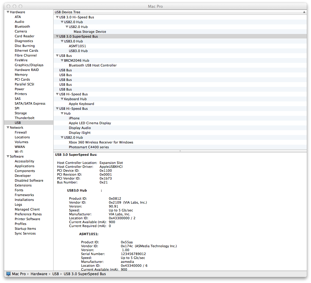

I did send them a message, but no reply for a week. So, I went to a computer store to pick up a Orico PME-4U today.
According to the official website information, there should be a cable included. However, the seller show me few packages, there is no cable in the box. So, he just give me a non-official cable.
I didn't check if that's the correct one. After back home, I found that the cable is wrong (the male/female reversed). For testing purpose, I'd try to install the card without the power cable, no luck. The card showed up in system information with driver properly loaded. However, it can't detect anything (HDD, USB drive, powered hub, etc).
All the cable, device, and the hub is working properly with the USB 2 port. Therefore, it must be the card. Even though the driver is properly loaded, iStat shows that the card draw zero current from the PCIe slot (I'd try both slot 2 and 3, same situation), may be this is the reason why it doesn't work (I really can't understand why they design a card that don't use the PCIe slot power, but force us to get it from other source).
Anyway, I will try to get a correct cable tomorrow and test it again (hopefully I can find one, otherwise, I will have the card in my hand, but forced to stay with USB 2 for a while).
h9826790
macrumors P6
Apr 3, 2014
16,656
8,587
Hong Kong

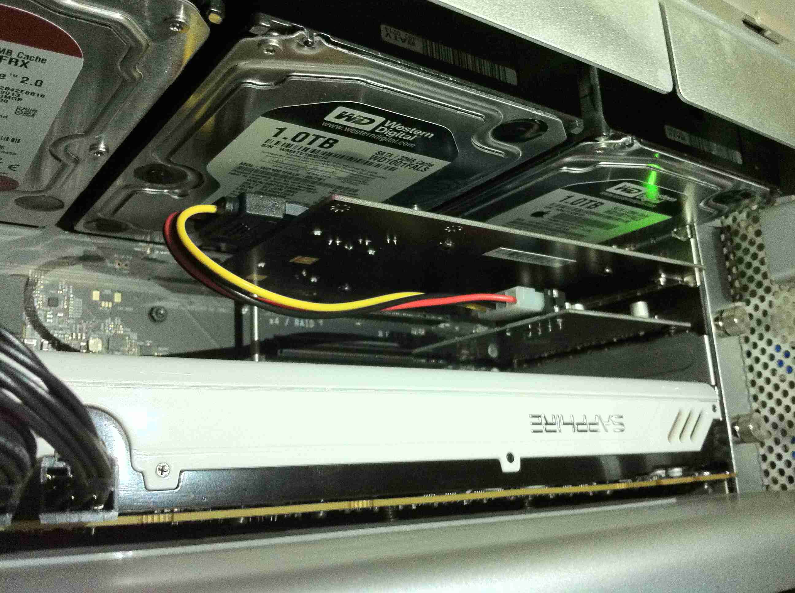

Lucky enough to find the correct cable for my Orico PME-4U for just $2 today. With this power supply, this card works flawlessly (all keyboard, mouse, HDD, USB driver, CF/SD card reader tested via a USB 3.0 hub), no driver required, high speed, and no crash.
Since I only have one SSD on my Tempo SSD card, so I can simply connect these 2 card together to power up the PME-4U.
The cable length is just perfect, not too long, not too short, and doesn't make the inside looks too messy.
