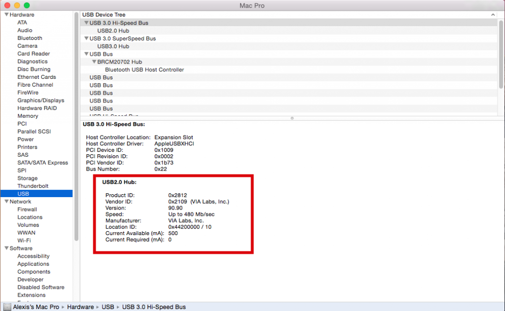

Hi guys wondering if any one knew whats the problem with my USB 3.0 set up...
i have a Orico PFU3-2P which is working fine for usb 3.0 speed
PCI Card
just purchased a Orico M3H4 4 port hub
USB 3.0 Hub
tried with different usb 3.0 cables and nothing... still only registered as a usb 2.0 hub 🙁
any help would be great
Mac Pro 3.46 12 core running Yosemite PB2
PCI Card
USB 3.0 Hub
[url=http://i927.photobucket.com/albums/ad120/Lexrouzee/ScreenShot2014-09-17at195811.png]Image[/URL]
Your USB 3.0 hub is normal. Your card support both Hi-speed (USB 2.0) and super speed (USB 3.0). Did you see that your hub also appear under the super speed bus? That means your hub now can work with both USB 2.0 and USB 3.0 device.
According to your pic. Your hub is listed under the USB 3.0 SuperSpeed section. Plug in a USB 3.0 drive and test the speed. Pretty sure you'll be satisified.

Thanks guys yeah after testing you guys were right! appreciate your experience 🙂
