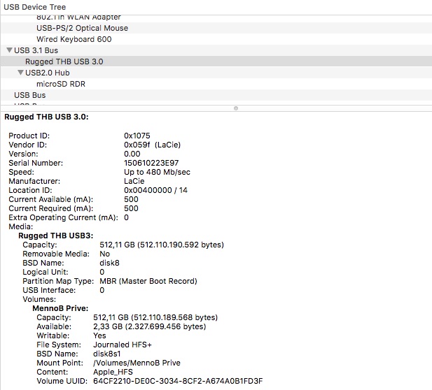

Hi Everyone,
I'm running a Mac Pro 3.1 early 2008 on Sierra. I have a Microconnect USB-C Card installed. This card has a ASM1142 chip.
It works natively in sierra but i get a very low transfer speed of about 32MB/s read and write speed. I tested this both on the X16 and X4 slot but dat doesn't make a difference. I also tested multiple ssd's. The card is internally powered with the power cable of the optical bay.
The PCI tab in the System Information says:
There was an error while gathering PCI device information.
The USB Device Tree the following.
Any idea what this could be.
Thanks!
Mac Pro 3.1 Early 2008
Asus Radeon RX460 2gb
There are many indicators showing you are actually running USB 2.0:
  • "Up to 480 Mb/sec" is USB 2.0
  • A current of 500mA is USB 2.0
  • 32MB/s is a typical real-world speed for USB 2.0.
So something in your chain is operating as USB 2.0 and everything else is forced down to that level for compatibility. Since you have tried multiple drives, that leaves the card, the cable, and the OS/driver. Depending on how you connected the SSDs, maybe also the USB enclosure/adapter for the SSDs.

I have a Sunix USB-C card in a 2009 Mac Pro. I saw the same issue, but swapped out the cable and resolved the issue.
The link was consistent with USB 2 speeds using an eBay sourced USB 3.0 cable ( longer ) that attached to a Seagate Backup+ drive. Once I swapped out the cable with the one provided by Seagate, it worked as expected. YMMV
