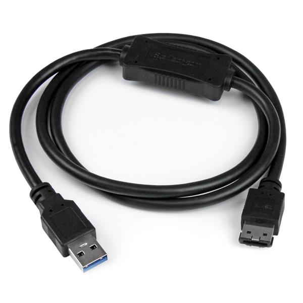

You can get USB to eSATA cables. They have been around for some time but never tried them myself.
Startech USB 3.0 to eSATA HDD / SSD / ODD Adapter Cable
I have a similar USB/eSATA cable. The problem ist eSATA is not powered, so I cannot use it with small 2.5" SSD's without power supply. Apart of that it's an uncomplicated device, no drivers needed, performance up to 400 MB/s.

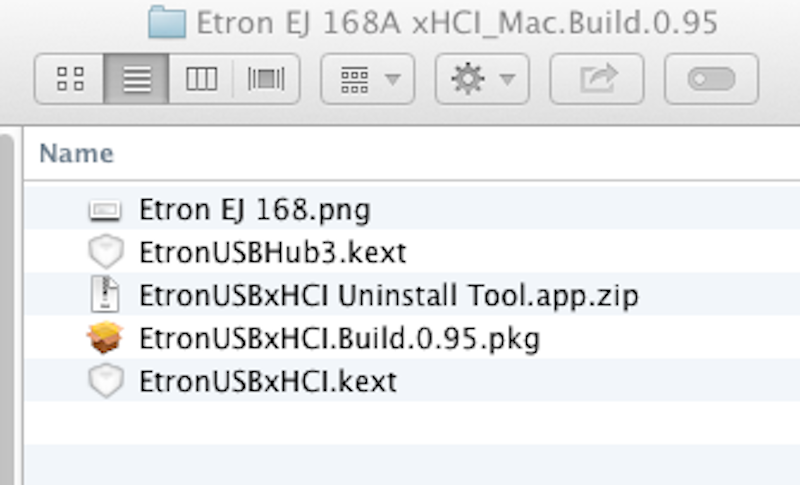

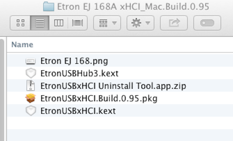

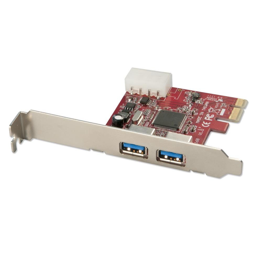

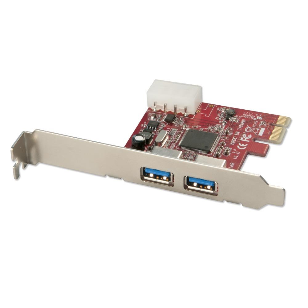

Here in Japan I found an Etron EJ168A 2 port USB 3.0 card ( ¥400 ! about US$ 3.50 ) which worked OOB in Sierra 10.12.6. ( I haven't tried it in High Sierra yet ).
Just out of curiosity I had a look in the mini DVD that came with it and .. lo and behold ! . . it had Mac Drivers !
The card was packaged in a simple white box .. no maker's brand.
Seeing that card works OOB and with doubts that the drivers are Sierra / High Sierra compatible - the installer has a message that minimum OS X must be 10.8 - I will only install for testing later on a spare High Sierra and Mavericks HDD and post the results.
Some people like myself need to use Mavericks - this card doesn't work without a driver in Mav. So if after installing the driver it does work .. that would make it useful
Contents of the drivers
For ¥400 this card was a steal. :)
