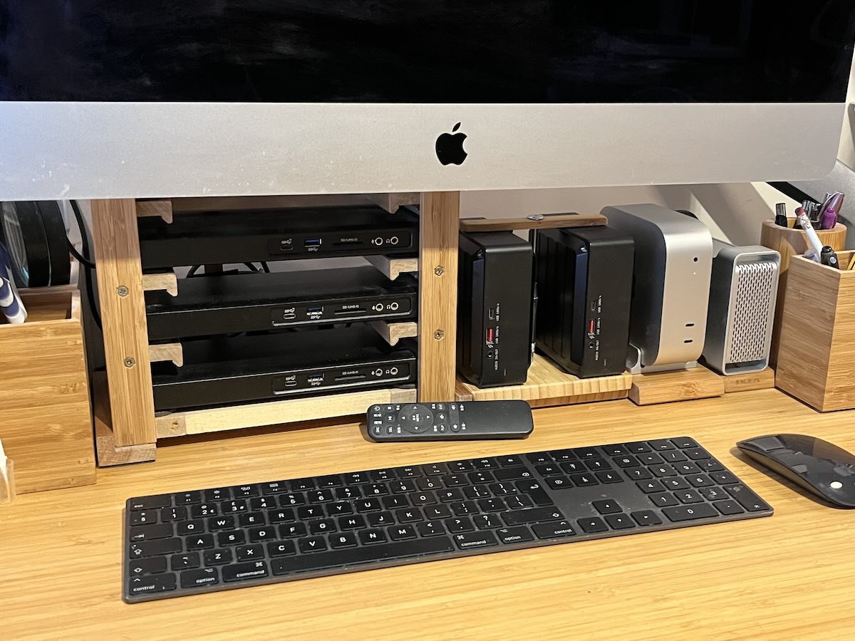

Without trying, and wanting to stick to USB-C, I nevertheless find myself* looking at 12 (twelve!!!) unnecessary USB-A 5/10Gbps ports (+ sundry USB-C ports+ 3 UHS-II SD card readers + 6 audio ports) in front of me on my desk... 😃
But I do actually use a -A port occasionally. ;)
But I don't want them cluttering/replacing USB-C ports on my Mac mini.
*Because I was able to buy 5+ TB3 NVMe enclosures from major brands - which all happen to be EOL docks - for less than the cost of 5 ordinary TB3 enclosures...
And it's a DIY 5K monitor (VESA), which is normally lower.)
