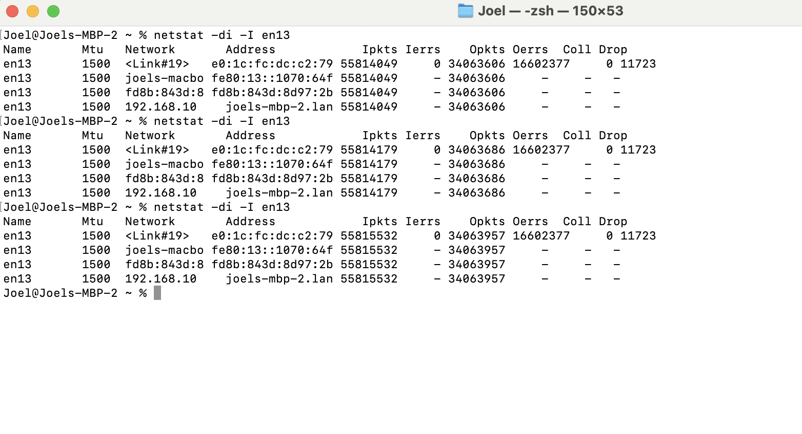

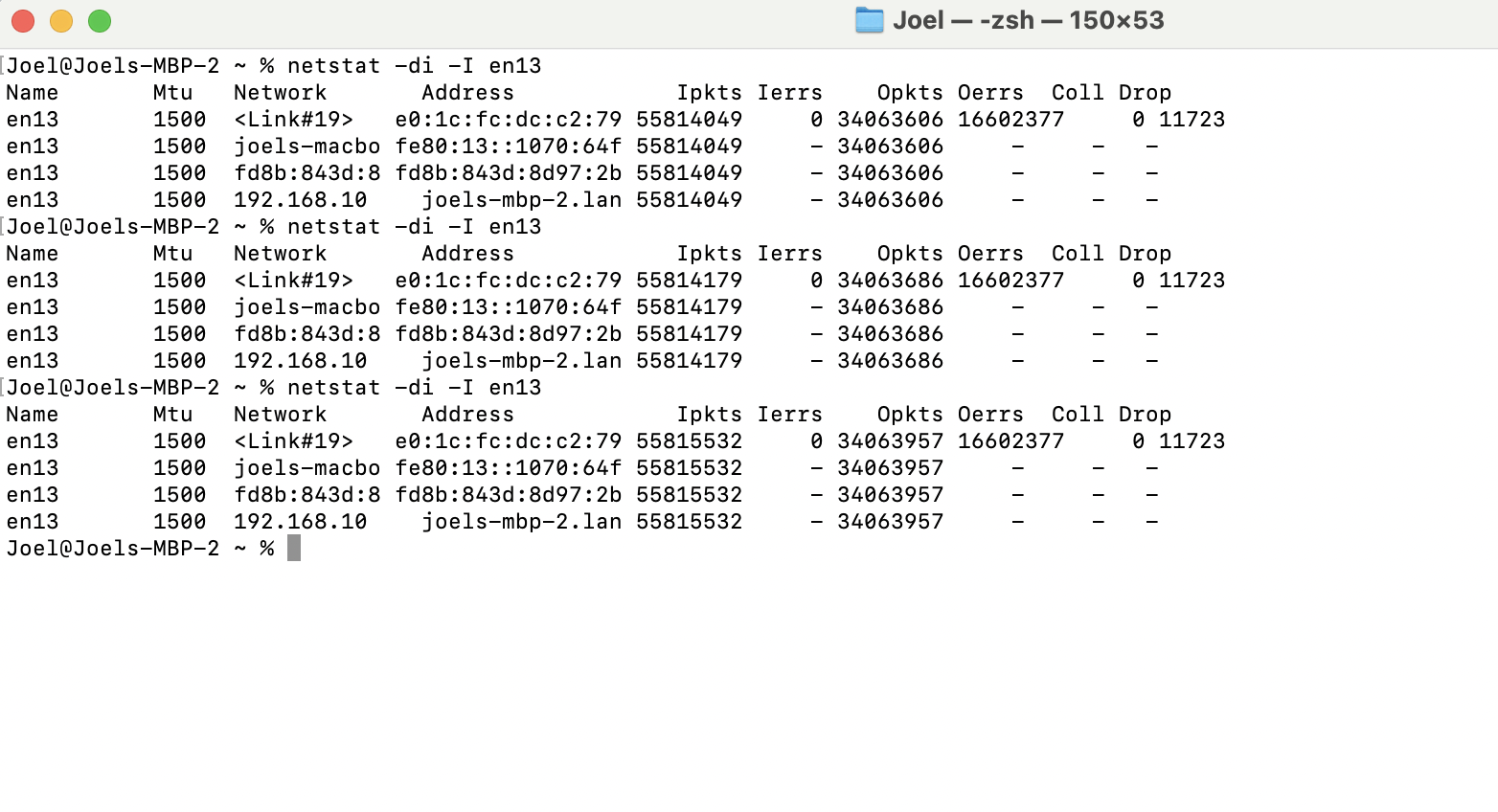

Would you be so kind to test the terminal command "netstat -di -I enX" (use the numbered interface corresponding to your USB-C-Ethernet adapter) and report the number of "output errors" after some time of usage?
I would be happy to but want to make sure I do it correctly.
Is my understanding correct that based on the below image teh command should be netstat -di -I en4
Please correct / confirm my understanding at which point I will run the command and report back.
Thank you.
Thank you.
You can find out your interface number with the ifconfig terminal command.
@learjet , here you go, as requested. I ran it 3 tims.
If you don't mind, help me understand what it is reporting.
If you need anything else, please let me know.
It reports, like on my M3 MBA, apparently lots of "Oerrs" (output errors) and some dropped frames. Using 8153-based adapters or the official Apple Thunderbolt Gigabit Ethernet adapter, there usually are zero "Oerrs".

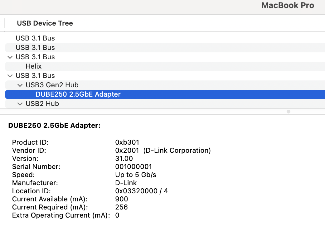

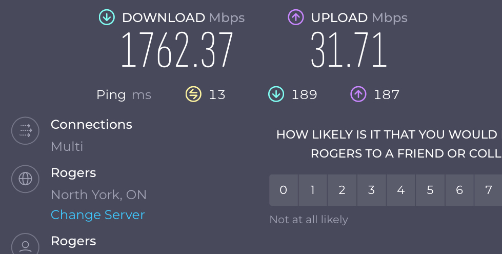

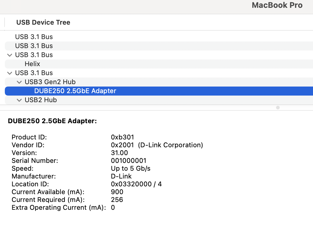

Based on the advice in this thread, I picked up the D-Link DUB-E250 on sale here. I don't know what the usual pricing is but list price on the D-Link Canada website is CA$44.99. However, they had it on sale for CA$19.99.* I guess that moved a bunch of them quickly because now it's sold out.
I don't actually need it for my M4 Mac mini, since I got the 10 GbE upgrade on it. However, I did want to have 2.5 GbE support on a second machine for testing purposes, as I will be upgrading parts of my home network to 2.5 Gbps. The plan was to use my 2017 MacBook, but clearly it is not up to the task. The adapter shows up on the MacBook as connected at 2500 Mbps, but the MacBook just can't keep up.

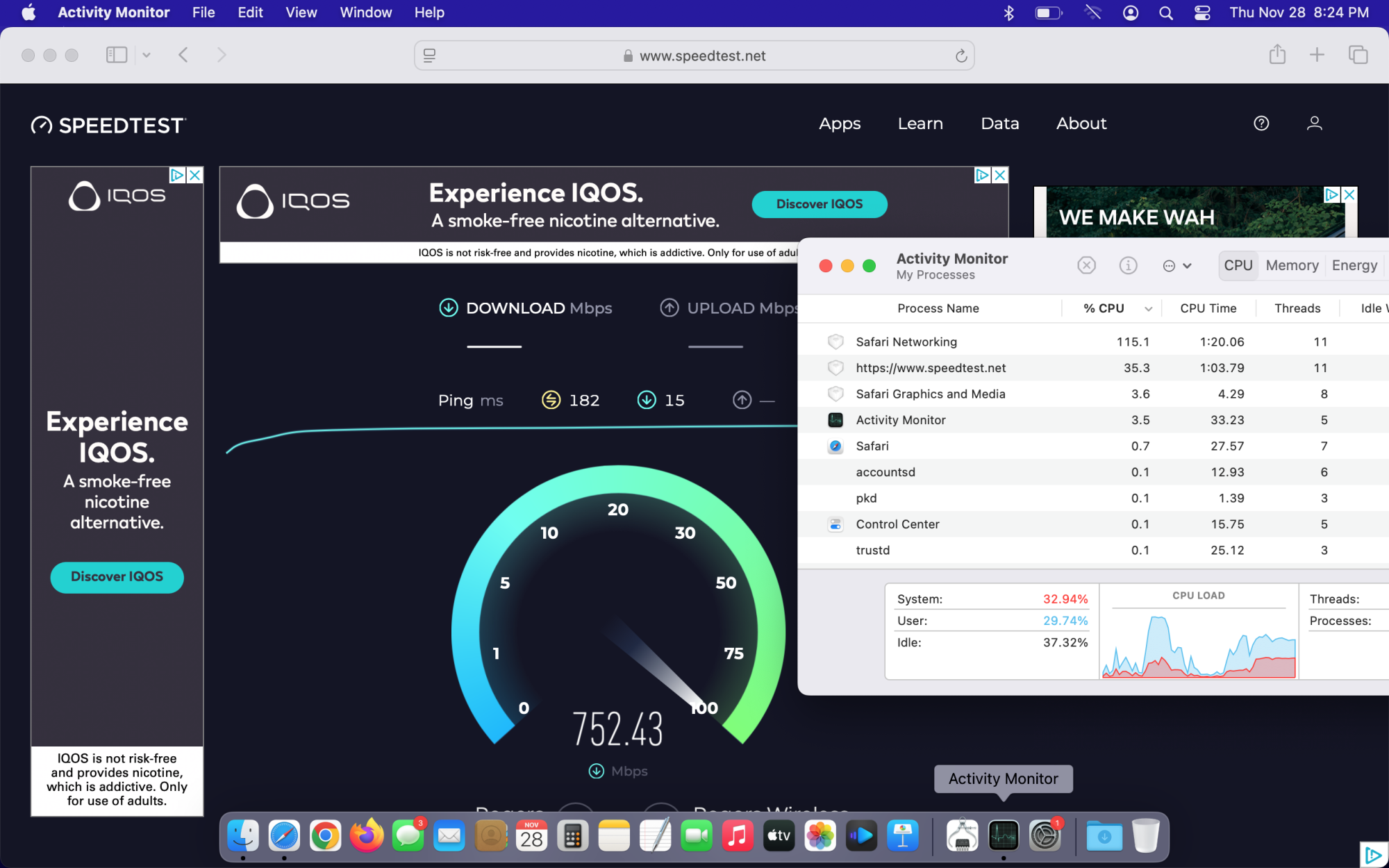

So obviously this 12" MacBook will be useless for testing out my network. The USB-C port is only 5 Gbps but that should be fast enough for 2.5 GbE, but I also see that it's eating up a lot of CPU cycles, so perhaps that's where the bottleneck resides.

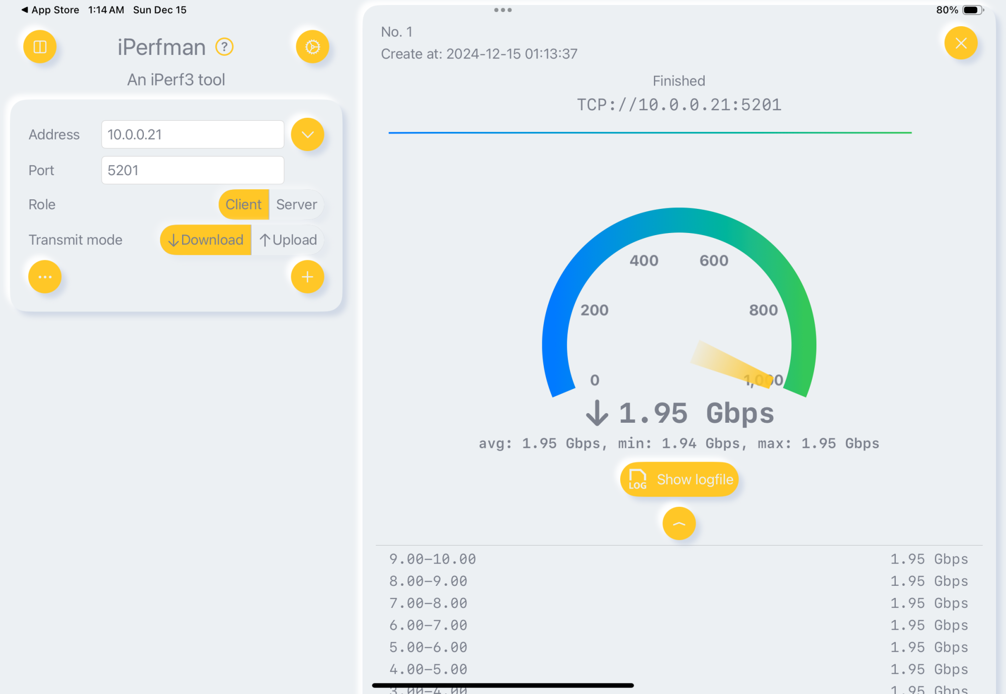

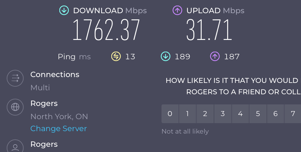

However, it turns out my M4 iPad Pro works great with it. I'm on 1.5 Gbps download with 50 Mbps upload service, and the iPad Pro is more than maxing that out.
*If it does get back in stock, here is a hint for a discount. At least in Canada, for purchases this small, they charge a shipping fee. However, D-Link Canada has a Subscribe And Save deal for new subscribers. Unfortunately, it's only 10% off, but more importantly, there is also a promo code floating around out there that provides for free shipping for subscribed users. You can't use the 10% discount and free shipping at the same time, but the free shipping is a much higher value. I subscribed to their news info, and did NOT get the discount code email as promised, but I found both the discount code and the free shipping promo code online anyway and was able to use the latter, so I just paid the CA$19.99 (which is a little over US$14) plus tax. (The codes did not work with my other email. They only worked with the email I had subscribed with.) At this price, it's a steal, significantly cheaper than the UGREEN for example.

Server is M4 Mac mini with Sequoia 15.1.1, with 10 GbE port. Client is M4 iPad Pro with iPadOS 18.1.1, with D-Link 2.5 GbE adapter. They are connected through the same 2.5 GbE switch.
Testing with my internet access isn't helpful, because it is 1.5 Gbps service, which maxes out at 1.9 Gbps (which is apparently the speed to which my internet service is over-provisioned).

[ ID] Interval           Transfer     Bitrate         Retr
[  5]   0.00-10.01  sec  2.27 GBytes  1.95 Gbits/sec  203             sender
[  5]   0.00-10.01  sec  2.27 GBytes  1.94 Gbits/sec                  receiver
(also note the "Retr" column)

From what I read on a few forums, 5 GbE adapters (based on the Realtek 8157) are not as badly affected but they still show some loss; it's just that at 2.5 Gb there's a lot of headroom before it becomes an issue in that case.
Interestingly, I no longer have Oerrs on the 2.5 GbE interface, whereas I had a LOT of them in Sequoia:
Code:
octavarium:~ jollino$ netstat -di -I en11
Name       Mtu   Network       Address            Ipkts Ierrs    Opkts Oerrs  Coll Drop
en11       1500  <Link#13>   00:e0:4c:68:02:23 16025605     0  2231296     0     0   7
en11       1500  192.168.0     192.168.0.2     16025605     -  2231296     -     -   -
en11       1500  octavarium. fe80:d::4f0:630c: 16025605     -  2231296     -     -   -
en11       1500  2a07:7e87:2 2a07:7e87:2865:0: 16025605     -  2231296     -     -   -
YMMV but here's to hoping they eventually sort it out, it's not really a dealbreaker but something definitely changed in Sequoia!
