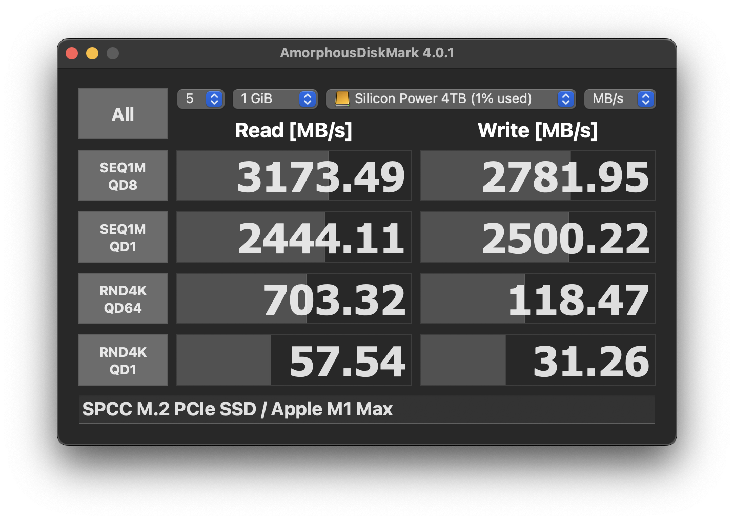

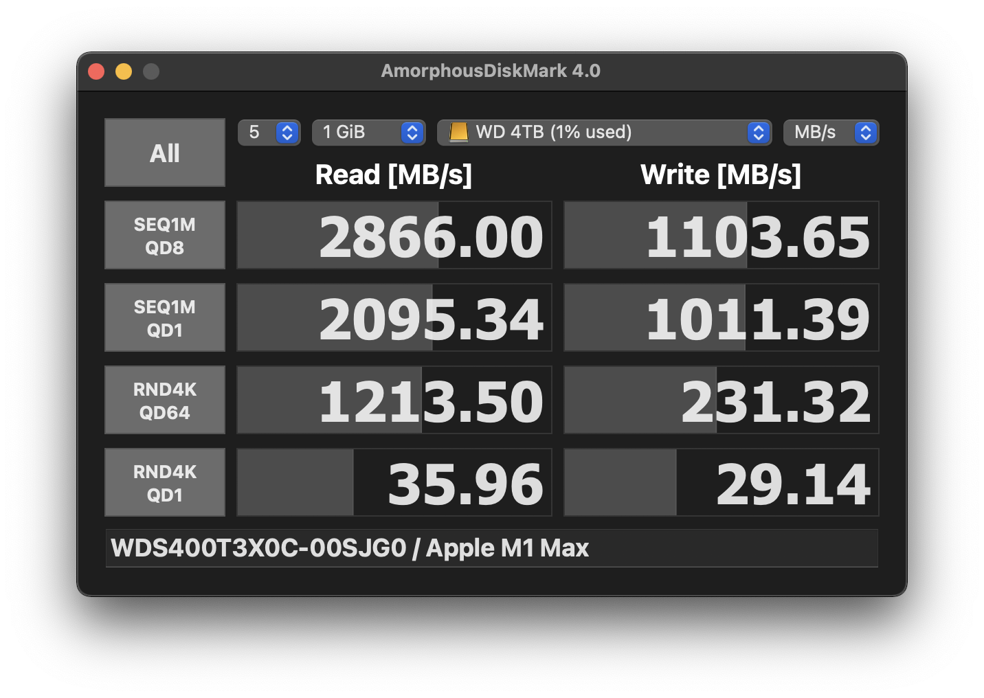

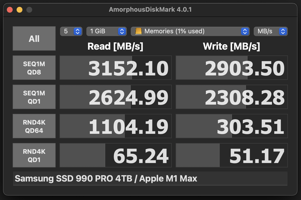

I passed on the HyperDrive and bought an Acasis instead. I put in a Silicon Power 4TB SSD. Here's the DiskMark test with my MBP M1 Max. It's definitely the fastest drive I have by a long shot. It even beat my WD Black 4TB drive in a Konyead enclosure.
Reactions: verm
View attachment 2250465View attachment 2250466
Interesting. I think there's a problem with AmorphousDiskMark and WD 850X 4TB. I get the same low write results.

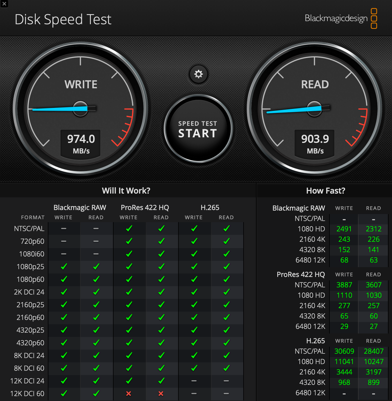

When I test in Blackmagic Disk Speed Test and AJA System Test I get about 2800 mb/s in both read and write.
I've done some real world tests writing from the acacias TBU405 to the internal disk and it's blazing fast.

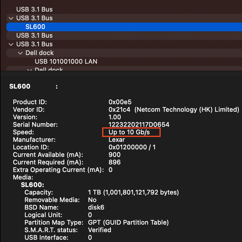

I have a Lexar SL600 1TB external SSD which supports USB 3.2 Gen2. Connected to my MBP 16' M1 Pro and the connection speed was right at 10Gbps.
Speed test result looks normal as well.

Thanks! I went with the 990 Pro and will post results. My Acasis model is TBU405 with the fins on top, but without fan.

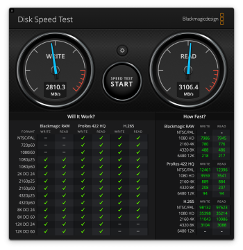

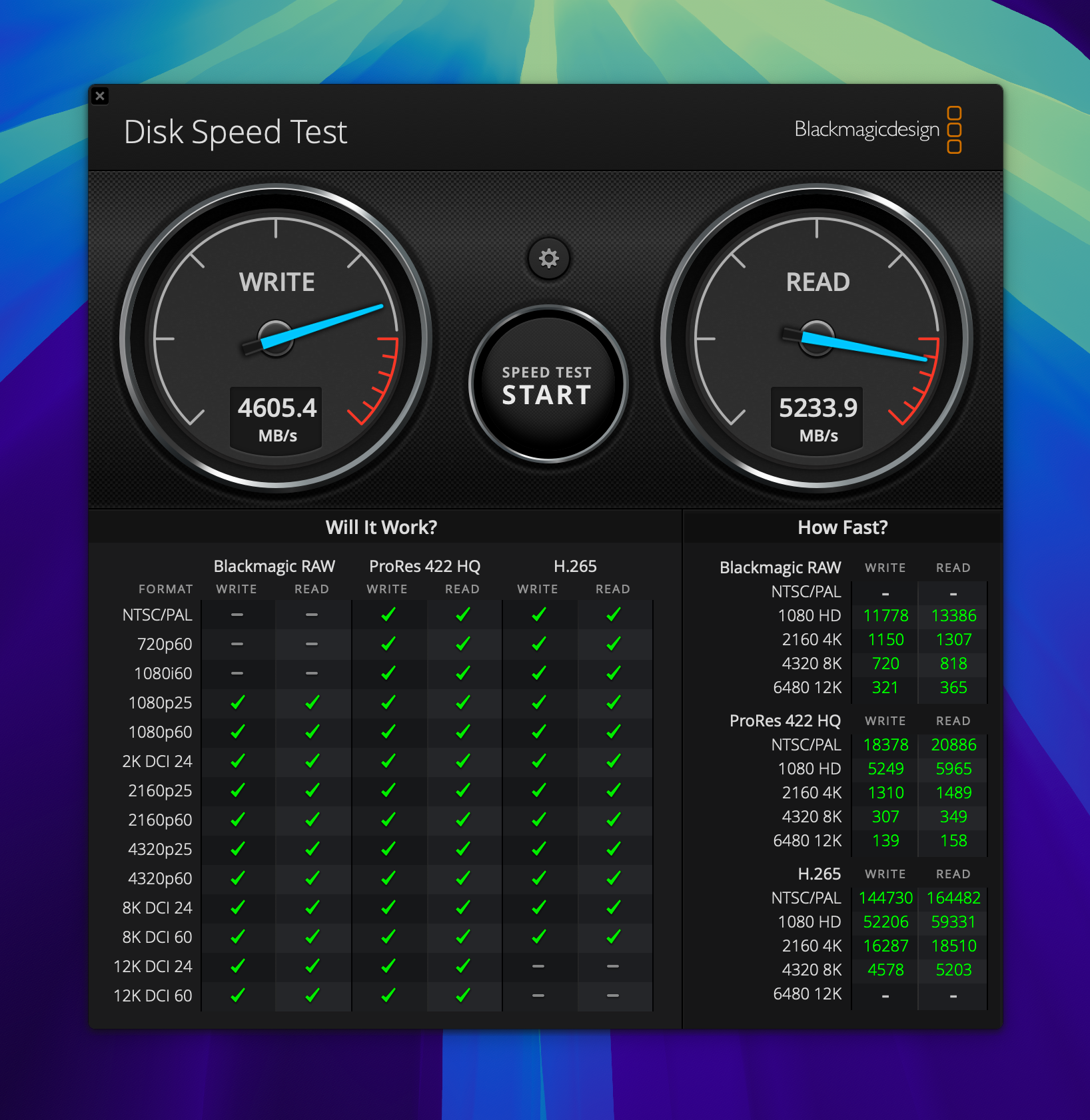

Here's a different test using an Acasis Thunderbolt 5 enclosure and an 8TB WD_BLACK SN850X SSD. I am comparing my 2023 MacBook, which has Thunderbolt 4 ports, with my Mini m4 Pro, which has Thunderbolt 5 ports.
Thunderbolt 5 is significantly faster, 2810 MB/s vs. 4605 MB/s write.
