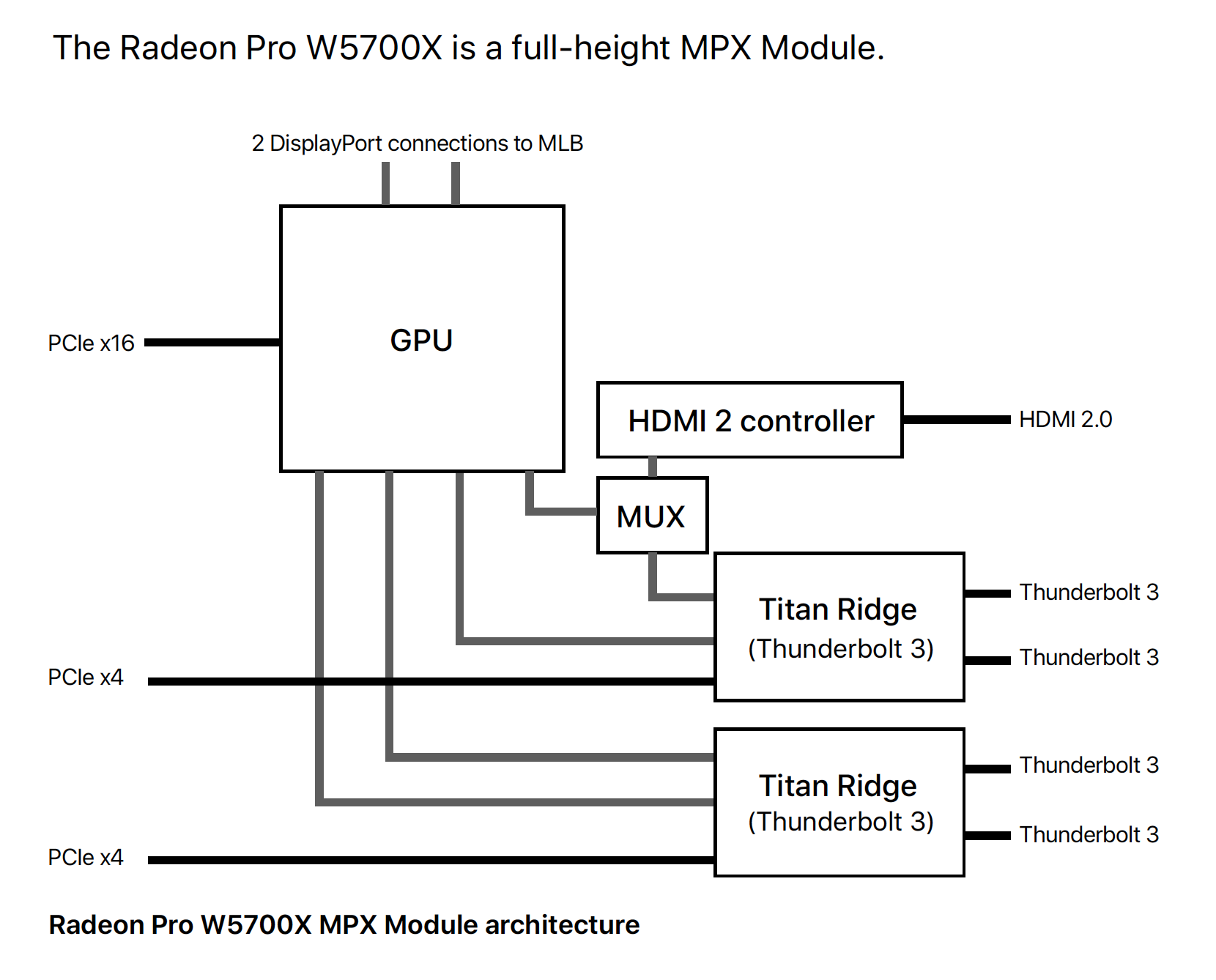

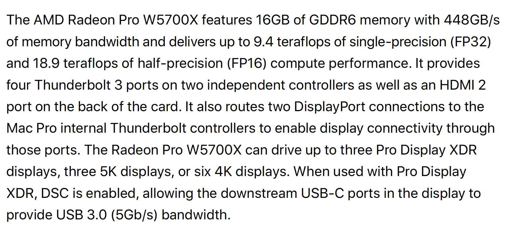

They are only 2K QHD monitors. Is there any reason I should not be able to connect all three monitors to three separate TB3 connectors on the W5700X card itself? All the monitors will have Display Port connectors
You have posted before about monitors. Monitors with USB-C would have been better. But with the proper cable you will be ok:
From Apple:
Lou
Reactions: choreo
Lou
Just to confirm, I finally was able to connect all three of my 27" NEC monitors for the first time tonight to three of the W5700X TB3 ports using these Monoprice cables and they fired right up - no problems yet and have had 5 restarts since install.
Thanks again for the link!
