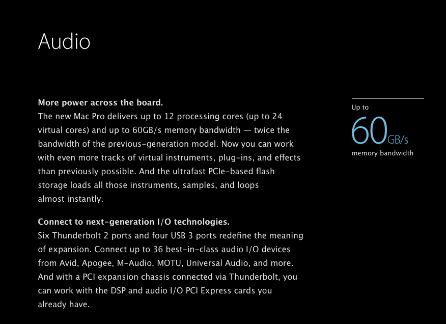

When you work with a full orchestra of VIs you want, and need a lot of cpu power. Not to mention compression, EQs, various realtime effects, etc. Plus the realtime performance/playback of your DAW - plus video tracks(s) (I work in film music), and I could go on. An iMac is certainly NOT the ideal tool for the job! I couldn't do what I do each day on an iMac. If the 7,1 is announced I'll definitely look into it. The only reason I didn't get a 6,1 was the lack of PCI. Maybe I'll reconsider if the 7,1+extrernal PCI is a viable option.
Unless you're talking about the indie pop band that only needs a laptop, a guitar and a cheap mic when they record outside next to their westfalia.

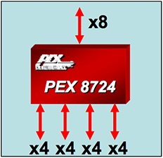

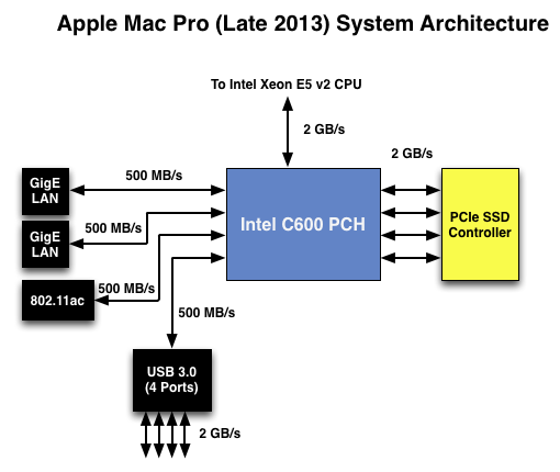

Aiden, whatsup? this is the PEX-switch for the TB2 controller on the nMP6,1, we where talking about the 8 PCIe2 lines from the PCH C602 on the nMP6,2 which has 4 wired to the SSD, 2 wired to the dual GbE controller and one Wired to the WiFi/BT module, leaving only one line PCIe2 free.
The posts that I replied to were discussing the MP6,1. Apple left four PCIe 2.0 lanes unused on the MP6,1.Aiden, whatsup? this is the PEX-switch for the TB2 controller on the nMP6,1, we where talking about the 8 PCIe2 lines from the PCH C602 on the nMP6,2 which has 4 wired to the SSD, 2 wired to the dual GbE controller and one Wired to the WiFi/BT module, leaving only one line PCIe2 free.
a nMP based on C612 not using a PEX to share the 8 free PCIe3 lines from the CPU, and enabling only 4 TB3 ports would require all that 8 PCIe2 lines from the PCH to drive the NVMe ssd(s), but given the C612 provides also USB3, it could wire unused USB3 ports to WiFI/BT

You're wrong Aiden, take your time to read the article from Arstechnica on the MP6,1 it details onlu 1 PCIe 2 line was left unused.The posts that I replied to were discussing the MP6,1. Apple left four PCIe 2.0 lanes unused on the MP6,1.
The MP7,1 will be interesting, since each T-Bolt3 controller needs twice as much bandwidth.
Beg to differ.You're wrong Aiden, take your time to read the article from Arstechnica on the MP6,1 it details onlu 1 PCIe 2 line was left unused.

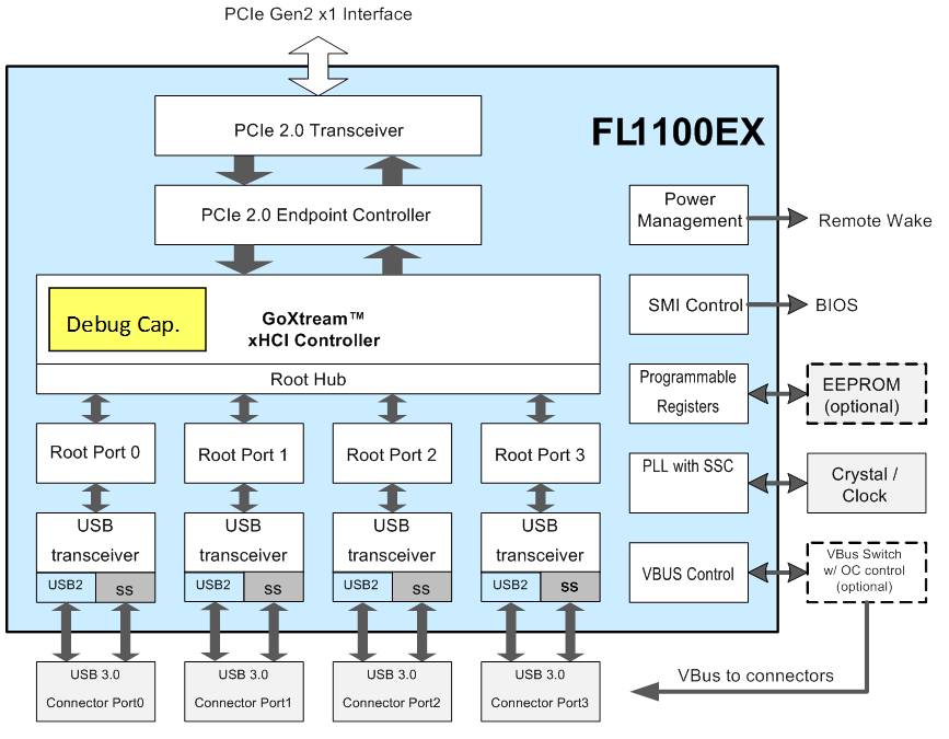

ahh, that's another question, you talk anbout the 4 PCIe2 lines from the PEX Switch, sorry again those are used by the USB3 adapter since the C602 don't provide USB3.Beg to differ.
Only 3/4 of the bandwidth of the 8 PCIe 3.0 lanes going into the PEX are used - 25% of the bandwidth is left on the table.
The above diagram does not agree with what Anandtech found by mapping the PCIe complexes.ahh, that's another question, you talk anbout the 4 PCIe2 lines from the PEX Switch, sorry again those are used by the USB3 adapter since the C602 don't provide USB3.
Still sistem wide, the nMP 6,1 only left 1 PCIe2 unused.

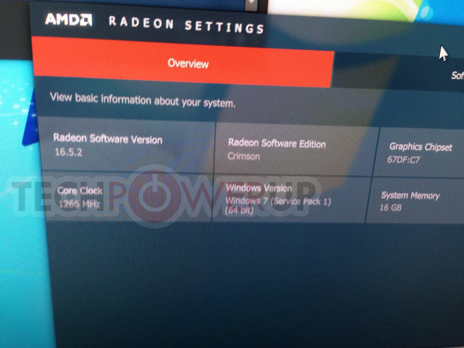

8GB version of RX480 at 229USD seems good value.
If it gets to 5.5TFlops it's great.
Speed seem to be at 1266MHz, according to TPU:
Default or OC'ed is anyone's guess.

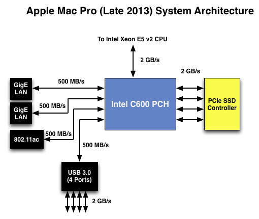

They put the USB 3.0 controller on the PCH.
In any event, there are four unused PCIe 2.0 lanes in the MP6,1. Either four from the PEX, or three from the PEX and one from the PCH. (Notice the unused PCH lane on your diagram.)

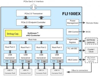

The USB 3.0 controller is a Fresco Logic FL1100EX - which is a PCIe 2.0 x1 part.I believe the USB3 controller is using the 4 additional lanes out of the PEX, not as Anandtech says that it only takes 1 PCIe2 lane. that would be serious bad design choice.
