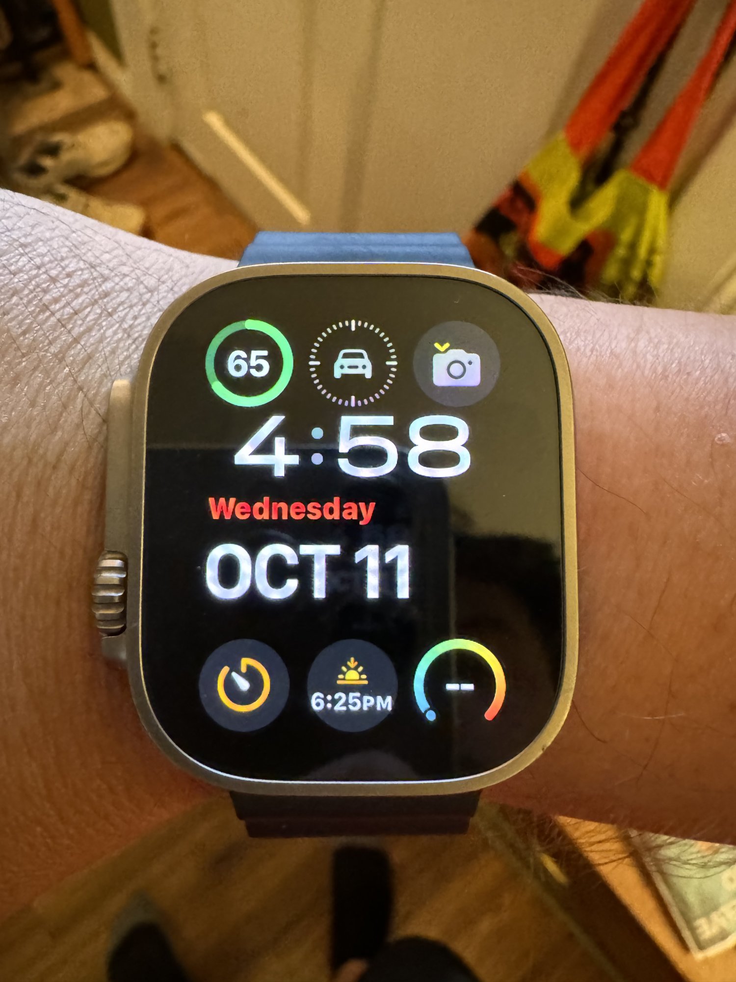

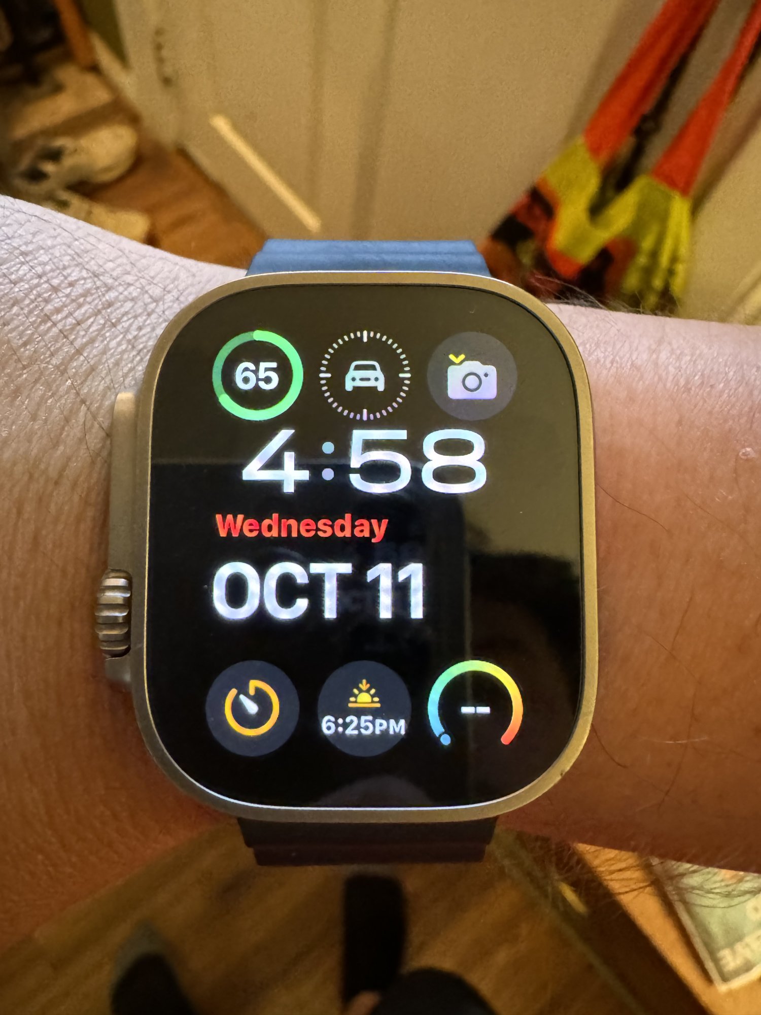

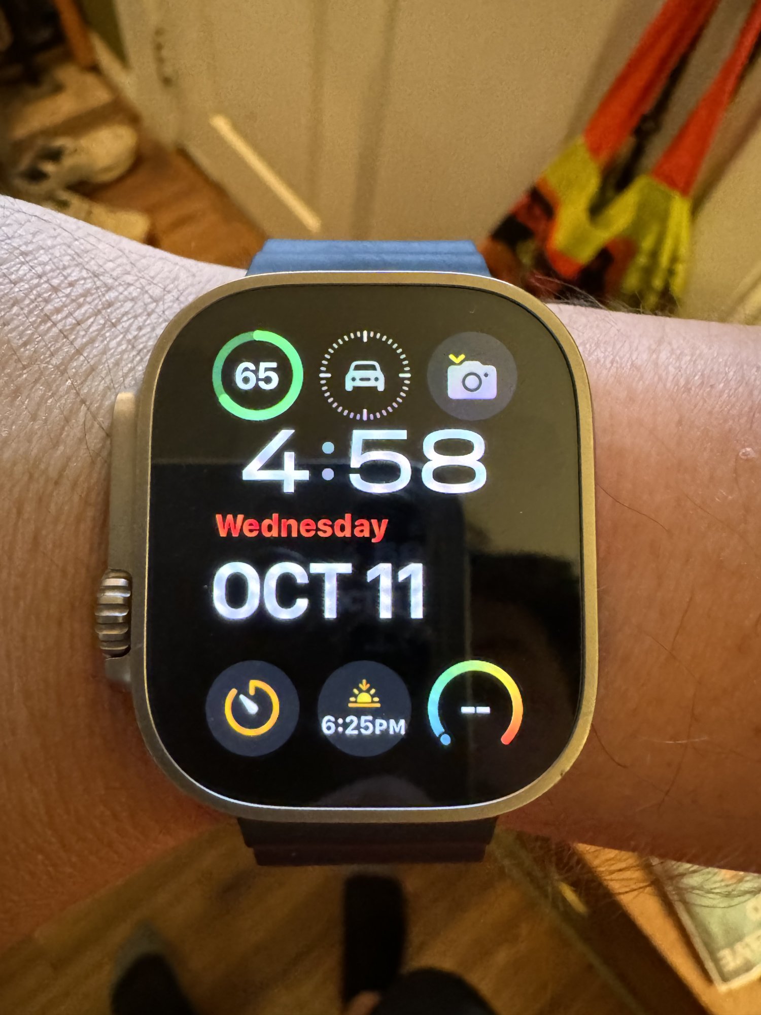

Just did a clean install on the Apple Watch Ultra 1 because I’m getting awful battery life (30hours if barely used).
Weather complication is still an issue even with turning off location, turning it on, changing location, restarting phone and or restarting watch. Oh and turning on and off Bluetooth.
Blah.
Reactions: Barbareren
