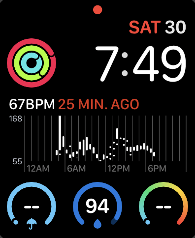

I have tried rebooting both devices (Iphine 15 Pro Max and Ultra 2 iWatch) several times.
I have tried the two suggestions Apple fixes....and nothing works.
I have no weather data - not Temperature/Rain?UV Index etc - so three of my Complicaitons on the watch are useless right now!
Are there any other suggested fixes ?? Bizarrely it did work when I first sett the arch up - and then I did get it to work briefly by changing all the complications around and re-loading - but after half and hour or so it reverts to "--" in all the weather complications .....Arghhhhh

I upgraded from a Watch 6 to Ultra 2. As well, from iPhone 12 Pro Max to 15 Pro Max. And switched from ATT to Verizon. So, thought this had something to do with my "it's complicated" situation.
I'm seeing the same thing. More often than not I get dashes. Sometimes though I get values. Sometimes I will see values if I switch to another face. Sometimes when I switch back to the first face, I get values. Sometimes not.
If I tap on the complication, I do get weather data. And sometimes when I go back to the face then I get values. And then I'll glance at the watch later, and no values.
