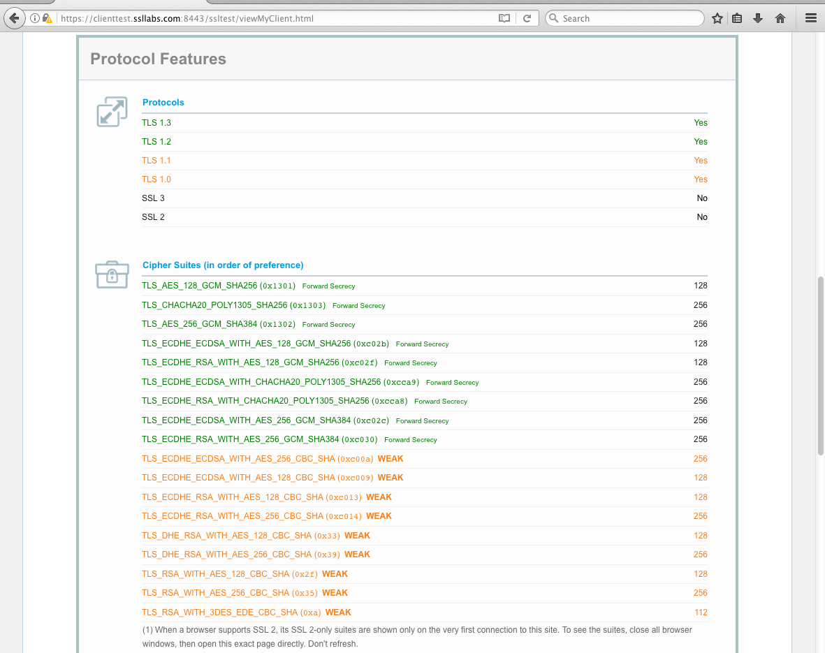

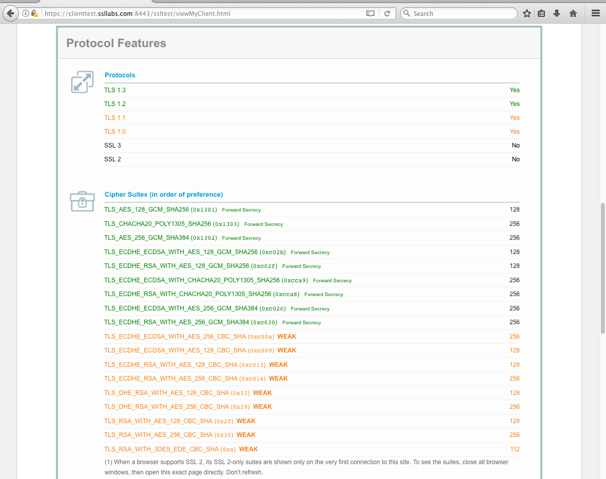

InterWeb 60.9.6 is released. I've added TLS 1.3 support to this release.
Download here: https://github.com/wicknix/InterWebSnow/releases/tag/60.9.6
Changes from 60.9.5: https://github.com/wicknix/InterWebSnow/compare/60.9.5...60.9.6
TLS 1.3! Woohoo!

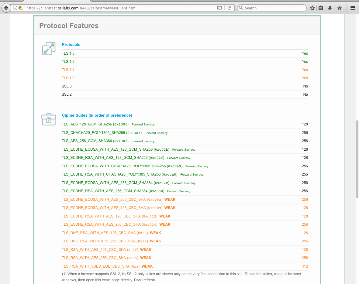

TLS 1.3! Woohoo!

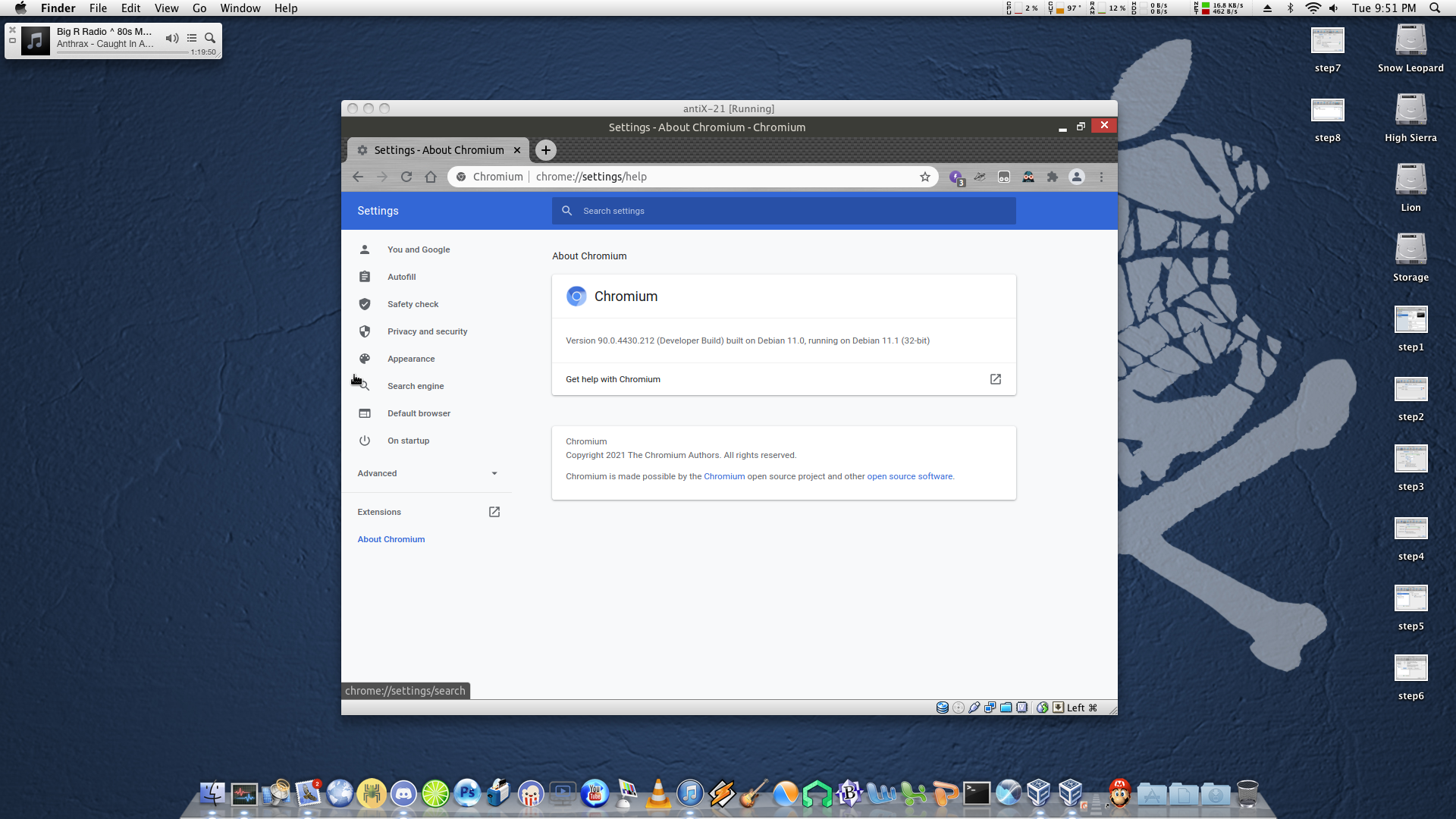

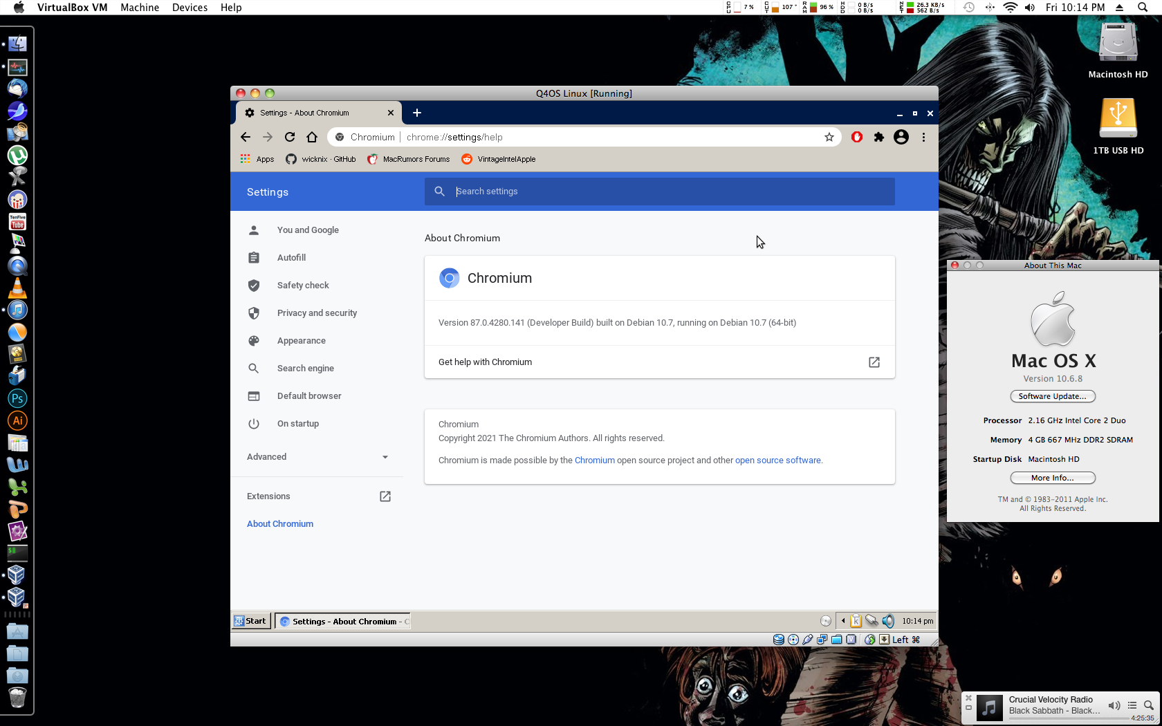

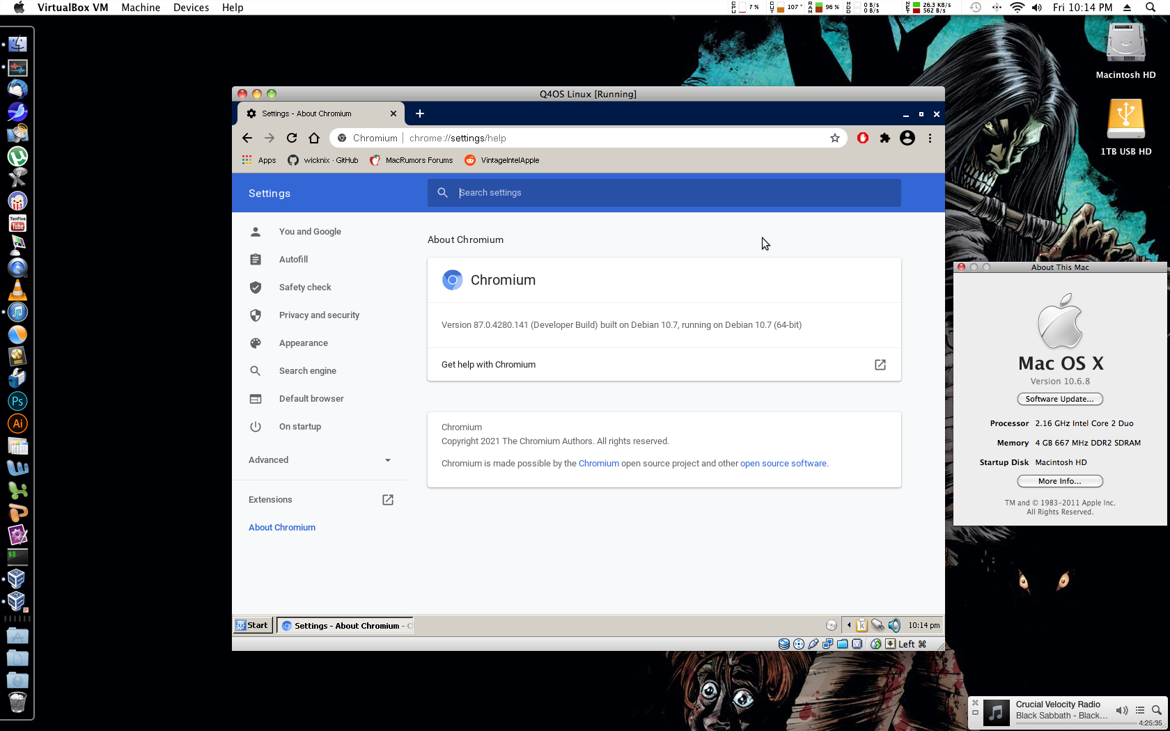

Most people know this already, but here's another way to have up to date browsers on our dated OS X's.
VirtualBox is free, and so is Linux. The lighter weight, the better. I chose Q4OS with Trinity desktop.
Works great for those occasional stubborn websites (or security for banking, ebay, etc without rebooting).
Cheers

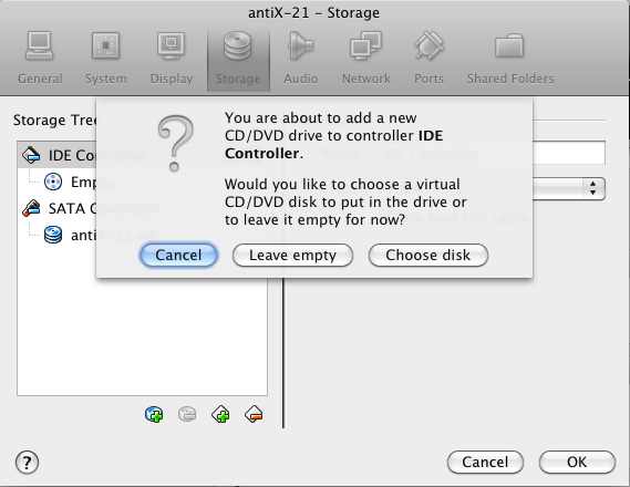

Once you create a new "machine" click settings and adjust your ram, video card ram, etc. Then for the hard drive section click the little +cdrom icon and select the .iso for your linux as a boot device. It should now boot from the virtual cdrom.

Hi there, I'm new to Virtualbox and also have Snow Leopard. Can you tell me how you set this up? I keep on getting errors or black screen. Thanx.​
Sorry for the double reply, but i'm home from work and can give a better tutorial on how to set up virtualbox.

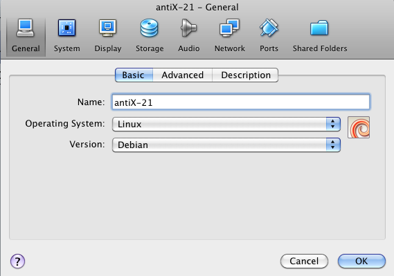

Create a new "machine" and select what fits it best. Most distros are Debian based, so choose that.

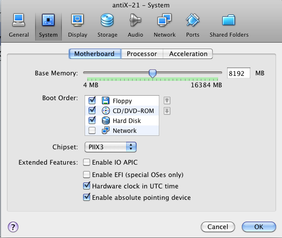

Set your virtual machines ram. Be careful here. If you only have 2gb of ram, set this to 1gb max. You still need ram for the "real" machine to use. (I have 64gb of ram so i have a lot to spare for my virtual machine in this example)

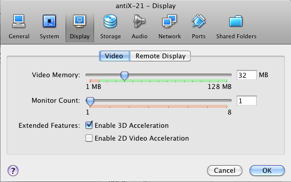

Adjust your video card ram. Again, be careful here as it takes away from the actual systems ram. 8mb will be fine for web browsing. Make sure to check "enable 3d acceleration" also.

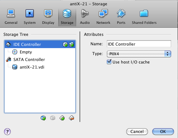

Choose your boot device. To get started we boot from a live linux .iso. This will let you boot into a live system, or the installer.
Click the +cdrom icon, then select your .iso. (once you install the system, remove this .iso as a boot device or it will always boot the .iso and not your installed system.

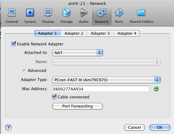

Set up your network (virtual ethernet) device. I find the pcnet-FAST II or III works best.

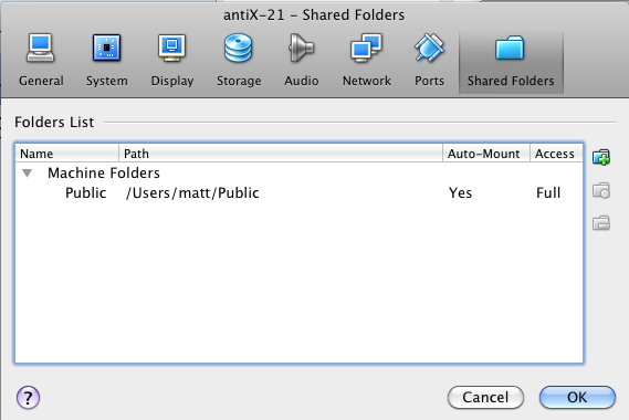

Set up a shared folder if you want to be able to share files between snow leopard and linux.
If all went well, you'll end up with something like this.
Cheers
