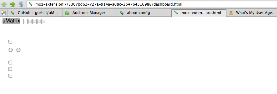

Most of these relate to compatibility, if any, with classes of add-ons. The usual legacy add-ons I keep archived locally (my big three: uBlock, uMatrix (or etaMatrix), and some kind of dark theme) were all incompatible with SnowLion 2.2.6 (as memory serves, is version number seems derived from the SpiderWeb version numbering). Even for versions of uBlock and uMatrix which I managed to add on successfully (i.e., the browser didn’t prevent it or post a modal about incompatibility with SnowLion 2.2.6), they are non-functional.
That is to say: opening add-on preferences, after being added, produced either blank or missing rendering.

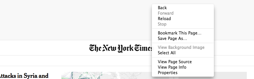

As well, uBlock Origin may appear as loaded add-on, but options in the right-click menu, within a loaded page, don’t show uBlock being available:

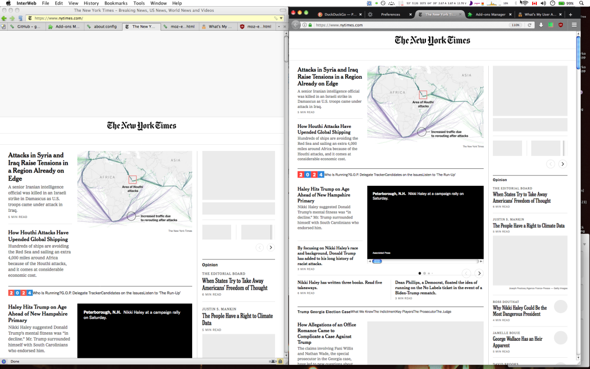

Side by side (SnowLion at left, Interweb 60.9.9 at right), a sample of rendering the front page for The New York Times presents similar rendering, apropos of the cap for parsing and rendering XHR/JS-related page code. For previously discussed reasons, that’s to be expected.

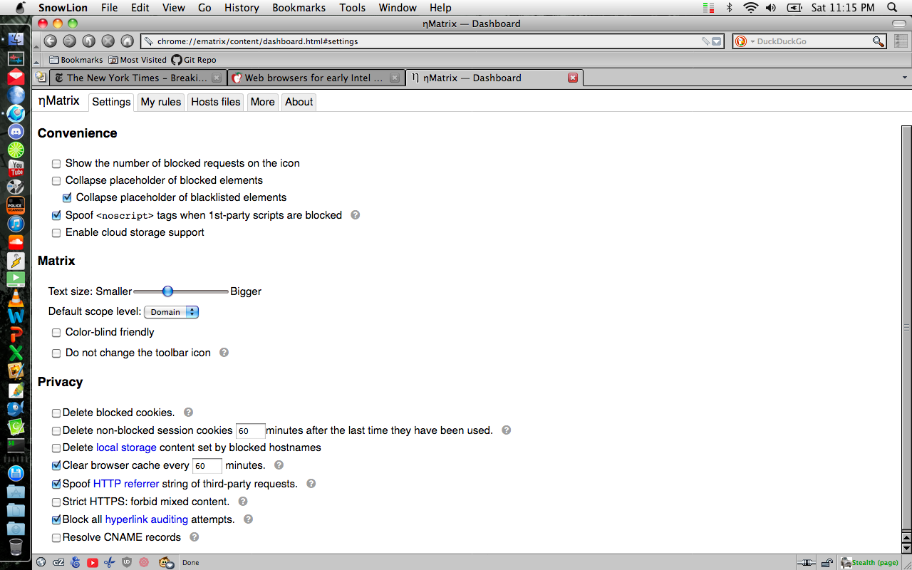

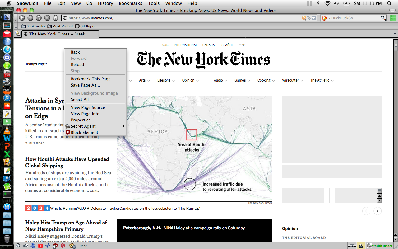

SnowLion comes with modified and working versions of ublock and ematrix in the download archive and they work as intended. Not sure what you installed, but use what's included and you'll be golden. 🙂
Just drag and drop to install.
See attached
Cheers
