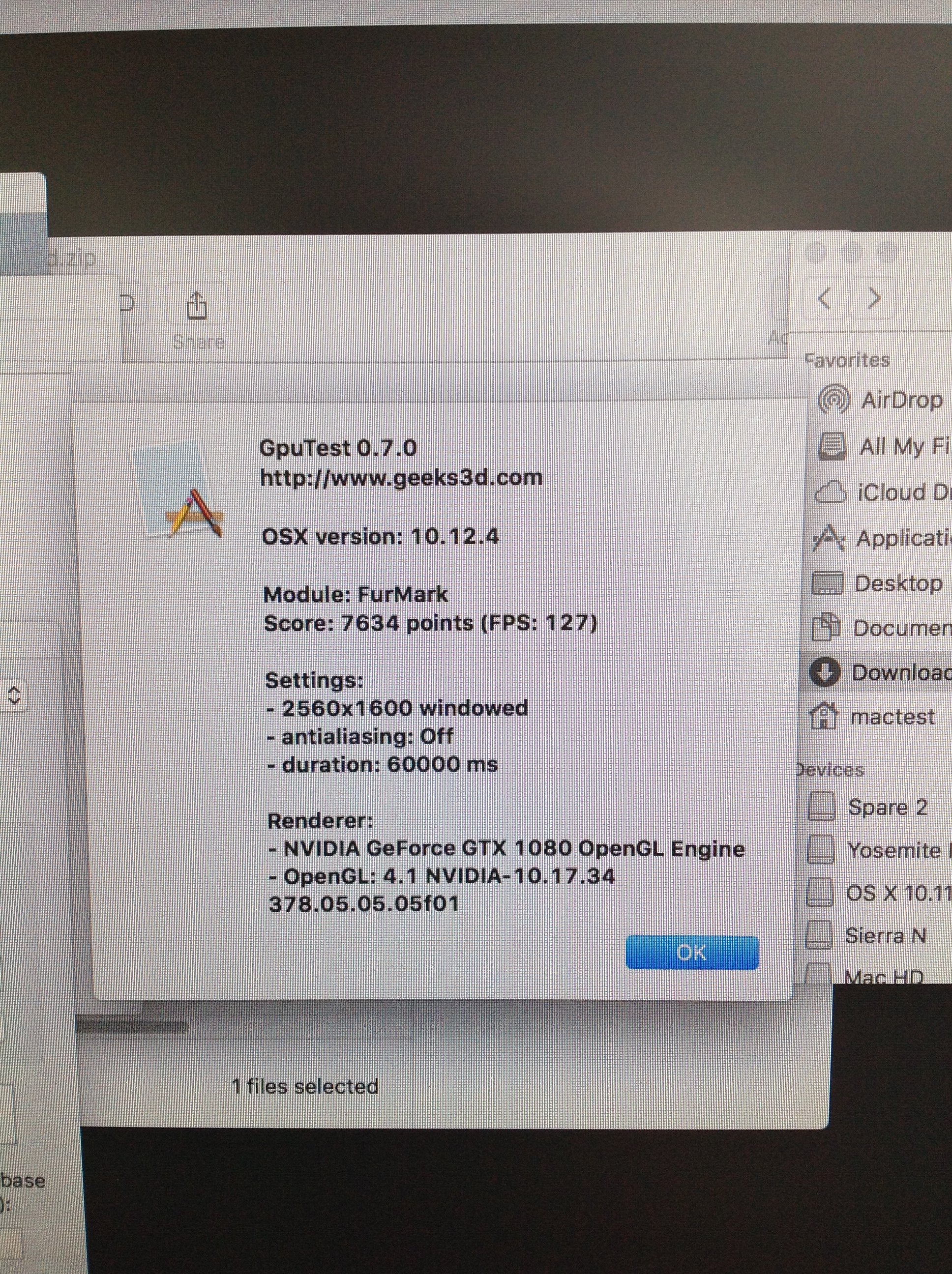

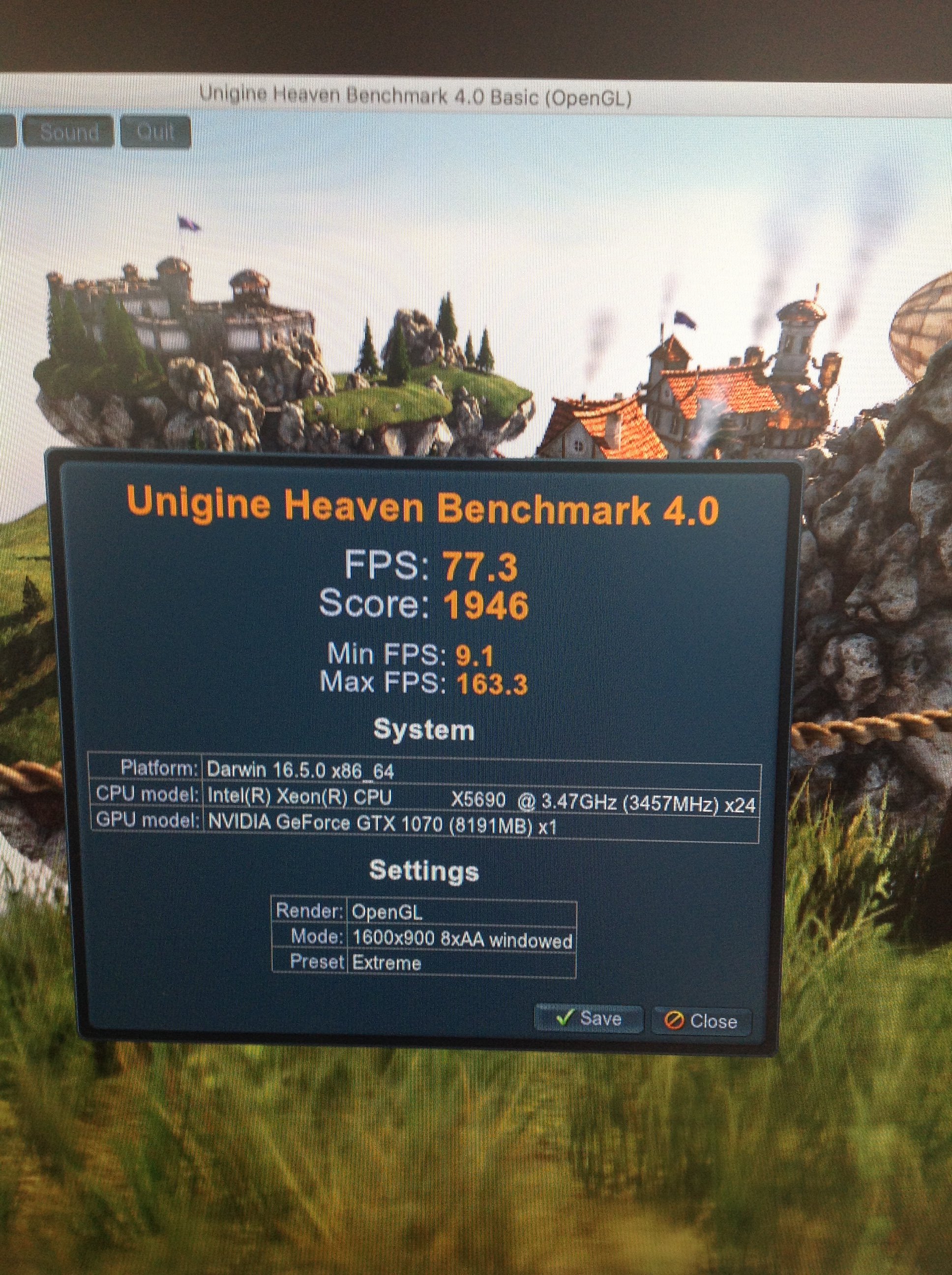

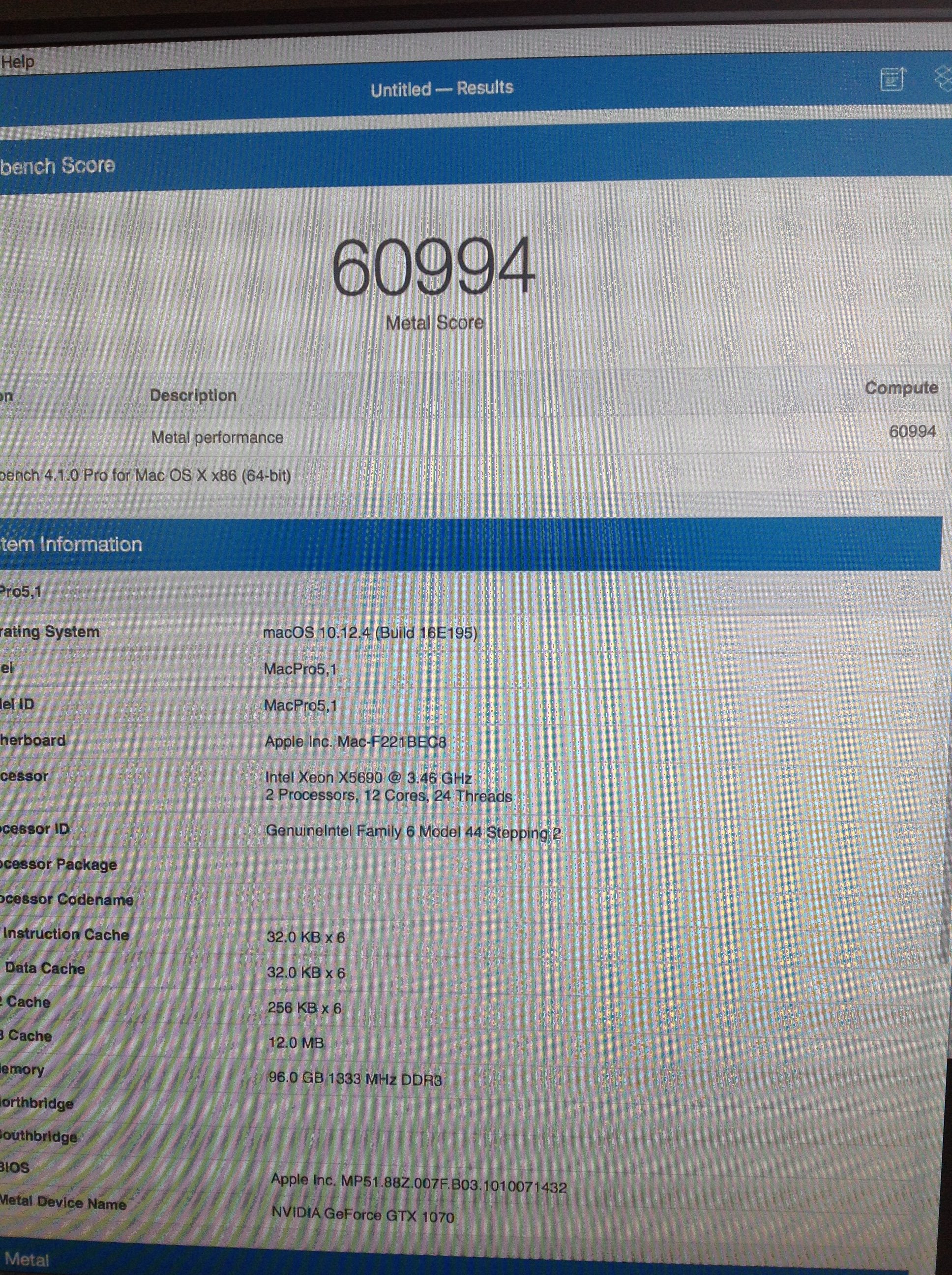

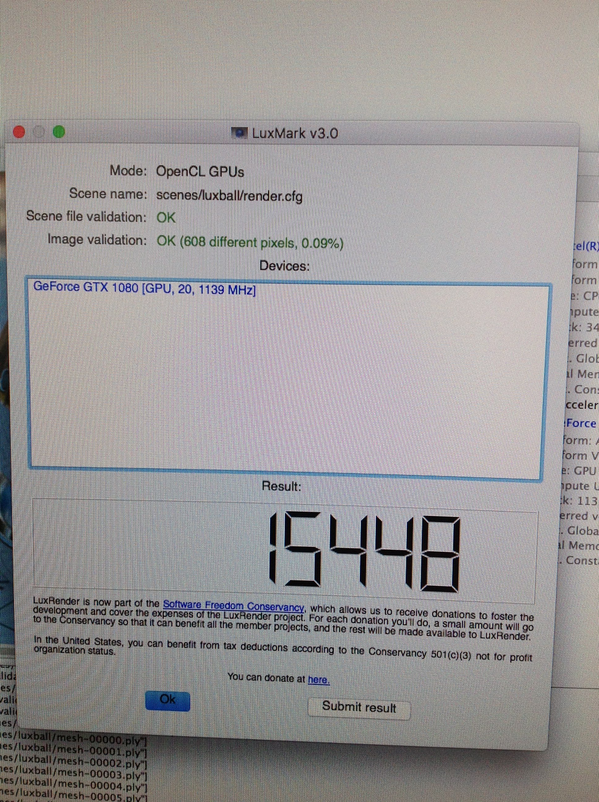

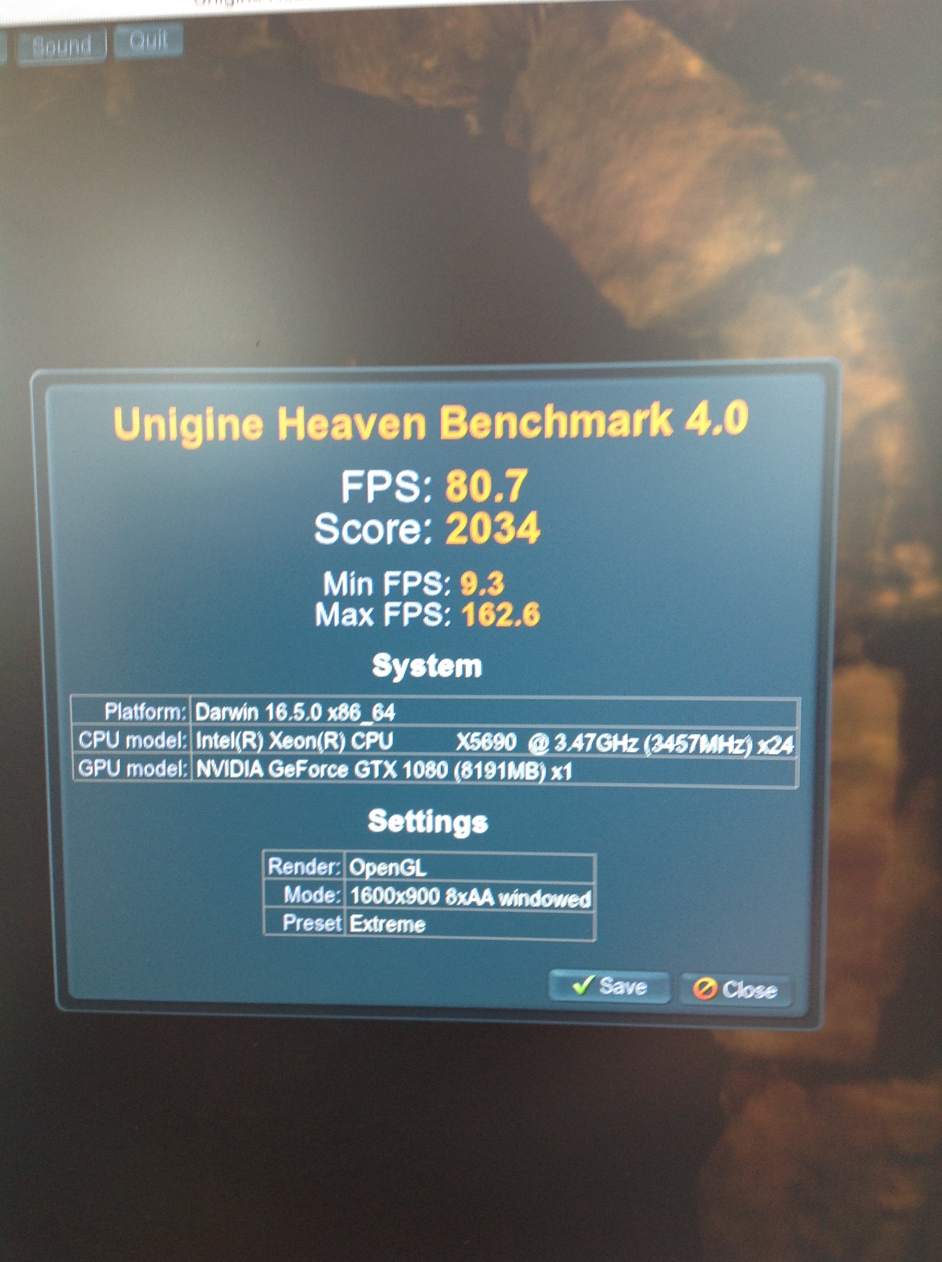

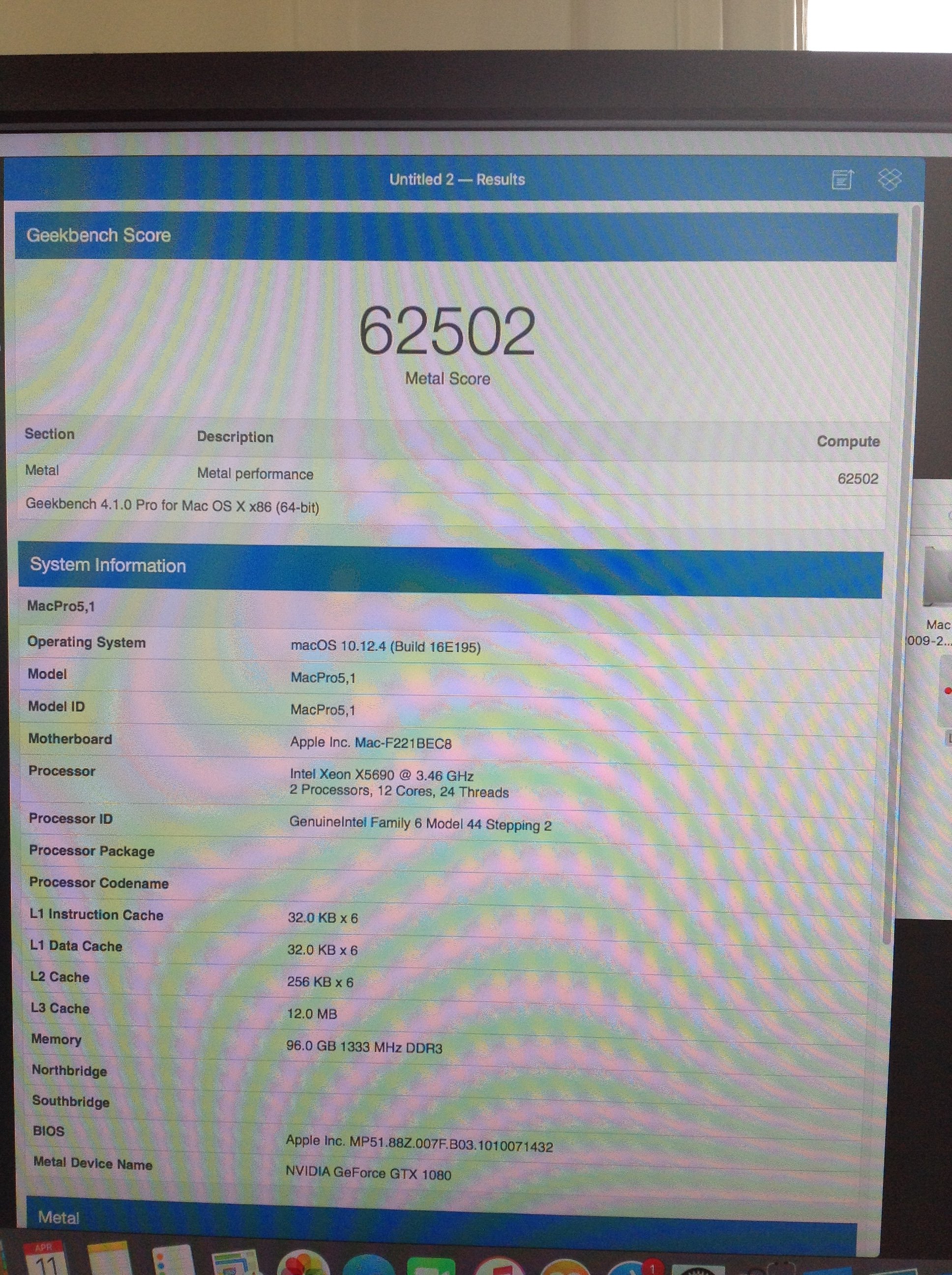

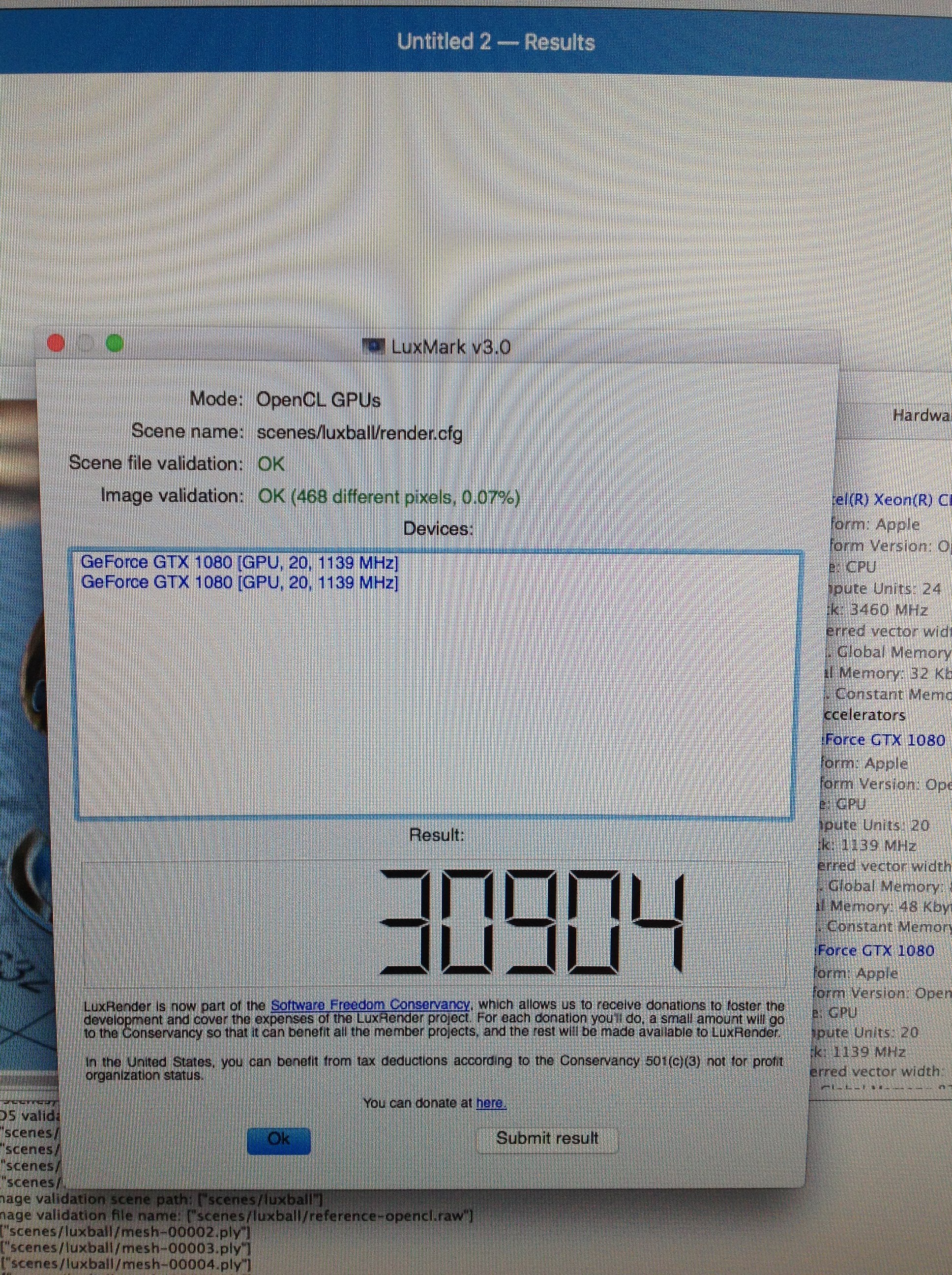

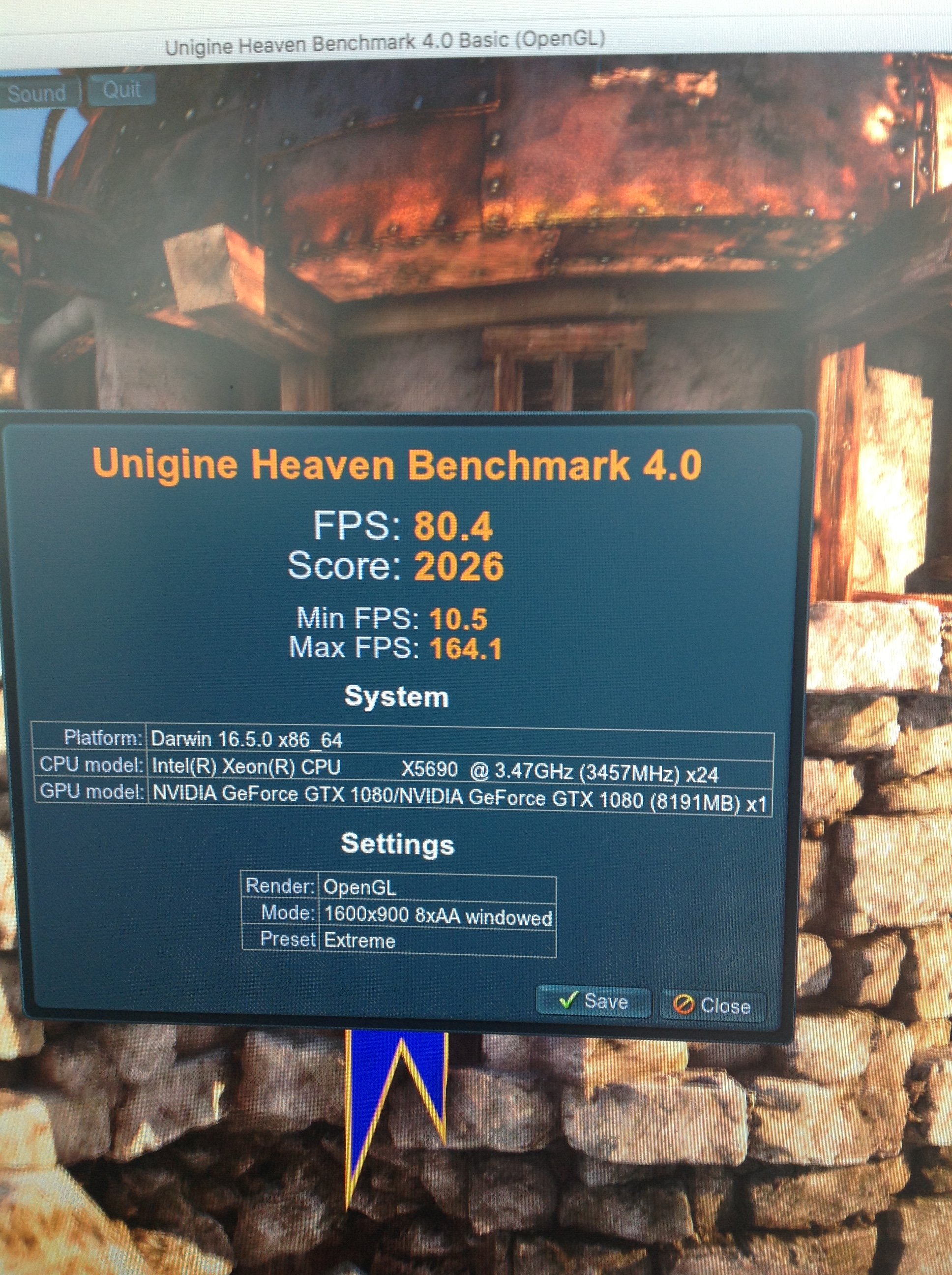

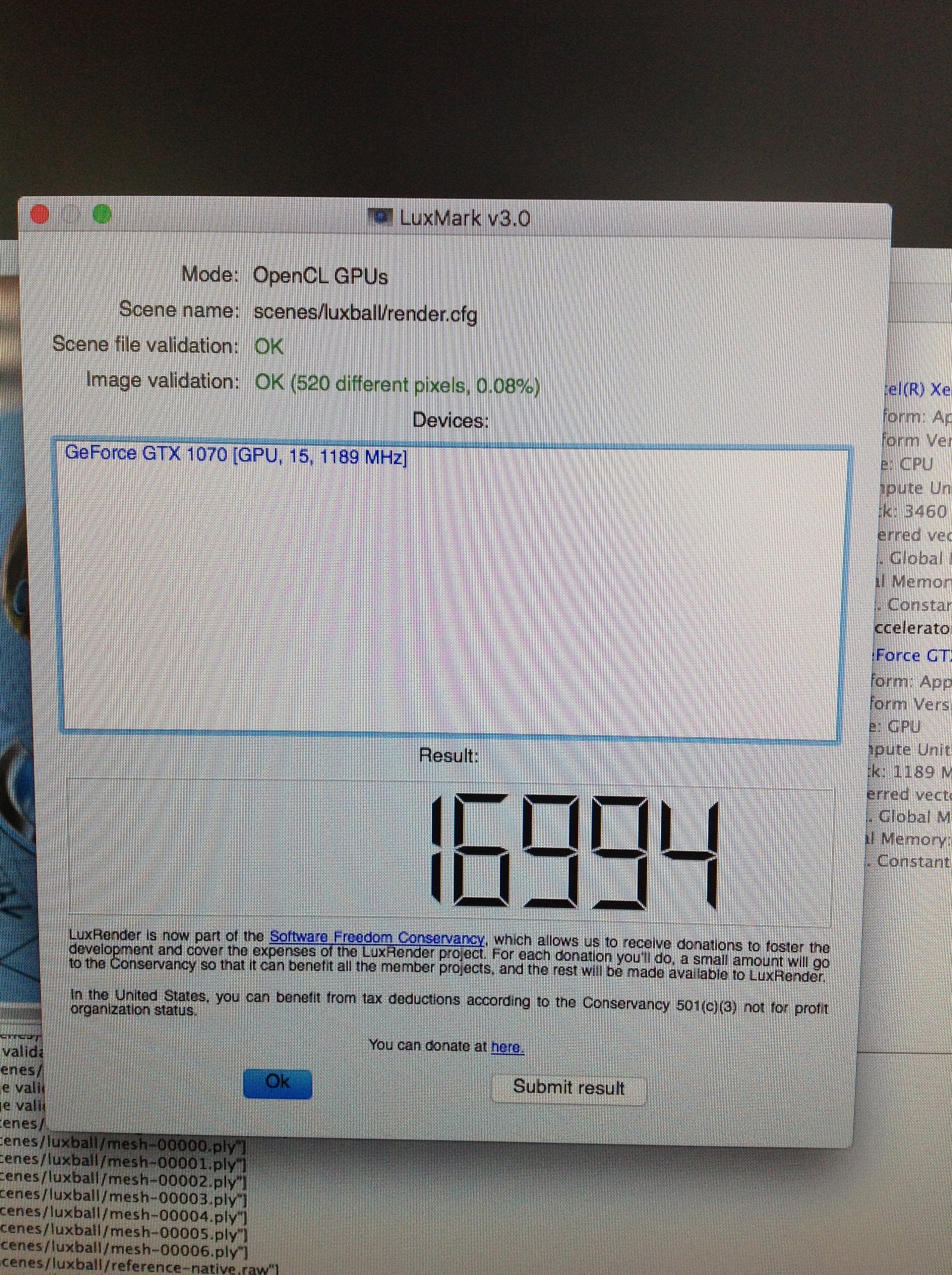

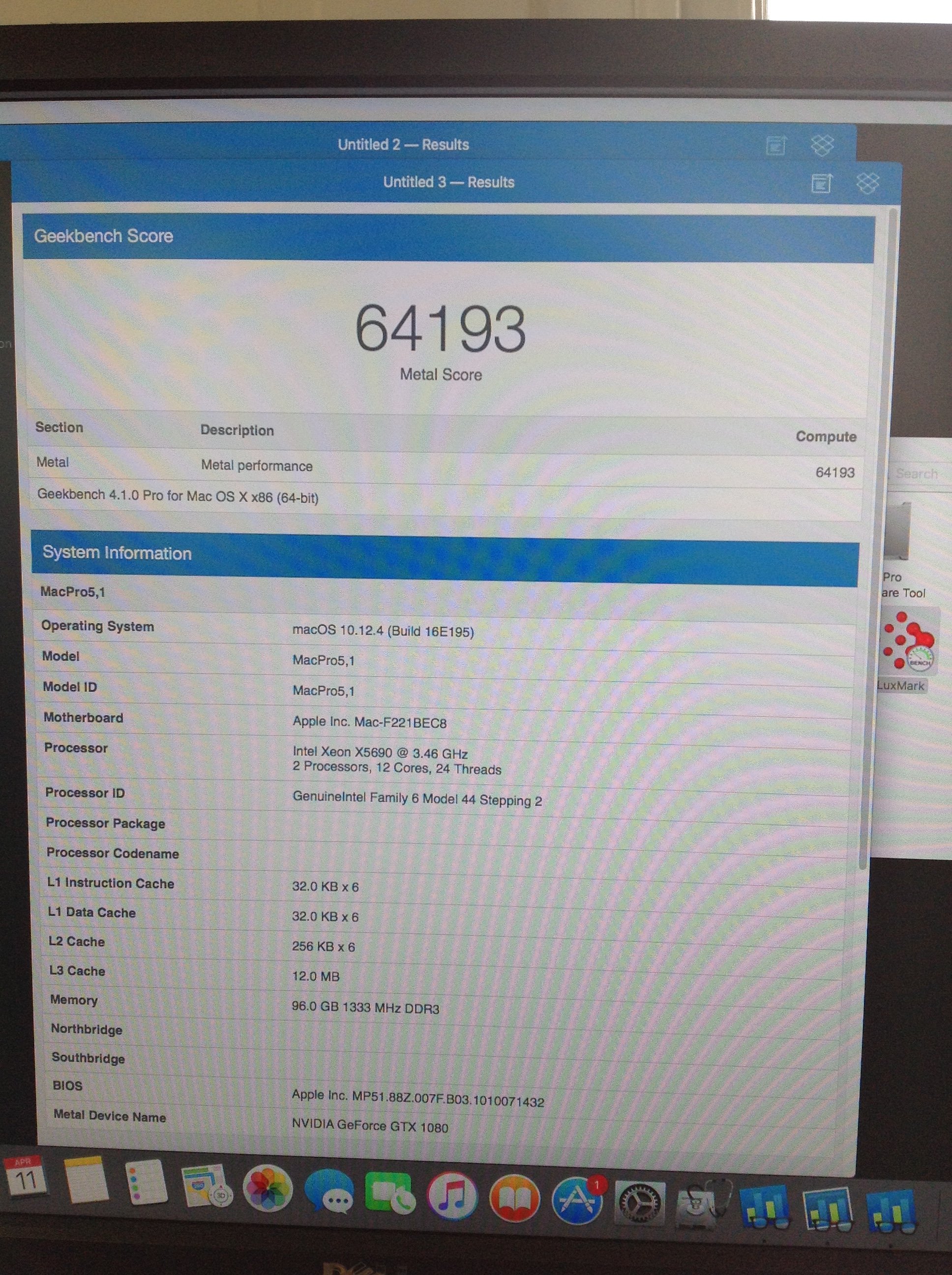

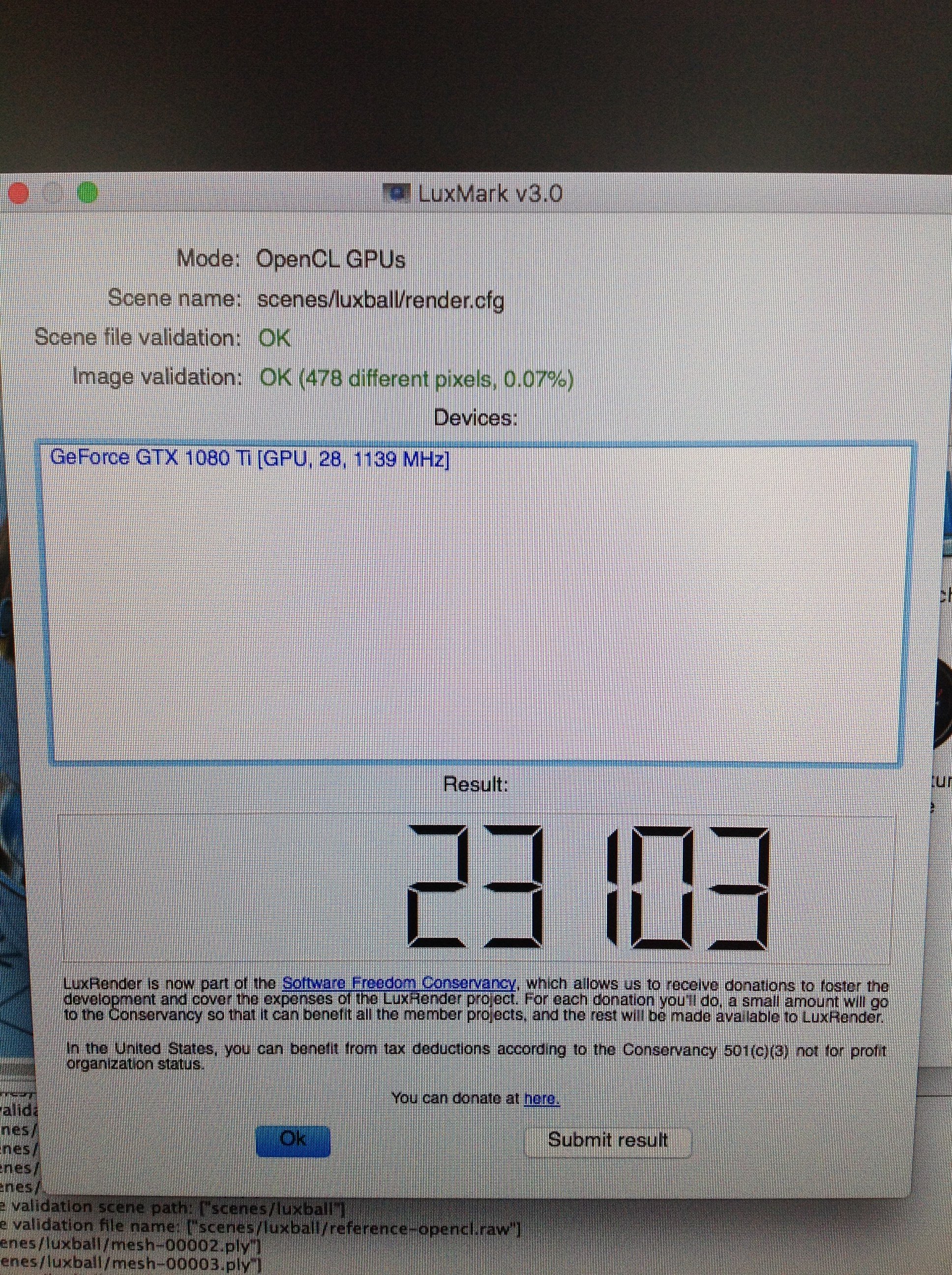

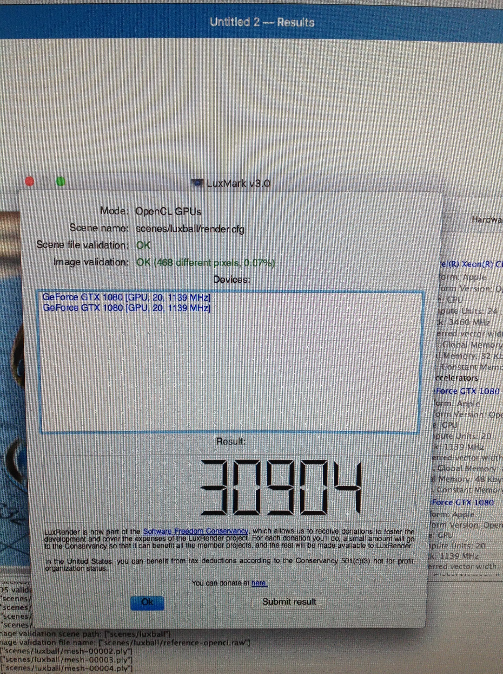

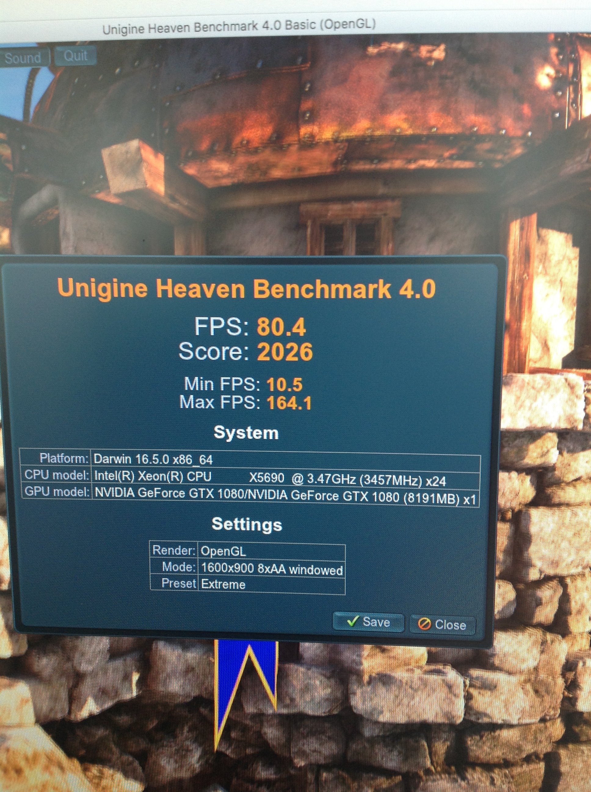

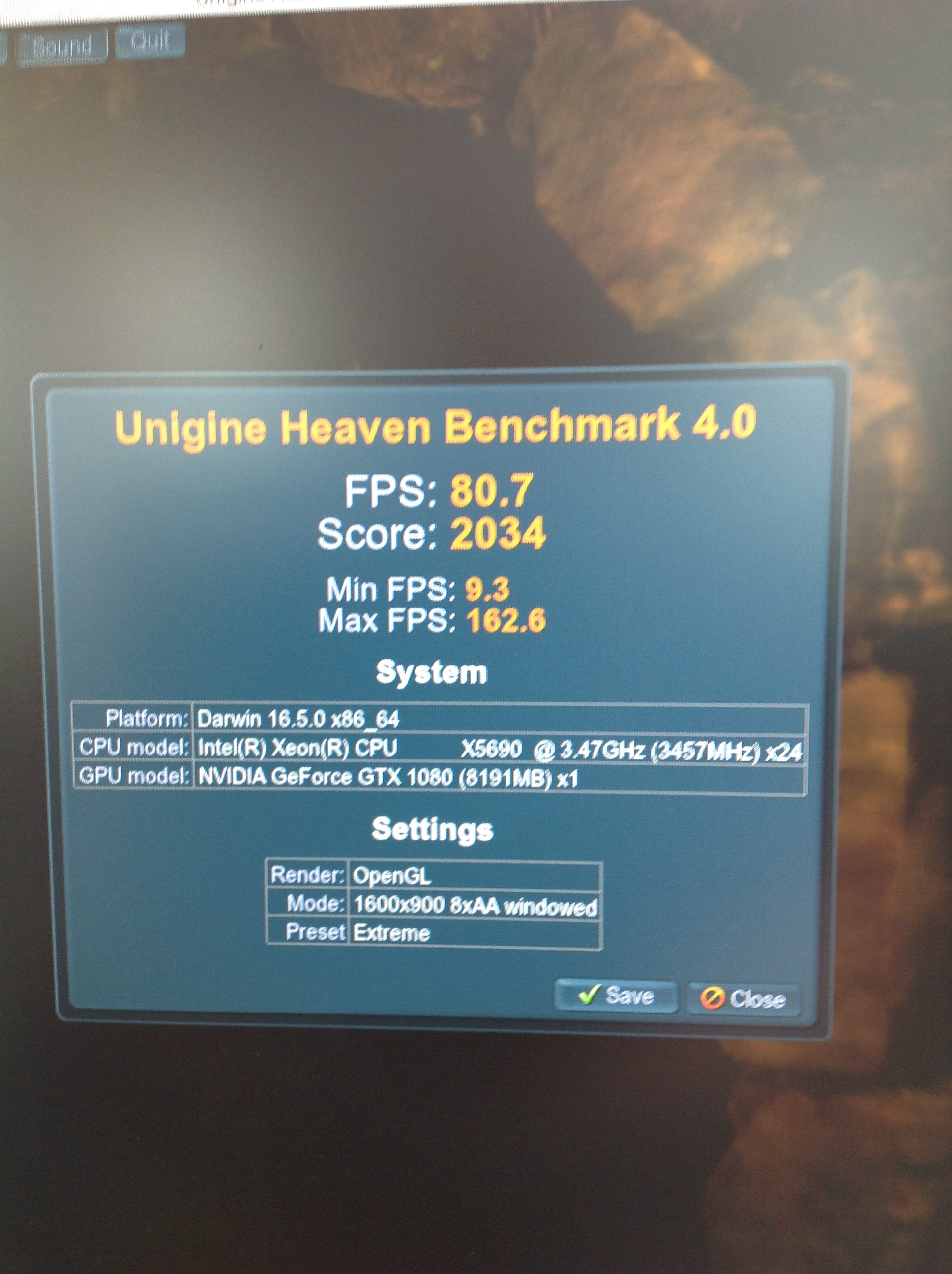

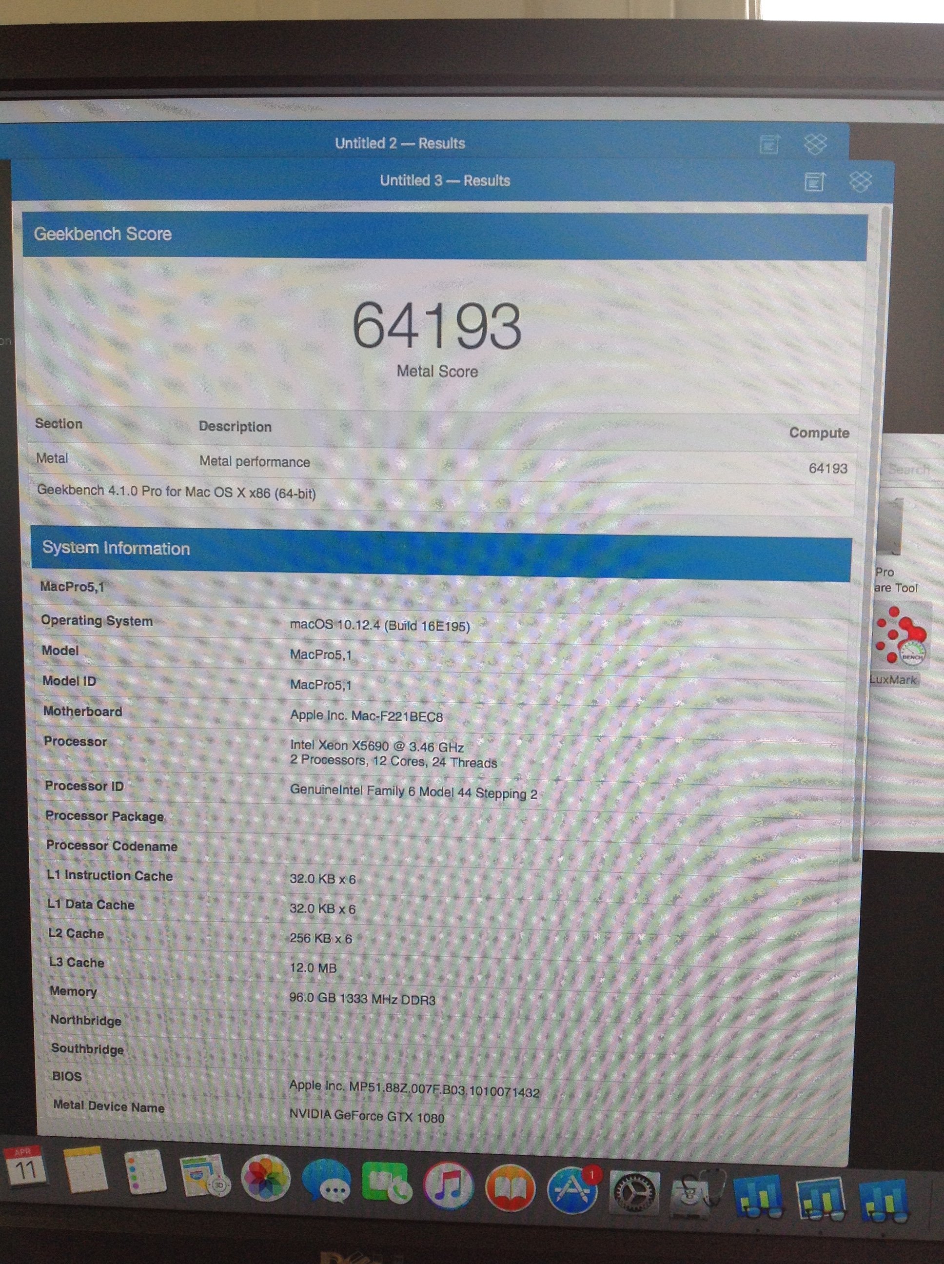

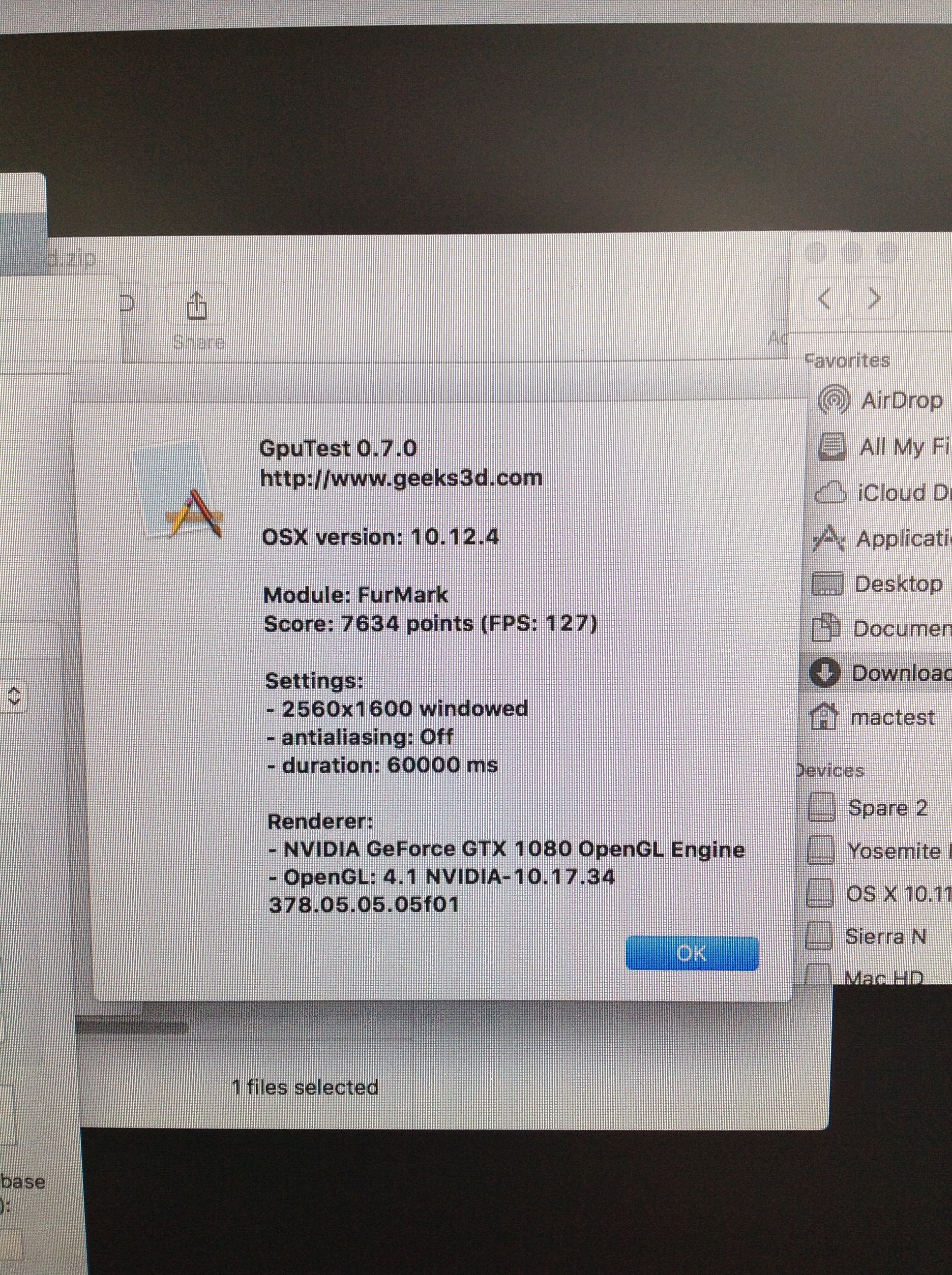

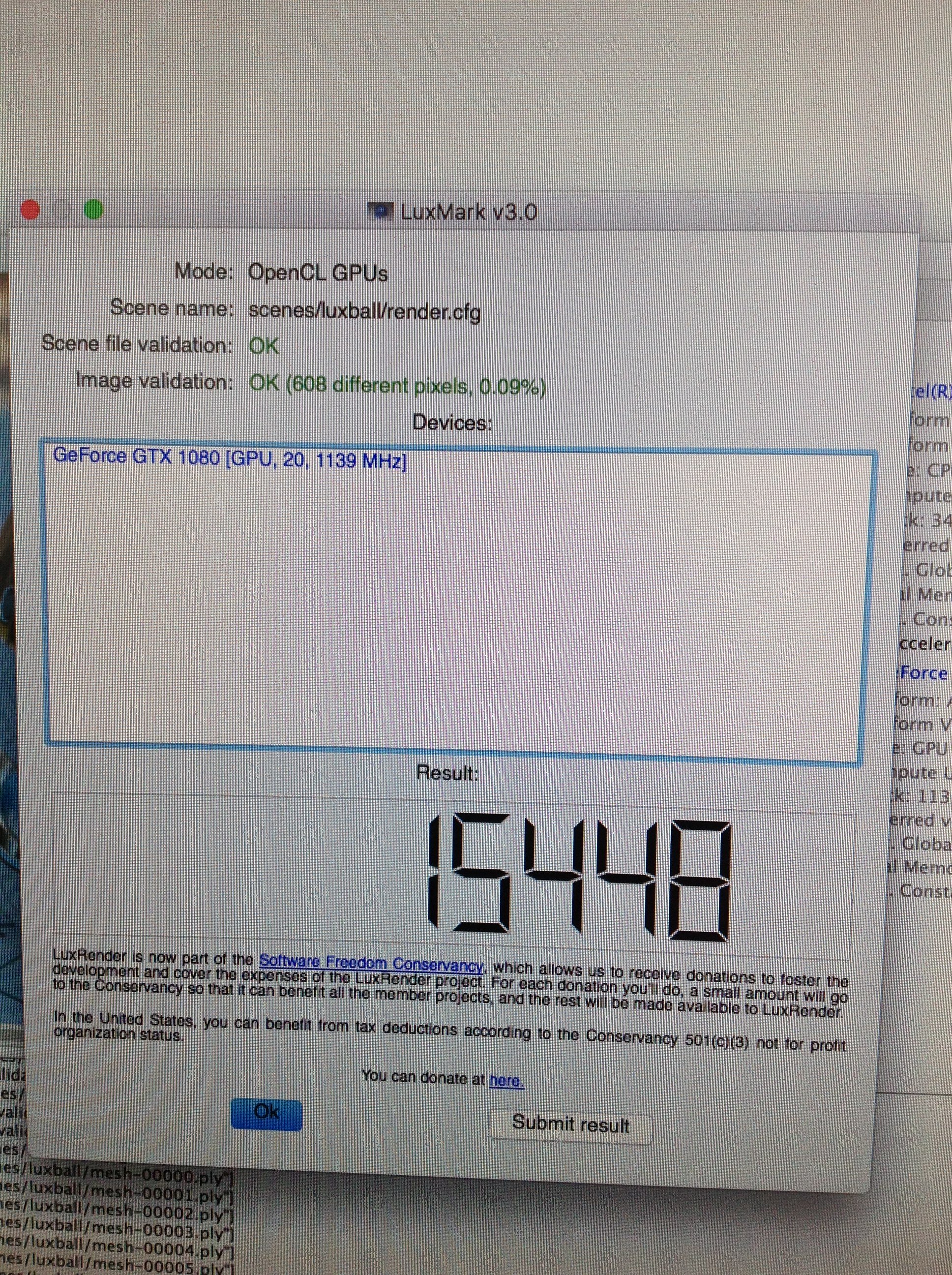

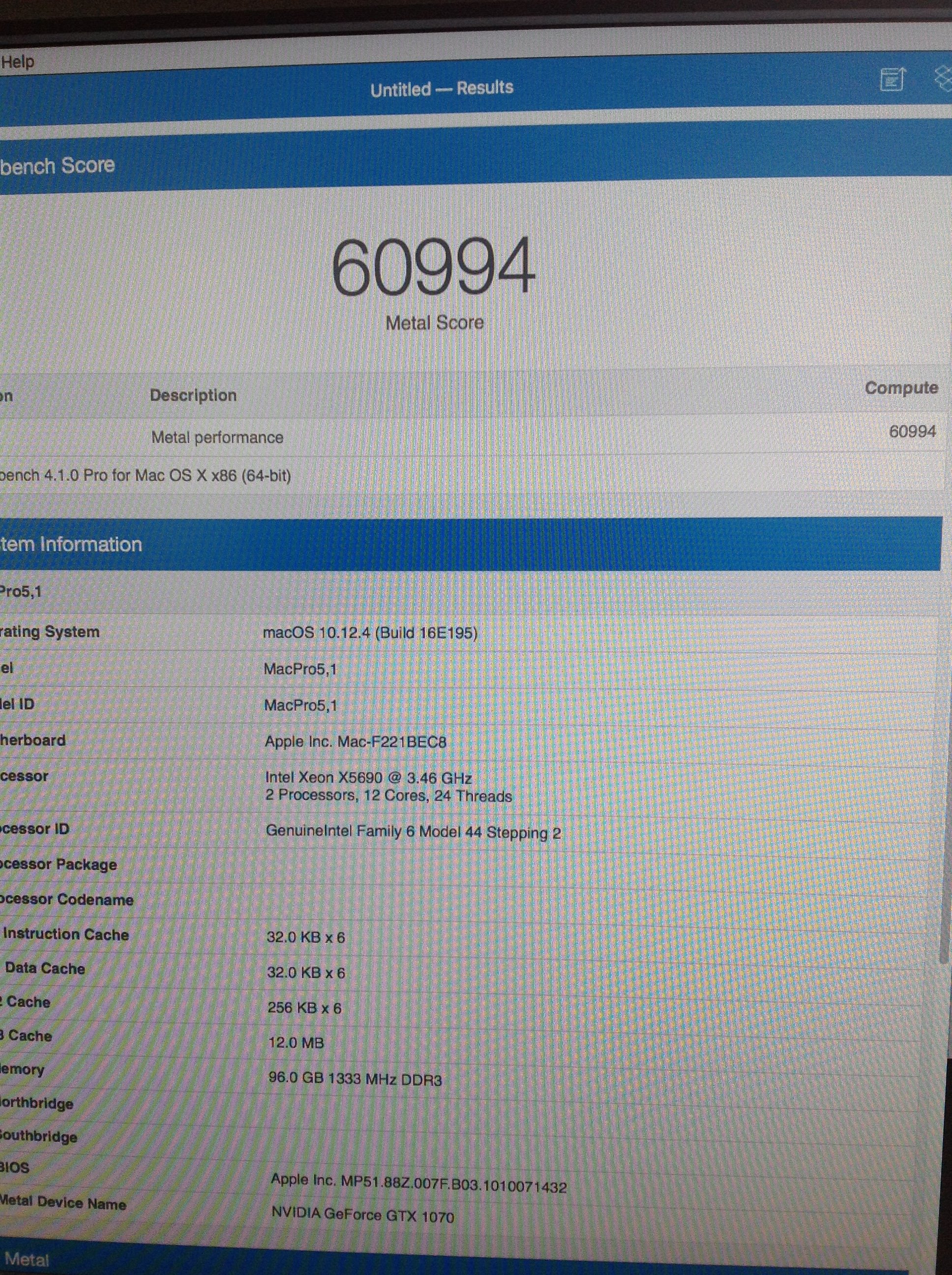

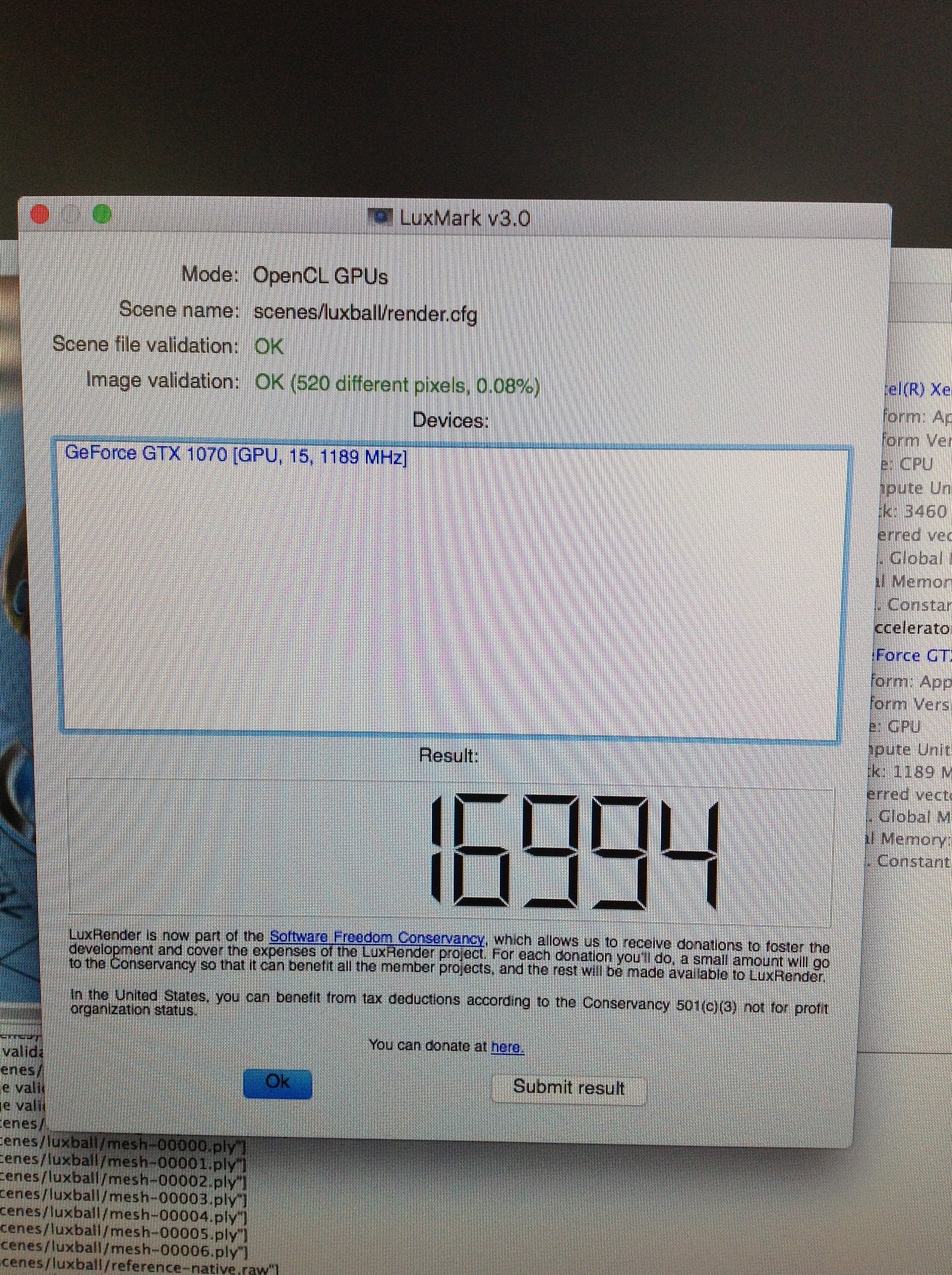

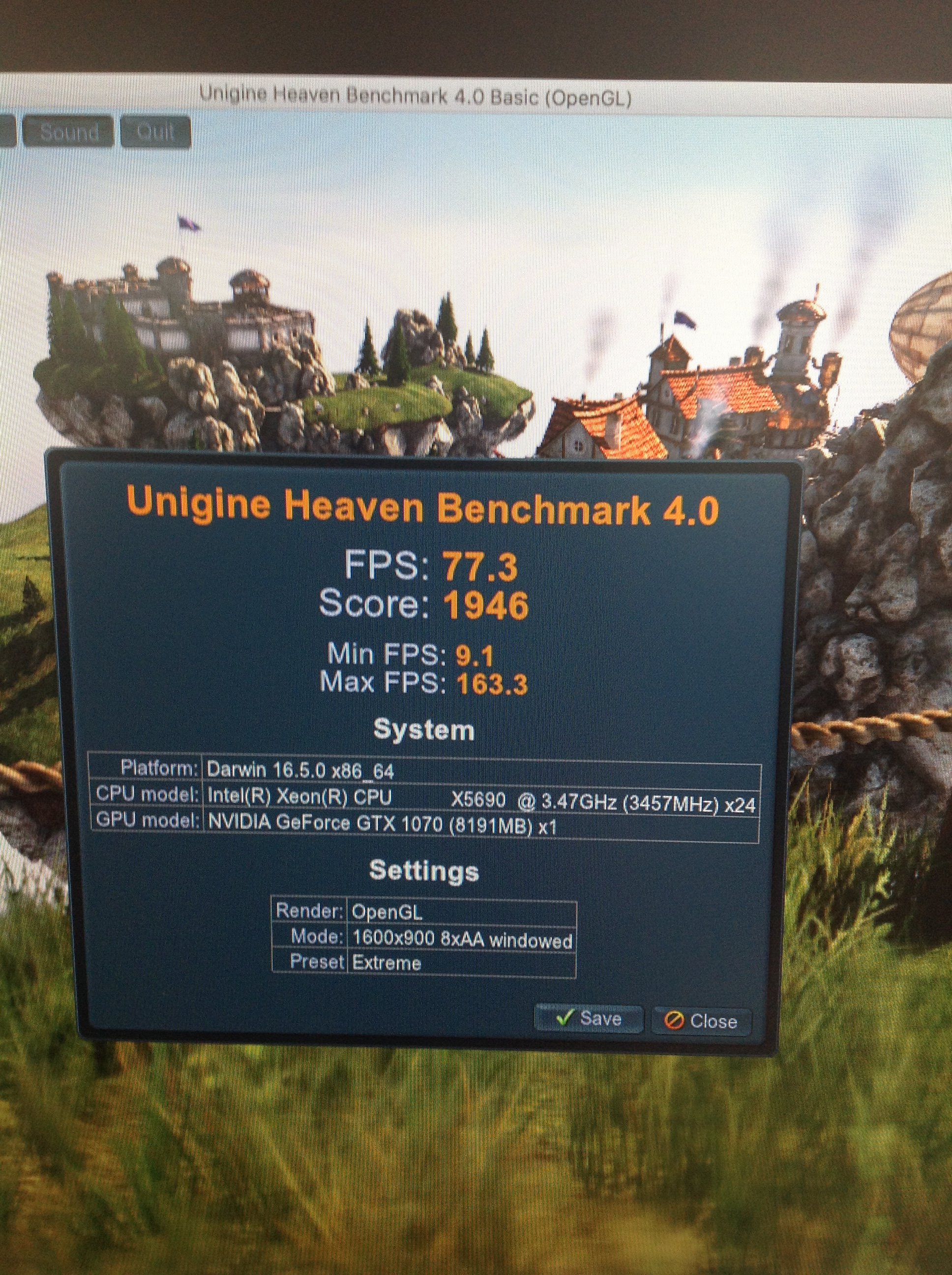

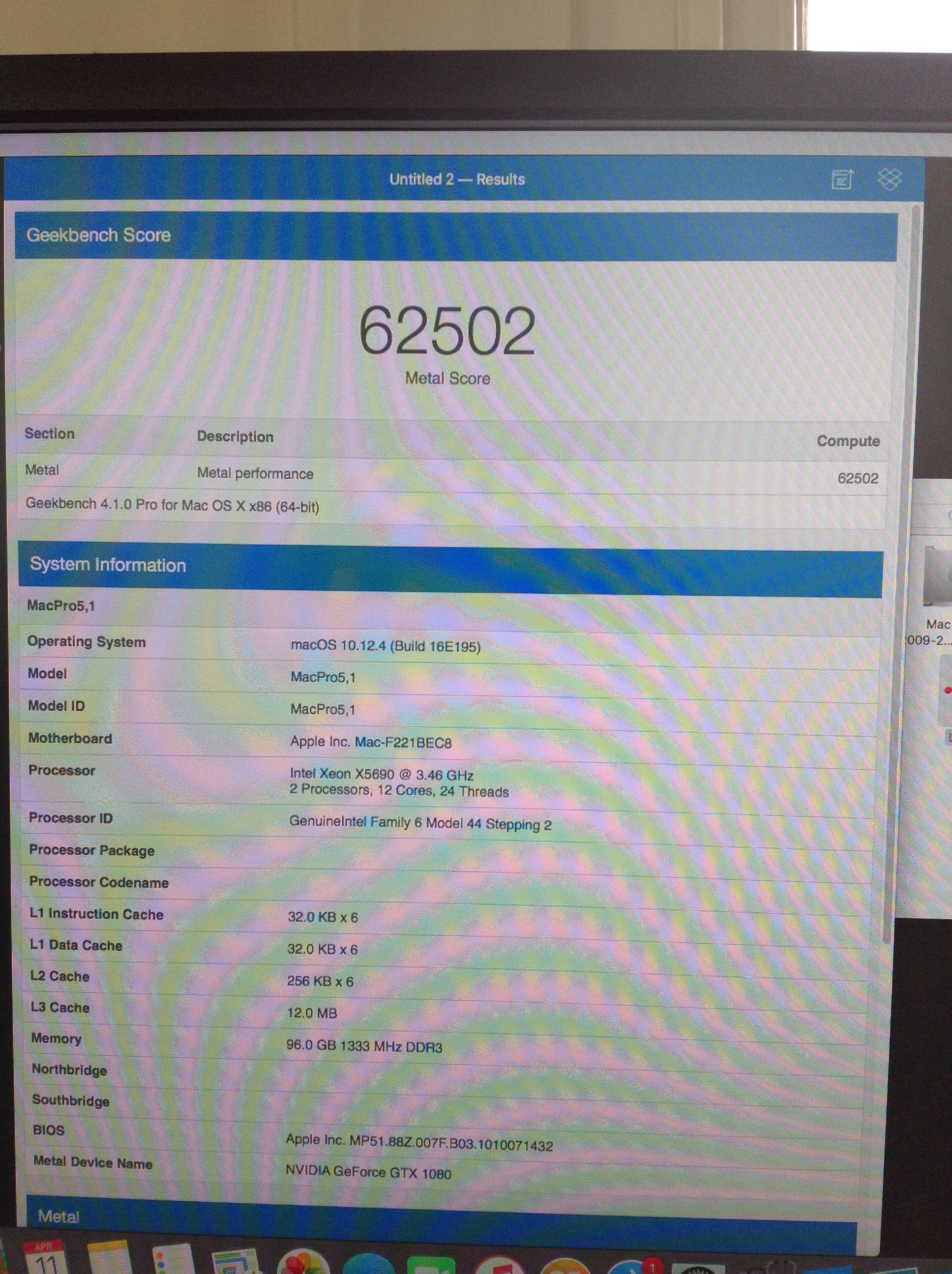

Ok, I have results for 1 x 1080, 1 x 1070 and 2 x 1070
980Ti in cMP scored between 1600 - 1800 in Heaven and Titan X (Maxwell) scored around 18000 in Heaven. So there is a performance increase from Maxwell to Pascal in the cMP. In your Hackintosh machines with i7's it may be different but in my 3.46GHz 12C setup Pascal is better. Once they release the CUDA driver performance in Pro Apps I would also expect to be an improvement.
The other bit of good news is you can easily install 2 1070 or 1080's off internal power (I now await many messages saying this isn't safe as each GPU requires 1 x 8pin). As you can see in the LuxMark test 2 x 1070's score over 30000. The nMP with dual D700's scores just over 20000 in LuxMark.
I'm receiving an eGPU rig in the next week I'm looking forward to running these tests with the 2.7GHz 12C nMP to see what improvements I get in GPU performance.
There is a performance gain for Pascal over Maxwell. At the moment it looks like the 1080 is the best card to choose but if the driver can be improved or you need more VRAM maybe Ti and Titan Xp would be an option.

C'mon guys, are you really running Unigine Heaven at 1600x900??? This is going to be absolutely 100% CPU limited on macOS. Why don't you try running it at 4K, or even 2560x1600 or something. This might give the GPU a chance to stretch its legs despite being limited by Apple's terrible OpenGL framework design. Or, focus on Metal benchmarks since those should run much, much better due to the low overhead nature of the API.
i think we need some mac with TB3 like the macbook pro 2016 to run these test...i think the bandwidth limitation for TB2 is 16 gbps instead of 32
Reactions: Crosscreek
I read more about the bottleneck issue. Now I understand. Your are right sir. All cards are bottlenecked somehow. If I'm correct, all that matters is full potential of the gpu (saturation of the pcie for pro apps) and stable 60fps in games. More demanding games or applications will use more potential of the card that is available. High, 200+ fps only matters on high frequency monitors. So I'm gonna buy 1080ti, it will be the most future proof gpu.
Right, this is why my FAQ says "do not use Cinebench as a GPU benchmark". At some point, the CPU simply cannot keep up with the GPU. This happens very quickly when you have a slow CPU (e.g. in the cMP) or a very, very fast GPU (e.g. a high-end Pascal card). If you were to run Unigine Heaven/Valley at 4K resolution, the GPU would have a ton more work to do (since it's rendering more than 5x the number of pixels compared with 16x9). You'd be able to very clearly see that the GPU is mostly idle if you ran the OpenGL Driver Monitor and enabled the "GPU Core Utilization" stat in Linear display mode while running a CPU-limited benchmark like low-res Unigine or Cinebench.
Yep, that's it. 4k vs 1080p should clearly show that even on cMP I would get stable 60fps and CUDA will saturate all my PCIe bandwidth. I don't need 200+ fps, so I will be happy to have stable 60fps on 1080p for many years and 4k in the future. All that matters is performance in Octane for me. I just wanted to check really if the 1080ti would hit bottleneck in LuxMark or Octane, so performance would be the same as 980ti, so it will be more optimal to buy 980ti for less.

You need 2 monitors, each attach to one of the GPU, and run two Furmark (at the same time), each on one screen. Otherwise, only one card will be stressed, but not both at the same time. Also, Furmark will warm up the card slowly. And the card will draw more power once warmed up. So, for stability test, you need to run Furmark x2, and keep them run at full screen (on both screen), for at least 15 min to reach the stabilised point in order to determine if the setup is stable enough.
