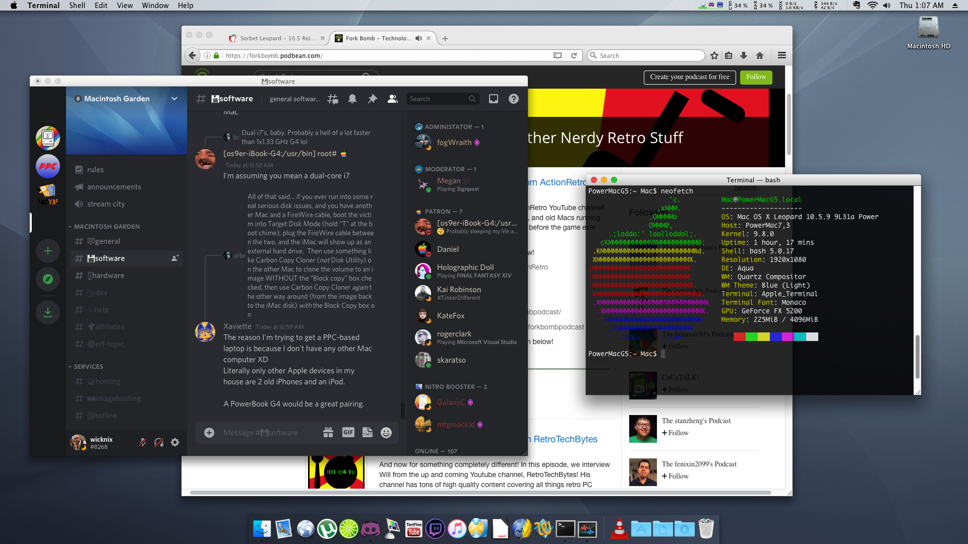

Installed @z970 's Sorbet on the dual 2ghz G5 and loaded it up with some goodies like @Dronecatcher 's VLSEE. Now listening to @pipetogrep 's podcast via InterWebPPC, and catching up on discord chat logs via DiscordPPC. Sometimes it's actually fun to start fresh without using backups. :)

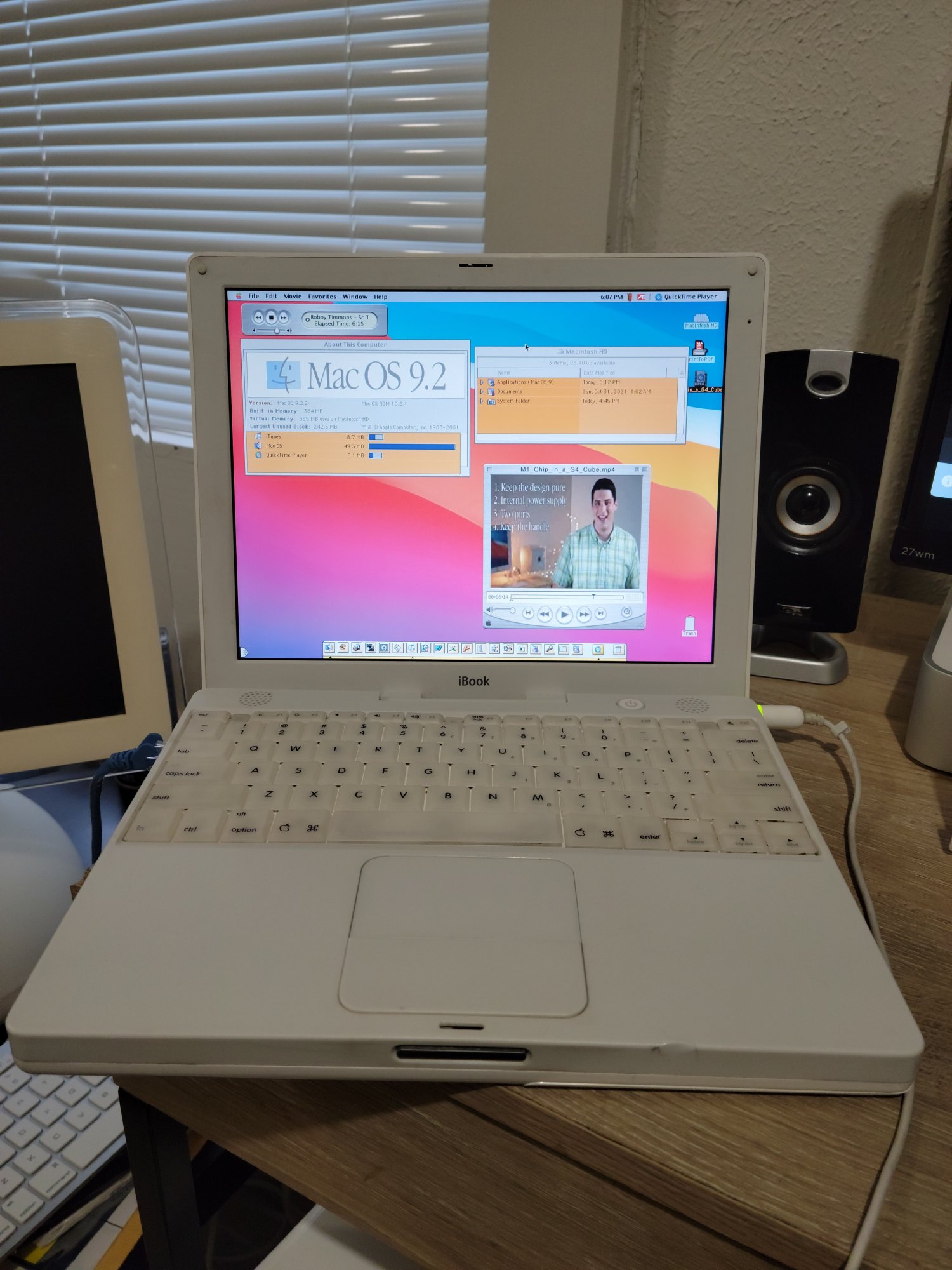

Cleaned up and brought my iBook G3 800mhz back with a new working keyboard; one that doesn't smell like dirty socks, albeit slightly yellowed. I should have snapped a photo of the mold-encrusted original keyboard before trashing it. Oops. Someday, I'll take it apart and clean the seams of the dirt and (likely) mold. Listening to some jazz radio in iTunes at the moment (downloaded the .pls)...
