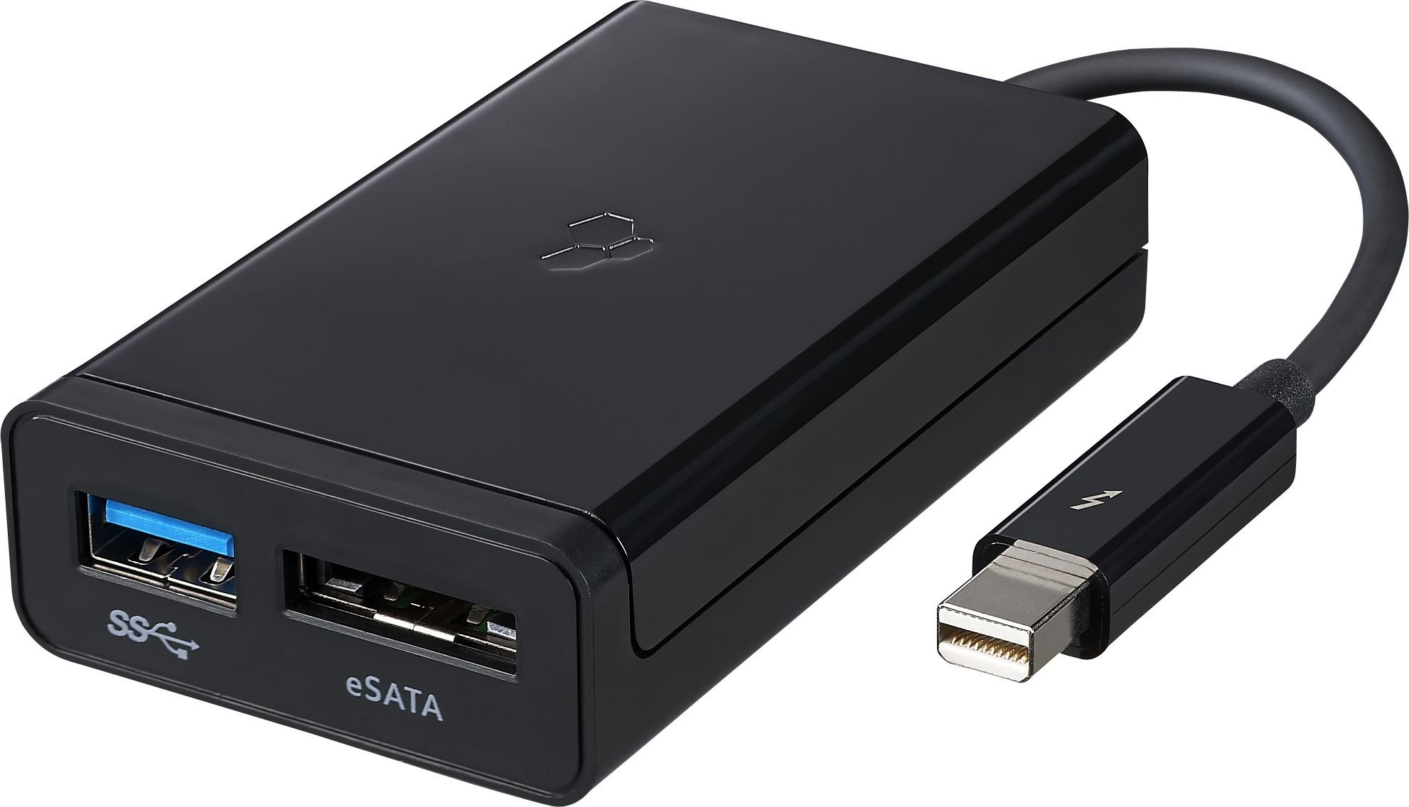

I have the Kanex KTU10 adapter for USB3.0 which works really nice with the iMac 2011
Yes, I am sure it did. I had mine under the display on the table and it was always in the way so attaching it to the case would have been much better solution, but I didn't thought of it. So, I was not belittling his hub -install but offered what I had done when I upgraded to 2011, which has the TB2, as an option worth considering. I realize the dock is more expensive solution, even 2nd hand than a simple USB-hub, but in my experience offers major advantages. When I referred to "internal USB3" I meant this: USB3 to 2011 iMac.

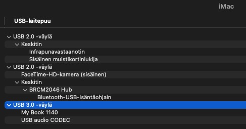

How much your USB-buses can provide current? Open About this mac, more info and USB and you will find the output specs in mA.
So, I hope that cleared things up.
BTW. I just noticed that the iMac sees the Elgato TB2 Dock - USB3 -connections as an actual USB3.0 bus.

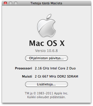

BTW. Snow Leopard is now installed and running. Nice thing is that the iTunes internet-radio still works as is. And the internal speakers on this model are surprisingly loud. :cool:
After installing the SL it all came back to me when I saw the version number 10.6.8. I used SL in my work late 2009 iMac 27" as I had old Adobe software versions until I finally upgraded to High Sierra. So, I skipped Lion and ML altogether.
Reactions: DCBassman
Wow, now the iMac suggested EFI BootROM upgrade. I've only ever done it to my Mac Pro 5,1. Well, ok lets go for it! And now its upgraded from IM51.0090.B08 to IM51.0090.B09. The specs said something about performance and reliability improvements and Boot Camp bug fixes. Well, lets see... ;)
I guess there is no spotify-client that would work in SL anymore? Any workarounds? I remember there was a site which allowed you to play spotify lists throught browser but cannot remember what it was.

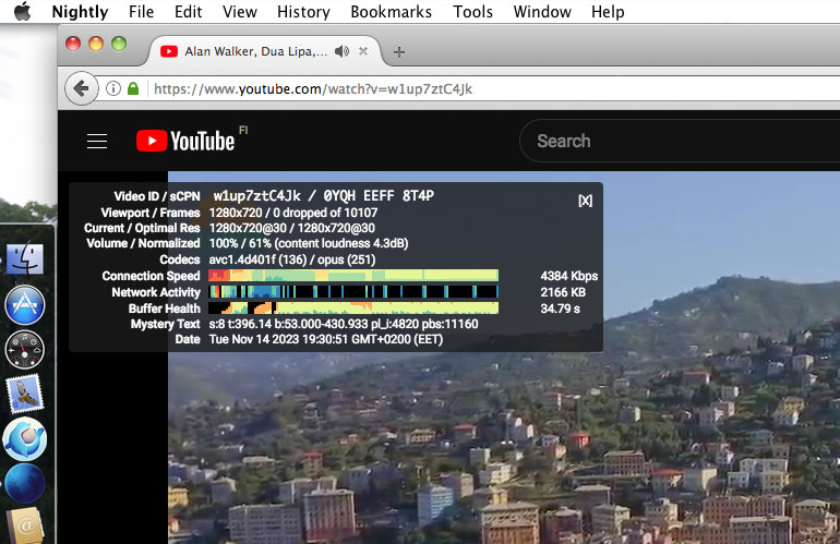

BTW. using Firefox Nightly it runs videos on YT and chooses automatically 720P. And wow, zero dropped frames! I tried 1080P but its too choppy. This over Wifi.
I was sure I had 2x2GB DDR2 in my boxes but I didn't. Only 1GB sticks. So, I now have 2GB RAM. I did find 2GB sticks from our local classifieds site and bought 2 of those for 5€. So, now I get to upgrade to max 3GB and leave the other 2GB stick for later use.

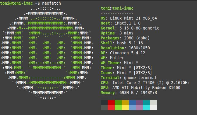

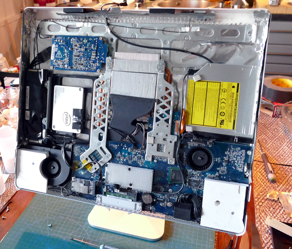

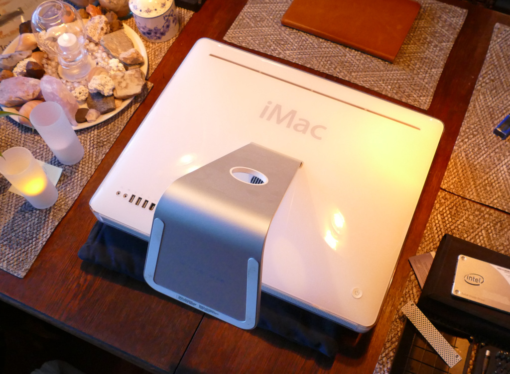

Today I installed a 240GB Intel SSD into the L2006 iMac. I must say this is one of the most annoying machines to open this far! It took me an hour to get the front bezel top latches to unlatch. They are super flimsy thin metal and bend everywhere but to the correct direction. And then the screen itself is glued with metal shielding tape all over to the frame, and the screws are recessed very deep. Argh!! 🤬
Well, finally got it all out and swapped the drives and wrestled the shielding back. I yesterday cloned the MacOS from the spinner to the SSD so it was just a matter of resetting PRAM and all was good. I also partitioned the SSD for Linux -installation prior to installation.
I then first installed Lubuntu but for some reason I could not get it to boot, even with rEFInd. It found the Linux but could not boot ("no bootable drive found"). Then installed Mint, reformatted the Linux main partition and the installation went smoothly like it usually does with Mint. But, wifi was not automatically detected. Installed drivers and now it works too.

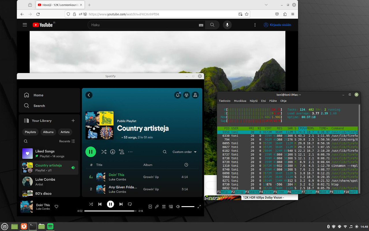

So, its Snow Leopard + Linux Mint 21 dual boot thingie now. Aaaand...Spotify is now installed and running on Linux side! :cool: I guess I'll use this one as a streamer of some kind at this stage.
