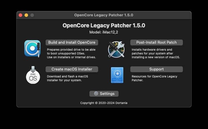

Speaking of OCLP, I updated Ventura on my 13" 2012 MBP and that was a terrible decision because the display settings appear to have been corrupted as a result.
Does OCLP have an option to reapply patches? If so, I’d try this with anything related to graphics. Did you update OCLP (if possible) before updating Ventura?

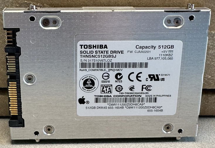

Continuing with the Apple OEM SSD story, 2012 had SanDisk join the game. All examples I've seen share the F1 prefix.

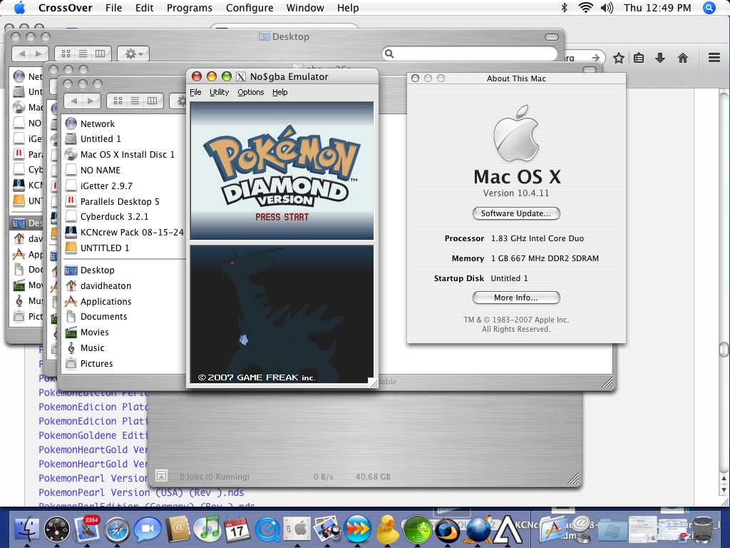

got Pokemon diamond running under Crossover 9 on a 1.83ghz mini running tiger with No$GBA runs at full speed unlike desmume heck on a 2002 optiplex gx 260 with a 2.26ghz P4 it was playble wish there was a ppc port
This is a good point - I didn't check and really should have. That's a lesson for the future.
Another good point. I completely forgot about checking that - which is something that I would've done with the DosDude patchers.
Yes, it's right on the OCLP control panel. The button says "Post install root patch". You are supposed to reinstall the patches after updating the OS as the OS installer overwrites any patches that were previously installed.

The frame tearing and sluggishness returned so I had a look at the options.
After rebooting the frame tearing and other visual problems were resolved. There's a niggle with the patcher displaying this message on reboots:
No matter how many times I update the bootloader and select the USB installer's EFI partition so that the update will go ahead, the message reappears. I gave up and clicked cancel. The main thing is that Ventura works properly. :)

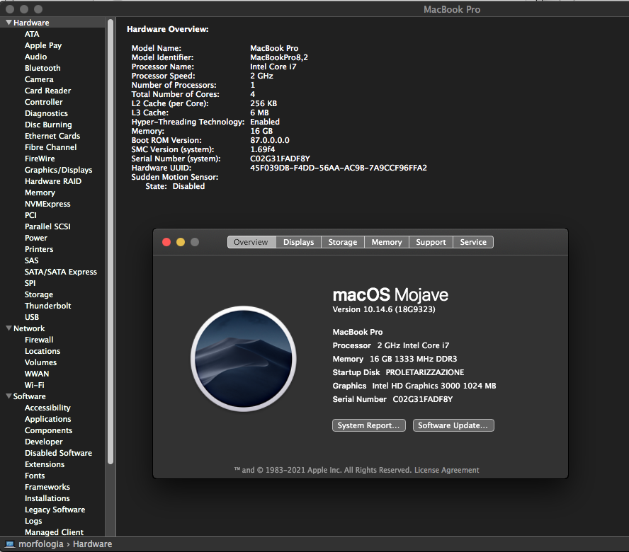

This is the operating environment I named morfologia back in 2009. (My system names aren’t perma-tied to hardware, but to the data on that hardware.) If I keep it on the A1286, this would be the fourth laptop on which morfologia has run as a long-term setup.
I’m on the fence about a permanent migration. I wanted to try out this setup for maybe a week or two and also to get a sense of any noteworthy UI differences or residual issues with the dGPU resistor removal last weekend. One I‘ve noticed is the keyboard on this unit is slightly stiffer and a tad less sensitive than my late 2011’s, but I’ve also taken note how the keys haven’t picked up that shiny sheen of heavy usage.
Without a proper carrying case for it, it’s not as portable as the 13-inch for daily use. It’s also heavier and — shocker — has a bigger footprint.
There were a couple of minor, expected adjustments to make, but it’s seeming to do OK and without untoward surprises — both when booting into Mojave (in moving the system to different hardware, dosdude1’s patcher update needed to update one patch) and when booting into my heavily modified Snow Leopard I’ve used since, well, this very day 15 years ago when 10.6.0 was about one week old and was shipping with new Macs.
Hurrah on undoing the bad patch!
I’m surprised there isn’t a prefs toggle to quiet the modal nag — particularly after the first time it’s displayed after a patching change. I could mumble something about rolling releases always insisting on being the most current revision possible and the pressure therewith, but nah. The sun is out. ☀️
Reactions: TheShortTimer
Select USB installer's EFI? 🧐 That makes only sense if you will always keep the USB stick in and that is the only EFI that is used. You should choose the internal drive's EFI and update that. And remove first that usb stick so you can be sure it boots successfully from the internal drive.

Select USB installer's EFI? 🧐 That makes only se se if you will always keep the USB stick in and that is the only EFI that is used. You should choose the internal drive's EFI and update that. And remove first that usb stick so you can be sure it boots successfully from the internal drive.
Further evidence that my brain has not been working at 100% this week. :oops:
I selected the internal SSD EFI for the update. Somehow I got confused from what I'd read online about booting from the external EFI for the update. Anyhow it's sorted. Thanks.
