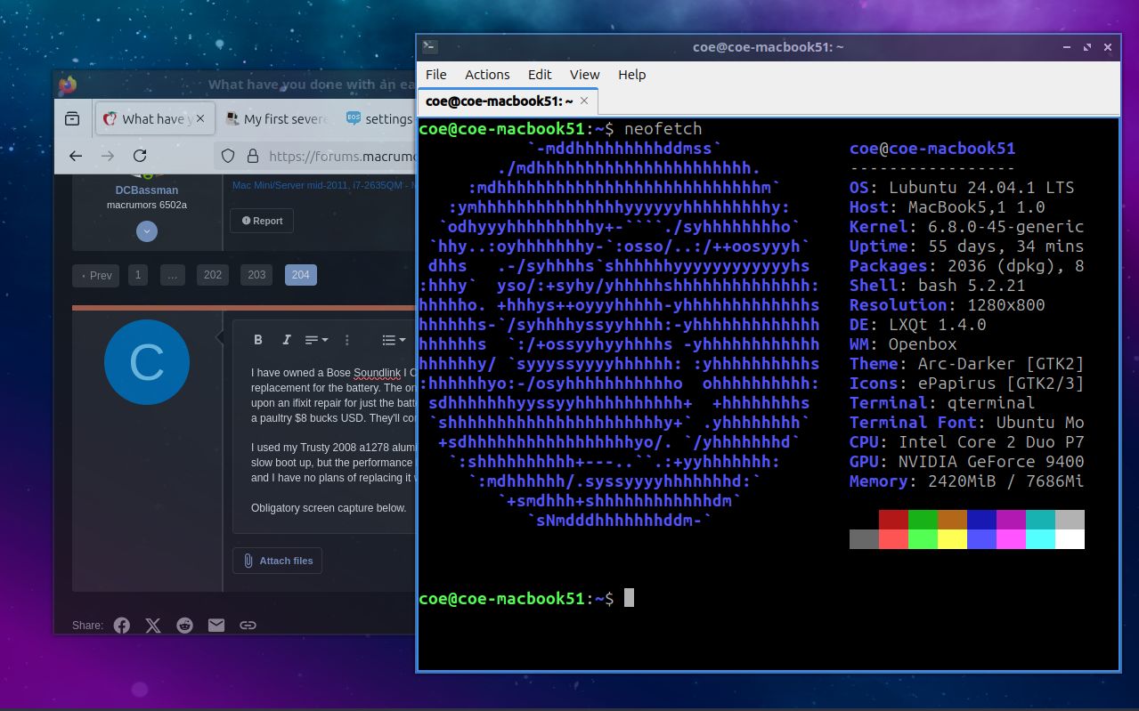

I used my Trusty 2008 a1278 aluminum unibody macbook running Lubuntu for this research. Speaking of Lubuntu, I have not figured out a fix for the slow boot up, but the performance boost Lubuntu has brought to this old mac once into its gui is excellent. It's been a few months of DDing Lubuntu on this portable and I have no plans of replacing it with anything else. It is a snappy experience with plenty of apps for all sorts of needs. It's been so nice on this macbook, that I am considering learning how to fix the installer so it is 32bit and will install onto my 1,1 cMP. That machine crushes ElCap but I think a separate partition of Lubuntu on it would rock some socks.
Obligatory screen capture below.
