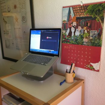

Today, when the new Win10Pro-FileServer arrived in the office, I had to decomission all my white early-intel Macs, who did a great job serving as "thin-clients" (with OSX+MS-RemoteDesktopClient) to access my WinServer2008-TerminalClientServer. 😢
Now a bunch of newer early-intels (four 24" c2duo early-2009 iMacs together with a 15" c2duo 2009 MBP) took over as fat Win10Pro workstations, but are noticably slower compared to the thin-client/RPD-approach. And I'm really gonna miss the appearance of the white iMacs ...
The 15"MBP is fixed onto an mStand using Velcro-tape to prevent it from slipping off the stand. That combination makes it a perfect standing-desk with a firm stand and also too clunky to "disappear".
Overall costs are far far below the alternative choice of 5 new-Win10Pro-Workstations plus an upgrade to a new WinServer2019-TerminalClientServer plus all the licensing. Managing the network (now FileServer/Workgroup vs. the old TerminalClientServer/domain) is a snap now - even for close-to-dummie guys like me 😀!
So that's the happy ending of this story ... 🙃

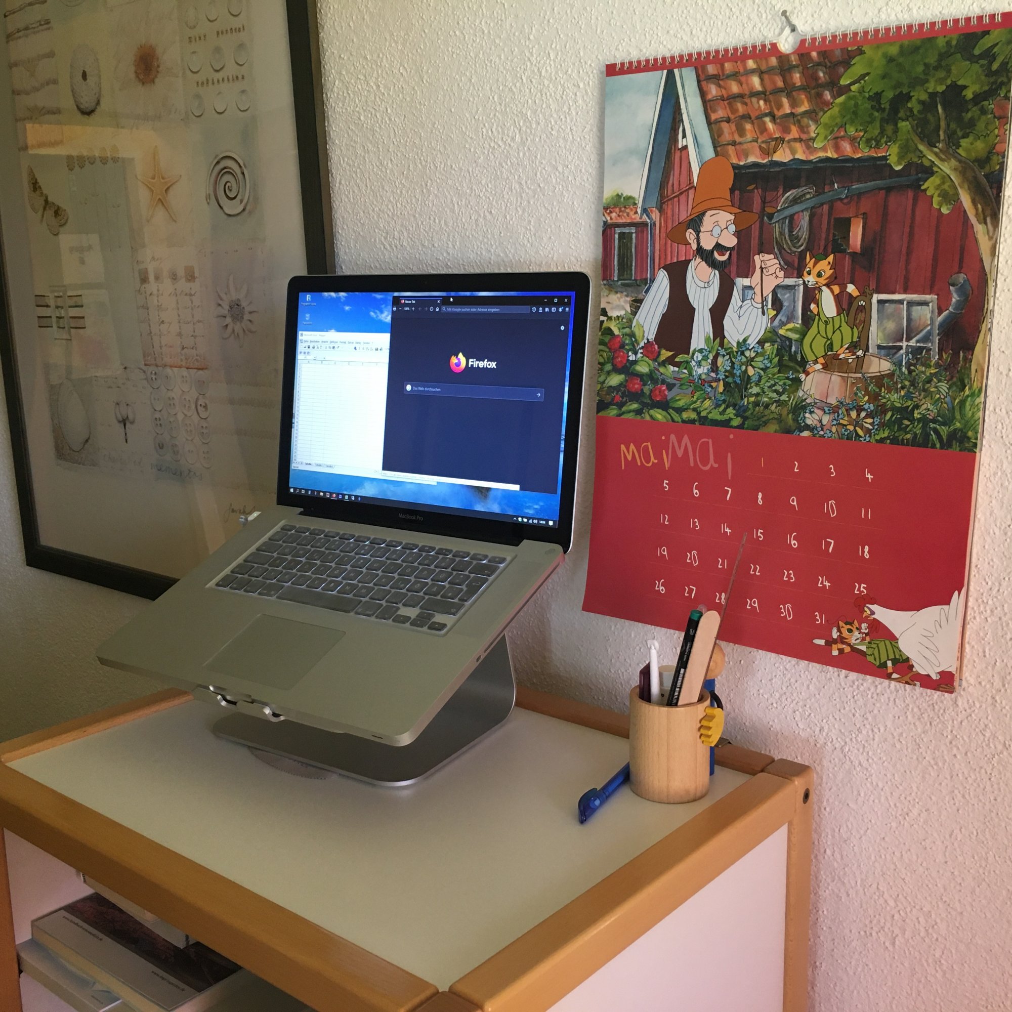

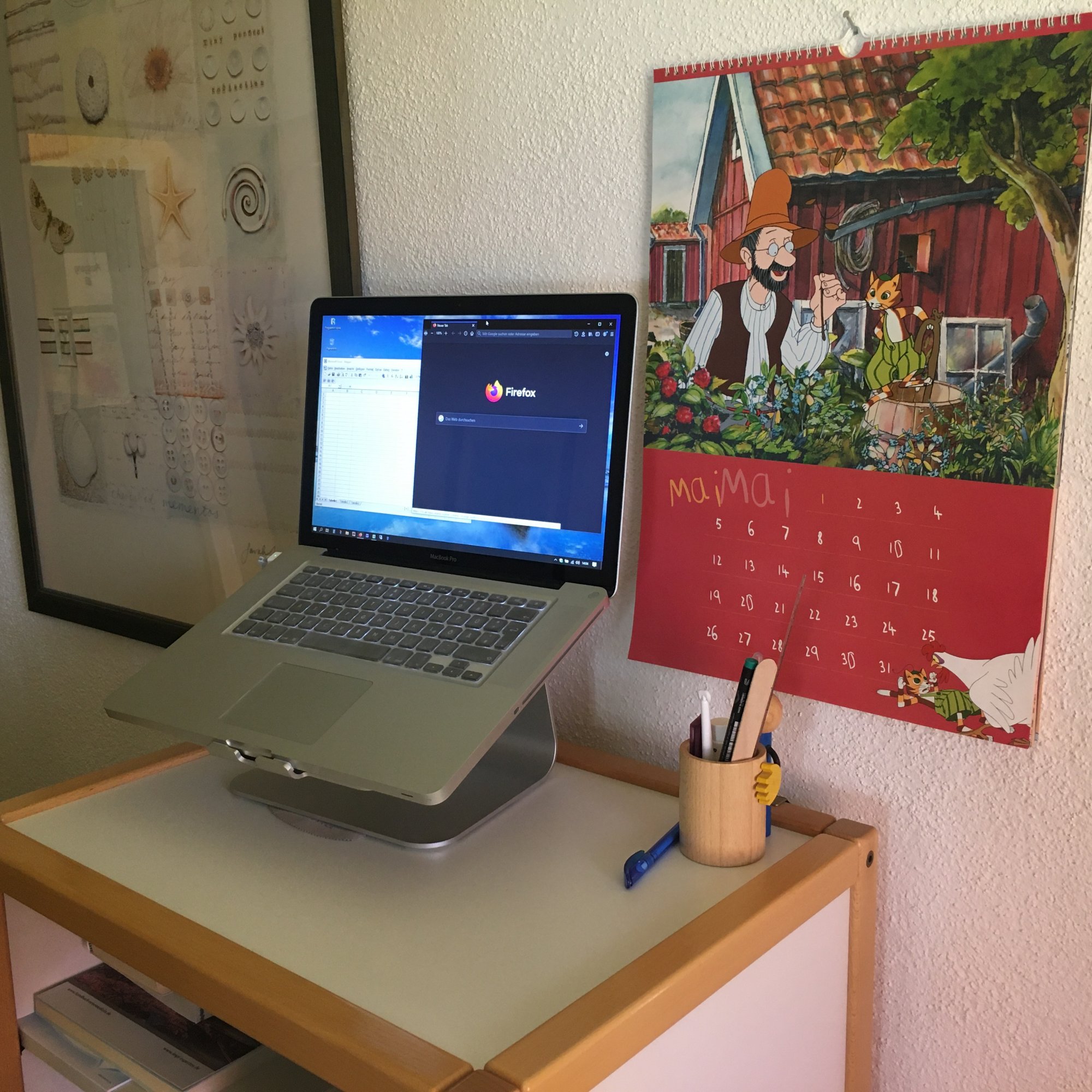

I sure would love to see that :)
Here's a picture ...
Spent hours in the office and at home (through VPN/RDP) to get all things straight with the network- and other settings on all machines.
Cumbersome job on an awkward operating system.
The keyboard is protected with a TPU-cover - same for the small USB-keyboards (w/o Num-block) on the iMacs. Both keyboards have the same size and layout.
Perfect for keeping things clean.
