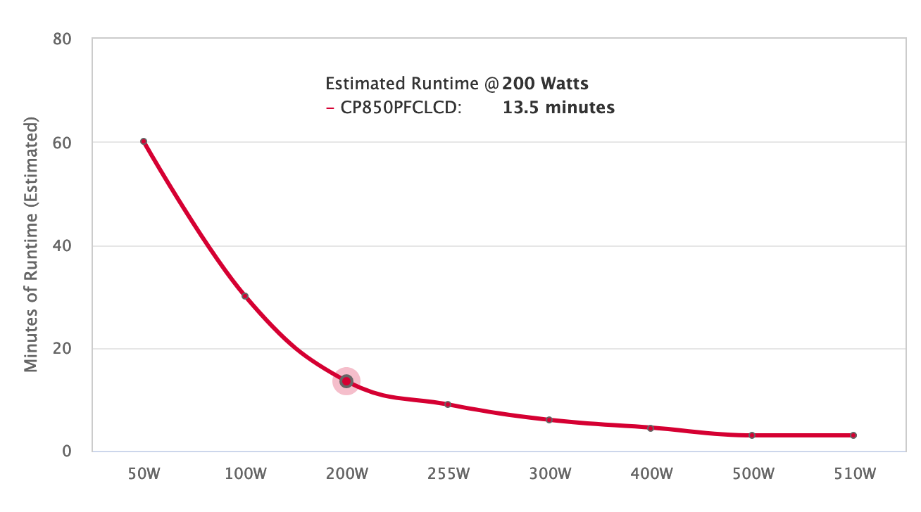

How do I figure what capacity I need to run a Mac Studio with a M2 Ultra for 10-15 minutes?
arw
macrumors 65816
Aug 31, 2010
1,227
974
I don't own a Mac Studio so I'm just speaking theoretically how to proceed:
According to Apple, a maxed out Mac Studio with a M2 Ultra can draw a maximum of 295 W (Which is the absolut max and not a usual use case). I suspect less than 100 W are more realistic.
Then add the power consumption of your display (depends on the exact model but probably ~75 W).
Add other important peripherals you have (like an HDD enclosure with external power supply).
Let's say you usually use 200 W total.
But 400 W are the theoretical maximum of all components together, so that is the mimium power the UPS must be able to provide to prevent a crash.
For UPS' (as for other electrical loads), the more common descriptor is not Watt but Volt Ampere (VA).

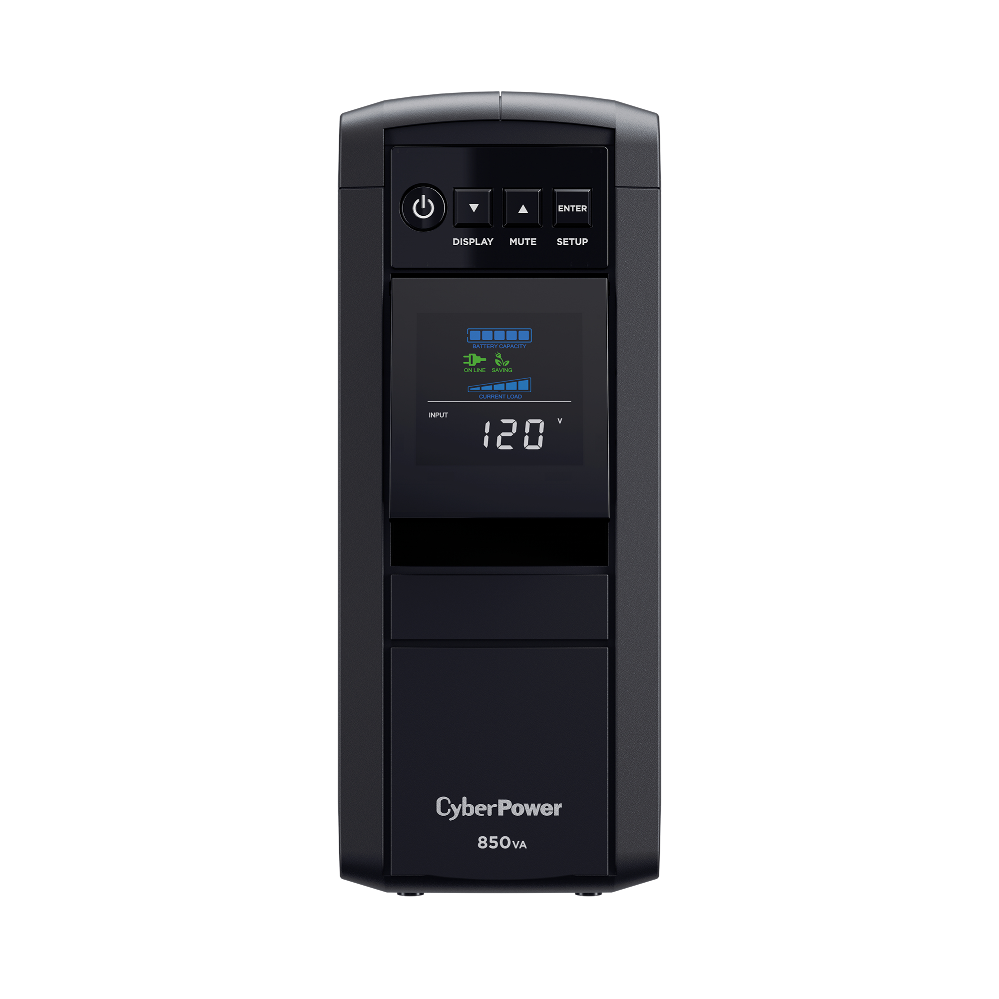

Looking at CyberPower's Sinewave series, the smallest model is 850 VA (500 W) CP850PFCLCD.
500 W is more than your 400 W, so that's fine.
Then you can dynamically move the mouse around the #Runtime graph of the model in question and check if the runtime at ~200 W load is sufficient for you.
If you want a longer runtime, you have to pick a larger UPS.
