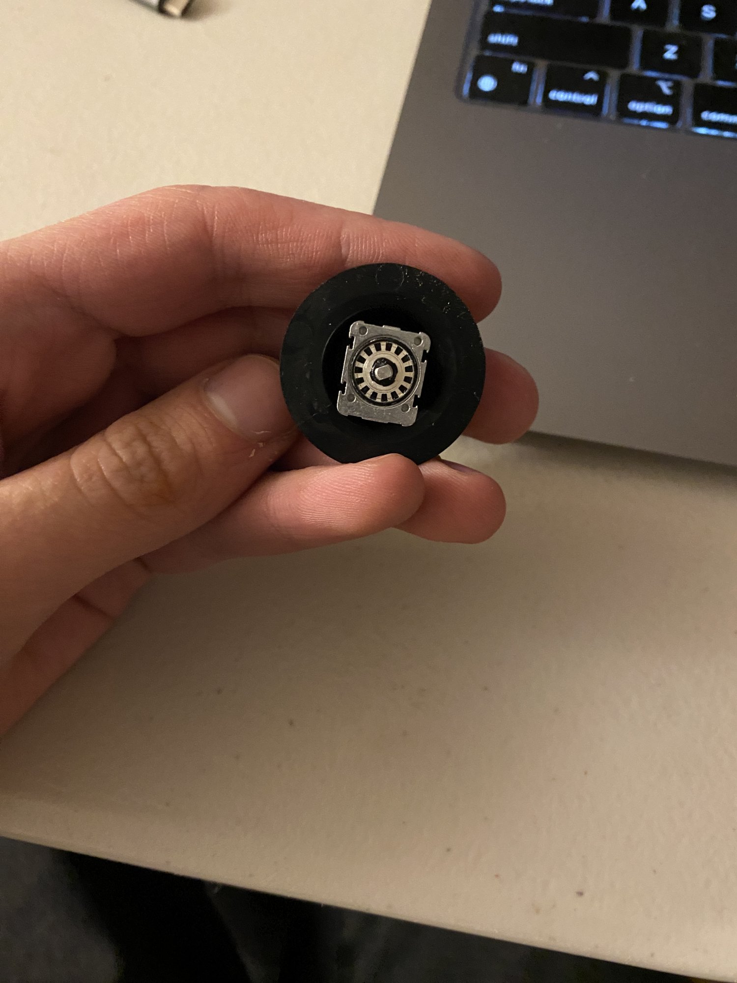

This is the part: View attachment 2320347
When it fell off, the little silver thing (which seems to have the electrical connections to make the knob work) also fell off. The thing is, that knob is meant to be taken off to upgrade the firmware on the amp (as a small USB port is underneath. The thing that's NOT supposed to be taken off is the metal piece. :(

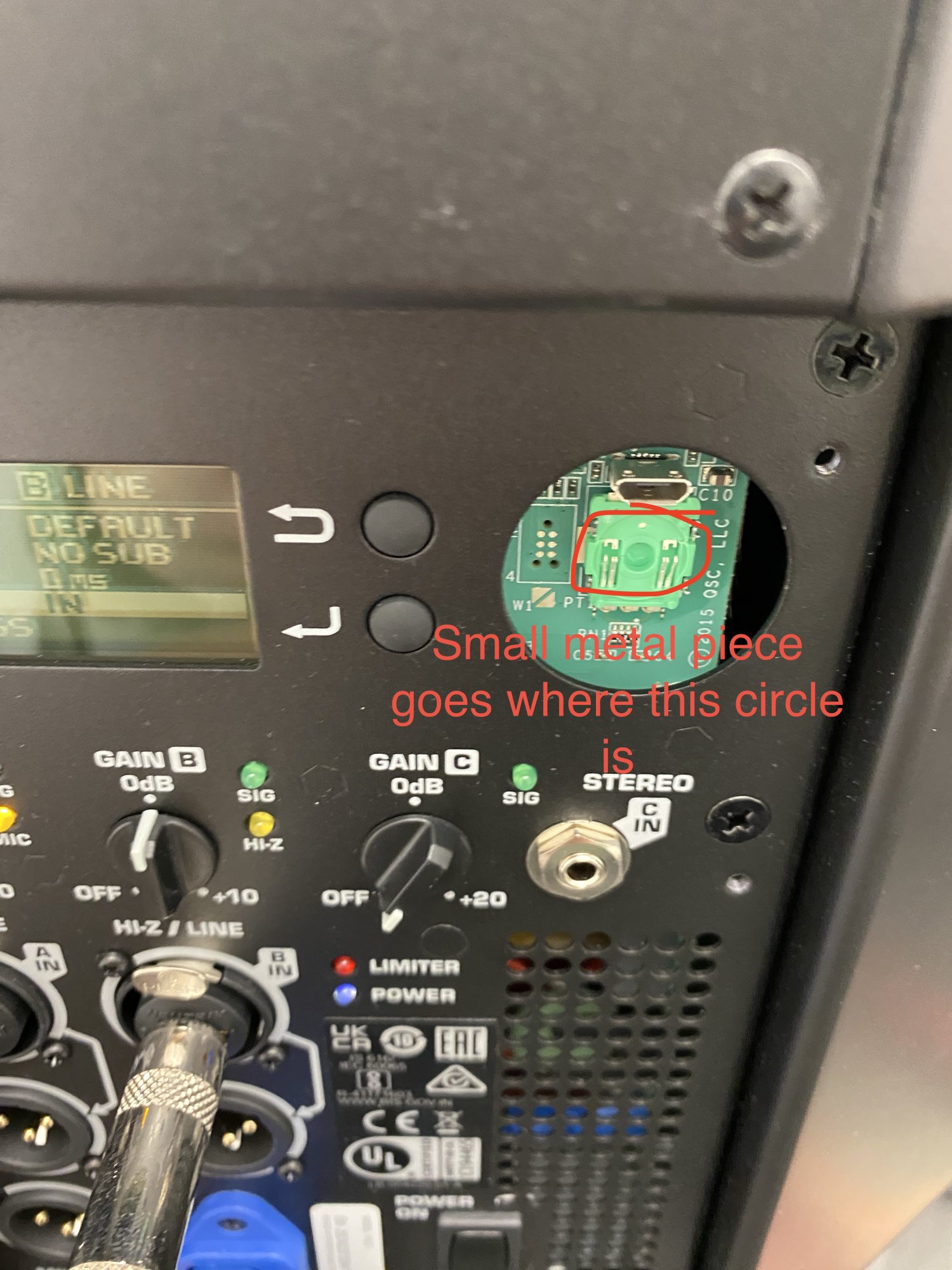

This is how the back looks now without the knob:View attachment 2320351
It's hard to tell from the photos how the metal piece is held on but it doesn't look like it's soldered. Are there any clips that hold it in place?

That doesn't look good at all.
It looks like the metal piece that came off and the light green element in the photo are (or were) a single component which has come apart....ugh
Maybe the two pieces snapped together?
I see that the metal piece has 4 holes that look to align with 4 little pegs on the light green piece.

There are clips I think. That's why I thought I might be able to fix it myself.
I agree.
Judging by the contacts remaining on the circuit board, and the pattern of what appears to be metal on the disconnected knob, it looks like a type of rotary encoder known as a "quadrature encoder".
I don't see anything that looks like clips to hold things together, so my guess is that it's definitely broken.
I do see a socket on the green circuit board, above where it's been circled in red. I strongly suspect that "removing the knob" should involve a set-screw in the knob that holds it on the shaft, but the shaft is supposed to remain in place. Removing just the knob would expose that socket (jack), which may be USB-C or similar, for updating.
