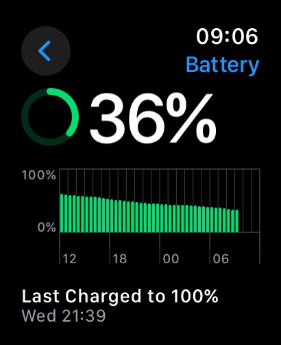

I think I can easily charge it every 3rd day. AOD, exercise 45 minutes regularly, view mail and messages as they come in. I do not wear it to sleep. No cellular, 77% day 1, high 40% day 2, 19% then goes in low power mode end of day 3.

Currently at 20% battery, an elapsed time of 60 hours.
So this Ultra 2, normal power mode, sleep tracking on, no AOD, no cell, minimal workout (working on that lol), is averaging about 1.3% per hour.
I figure that charging every other evening, between 8-10pm sort of thing, will be a smooth charging habit while still leaving a full day of use in case one forgets to charge.
"Last charged to 100% Sat 9:41pm"
Now at 2%, that's officially 72 hours.
