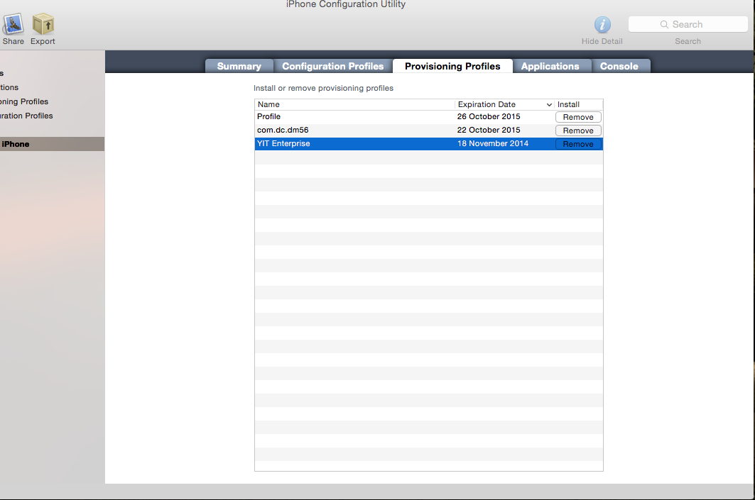

Guys,
I'm trying to remove both "com.dc.dm56" and "YIT Enterprise" from my iPhone using the iPhone Configuration Utility. However, hitting the Remove button does nothing.
Any ideas as to what to do?
The Provisioning Profiles don't appear under Settings>General either as others have noted. :|
Guys,
Like I said few posts above, use Xcode.

Okay, took me a while to figure out how to delete provisioning profiles with xcode.
1. Download xcode from the mac app store
2. Connect your phone to your mac and open xcode
3. Go to Window > Devices
4. Select your iPhone on the right side under "Devices"
5. Right click on your iPhone and select "Show provisioning profiles"
6. Select the profile and hit the minus button. Click done.
