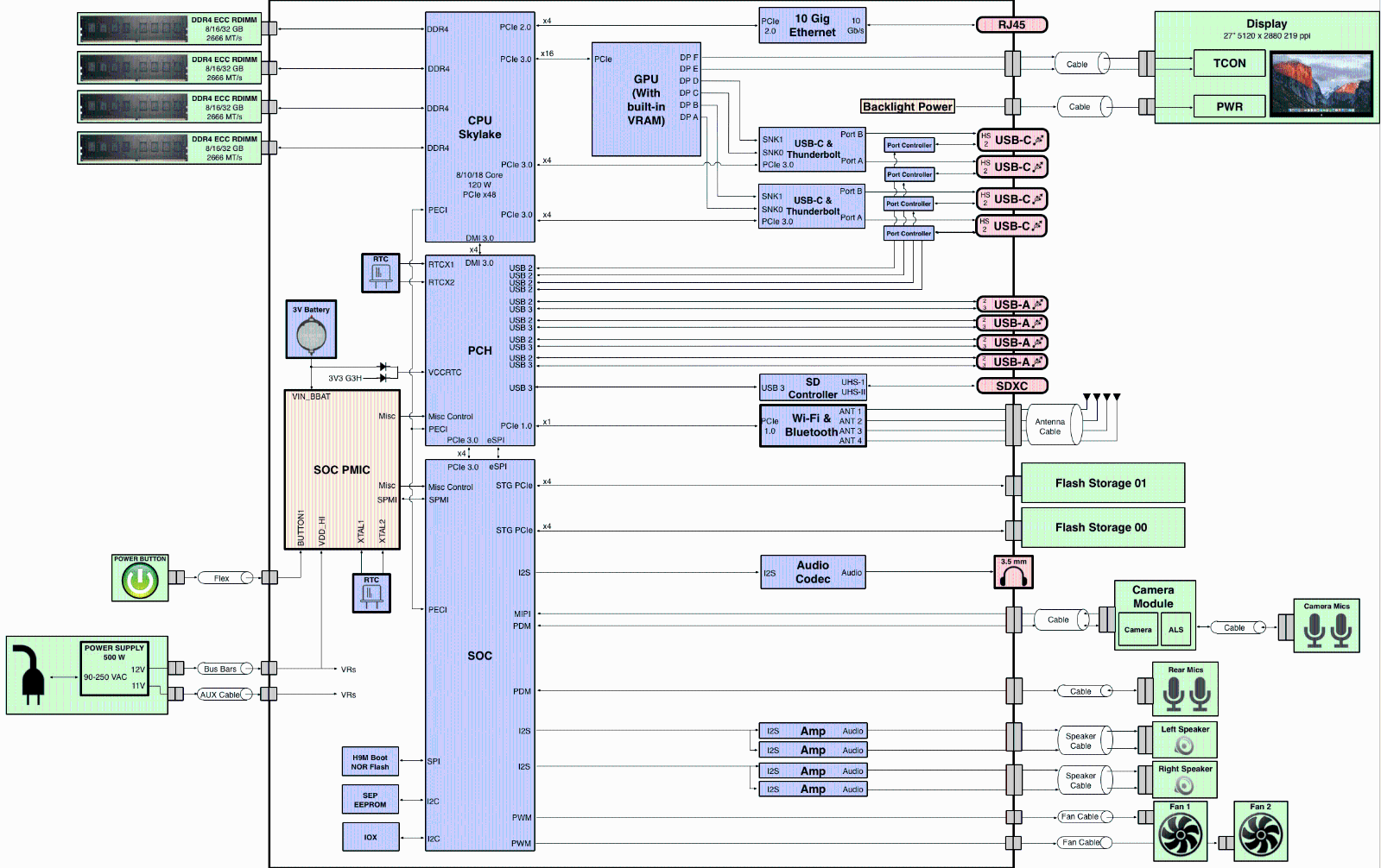

If I understand correctly, the 8950HK (latest MacBook Pro), or 8700B (latest Mac mini), or 7700k (latest iMac) only has 16 PCIe lane in total. Even that's PCIe 3.0. The total available bandwidth still less than a single W3690 can provide.
AFAIK, iMac Pro (48 PCIe lane) is the only exception that can really provide more bandwidth (than cMP) for multi GPU setup.
However, the block diagram suggest that only 8 lane (in total) for all four TB ports. Therefore, the combined bandwidth for all four TB3 ports just equals to a single PCIe 2.0 x16 slot.
Of course, if you put the iMac Pro's onboard Vega's PCIe 3.0 x16 bandwidth into the calculation, then the combined bandwidth for all GPU will become PCIe 3.0 x24, that's definitely more than the max possible that a single cMP can achieve (PCIe 2.0 x36).
However, it's very clear that the onboard Vega is downclocked to fit inside the iMac Pro's thermal / power envelope. No matter give it how much bandwidth. It still can't perform better than the Vega on cMP. Most of the bandwidth at there is simply wasted.

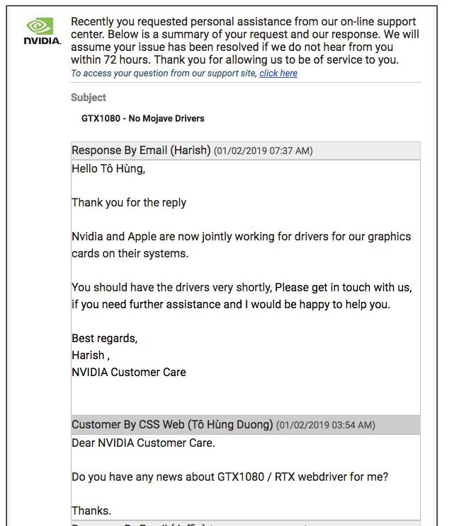

Mine is still in my machine, waiting for the web drivers. HS aint so bad, but I wish I was on Mojave13879dunno.gif
Lou
Reactions: crjackson2134
That has now been posted to at least 3 threads. I posted one, though not sure I believe it to be authentic13879dunno.gif
Lou
Commander, tear the internet apart until you’ve found those drivers! And bring me the developers, I want them alive!
We have no choice General, our cruisers can't repel firepower of that magnitude! We've got to give those fighters more time. Concentrate all fire on that Super Apple Destroyer.
Reactions: AlexMaximus and w1z
Hopeful, but you never know what to believe with tier 1 support staff.
I wish Nvidia would just come out and make an official statement, even a "We're working on it" or "Not going to happen" would suffice.
