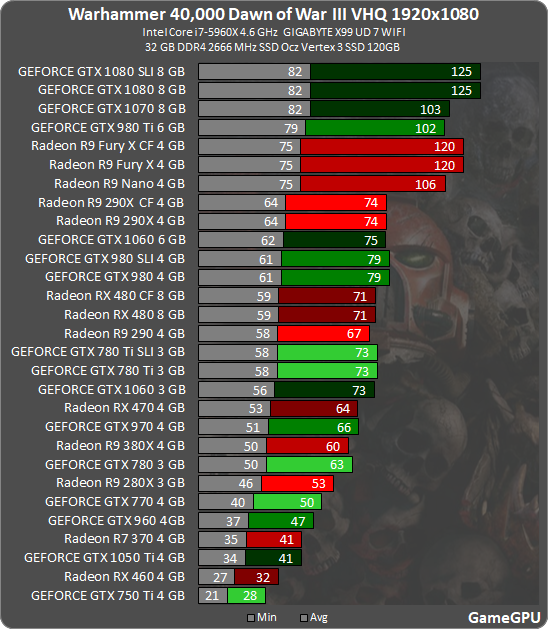

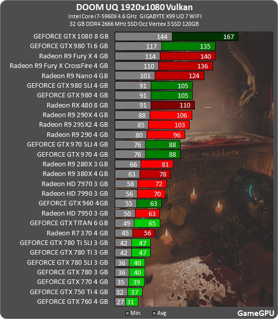

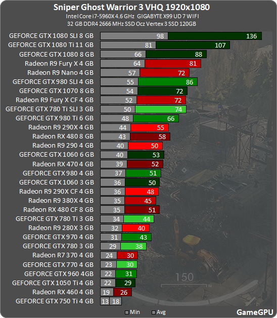

Why are you using 2012 reviews in 2017?
Especially considering my point: Over time, AMD GPUs are becoming faster, than Nvidia competitors.
You do not have to agree with my point. Lets cut to the chase. GTX 770 4GB vs R9 280X 3 GB:
GTX 770 slower.
GTX 770 slower.
GTX 770 slower massively than HD 7970.
GTX 770 is using the same core as GTX 680. In 2016-2017 titles. I am actually staggered that nobody here tends to say anything about R9 380X, which should be slightly faster than HD 7970, and should work flawlessly, because it is the same GPU as R9 395X in iMac, and should work out of the box.
At the beginning AMD GPUs are always slightly slower than Nvidia counterparts. They start to outpace, when software: which means drivers and applications mature. No wonder that you see no difference in performance if you use single Application, which is also very dated.

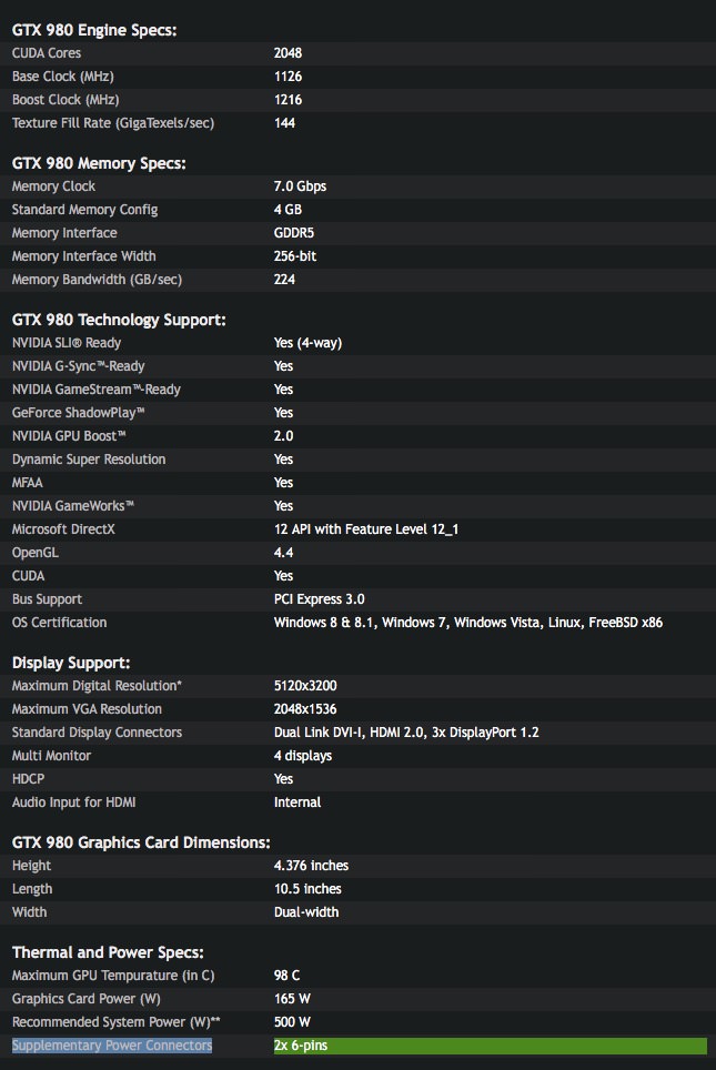

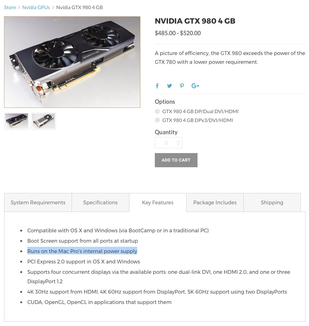

Good responses. Sounds like there are other options for a Mac 5,1 in 2017 besides the GTX 680 or the 7950 at a $200ish pricepoint. I just want something that's plug-and-play for MacOS Sierra, and don't want to deal with driver issues when Apple decides to do an OS update. I also want full boot screen support.
Also would heavily prefer using the internal PSU.
I bought a GTX 980Ti for £200 two weeks ago on eBay, which isn't much above $200 but has a massive performance uplift over a GTX 680 or 7970. Even if you wanted to be cautious and go for a GTX 980 because of the power draw, surely you could get one for just a shade above $200?
Spending $200 on either a GTX 680 or a 7970 seems like a massive waste of money unless being able to flash the card for a boot screen is non-negotiable to me.
The fact that you won't install drivers rules out a lot of good options and, since you want boot screens, leaves you with the GTX 680 or the HD 7950.
You could choose to get a GT 120 and an RX 460. The 460 is a modern card which works OOTB (just don't buy an XFX) and the GT 120 would provide the boot screen you desire. However, the RX 460 isn't that fantastic....so you may as well get a GTX 680 or an HD 7950.

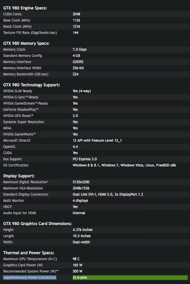

I've just came home with newly bought GTX980 and it has 2x8 pin connections.
It consumes almost half of what my late R9 280X did (1x6 and 1x8 pin). It's there for overclockers.
