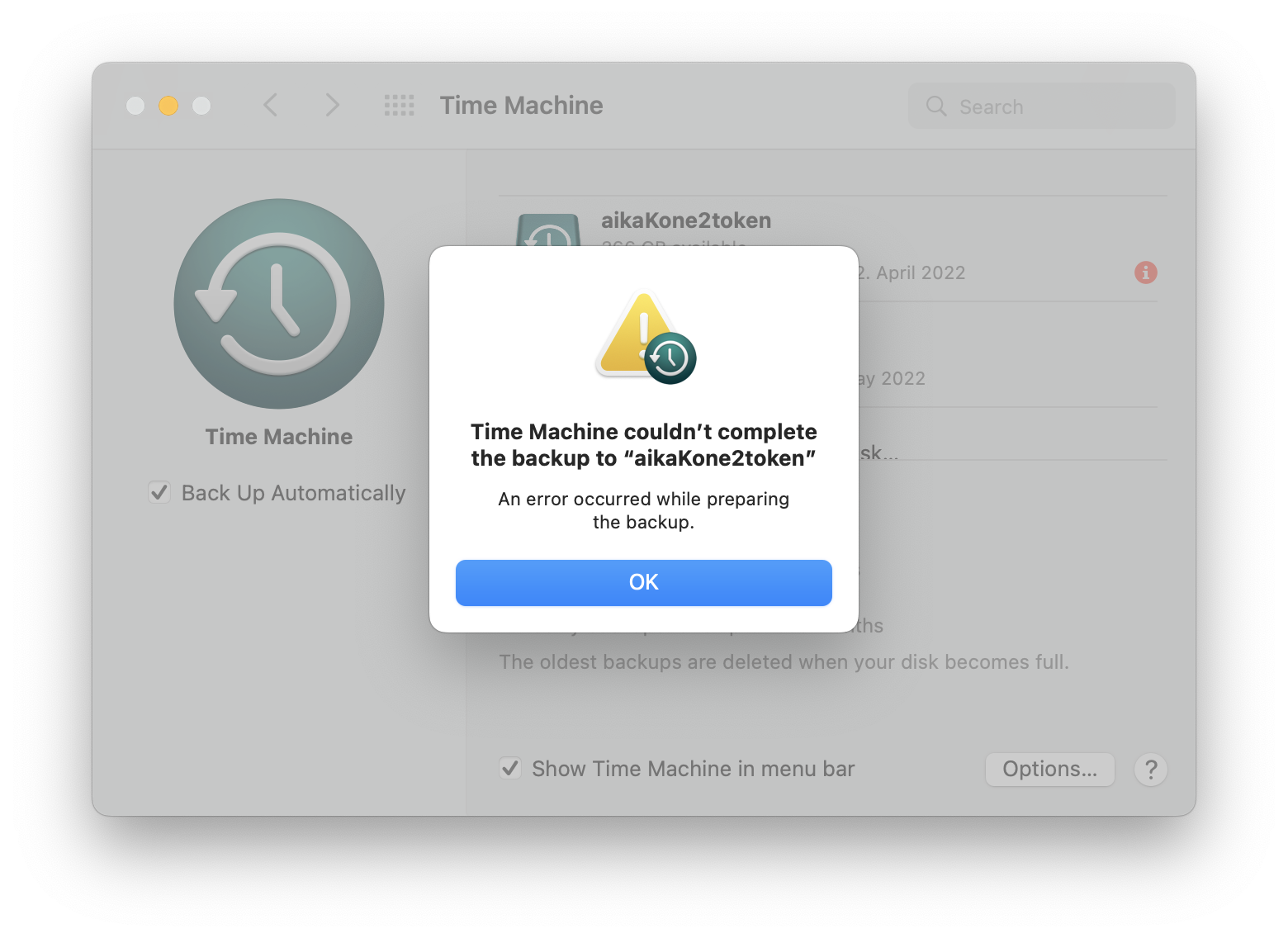

I think this Icy Box IB-Hub1701-U3 has costed me enough headaches now.
I have had my TM disk connected to it all the time.
Last month I noticed that my Photos library was corrupted.
Then I found out that most of my TM backups did not have a backup of it.
Then I contacted Apple about it and they couldn't do anything or explain the missing files.
This month I noticed that thos missing backups have appeared.
I guess they were in the disk all the time, but the usb hub was in conflict mini2018, so data speeds got so low that the indexing of the disk didn't work.
So, if anyone have any good experience with Mac Mini (2018) AND GenesysLogic "0x0612", I'd appreciate your experience!
Is this problem systematic of is just my piece a lemon?
I don't use TM.
I think I got confused about what kind of indexing you are referring to. Is time machine indexing different than Spotlight indexing?
If I use Finder to browse TM-disk's content, I believe indexing might be the same.
This might also be the nature of backup's incremental structure, which may take a long time to construct the file back together and with "flaky" usb-hub, the file might not get constructed at all. When Finder might not show the whole file at all.

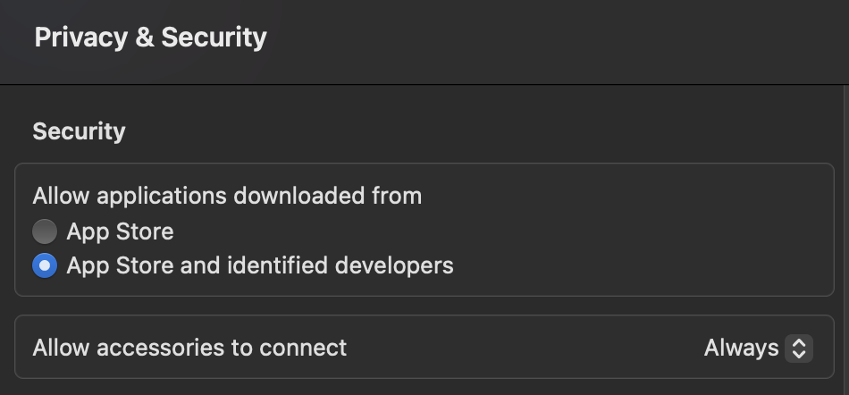

What would prevent my basic wired two button mouse not work when plugged into one of these hubs, or even a small usb-A to usb-c adapter?
My memory card reader also didn't work... But they do work on other computers.
The USB-A Apple Superdrive did work with the adapter when plugged right into the MacBook, but doesn't get the power through the hub for some reason. If anyone knows of one that works with the Superdrive, I would like to know.
But even using some old USB-A 3.0 hubs with the small adapter to USB-C isn't working for some reason with other basic devices. My mouse lights up, but doesn't work still.
So with the new OS 13, there is a setting that messed me up. I changed to always and now my devices connect and work.
There was a dialog box that popped up, but went away that asked if you wanted to allow the device access. Changing the setting removed that from blocking the items from working.
The Apple Superdrive still needs the USB-A to USB-C adapter to work and get plugged right into the MacBook without the hub. Even if I plug it into the USB-C port that is in the hub it doesn't work.
