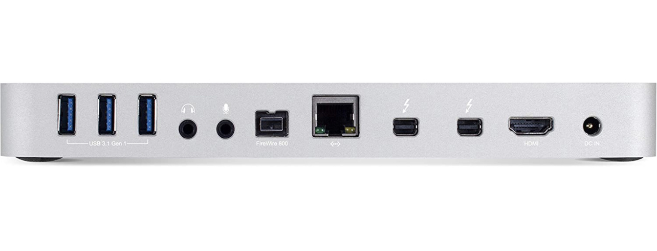

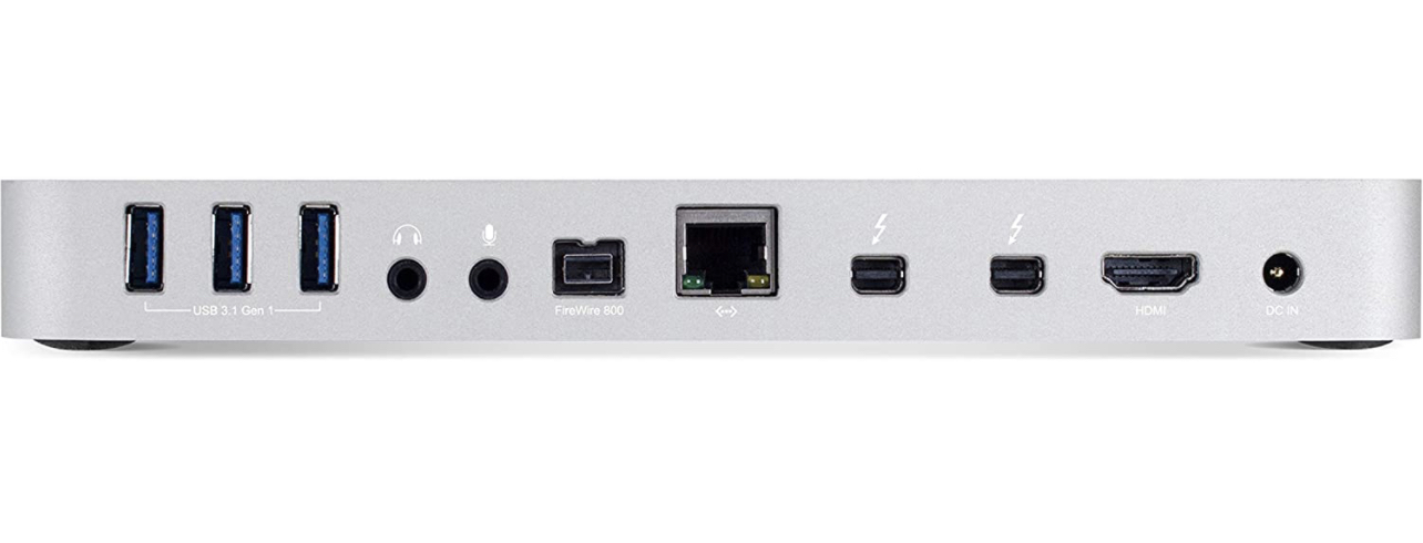

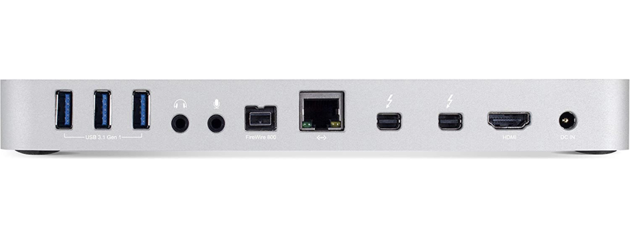

I have a few Thunderbolt 2 drives with a miniDisplayPort plug. Looks like I can daisy-chain them to one another but I do need a dock with Thunderbolt 2 to USB-C. I see that I can get a $60 Apple adapter but I'd rather keep the setup as simple as possible so I can use just one cable at my desk and not have a rats nest of adapters.
Are there any Thunderbolt 2 hubs that also have CFexpress, Ethernet, HDMI and the common assortment of USB-A and USB-C ports?
No Thunderbolt 2 device is going to have USB-C.
If one of your Thunderbolt 2 drives has two Thunderbolt 2 ports and its own power supply then get a Thunderbolt 3 dock and the Apple adapter.
A Thunderbolt 3 dock can add support for USB 10 Gbps speed.
A Thunderbolt 4 dock might work but I'm not sure. It doesn't work with Thunderbolt 1. It might not work with Thunderbolt 2 but I think at least one person said it did. I don't have a Thunderbolt 2 Mac to test. You'll need to use Big Sur to get full support from a Thunderbolt 4 dock.
This is a great idea. Thanks.
EDIT: Wouldn’t this work?
One of my Thunderbolt drives plugs into the Thunderbolt port in this OWC hub and then I run a USB type A to USB-C cable into my Mac?
You said you wanted a dock with USB-C ports. Thunderbolt 2 docks don't have USB-C ports.
To connect a Thunderbolt 2 dock to a Mac with Thunderbolt 3 ports, you must use a Thunderbolt 3 to Thunderbolt 2 adapter and a Thunderbolt 2 cable between the adapter and the dock.

That might be impossible to find. I sold mine a couple months back for $80 more than I paid for it in 2015.
No, yes, yes, yes, no.
If you're going to end up spending $300+ on a used OWC Thunderbolt 2 dock, put that money towards an M1. It'll smoke any Mac with TB2.
