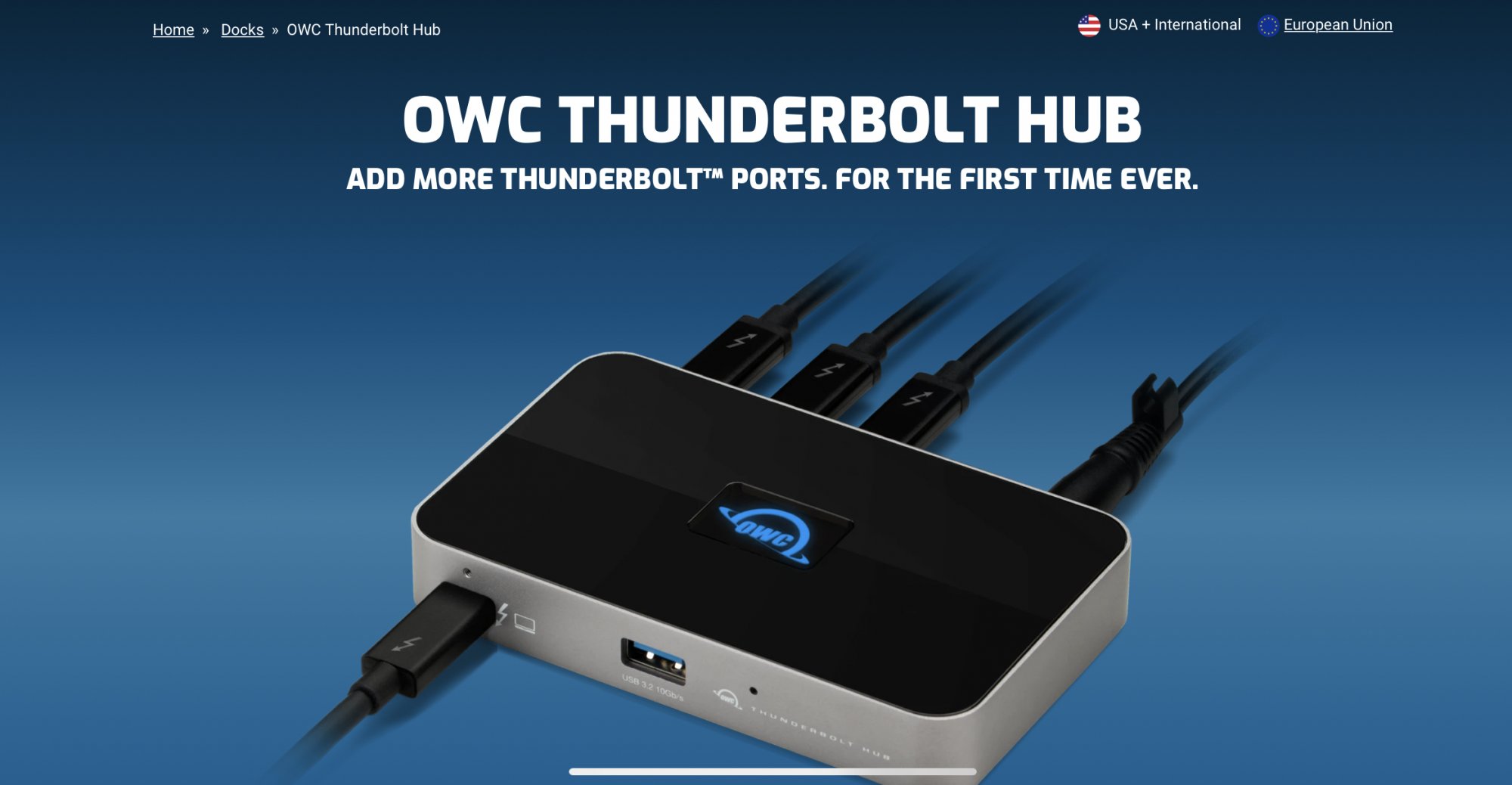

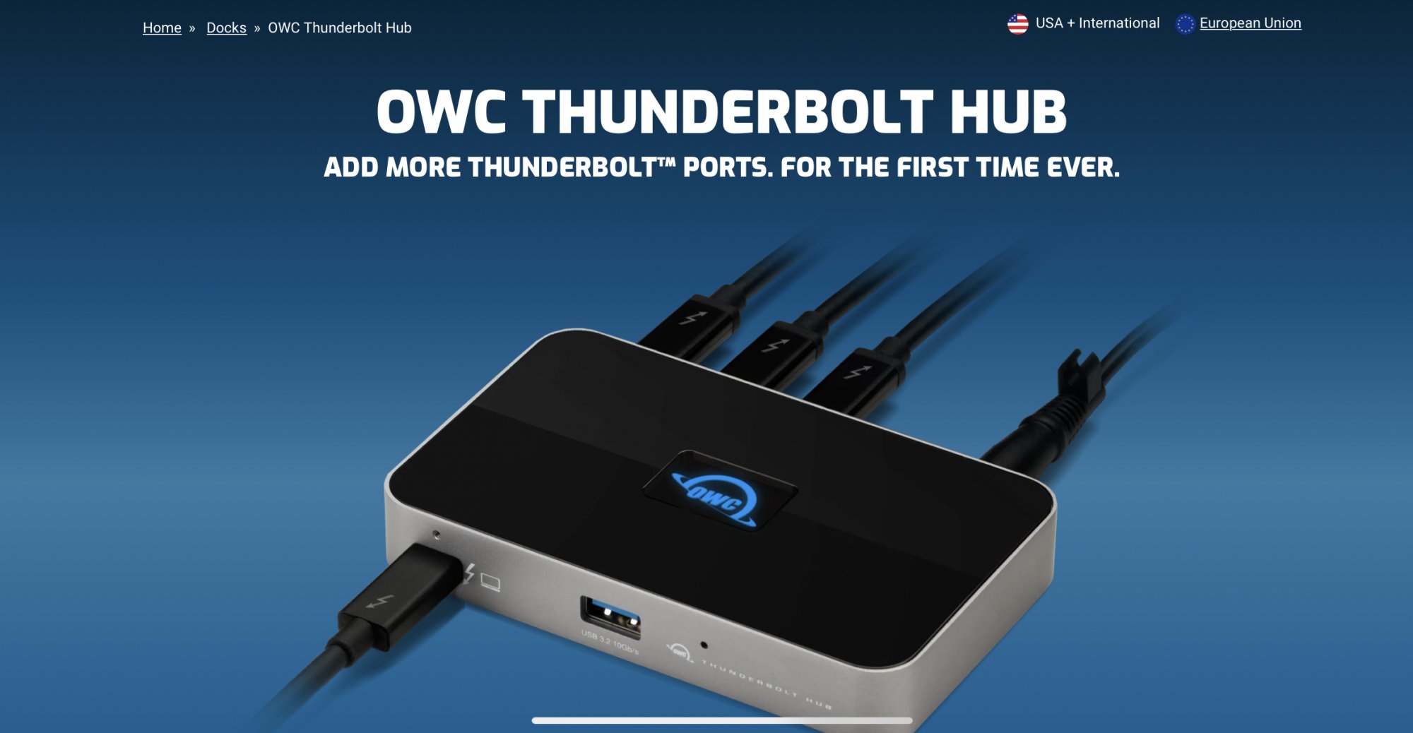

I’m getting this one in the next couple days. Seems like a good one to have along with a proper thunderbolt cable. The ones on Apple website are expensive but I’d rather be on the safe side have have a good one then from a fly by night manufacturer.
OWC Thunderbolt Hub
Add more Thunderbolt ports to your Thunderbolt (USB-C) Mac or Thunderbolt 4 PC.

Instead of HDMI out, consider a DisplayPort or USB-C DisplayPort Alt Mode output with a DisplayPort or USB-C to HDMI adapter. This way, you won't be stuck with the DisplayPort to HDMI converter that is inside the hub/dock - you can choose a new DisplayPort to HDMI adapter when they become available. For example, there exists different converters for HDMI 1.4, HDMI 2.0, HDMI 2.0b, HDMI 2.1 - maybe there could exist better adapters in the future. Each newer version of HDMI includes support for older versions.
No such thing as a FireWire to USB-C adapter or a FireWire to USB 3 adapter. Are you using an Apple Thunderbolt 3 to Thunderbolt 2 Adapter with an Apple Thunderbolt to FireWire adapter? In any case, it needs to be connected to a Thunderbolt port. Therefore you need a Thunderbolt dock, not a USB hub.
Are your Macs running macOS Big Sur? If so then maybe a Thunderbolt 4 dock will work. The Thunderbolt ports can be used for Thunderbolt devices, USB-C devices and displays, or displays or USB devices with an adapter.
https://eshop.macsales.com/shop/owc-thunderbolt-dock
https://www.caldigit.com/thunderbolt-4-element-hub/
I believe a Thunderbolt 4 dock can work with a Thunderbolt 2 Mac (I've only seen one person try it so far though). You need an Apple Thunderbolt 3 to Thunderbolt 2 adapter and Thunderbolt 2 cable to connect a Thunderbolt 3 device to a Thunderbolt 2 Mac.
Otherwise a Thunderbolt 3 dock will work. Many people like the CalDigit TS3 Plus. It's an older Alpine Ridge based dock so it does not support DisplayPort 1.4 and the USB ports are only USB 3.0 (5 Gbps) except for one USB 3.1 gen 2 (10 Gbps) port which only allows up to 8 Gbps of data. It doesn't have any USB-C DisplayPort Alt Mode ports except for the Thunderbolt port which you'll use for FireWire.
https://www.caldigit.com/ts3-plus/
There are other Thunderbolt 3 docks listed at https://www.nytimes.com/wirecutter/reviews/best-thunderbolt-dock/ but I don't think it's been updated much lately.
You can google for Thunderbolt 3 docks: Here's one:
https://www.anker.com/products/variant/powerexpand-elite-13in1-thunderbolt-3-dock/A8396141
(Triple monitor support only works with Windows where the USB-C to dual HDMI adapter uses MST; for macOS, more than two displays for Intel Mac or more than one display for M1 Mac requires a DisplayLink device).
It has an HDMI 2.0 port but HDMI 2.0b is required for HDR so maybe it doesn't support HDR from the HDMI port. I think it's another Alpine Ridge based Thunderbolt dock so it doesn't support DisplayPort 1.4 but Apple can get HDR from DisplayPort 1.2 somehow.

Yeah I clearly didn't have a few things straight before I posted this. It's been so long since I hooked everything up to the mac mini that i forgot what kind of ports were back there!
Now that I'm remembering the interface is going firewire to the thunderbolt port on the mac mini, I'm thinking I may be better off just doing the new audio interface + dock solution in one go sooner, and just fully switch to having the MBP being my one and only machine. The Mac Mini is on High Sierra, and I don't want to move it over to Big Sur for fear of the drivers on my current firewire audio interface not working anymore. I'd prefer to try and set up a new sytem based on the MBP and a new interface, I suppose.
I guess that changes the nature of my question. My preffered audio interface manufacturer (MOTU) isn't quite all the way updated for the M1 macs - they claim their USB class compliant devices, like the MOTU 8pre (which I have the firewire version of, currently) are working with the M1s, so I may go for one of those, and then my problem becomes cramming the interface,wireless keyboard, wireless mouse, webcam, and synthesizer all onto the MBP somehow, while also being able to cast whatever's displayed on the MBP to my HDMI-in-only Samsung TV that I use as a monitor. If I can somehow remove one of those things from the USB devices list, I might have more options.
Appreciate you setting me straight and helping out.

Are there now non-Thunderbolt multi-port one-to-many USB-C hubs available that can increase the number of USB-C ports?
The multi-port Thunderbolt 4 hubs (OWC, etc.) seem to now satisfy that need, but with the added expense/complexity of Thunderbolt.
Do the same now exist for simple USB-C?
