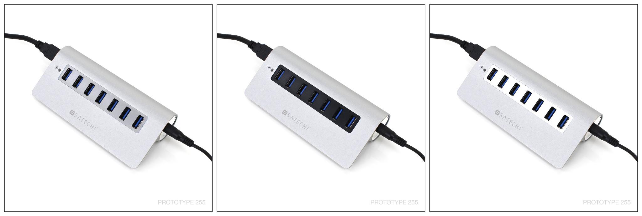

Im waiting for this mac like 3.0 hub to be released. :)
These are just prototype models.

I'd like to buy the "Satechi Premium Aluminum 7 port USB 3.0 Hub" but apparently the thing is sold out for weeks. The design is not so atrocious like many of the other hubs linked here. Any idea were I can get one?
I don't know I've been waiting for this to be in stock for a while.
