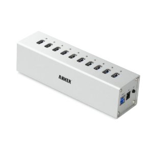

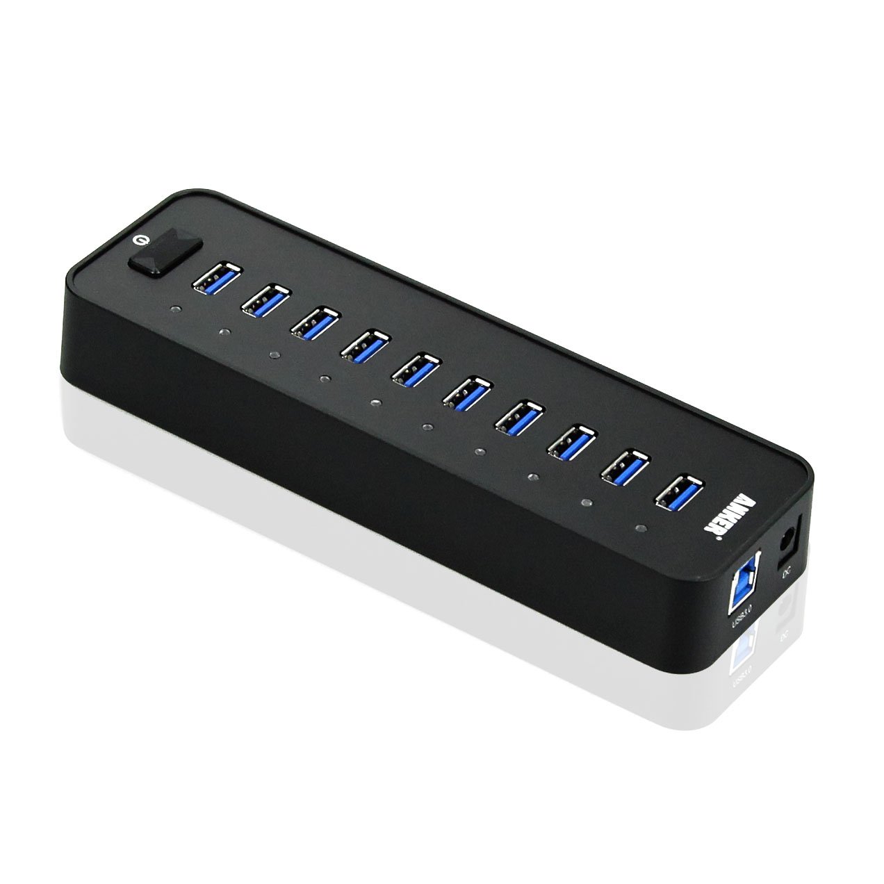

The Anker 10-port hub is still the best looking of the bunch.
I just bought Anker 10port Mac Style usb 3.0 hub after reading reviews.
It looks a bit odd but it is aluminium style instead of the plastic and has powerful power adapter.
I'm using Anker Uspeed USB 3.0. Small, compact, good performance... just look at the reviews on Amazon you will see.
