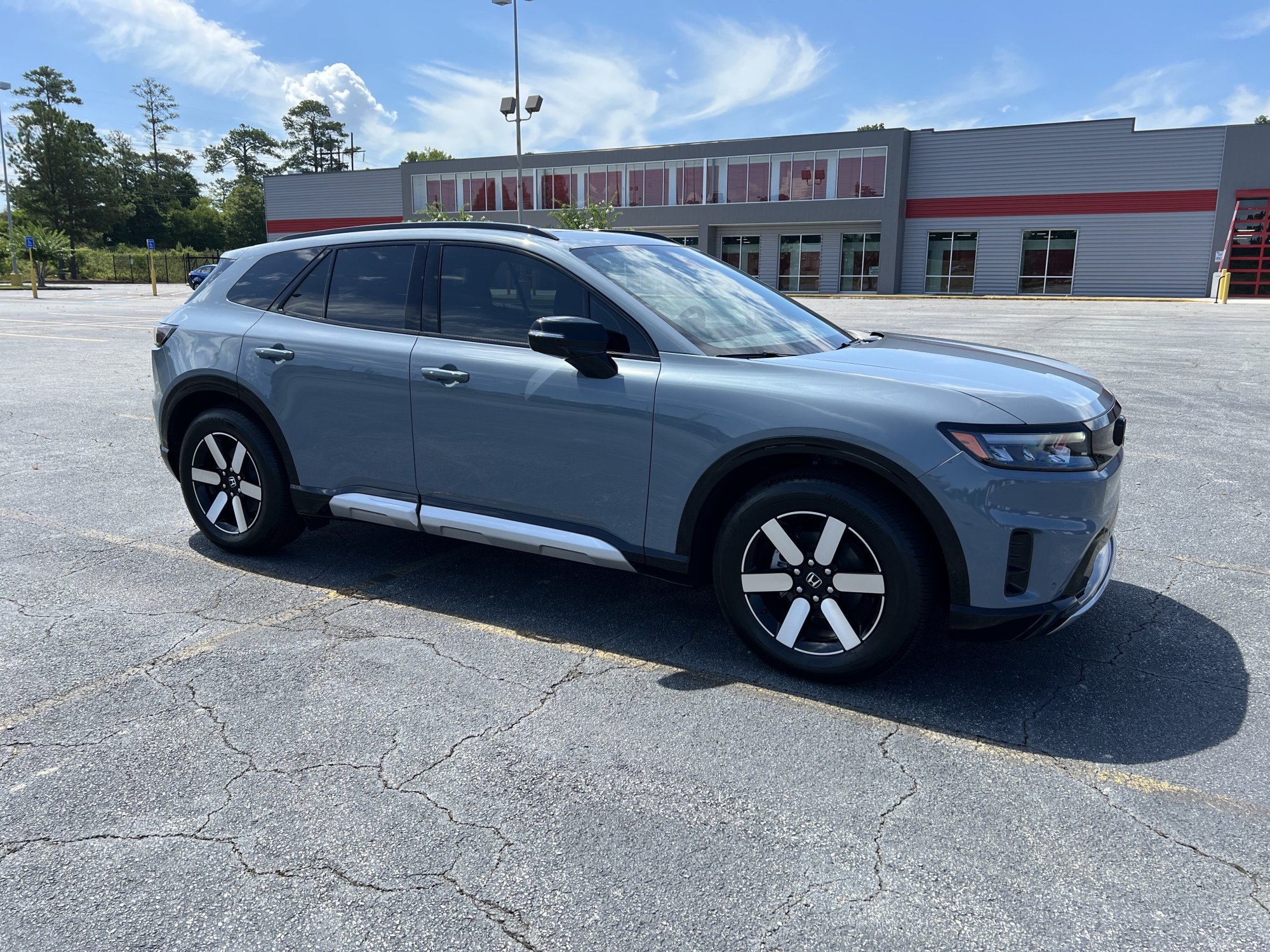

Didn’t realize there was an EV thread. Bought a Honda Prologue Touring a few months ago and so far I’m loving it.
Oh never seen one of those. Glad to hear you are loving it.
I understand it that Honda purchased the platform that GM created with the EV Blazer. They did Honda'ize it, so it was improved.
Honda initially had bad sales with them, when they first came out, but lately the numbers have jumped (they offered rock bottom lease prices, and good purchase deals). A buddy of mine is a finance manager at a local Honda chain.
Pretty positive it is built on the same factory (maybe even line) as the Lyriq and Blazer EV by GM. I am glad to see it selling well now though. Much better than the BZ4X, that is for sure.
