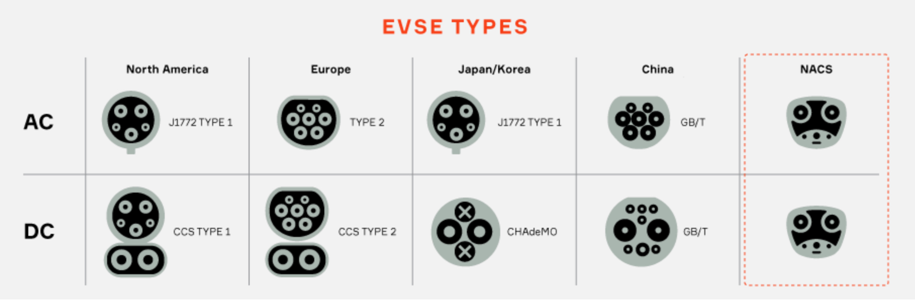

I didn't think CCS 1 or 2 carried AC, it falls back on J1172/Mennekes (I dunno ya'lls alphanum designation for that plug)
I have no idea about CCS1 we don't get that here. CCS2 definitely does both single and three phase AC. Typically they go from 1x16A to 3x125A. Our home in the UK has a 1x32A, the house being renovated in the NL has 3x80A but I'm in negotiations to get it up to 3x125A. 😎💪
That is interesting, so a single cable (the part that plugs into your EV) gives you both DC and AC charging, I thought the cables that have DC charging don't have the pins for AC charging (that is how the US CCS 1 works the AC pins are missing).
Cable is the wire that runs from the cabinet to the plug. Plug is the CCS1/CCS2/NACS/J3400 part that you hold onto.
Their plug uses different pins for AC vs DC charging, NACS/J3400 uses the same pins for AC or DC charging. This is why the NACS/J3400 plug is smaller. With CCS2, just like with CCS1 the plug goes around the top AC part (J1772 in the US or Type 2 in this image) to help align the plug, but doesn’t use the AC part of the pins, just the communication pins (smaller 2 pins in the top part CCS1/CCS2).
With CCS1/2 AC charging, it uses a plug that doesn’t go around the CCS part, but technically it could, without the pins. But since a lot of manufacturers put a flap over the DC pins, it’s just easier to have a smaller AC plug that avoids the DC part.
To me, NACS/J3400 is much more elegant, as it is a smaller plug for both AC/DC charging, and according to Tesla is capable of the same charging speeds AC (within a usable limit) and DC (with the right cabinets).

Telsa's AC charging is based on J1772, just with a different shape plug, older Model S with dual chargers can charge at 80 Amps using 80 Amp J1772 EVSEs through the Tesla-supplied adapter.
The only Teslas that can do 80 Amp AC charging are early Model S with the optional dual chargers, and the earliest Model X again with dual chargers. By the Model 3's release, 80 Amp charging had been dropped as even optional on all Teslas.
As for DC: CCS is in theory capable of up to 500kW - 500 Amps at 1000 Volts. Tesla's custom protocol is capable of 600 Amps, but only "400V-class" (up to about 500 Volts, so about 300kW.) The CCS-based J3400/NACS is rated for 650 Amps at 1000 Volts for 600kW.
