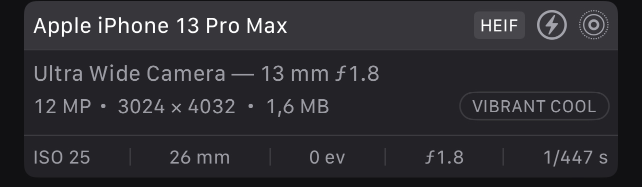

This is not correct. At least for the IP13PM
This is a macro shot.
Lens is 13mm f1.8 cropped to 26mm.
You can try it yourself as I said. The main lens is not capable of close distance shots.
As soon the camera shows the macro symbol it’s a cropped 13mm shot. Always without any exceptions.

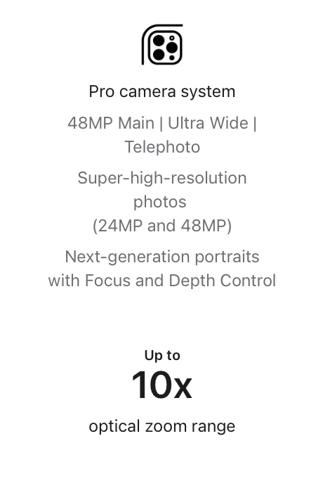

So I am finding this whole argument kinda dumb, but I am starting to see the point. This is on Apple's website:
Now I can make the argument that 3x on an iPhone 15 Pro is optical, or 5x on the Pro Max, but neither comes close to 10x optical anything.
