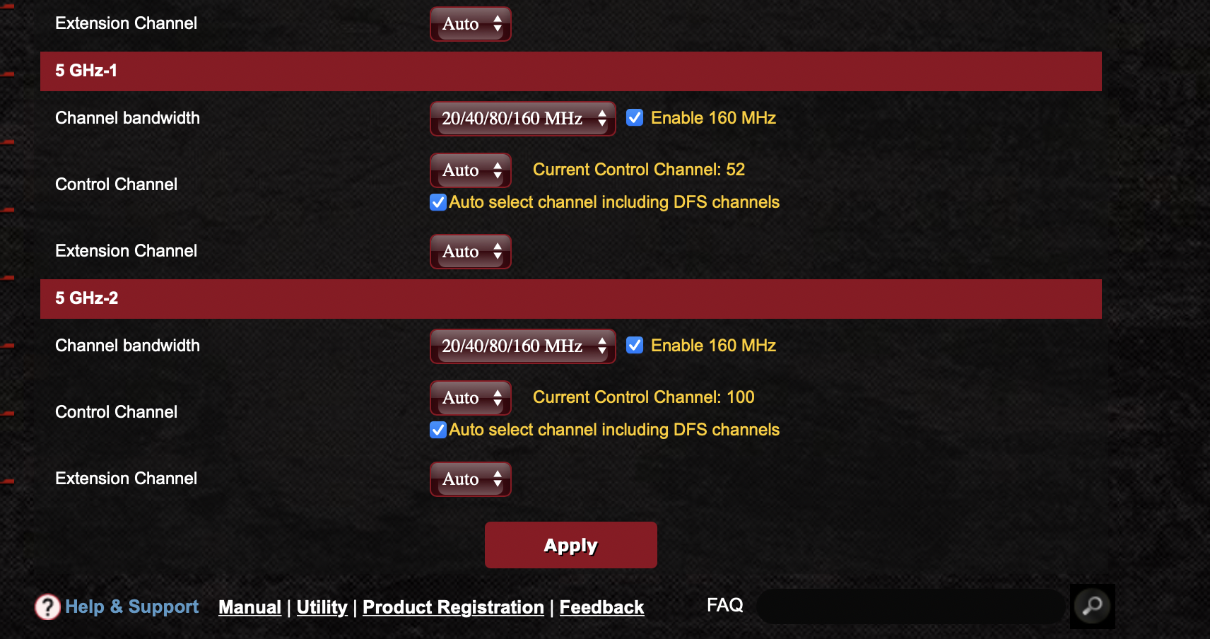

I am a first time Mac owner and I have an M1 MBP and an Asus GT-AX11000 and experiencing the same issue, having to disable/re-enable wifi constantly to get it working again. I am always streaming video in multiple windows like YouTube, Hulu, and an RDP connection to a Windows machine that controls my surveillance cameras and randomly all my video streams, web pages, RDP connection start buffering endlessly before the WiFi icon starts animating and telling me there's no internet connection while there are no issues with any other device, including an iPad, iPhone, Windows PCs, etc. I contacted Apple support and they were of no help. I don't know what to do, I read everything I could about this online and I haven't found a good fix. I see a common denominator with this issue appears to be Asus Wifi 6 routers which is troubling because I paid like $500 for my router and I'm not about to sell it and spend more money to downgrade.
Hello,
Exact same hardware here, M1 MBP and a Asus GT-AX11000 router. I'd constantly be getting issues where data flow would just stop. The MBP would stay connected to Wi-Fi but, the throughput would just die a death. So I had to turn Wi-Fi on and off again to get it going again. I tried turning Wi-Fi AX off, setting manual channels and all sorts to no avail.
Every other device in the house including, hue lights, sky tv, the telly itself, , an Apple TV 4K, Alexa, 3 games consoles, my work laptop and several iPhones were absolutely perfect. Just the MBP with issues.
Thought I'd finally fixed it by assigning a static IP address to the MBP and all seemed good over Xmas. Though all I was doing was browsing the web and light tasks like that.
However, this morning, thanks to Native Instruments finally releasing a Traktor beta which runs on the M1, I attempted to download my iTunes library from the cloud to the MBP and unfortunately, the issue was back with vengeance. I have several thousand songs in my library and every few songs, the throughput would just die again. I reset Wifi about 10 times before I became sick of the issue and started looking at both MBP and router settings. It would have taken me ages to just sit there constantly turning Wi-Fi on and off again every few songs to get my library.
I did wonder if it was to do with Wi-Fi channel width and started having a play, and I found something quite interesting!
Setting the 5Ghz 1 and 2 radios to use the 20/40/80/160 Mhz option (it defaults to 20/40/80) seems to have completely cured my Wi-Fi issues. The MBP pro is still only connecting on the 80Mhz channel width but it's ultra stable at 1200 Mbps. The throughput drops have now gone. It's almost like the MBP Wi-Fi speed was causing the router to hit some sort of rate limit at the 80mhz setting and give up, but setting it to the highest option gave it more headroom.
Thankfully, once done, I was able to download my entire iTunes library without a single further rate drop.
Try it yourself, see if it works for you. Do remember though, that it may cause issues with other devices on your network which don't like that setting. Thankfully all my other devices are quite happy to play along with it set on.

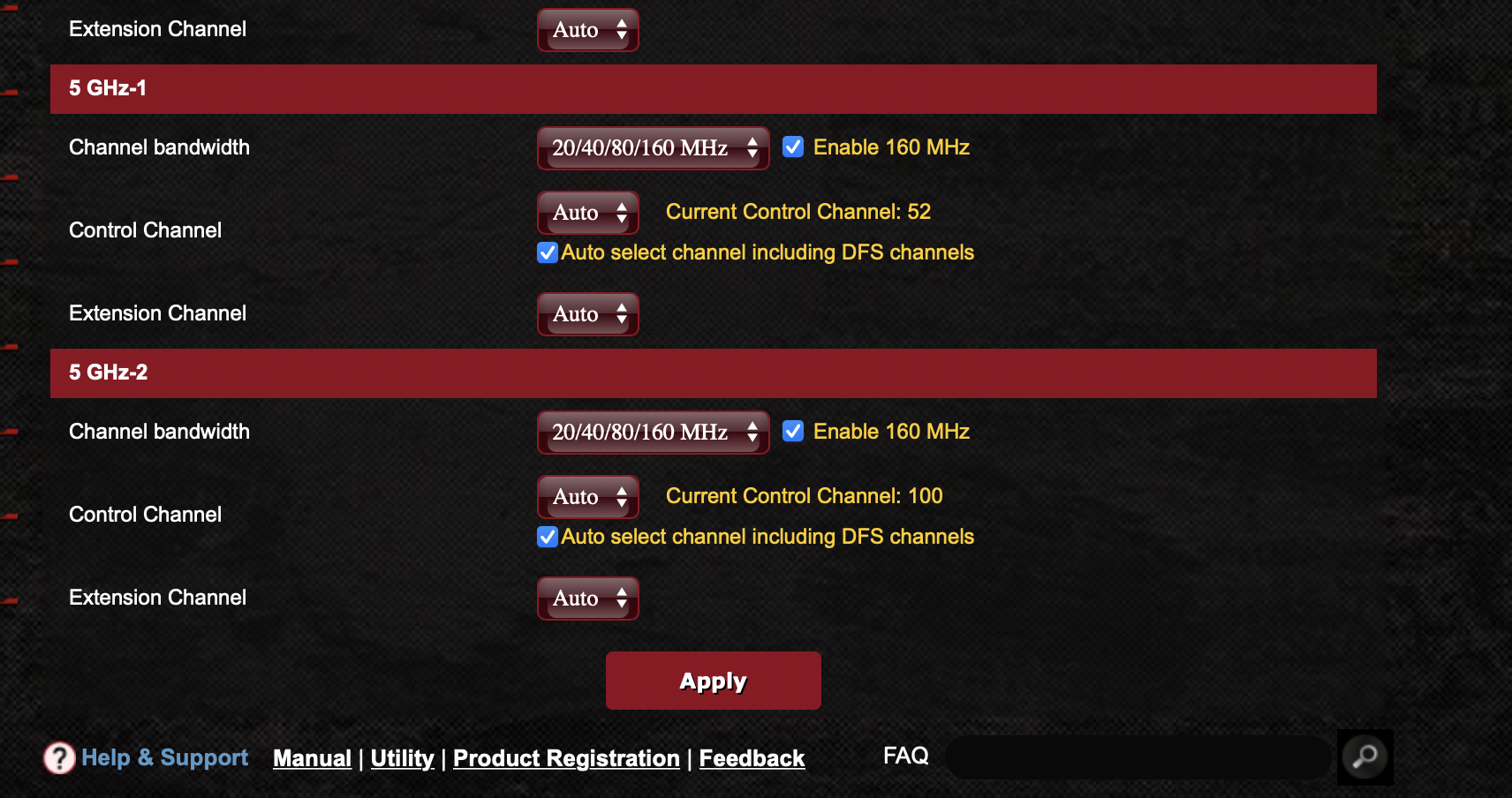

Hello,
My router's wifi settings were already set up the way you have it. I think I may have fixed the issue using a previous poster's advice on disabling unlocking the MBP using my Apple Watch and I haven't experienced a single disconnect for two straight days now even when transferring a lot of data. My speed test numbers increased as well since I disabled this. Time will tell if this is just a weird coincidence that it just happened to stop after the watch setting but I doubt it since I haven't had a single day since I bought this laptop where I didn't have to toggle my wifi at least once every hour or two. Fingers crossed. I'll continue to update this thread, even if the issue doesn't resurface for a few days.
