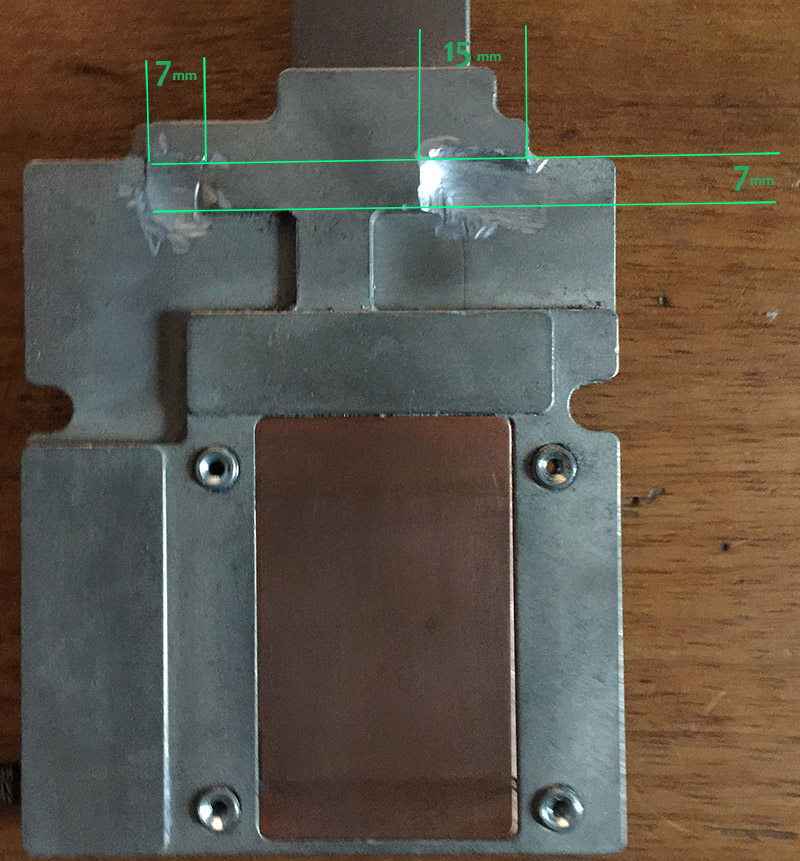

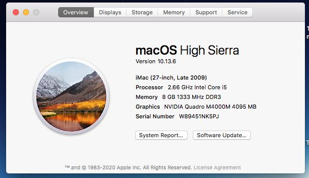

The HD4850m on my iMac 2009 was dead. (Typical symptom: boot to 50% on the boot screen and stop there)
I replaced it with a Quadro M4000m. It took me half a day to grind the heatsink, but the result was satisfactory.
What is it to do with your iMac 2010 issue?
Well, it has 99% similar specs as the iMac 2009.

Any photos of your grinding work?
What does this experience have to do with my issue? 🙂
1. If you still insist that your GPU is perfect and working fine, then it has nothing to do with your experience.
2. Photo for the grinding work: No, I have already installed the M4000m and another M6100 to the heatsink.
And I don't want to bother to take it out again just for a photo.
Something like this:
1. no i dont think its working perfect but other than placing a native GPU i dont know how to do the software hacks in order to place a diff GPU, otherwise i would certainly try one
2. when creating masterpieces like the photo, the creator takes a pic before installing it ;-), I admire the job u did
