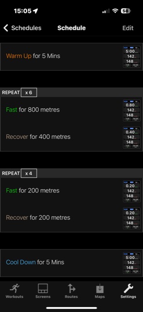

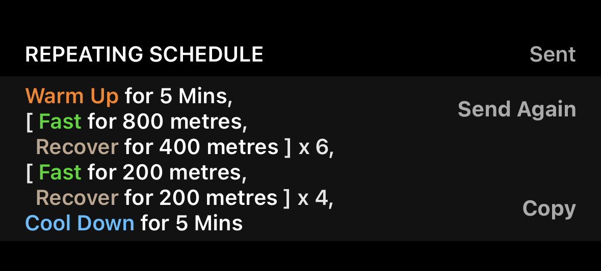

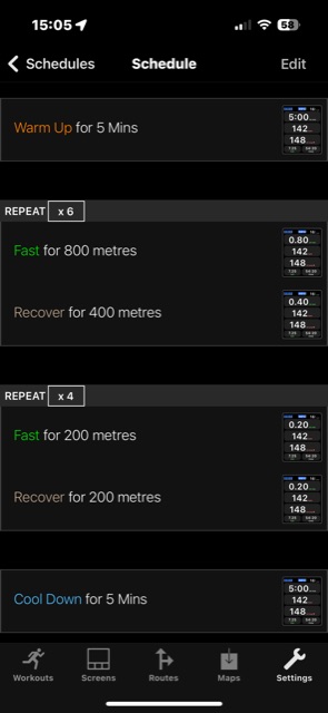

I am thinking of a simpler/lazier way of simply starting a run activity, then start and stop interval in the middle of a run, is that possible?
You can manually split a workout into intervals if that is what you mean? To do that use the New Interval command. On the Ultra that is the default command for the orange action button, but on other watches like your S7 you can configure it for a different gesture (e.g. double tap the screen) by going to Settings / Commands / Shortcuts
Thanks, that helps. And to end an interval, I can also have another gesture (e.g. triple tap the screen) to Exit Repeat, will that work for recording an unplanned/unscheduled interval?
Unplanned intervals are simply a way of manually splitting a workout into sections. There is no concept of repeat loops or even interval types (fast, slow etc). You just invoke the New Interval command and it starts a new interval (and ends the previous one).

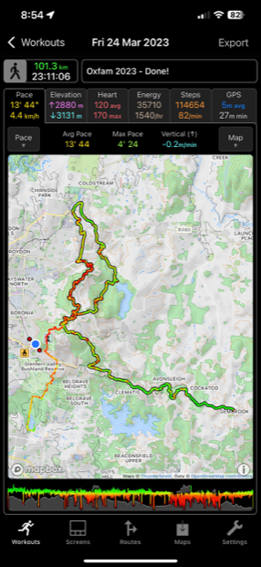

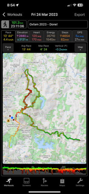

I managed a 23 hour event and finished with a couple of percent battery at the end (using an Ultra). I was carrying my phone and both were in low power mode (but still recorded full heartrate and GPS data). I think having the phone helps prolong the battery life but I'm not exactly sure how.
Yawn... I run 100km in my sleep.... cuz that's the only time I would even entertain it.
Crazy!
Would you mind to share your Apple Watch settings?
The longest activity i tracked was 11 hours and i had around 40 % battery left on my watch.
Crazy!
It was a couple of months ago and I have played with the settings since but if I recall correctly, I had:-
  • The watch in low power mode with cellular turned off
  • Notifications muted (I had do not disturb triggered automatically when I started the workout)
  • No music / podcasts playing on watch or phone
  • WOD was playing the alerts though the phone which I had in my pack
  • AoD turned off
  • The iphone (11) in low power mode the whole time.
I looked at the watch regularly over the event and had the route on the display the whole time which I was using to ensure I was on course.
This was my first 20+ hour event with the watch so I had a backup garmin in my bag too just in case.
Interestingly, it was my phone that ran out of battery - I had to connect it to a battery pack after 14 hours as it was draining quickly despite me never looking at it. I don't completely understand it, but I seem to get better battery life when I have the phone with me but it was my understanding that it shouldn't have made much of a difference as it does not use the iPhone GPS any more.
I did an 8 hour event yesterday and still had 59% battery at the end although this time I didn't have the do not disturb on. Interestingly my wife who has a the smaller series 8 also lasted the 8 hours with ~20% remaining (again carrying her iPhone with her). This is way longer than I was ever getting on my series 6.
