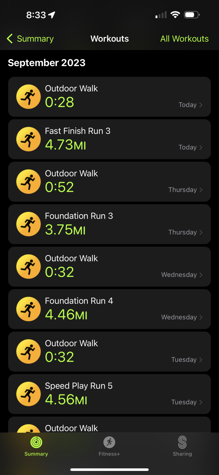

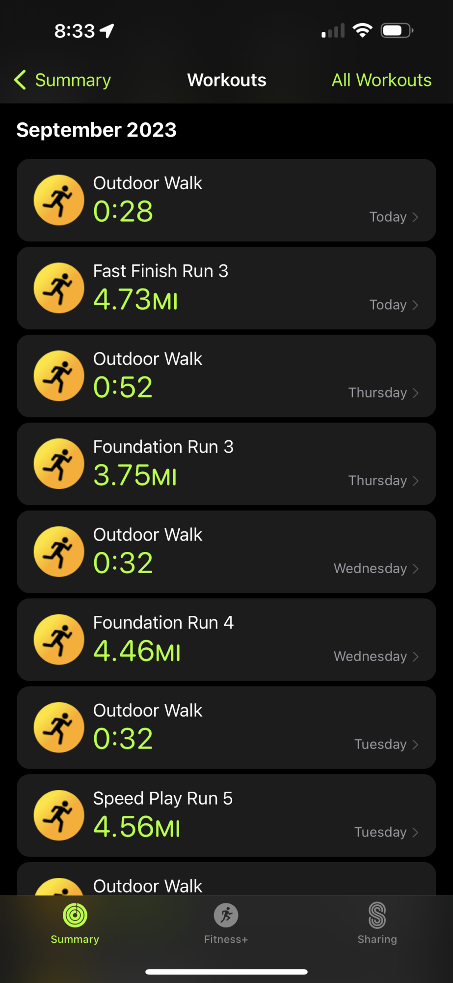

When you were struggling to end the workout what screen were you displaying when it didn't seem to recognise the long touch?
Since every time I pause I also get a screenshot I have the screen on the last pause I did before trying to end thd workout. The screen didn’t change after if not for updated position or time. I also sent the .wkt file.
As @Mitch8 says this sounds like a permissions issue where the app does not have the permission to save the distance information.
To check this go to the Settings app on the iPhone and select Privacy / Health / WorkOutDoors. Make sure that every health setting is enabled (you may need to scroll down to turn them all on).
If they are all enabled then you may be experiencing a rare bug with iOS/watchOS where the watch seems to lose the permission. To fix this switch all of the permissions off, then reboot both the iPhone and the watch, and then switch them all on again. This procedure nudges iOS into sending them to the watch again.
Thanks. Will give this procedure a shot since all permissions are on.

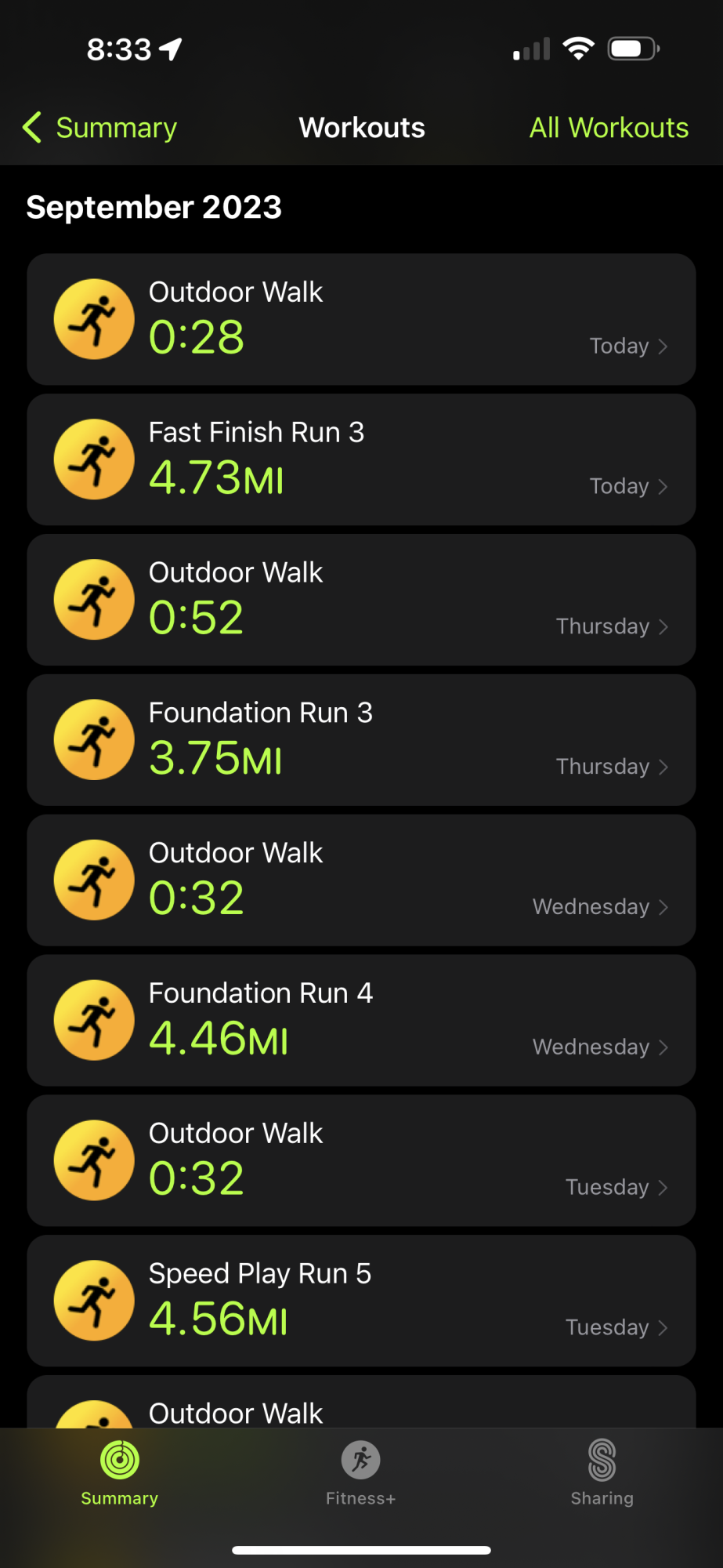

The interesting thing is that all my runs have no issues, and have the distance and pace included in Apple health, including runs on the same day as the affected walks. Only my walks don’t. And even with the walks, only walks in the last 2 days since the app update are affected.
Are there separate permissions for walking vs running distance/pace? Just trying to understand how a permissions issue gives this pattern of behavior.
That is strange. In theory walking and running distances are controlled by the same permission. However it is still worth doing the unset / reboot / reset procedure in case they are handled separately somewhere behind the scenes in Apple's code. I don't know why watchOS / iOS occasionally lose permissions, but that procedure fixes it and so may help here.
If that doesn't work then please could you send the wkt files for those workouts to info@workoutdoors.net. To do this tap the Export button 3 times quickly. All my test hikes and walks have distances, so it would be useful to see what is different about your walks.
Will do! Will get a chance to test it tonight. Really appreciate how responsive you’ve been, will do my best to stop bothering you! 😅

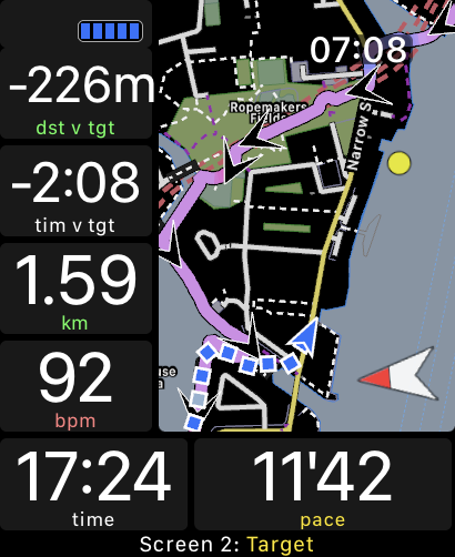

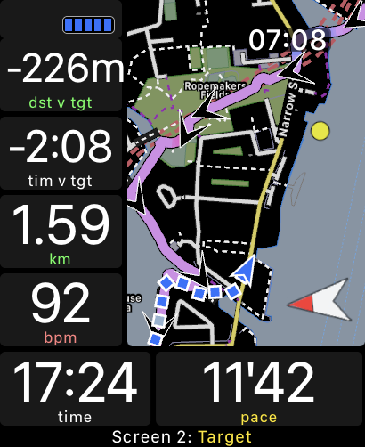

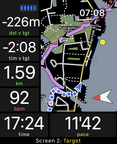

Another thing I observed, when using target, is that the yellow dot on the map, does not follow the route. My feeling is that it is show just at some point in front or behind you, but in a straight line I would say.
Am I correct? Is it on the plan to make it appear over the path you are following?
Thanks,
The yellow target dot is shown on your breadcrumb trail if it is behind you, but is extended out in the direction you are moving if it is ahead.
In theory if you are displaying a route and are currently on that route then the app could use the route instead of projecting ahead. However that would require it to know whereabouts you are on the route, which it currently does not know.
This should be possible after I have made the navigation improvements that are now top of my to-do list, because they will involve the app following your position on the route. However I can't yet say if I will implement it as part of those improvements. If I had to guess then probably not in the first version, but maybe after that.
Hi again! I did the privilege reset procedure, but unfortunately still had the same issue tonight. The run had no issue getting the data to Apple, but the walk has no distance, and consequently no pace. You can see in the screenshot here, all the runs have distance, but the walks have no distance, so instead their times are listed. Would you like me to send you any files or do anything to help test something with this? The problem doesn’t really cause me any issue, so if it’s too much work to look into this, no pressure or anything.
That is odd. Please could you send the wkt files for those workouts to info@workoutdoors.net. To do this tap the Export button 3 times quickly. All my test hikes and walks have distances, so it would be useful to see what is different about your walks.
