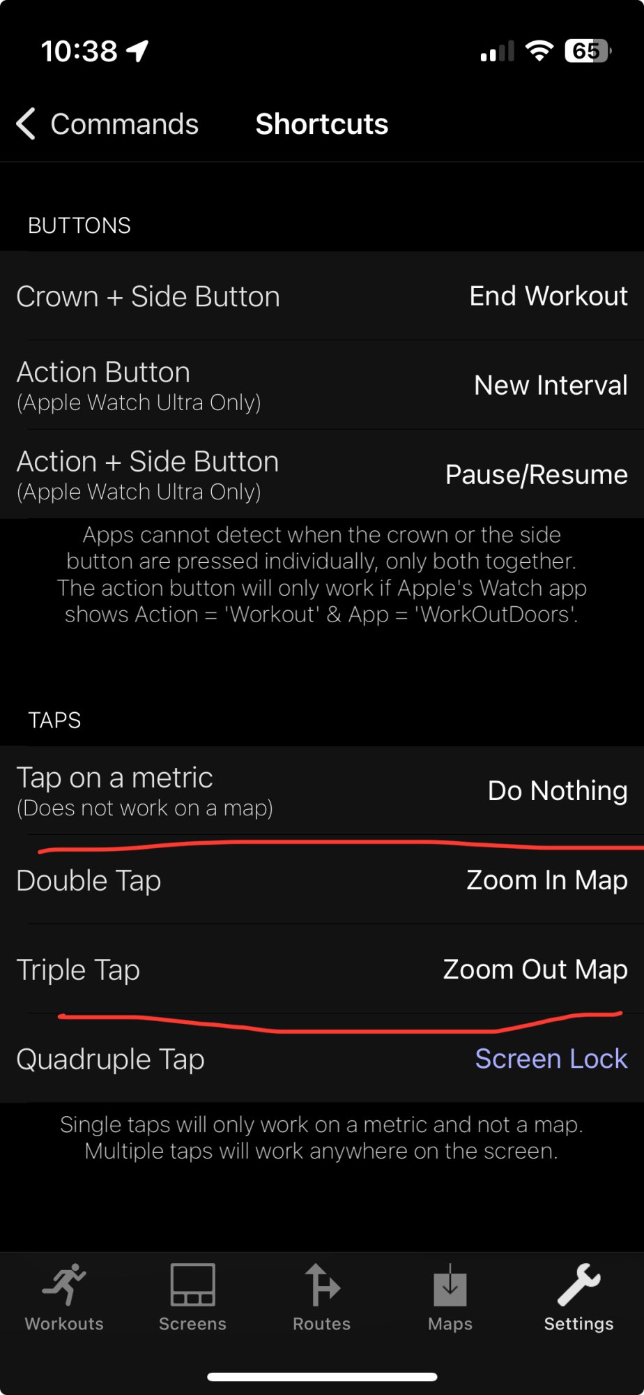

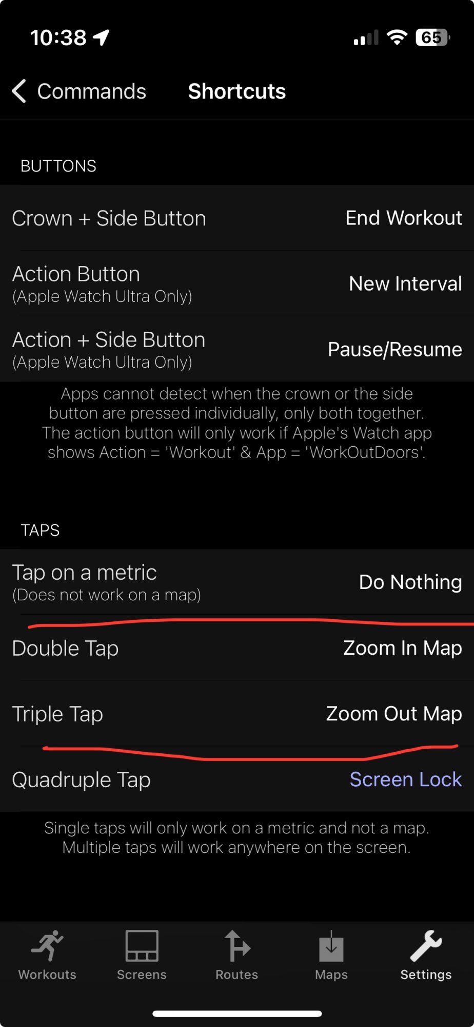

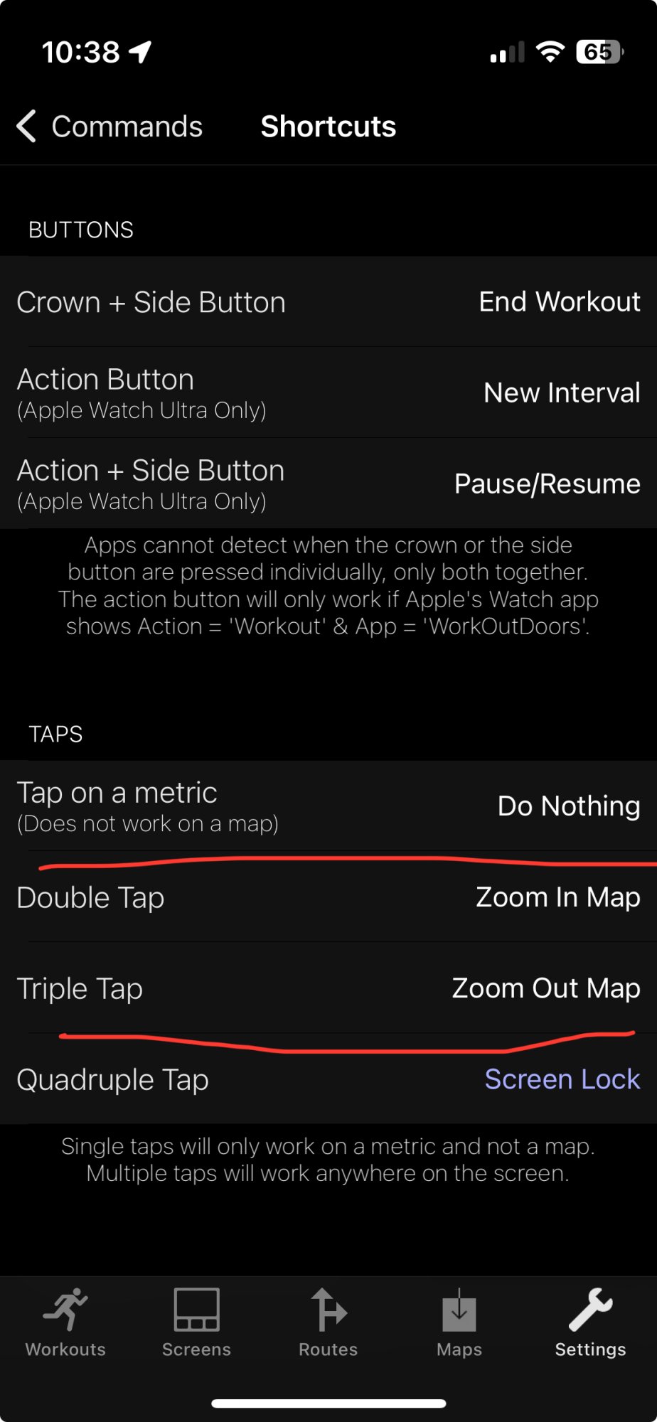

Hello! I'm having a problem, maybe a bug, for some weeks since the Always On support update I guess. I set double and triple tap do interact with map (for zoom in/out) since I use the crown to change screens, and it used to work fine. But this configuration is not working anymore, I spent sometime looking o the shortcut settings and it looks all right to me. Has anyone face this problem too?
Sorry that is a bug in the current version. It doesn't handle shortcuts for zooming so you can only use the crown.
I fixed it a while ago in the code, so it should be ok in the next version of the app, which will probably be released early next week (in time for when Apple release watchOS 10.1, because otherwise everyone's times will disappear!).
Reactions: Dovales

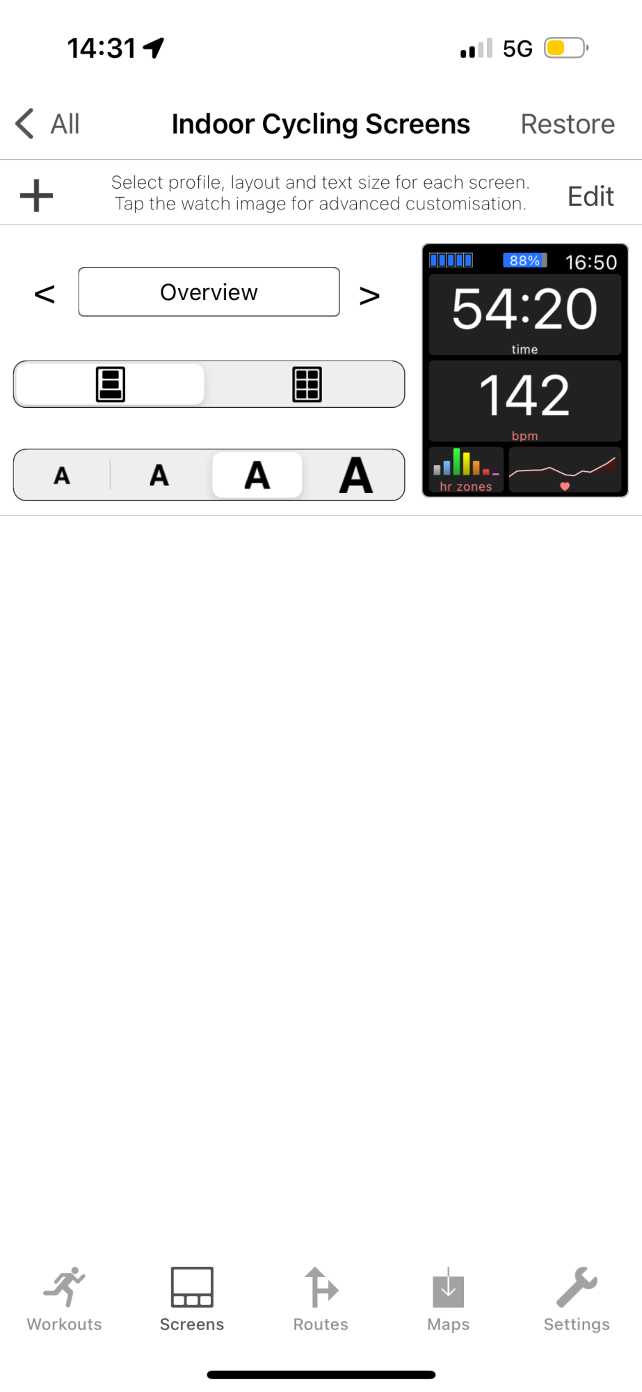

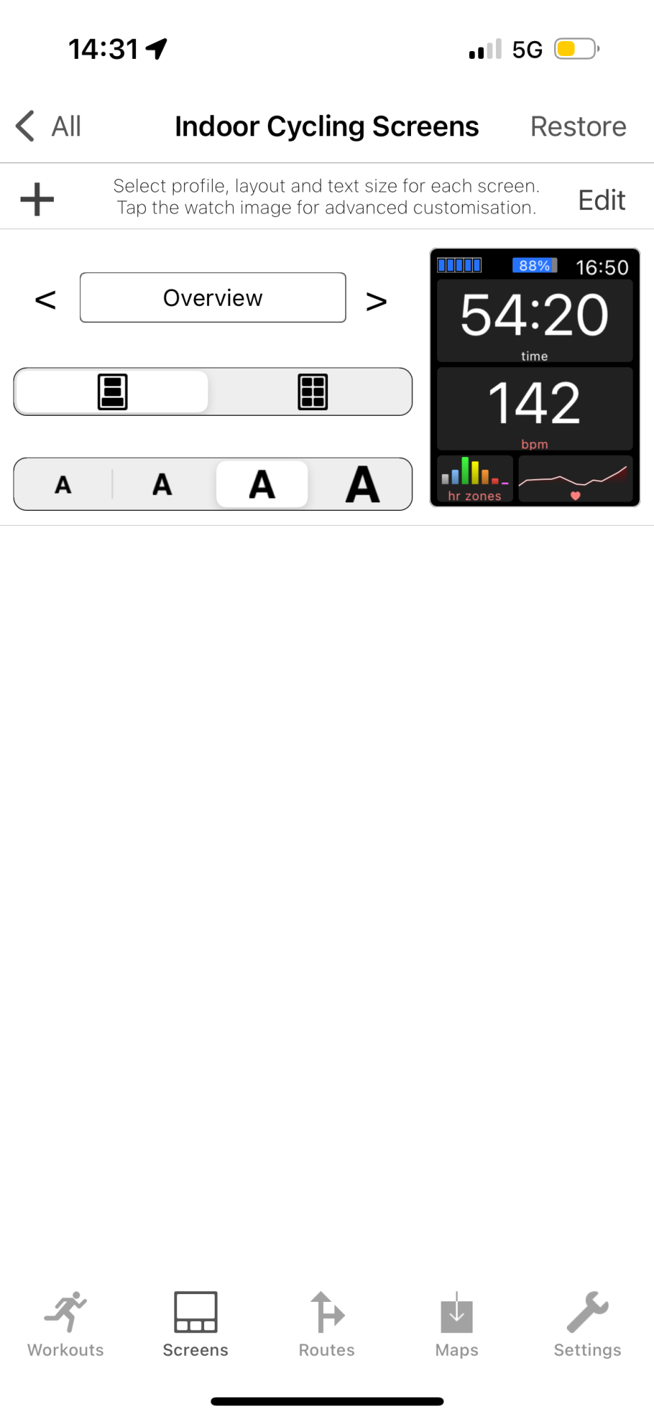

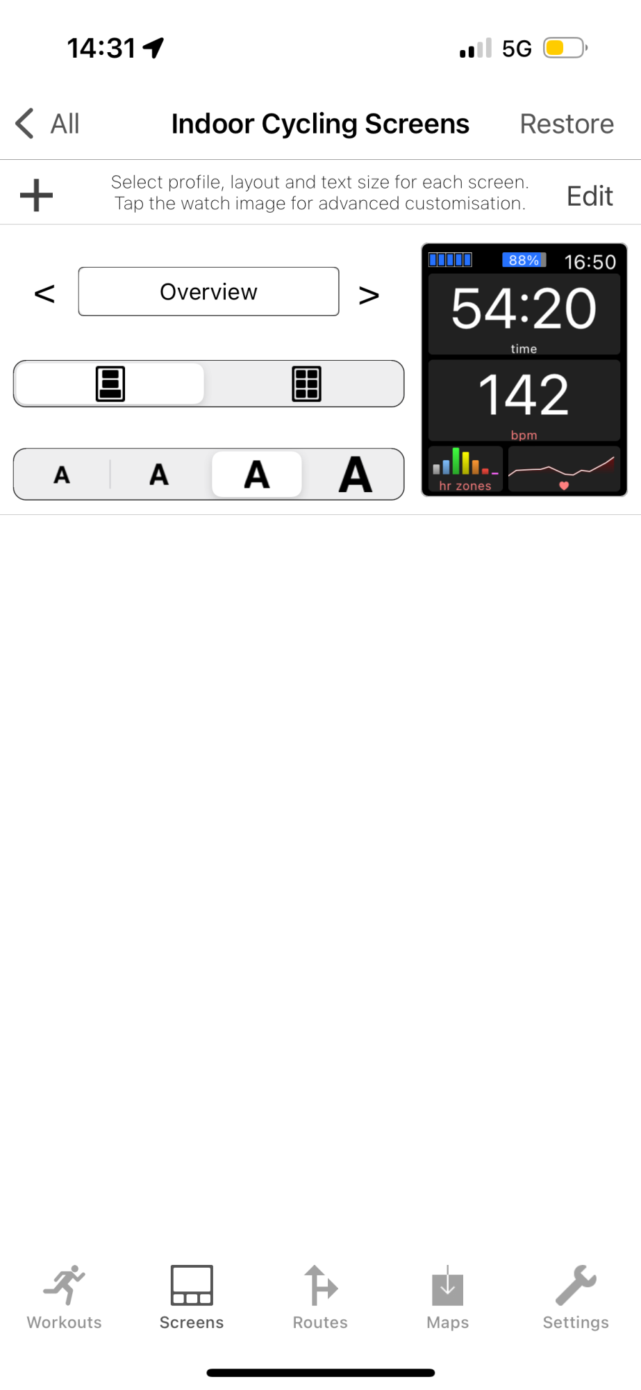

Hi @cfc I just upgraded to a new iPhone and migrated my data without issues. I then was prompted to pair my watch 8 to the new phone.
I opened the WOD app on the iPhone and can see all my workout history. However when I open WOD on the watch, there is no history and all of my preferences / screens are gone.
Is there a way to restore please?
You can send the data from the iPhone app to the watch app by going to the Settings tab and tapping File Management and then "Send Yesterday’s Watch Settings", "Send Screens to Watch” and “Send Interval Schedules to Watch”.
If you want then you can also send routes or workouts individually. They can’t all be sent at once because they are too large.
Thanks @cfc. FYI sending yesterdays settings kind of worked. Showed the right workouts on the Home Screen but the screens are still different to what is in the WOD app. See example cycling screen screenshots. Different on watch vs what’s on phone. (Phone data is correct
Did you tap "Send Screens to Watch"?
