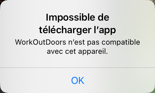

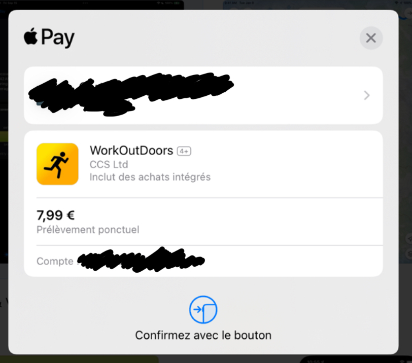

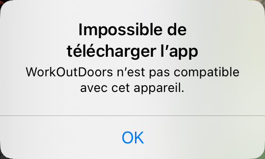

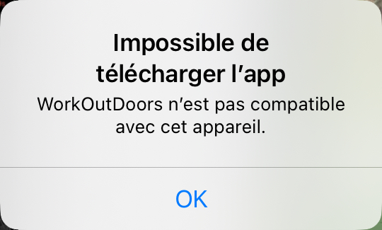

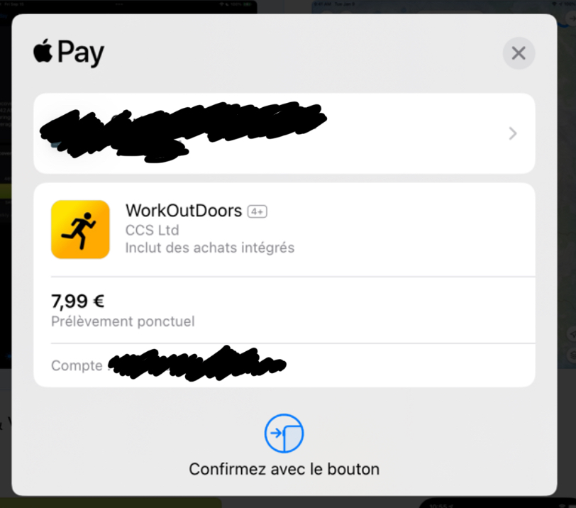

Hello cfc, why I have to pay the iPhone app on iPad whereas I have already paid for the iPhone app on iPhone ?
how to get the iPhone app on my iPhone without payment ?
The app has never been available on the iPad but for some reason a few people have asked this in the last few weeks so maybe Apple have changed something which makes it appear on the iPad App Store.
You would probably find that if you confirmed then it would say that you have already purchased the app. This is what happens if you buy the app on the iPhone and then again on the watch. I don't know why Apple can't tell you earlier in the purchase process. However don't try that because there isn't an iPad version of the app.
I understand there is no app for iPad, but Apple allow the iPhone app on iPad by filters on AppStore.
You know what, I will go to the end of the process to know, if I pay something it will be like a tip for you
Thanks for trying that; it's useful to know that the App Store realises that the app is not compatible with the iPad.
Maybe there is a bug in the App Store app recently which makes it seem like it is available on the iPad. No-one has mentioned trying to install the app on the iPad for years and then suddenly 5 or 6 people have asked about it in the last couple of weeks.

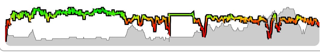

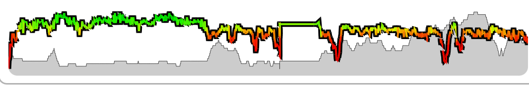

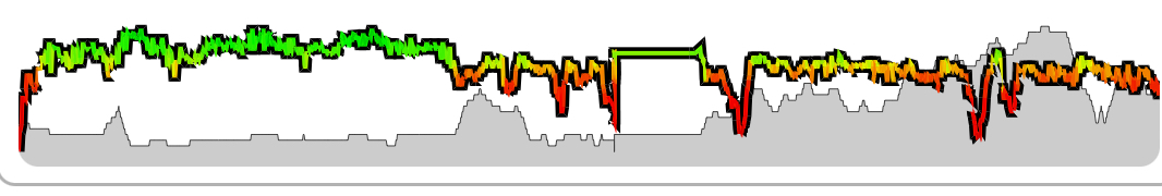

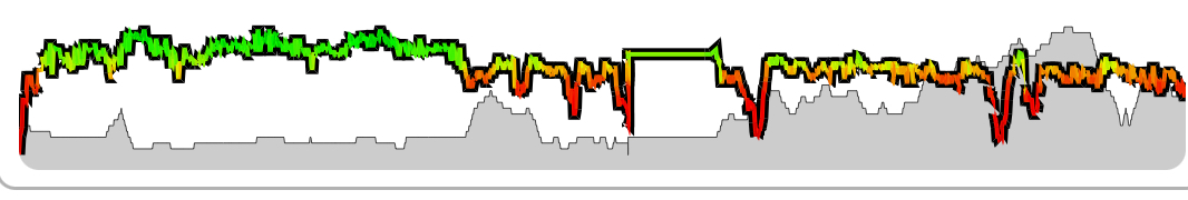

To help you to understand the motivation of that, I wanted the app on iPad to see better the route I created.
Also to see better the graph (don’t know the word in English, sorry)
An other question, does it possible to smooth the line of the graph ?
You could change Map to Map & Profiles, which shows 5 lines of the profile instead of the one in your screenshot.
I don't have any plans to smooth the pace graphs. Sorry.
