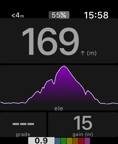

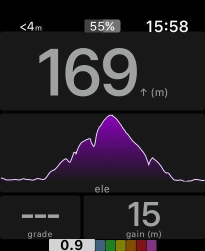

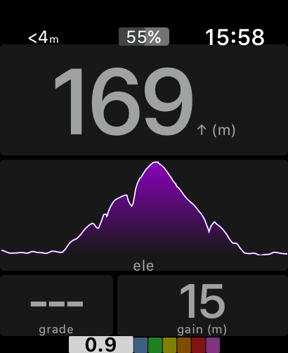

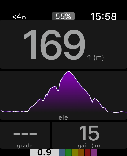

Today i did a walk to a hill for 5km, and exactly the same 5km way back. But why is the altitude graph so out of asymmetry ? I didn‘t use Allways on Altimeter.
Usually those sort of differences are caused by air pressure issues. The app uses the barometer by default and this can be affected by weather. That usually results in a smoother difference (e.g. the slope looks steeper on one side than the other) but windy conditions can also cause small dips and peaks.
Also did you maybe go indoors on the hill, or were you using a case on the watch, which can cause issues with the air pressure sensor?
The app just uses the values supplied by the barometer, so it's impossible to know what caused the asymmetry. You may find that enabling the always on altimeter (Settings / Other Settings) helps, but be aware that can jump at times for some reason (presumably watchOS recalibrating), which is why it is not the default.

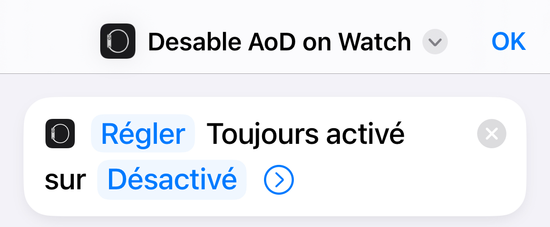

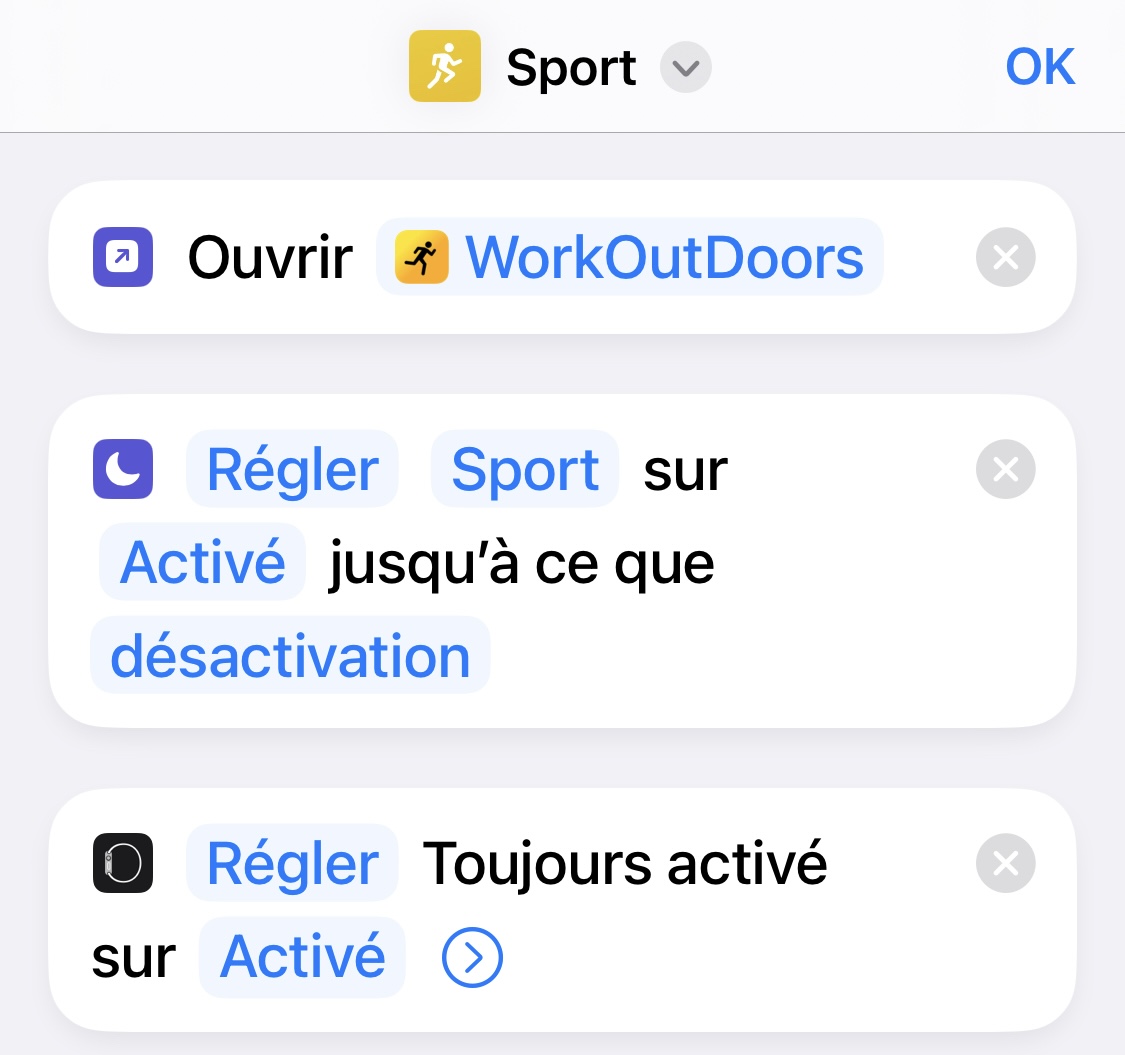

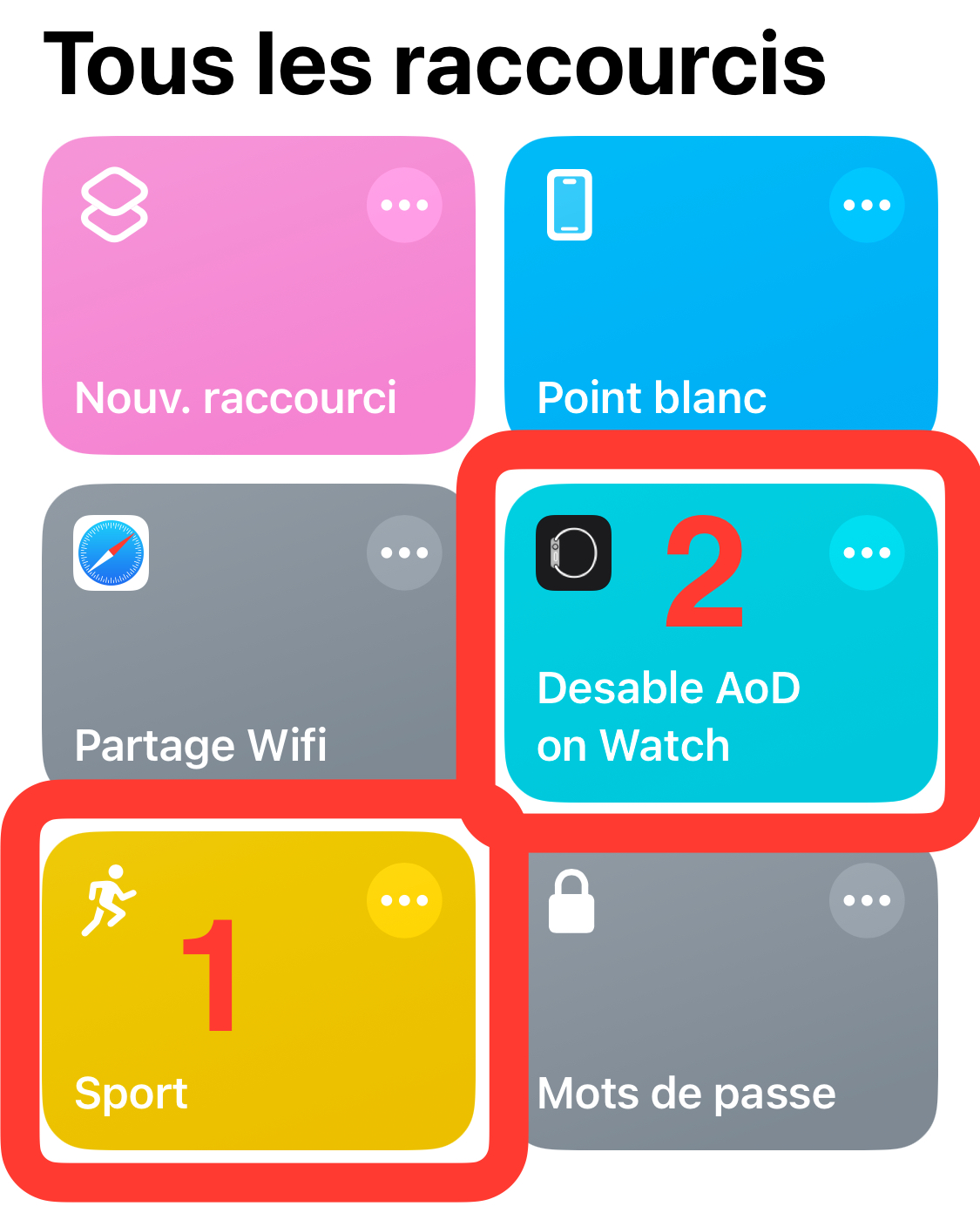

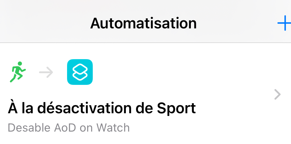

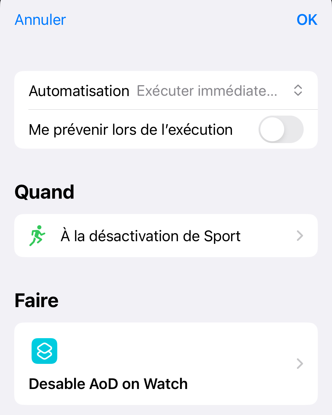

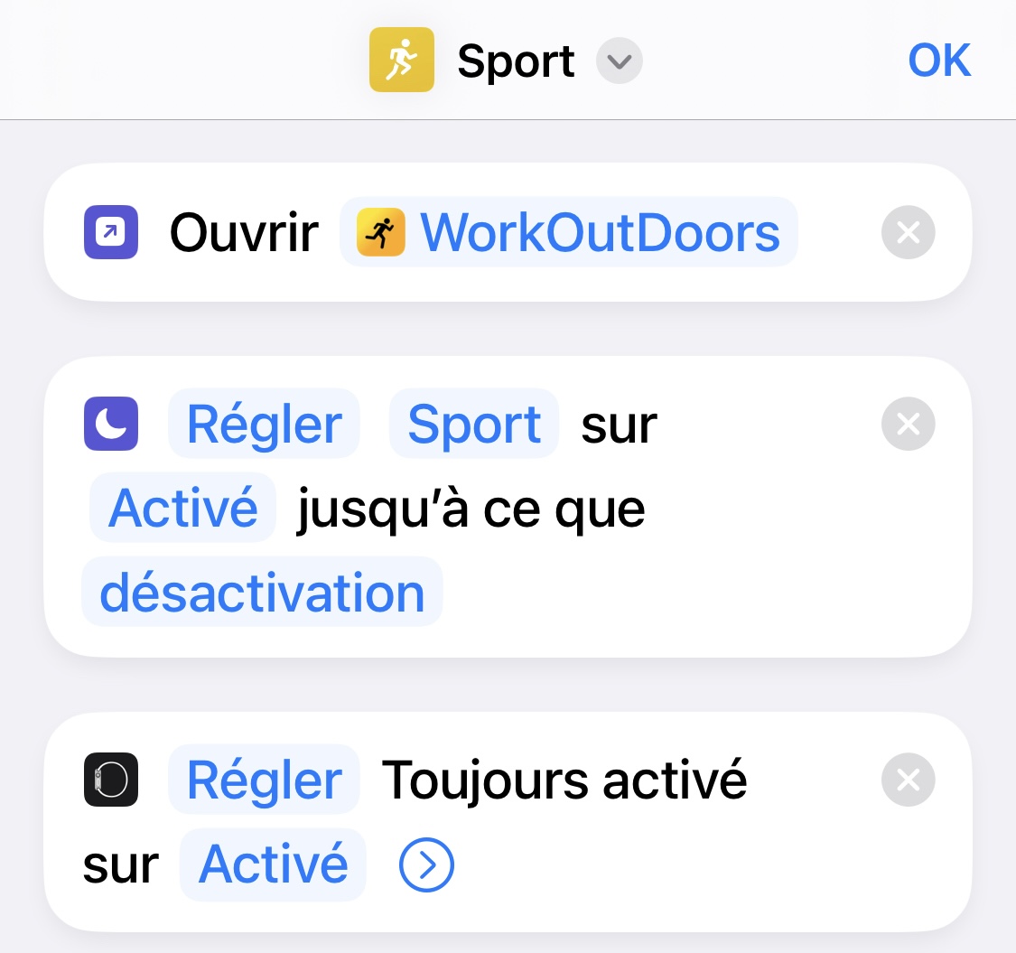

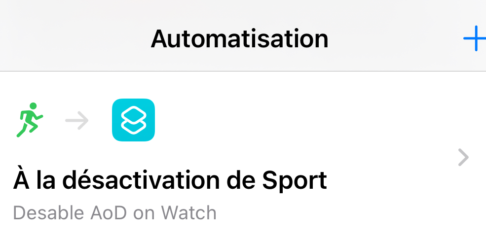

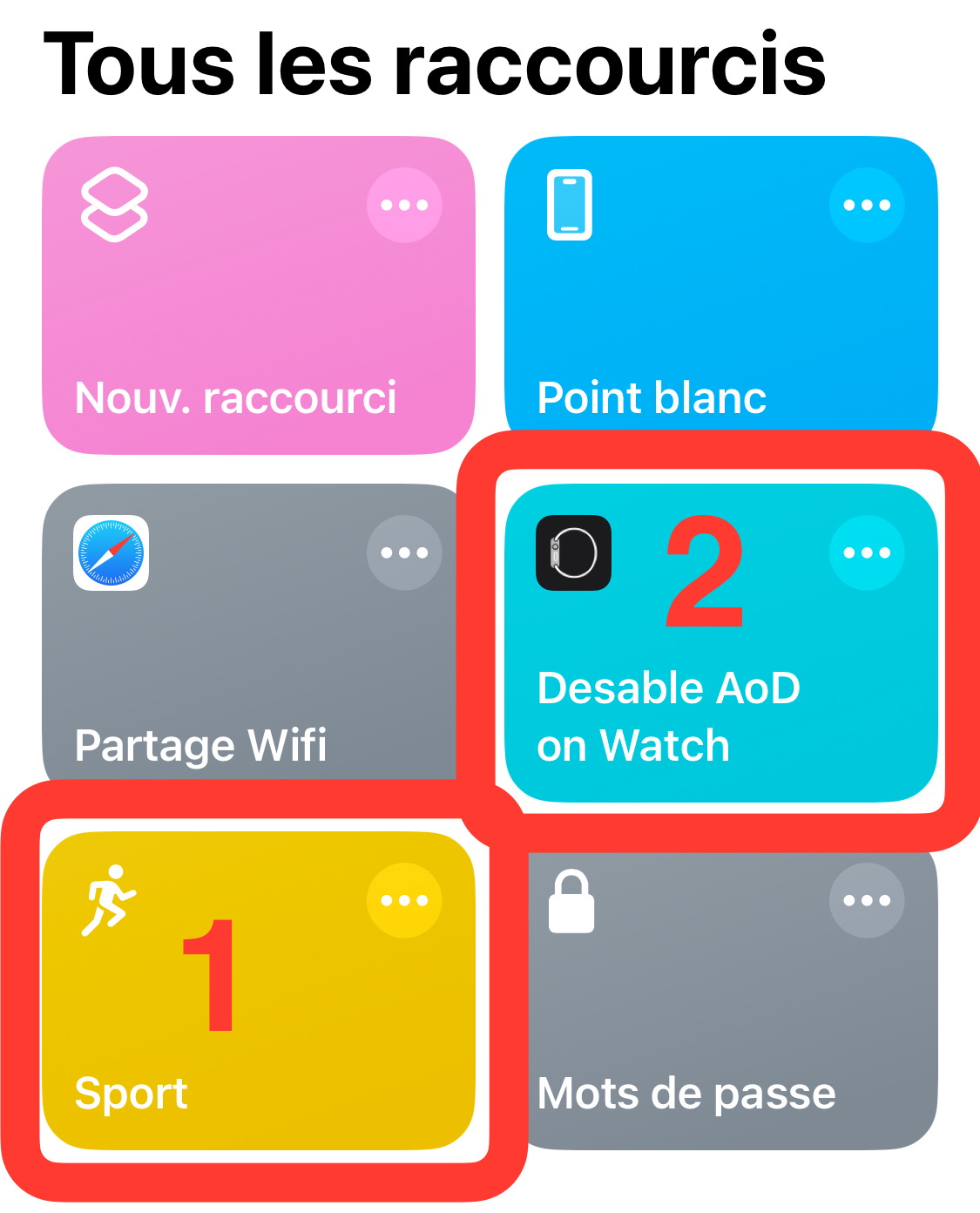

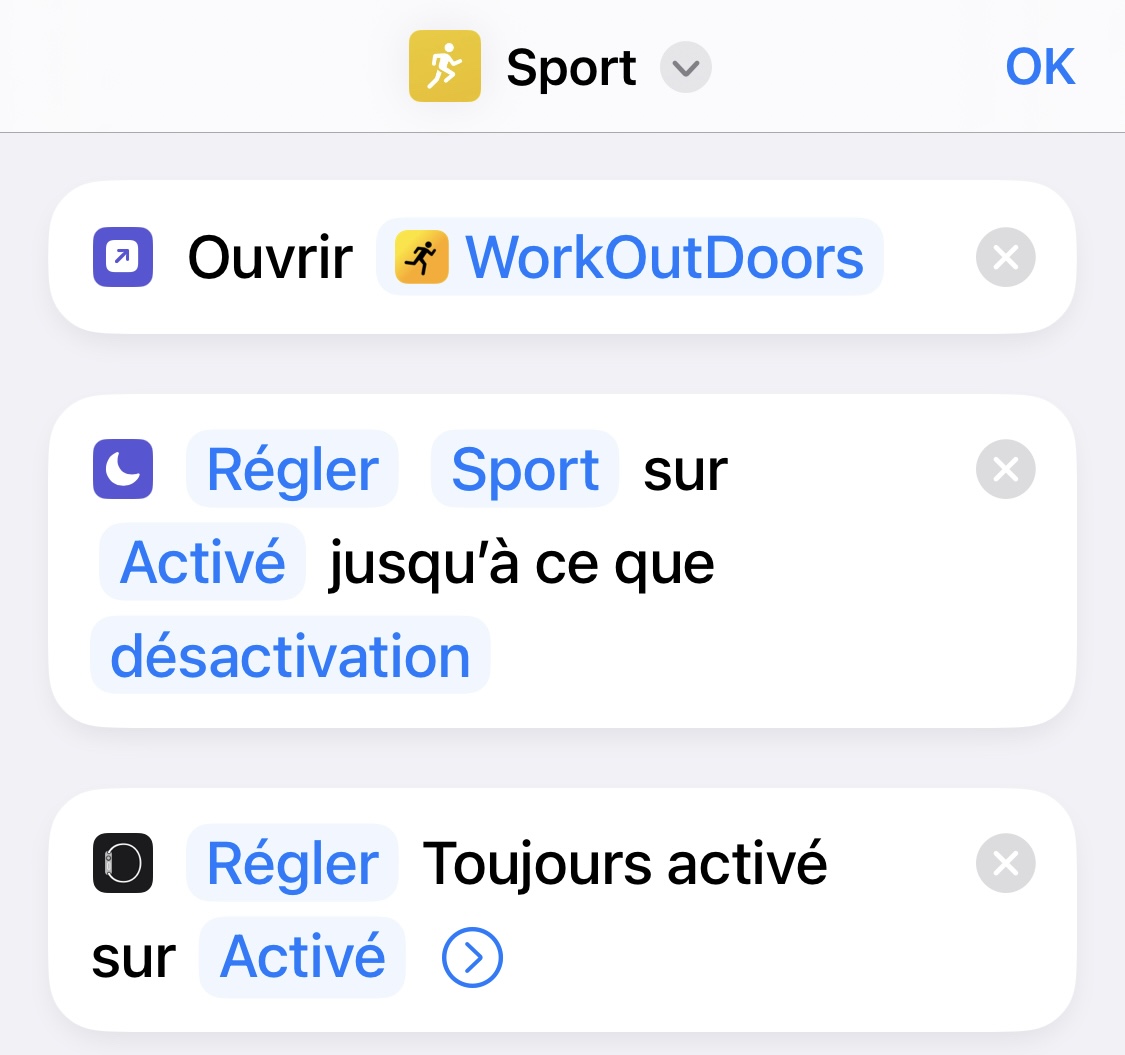

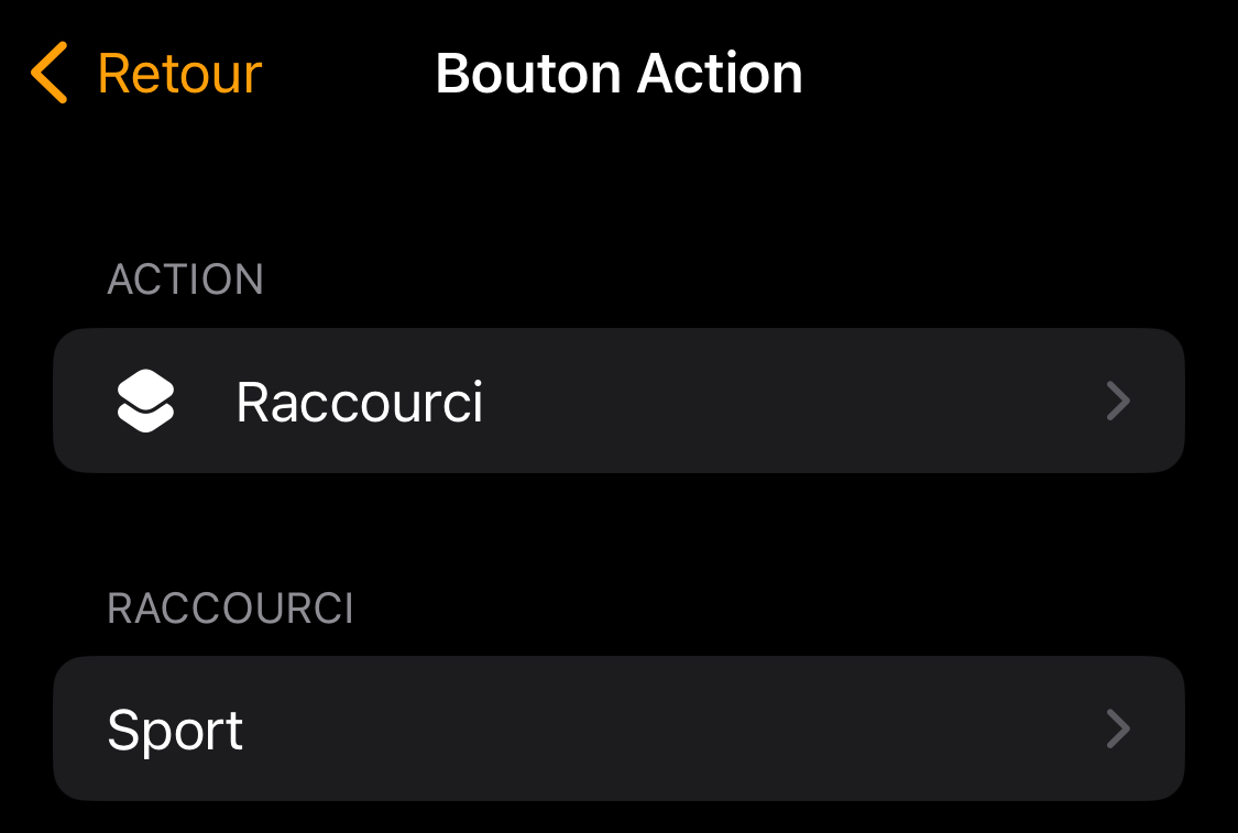

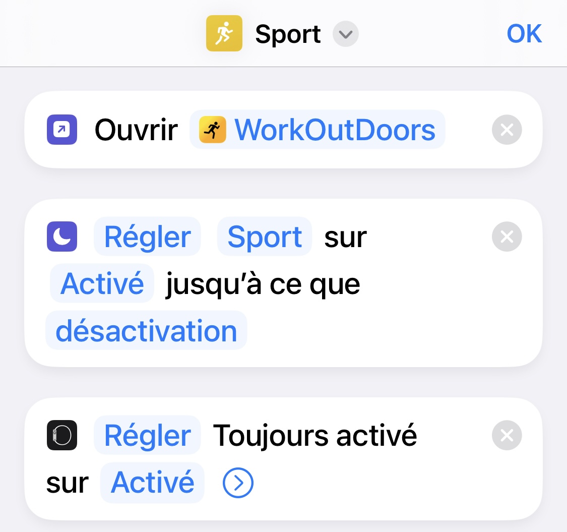

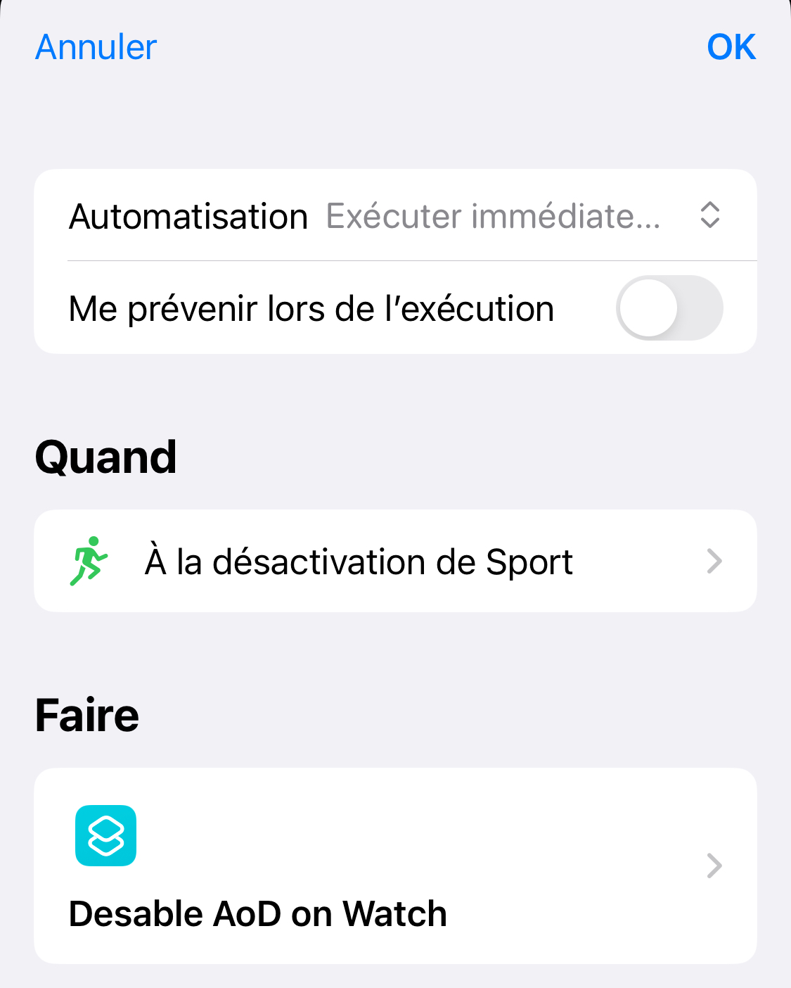

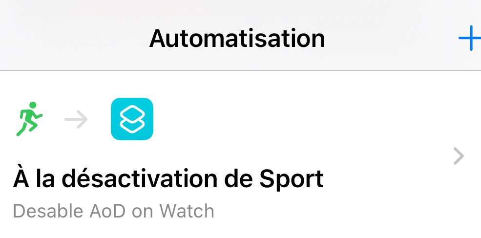

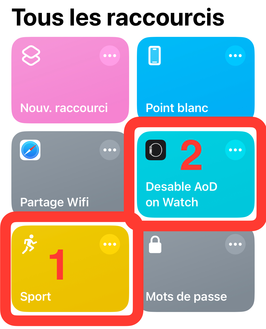

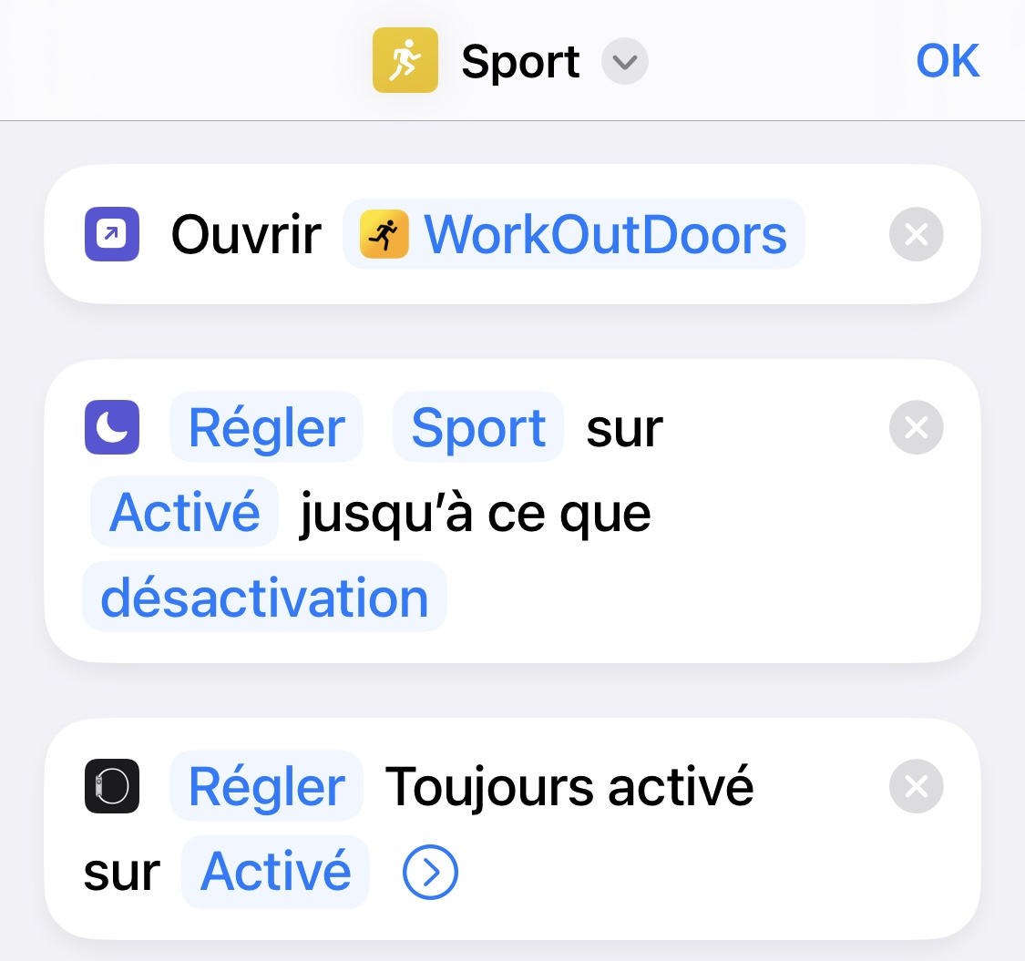

An other idea for you.
Enable always on display on watch only when we use WOD.
I don’t use AoD the day, but for WOD it’s better.
I made a shortcut a little tricky and here is my explain :
when I use WOD I set my concentration in « sport »
1/ Enable AoD
Create a shortcut #1 « sport »

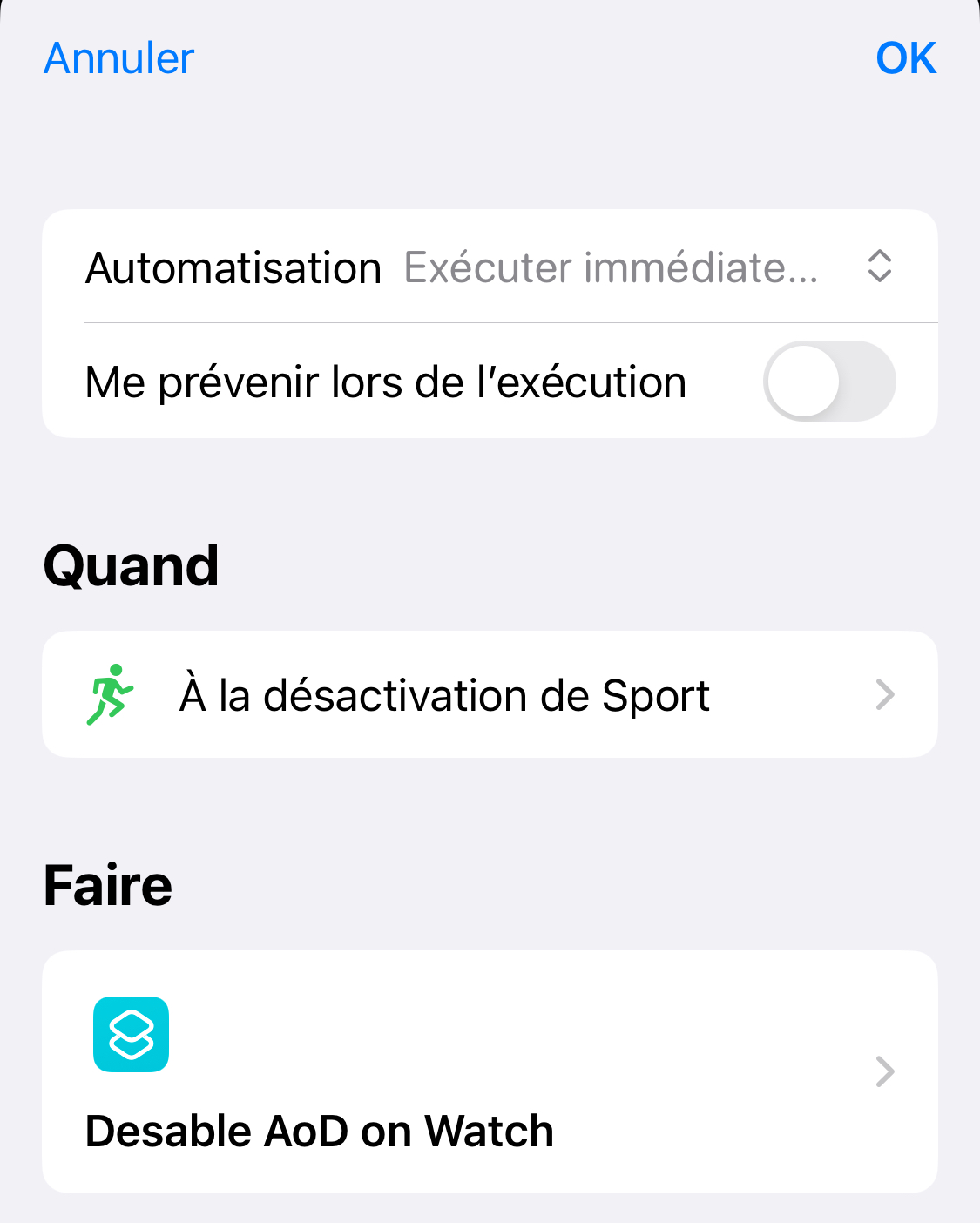

2/ Desable AoD
Create a shortcut #2 « Desable AoD »
Create an automation
Then when you desable sport’s concentration, the Apple Watch syncing and desable always on display to.

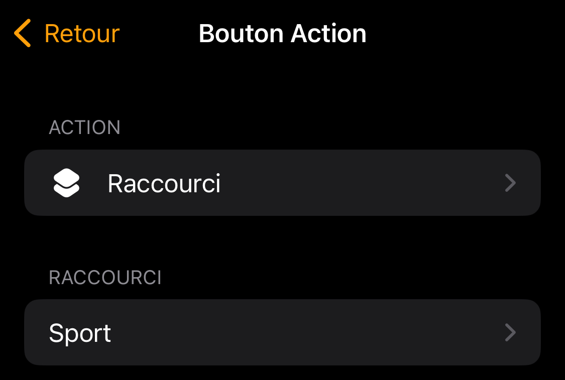

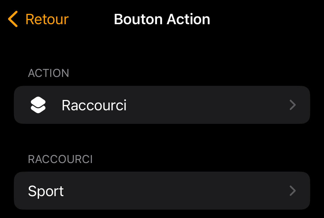

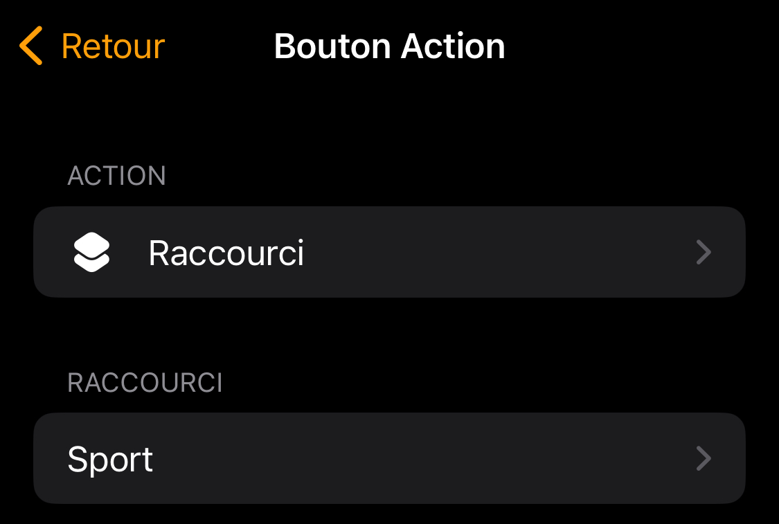

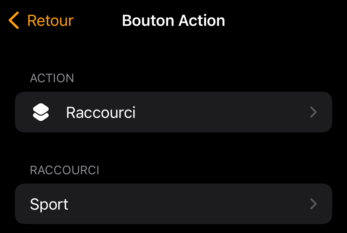

One more thing :
Select the shortcut on Apple Watch Ultra button
Reactions: Miggui and cfc

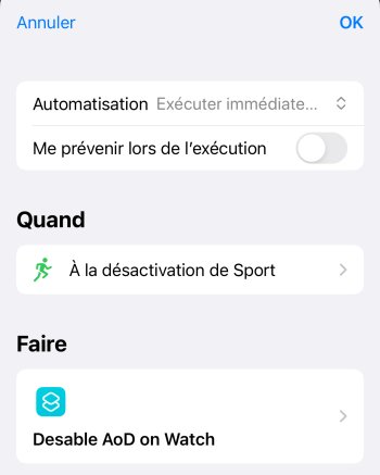

1/ Enable AoD
2/ Desable AoD
One more thing :
Thanks for that shortcut. Unfortunately the app cannot use the always on display if it is disabled in watchOS, so that is very useful.

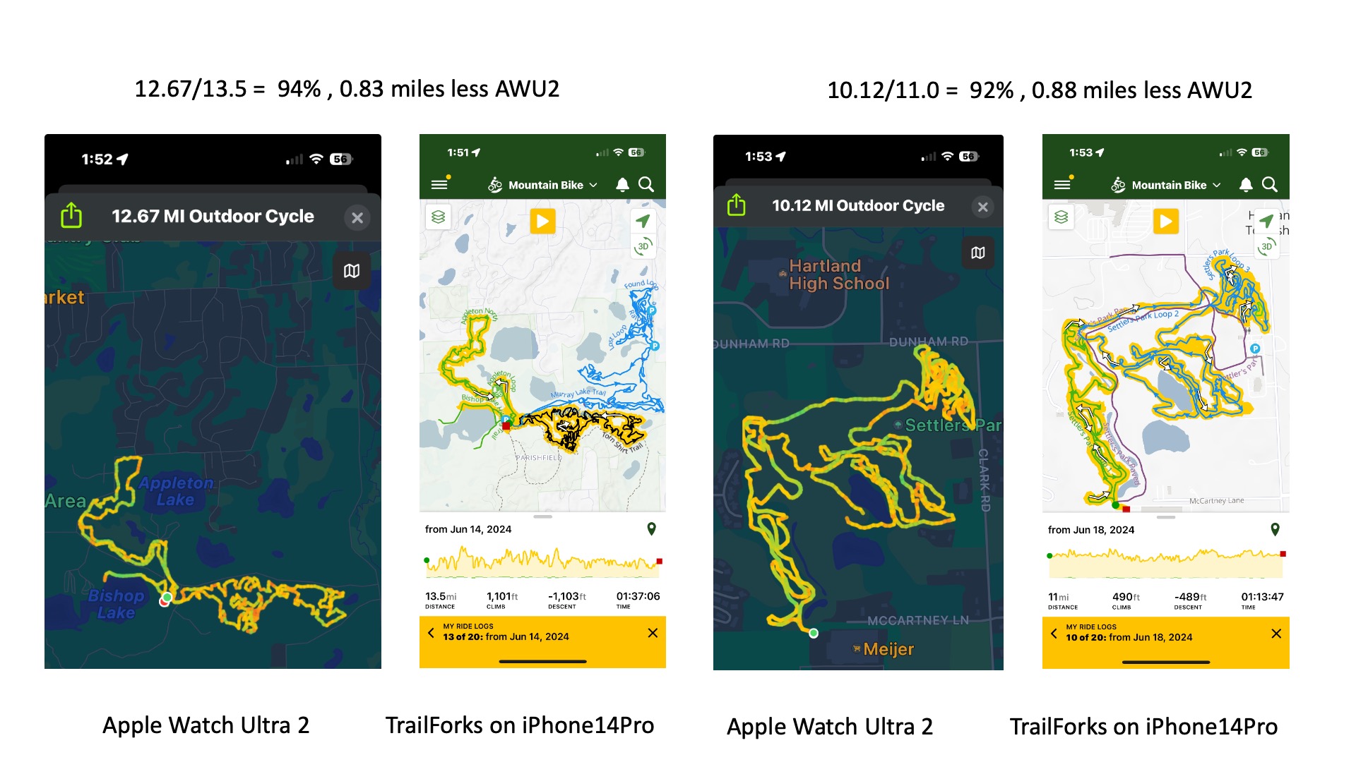

Hi, I just came across this thread.
What are the Apple Watch gps sampling rates while using workout app, specifically cycling?
the below is Trailforks and it’s settings options, I’d like to know Apple Watch settings
In my experience the "CoreLocation" framework which iOS and watchOS provide to developers gives location updates every 1 second.
This can be affected by a few parameters which the app can set, such as the desired accuracy and the "distance filter" (how far the user should move in order for a location to be reported to the app). However if the app asks for the best accuracy and doesn't set a filter then it will receive updates every second.
That is what happens with WOD and as far as I know it is the same with other apps.
Reactions: mtbdudex

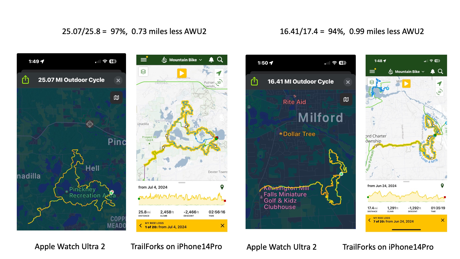

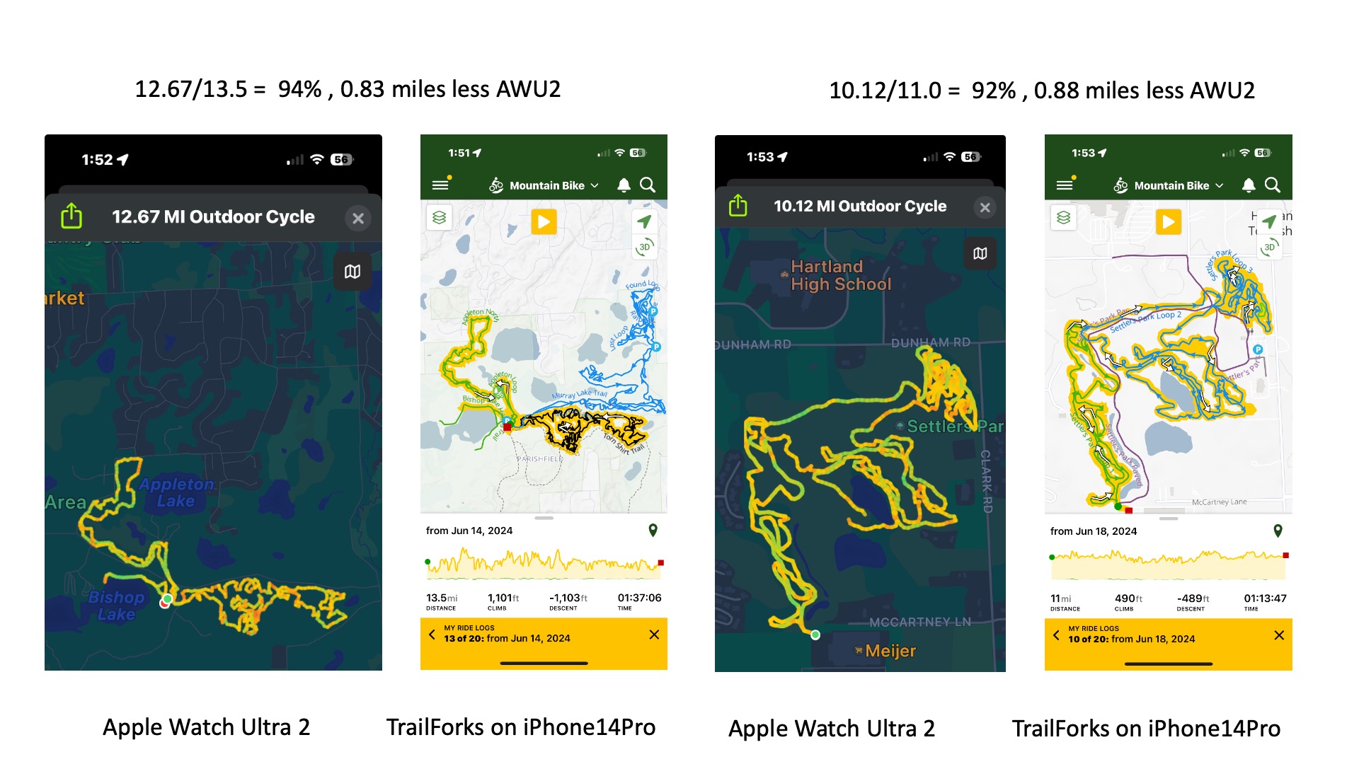

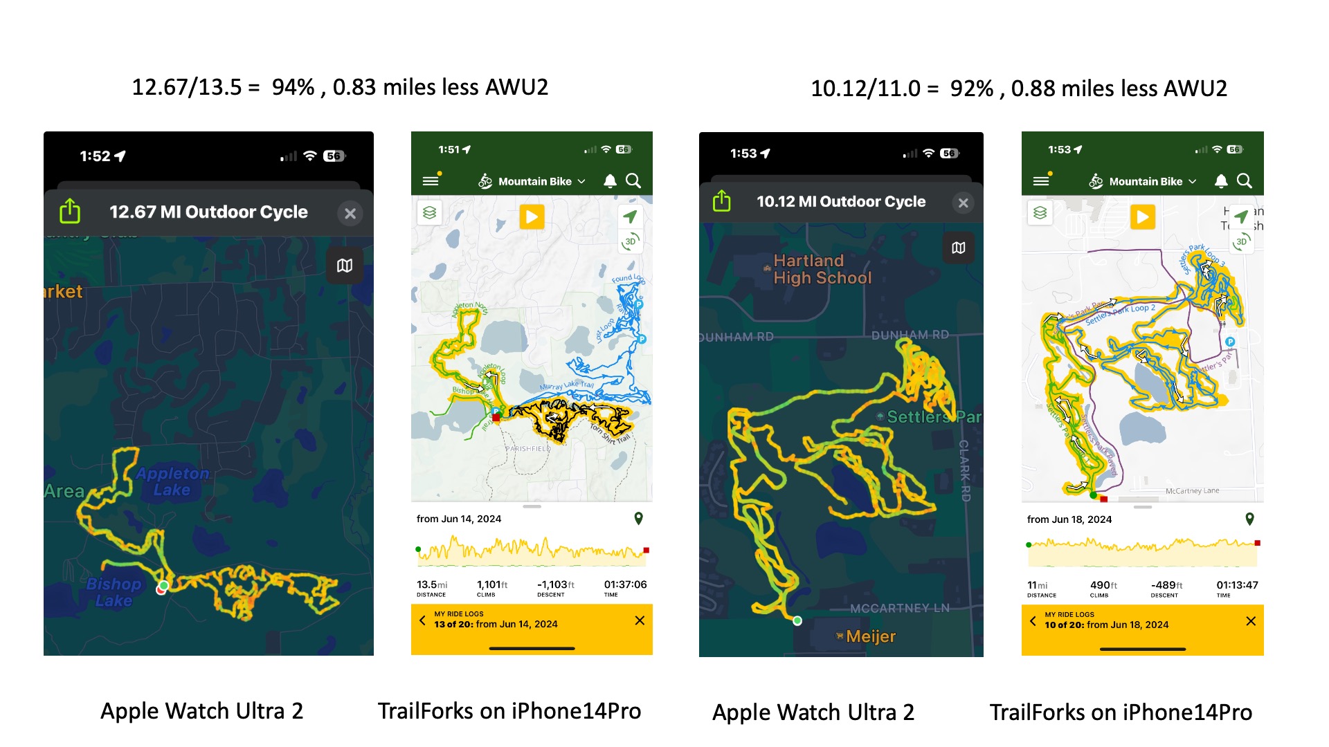

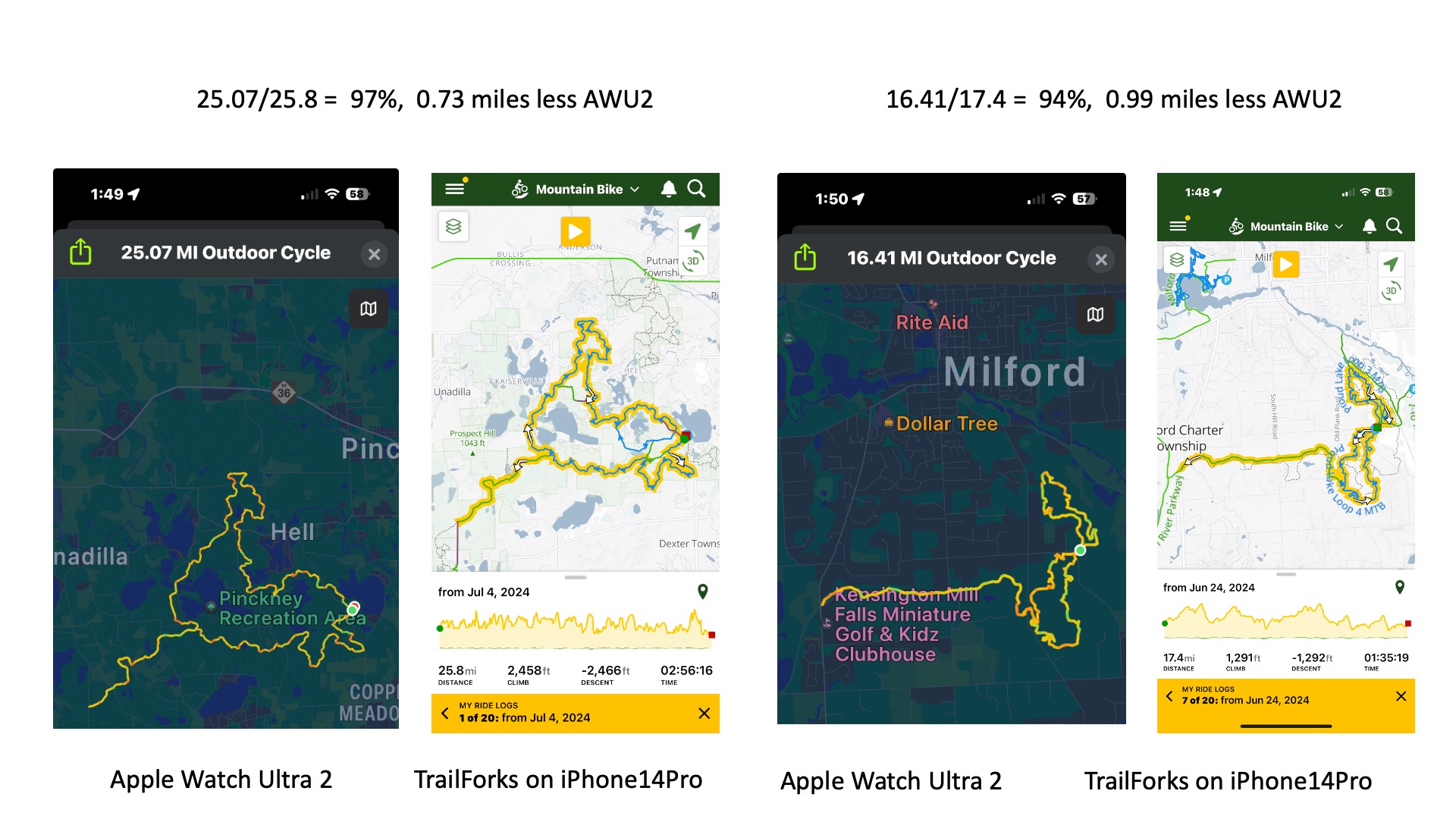

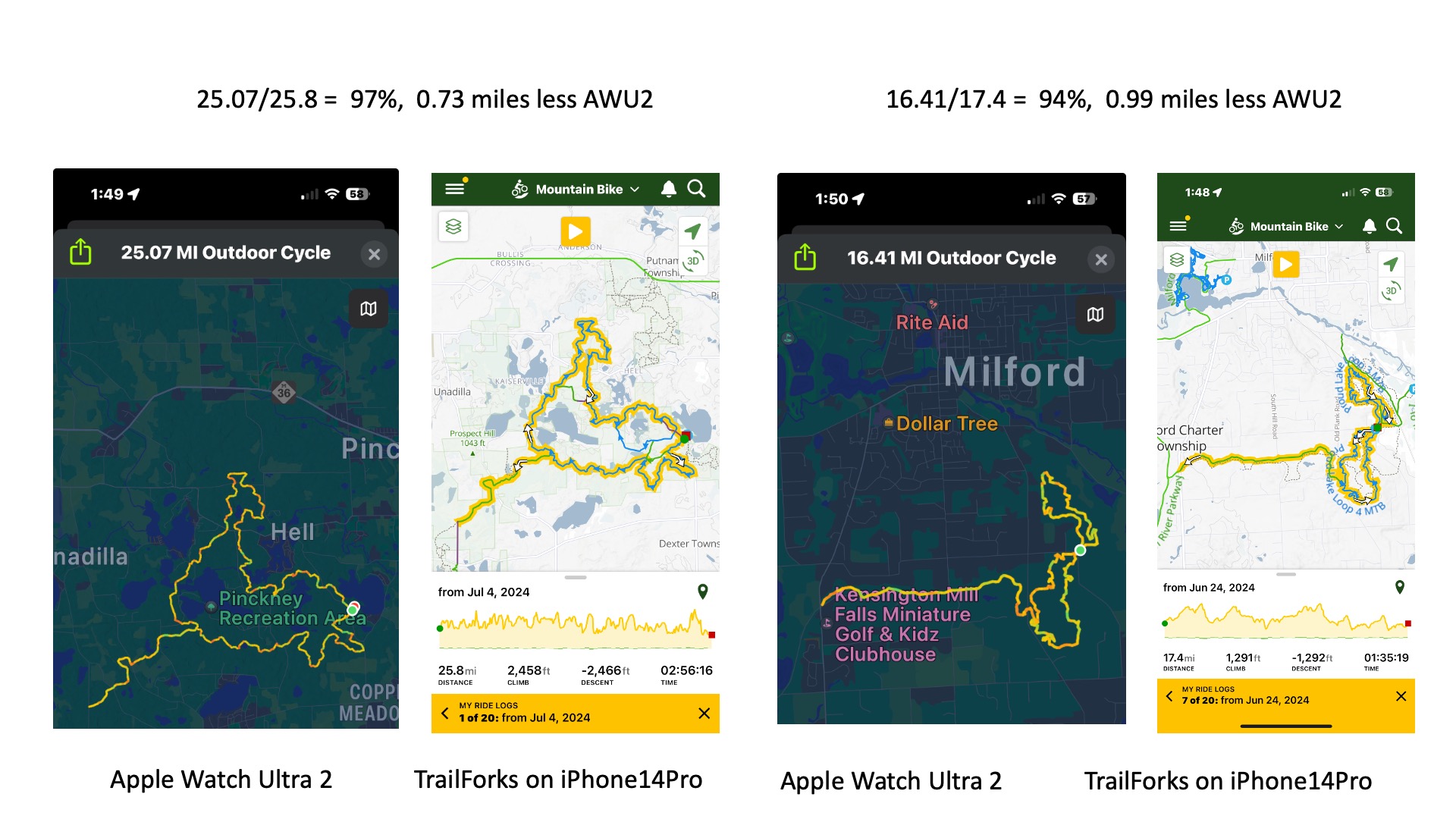

If the AWU2 is sampling every second, is there some known reason why it’s less accurate than the iPhone 14 Pro?
I use both when biking, the watch on left wrist face top of wrist, the iPhone mounted to Thule bike mount center.
Made comparison info;
View attachment 2402942View attachment 2402943
GPS locations are received every second in WorkOutDoors but I can't speak for what other apps are doing. They may be requesting lower accuracy or using a distance filter to save battery.
Please note that GPS is not a good way to measure distance on a very twisty route. GPS is inherently inaccurate so apps need to smooth out the inaccuracies. This works fine in most circumstances but can be inconsistent on very twisty routes.
The only way to get a truly accurate distance on routes like yours is to use a wheel sensor that counts rotations and has a correctly entered tyre diameter/circumference. WorkOutDoors will connect to such sensors. Otherwise the app allows you to use the distances supplied by watchOS (which is the default and what Apple's Workout app uses) or you can use GPS (which may be what TrailForks are using but I can't say).
I assume that watchOS also uses GPS but has a different smoothing algorithm to TrailForks. In 99% of routes this will make no difference, but on a very twisty route it can make a big difference. It is probably impossible to know which app is correct without using a wheel sensor to check.
Reactions: mtbdudex
You use 2 different apps to compare gps precision.
It’s not valid …
Apple workout app does a lot of location smoothing /filtering to show nicer and lighter routes.
For running, gps is not very calculate speed and distance, it’s better to rely on Apple calibrated runningDistance and runningSpeed HealthKit values which mixes pedometer and GPS
What gives you the impression the phone is more accurate? The watch has dual-band GPS which the phone does not. How have you verified that one is accurate and one is not? In my experience, at least with running, the Apple Watch (all of them) is more accurate than the phones. My Ultra 2 using WOD hits right on the timing mats on certified running courses all the way up to the final mile on a half-marathon. When running in the neighborhood I'll sometimes make a point to randomly zigzig from one side to the road in sync with telephone poles or manholes just to see how accurate the track is after the run and it's dead on.
Reactions: cfc
Seems iPhone 14 Pro has a better GPS chipset than previous models:
Reactions: cfc
