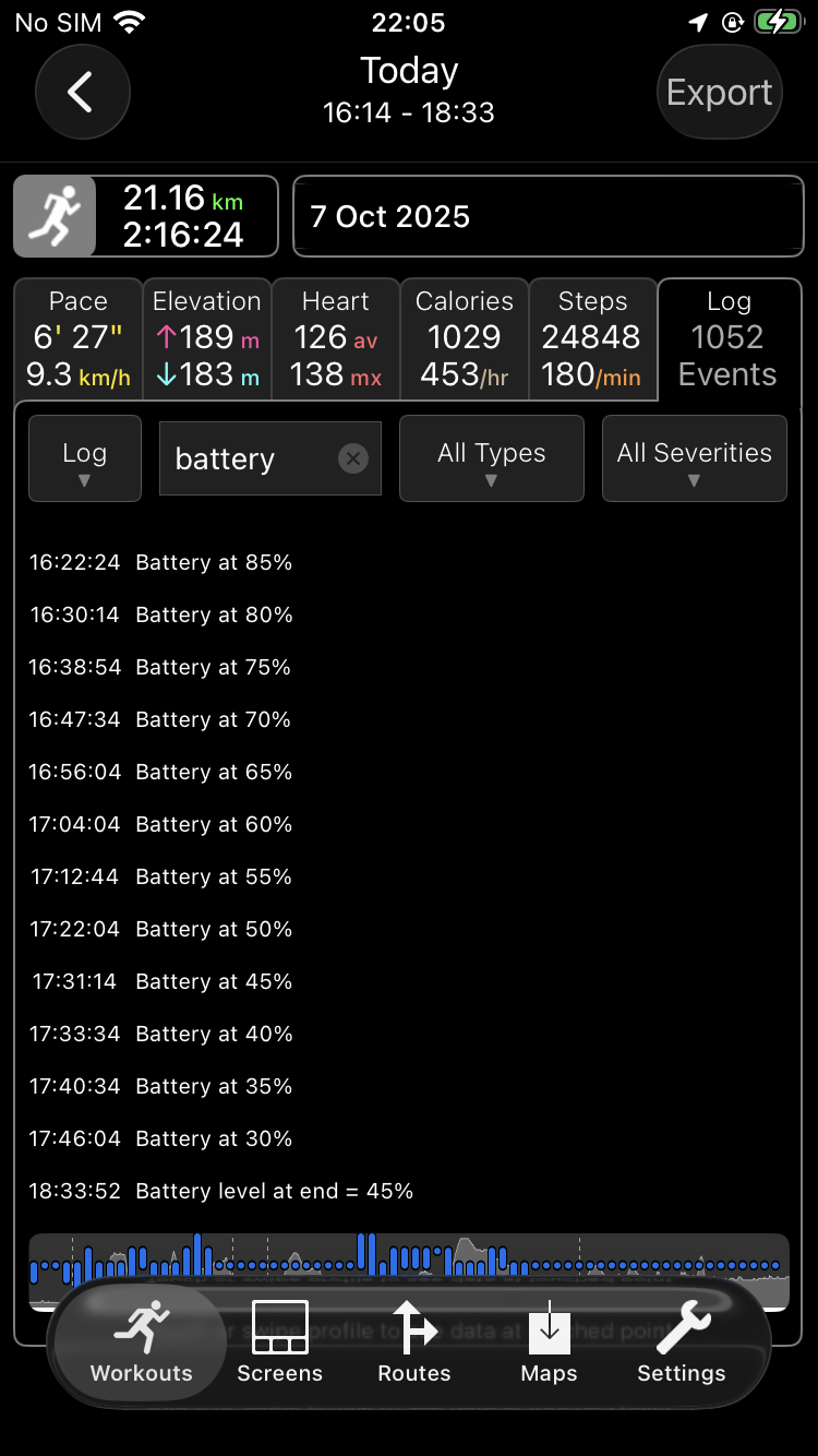

The app notes the battery level changes in the Log (on the last tab of a workout).
Using your watch over a sleeve so it has to use "full blast" seems a bad example. It is not designed to be used like that.
It sounds like you should be connecting to the external HR sensor via watchOS. If some reason watchOS is still getting values every few seconds despite being asked not to then that is the solution.
Nice, I didn't realize it was user accessible, I like it.

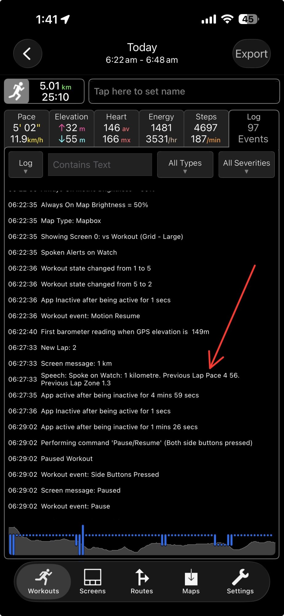

I also want to flag issues with the voice notifications since WatchOS 26 / latest WoD versions. I have been using WoD almost daily for 4 years and apart from the ducking issue during the first few kms of a run haven't really had any issues. For the last couple of weeks, when I go on a run with just my watch and listen to music or podcasts, the voice notifications just don't work at all. I have restarted the watch (AWU1) and it worked on one run but all other runs it does not announce at all. I've tested every combination of voice settings and observe the following:-
  • If I carry my phone and set the device to iPhone it works every time
  • If I carry my phone and set the device to watch I hear the announcements on the watch and the podcast from the phone
  • The interactions (mix/duck/pause) don't seem to make a difference.
This is a real problem as the main use-case for me is to go for a long run and rely on the voice alerts to guide the workout. Voice really doesn't work at all if I don't have my phone.
Here is my last run with no voice - you can see it is trying and the podcast carried on unabated.

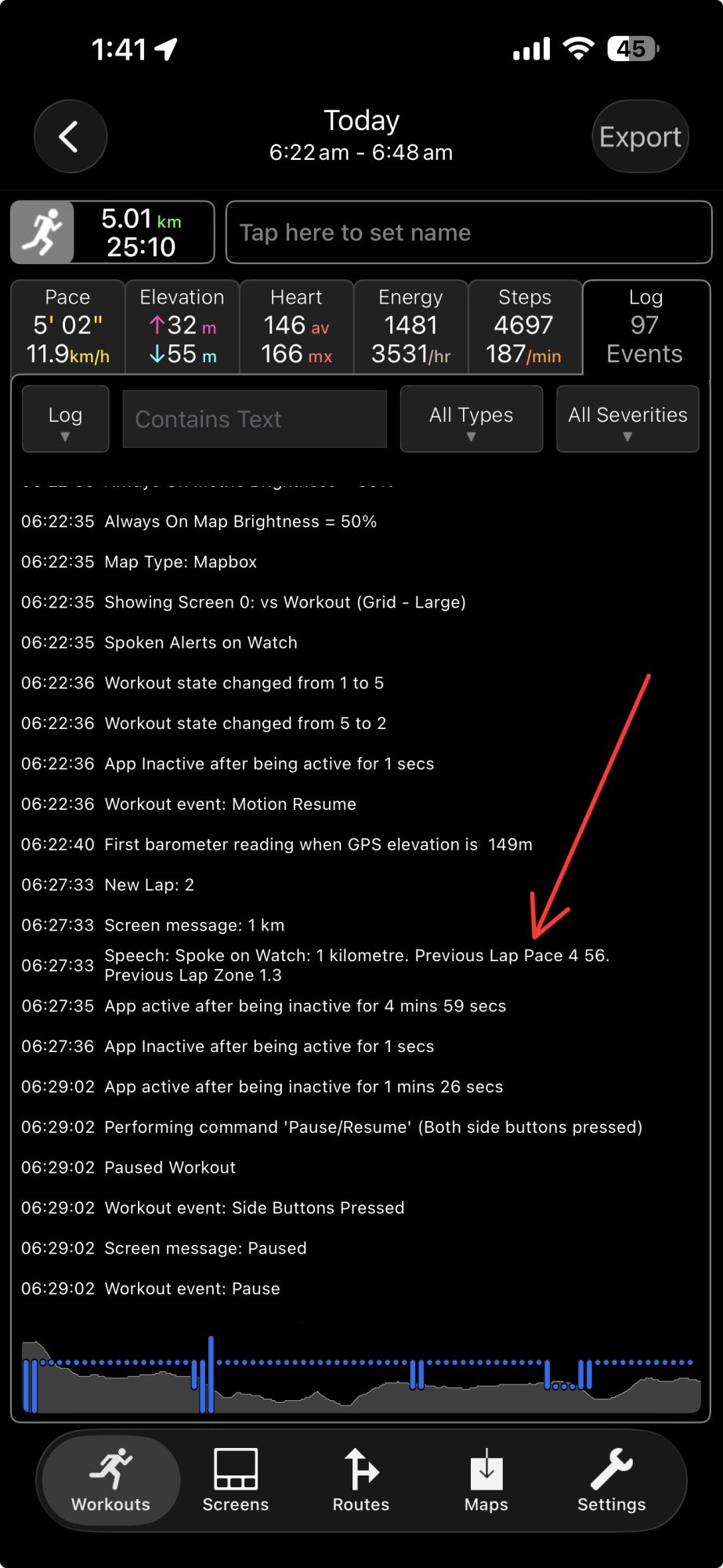

Nothing has changed in the voice alerts code for several years. The interaction with other audio apps has always been flaky for some people (especially Spotify users) but it does seem to have been reported more often and for more other apps since watchOS 26.
I am planning to create a beta with a couple of possible workarounds so if anyone is having problems and is interested in trying a beta with possible fixes then please email me at info@workoutdoors.net. I won't release this beta to all the beta testers, just to people who are experiencing voice issues.
It is also worth making sure that watchOS is up to date because one person who was having voice issues with watchOS 26 reported that they were fixed with watchOS 26.0.2.
However I am sure there are still long term voice issues, so I have now created that beta with some possible workarounds, including an optional one that is quite extreme. This beta also logs more information to help diagnose the problem if the workarounds don't work.
So if anyone is still experiencing voice problems then please email info@workoutdoors.net and I will add you to that beta.

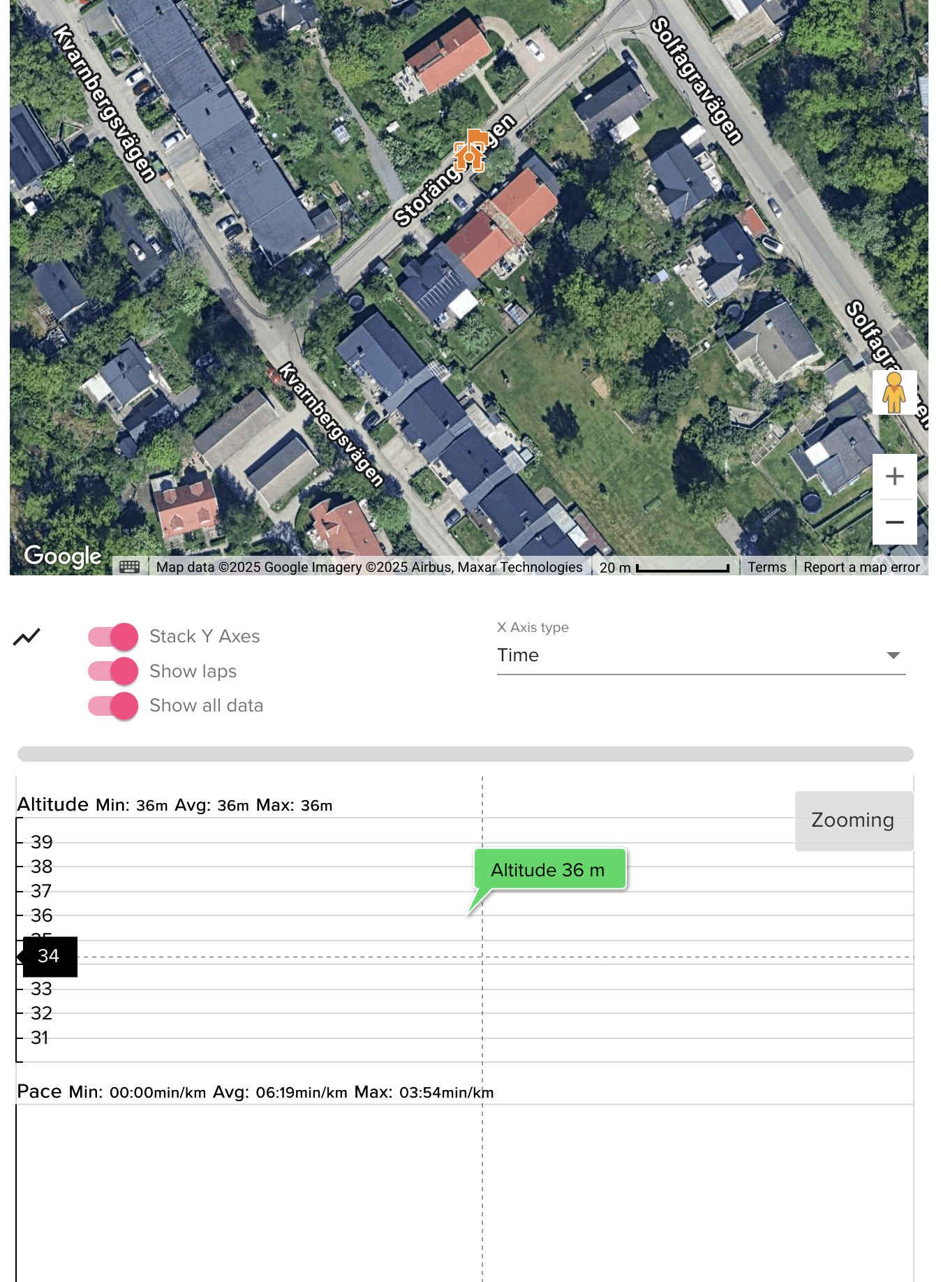

Okay, I'll take an hour or two to try to find which failure makes Quantified Self unable to load the file fully.
Code:
Session Message total_timer_time is Equal to the Sum of Lap Messages total_timer_time Values - Level: REQUIRED Status: FAILED
    Session message total_timer_time does not equal the sum of Lap messages total_timer_time values.
On an activity recording without laps, that's the only FAILED test case reported by Garmin's FitTestTool.jar
From some error in the WOD FIT formats, Quantified Self shows the beginning and the end as a single point, and none of the graphs.
When there are more laps like in the activity uploaded above, there are more issues as timer totals don't add up to what's stored in the session.
Fixing the error that makes Quantified Self might be a trivial change, let's see.
  • aw7.fit.zip
@cfc okay so I tested a few things and my conclusion is that the issue is with Quantified Self and its file parsing library, both of which are unmaintained for several years.
By converting the WOD's FIT to CSV and back to FIT, I was able to correct the issues reported by Garmin's validator, but Quantified Self still failed to display the fully compliant WOD FIT file correctly.
The errors in WOD's FIT are minor by the way: there's an inconsistency for elapsed & timer times between Lap(s) and Session. One is rounded and one is not. The error comes from the fact they're supposed to be the same numbers, either between Lap and Session if there's only one lap, or all Laps added and Session if there are multiple laps.
Same problem with the AWU1. Only voice control when I'm wearing my iPhone. The Apple Workout app has the same problem :) Since iOS 26. I tried resetting the AWU1 to factory settings. Nothing helped.
I also always had problems with the AWU1 recording heart rate correctly. (The Apple Workout app worked fine.)
I bought an AWU3. Everything works fine. Problem solved.
