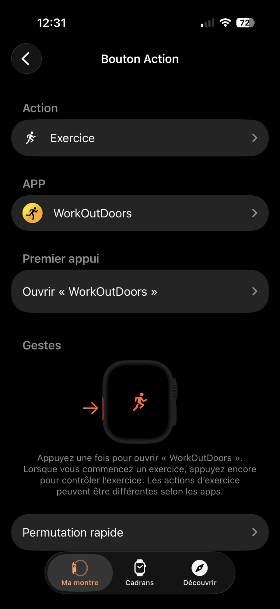

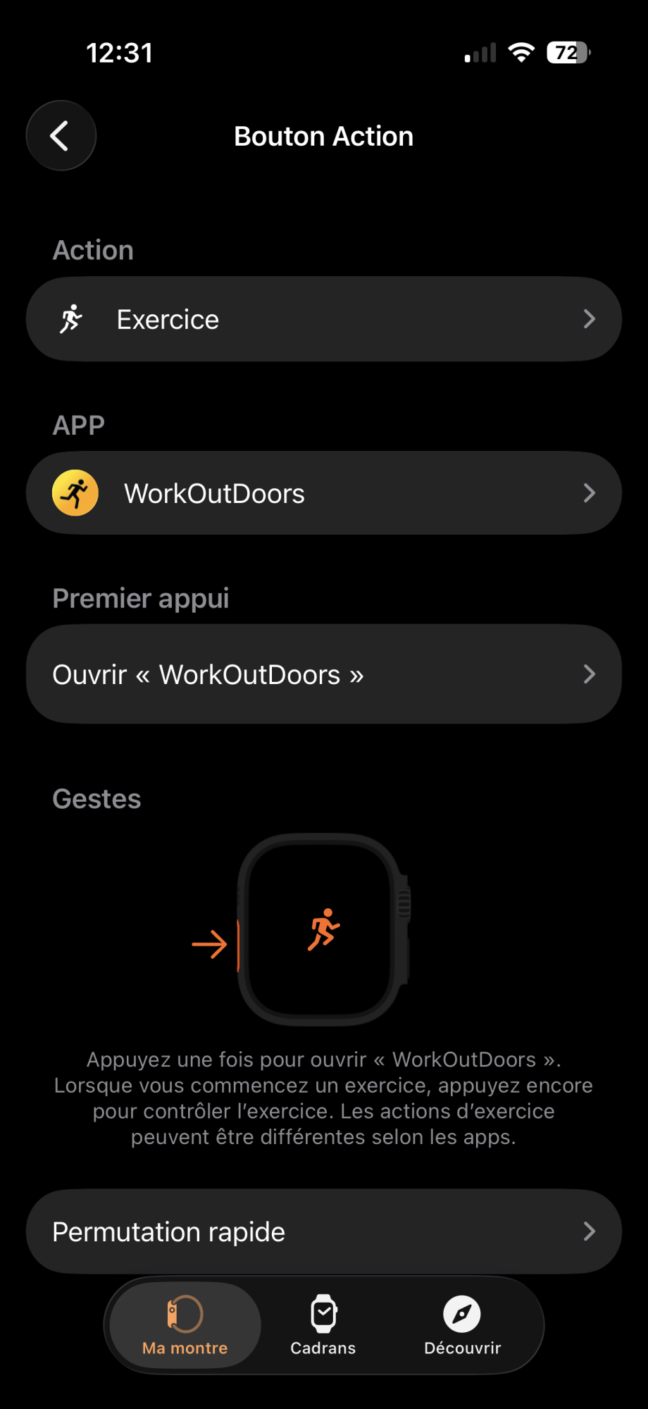

Hello, since the iOS update, my action button no longer works to start a new running interval. I have an Apple Watch Ultra 1. I've restarted both the watch and the iPhone but without success. Are others experiencing the same problem? Only an orange color appears and disappears...
No solutions ? The action button doesn’t work for all options …

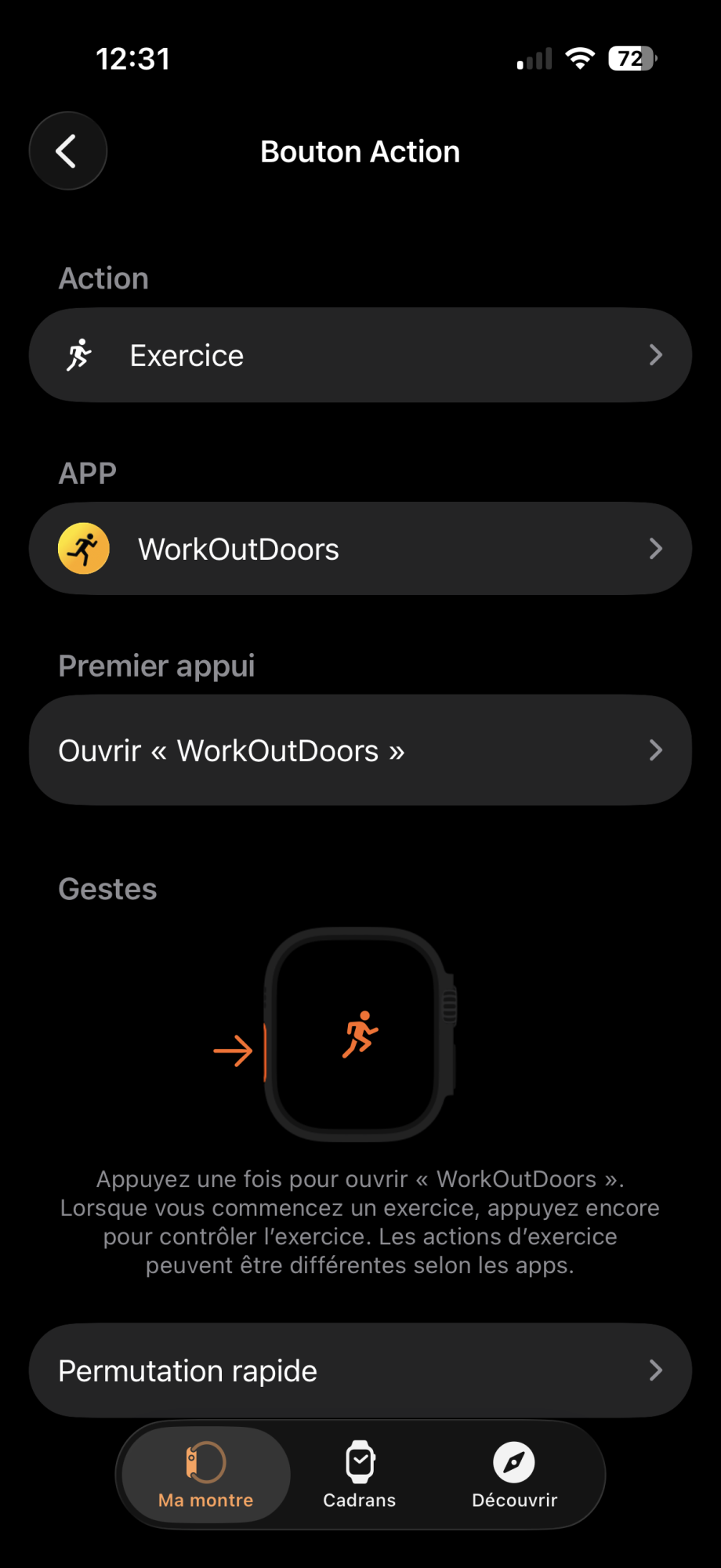

Have you configured watchOS to start WorkOutDoors for the action button? Sometimes it seems to be necessary in order for the app to receive notification of it being pressed during a workout and sometimes not.
Hi Ian, thanks for the quick answer. Yes it is configured.

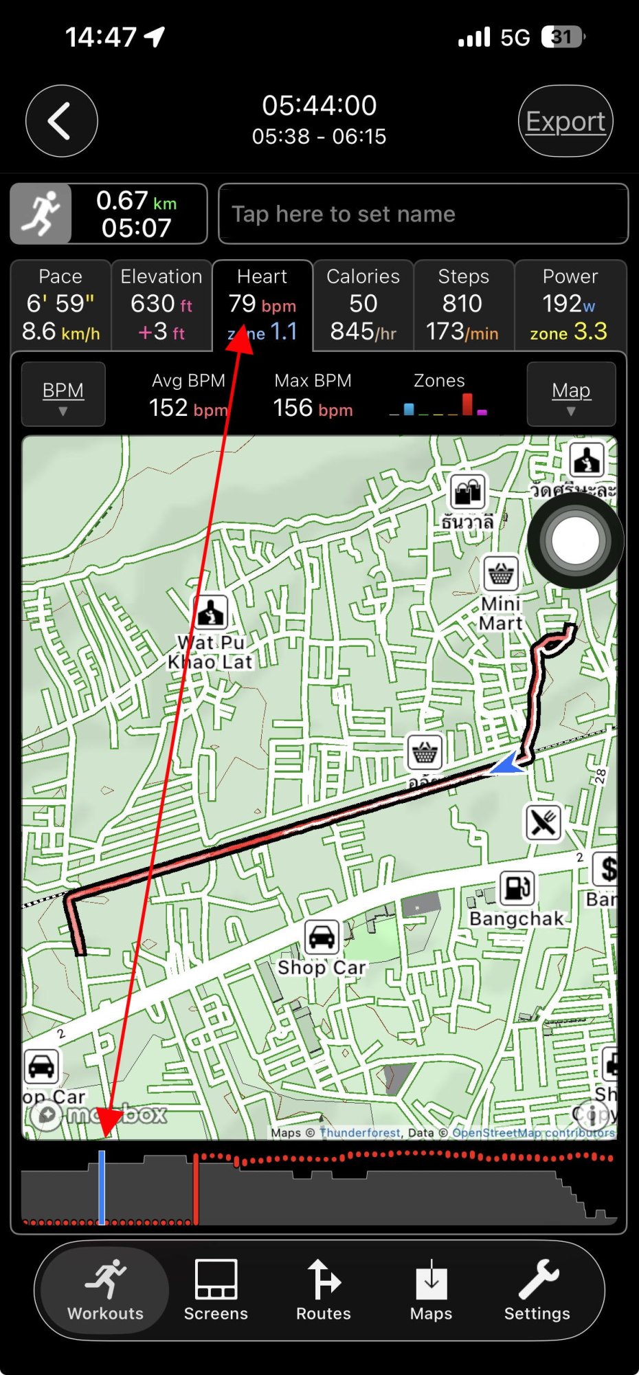

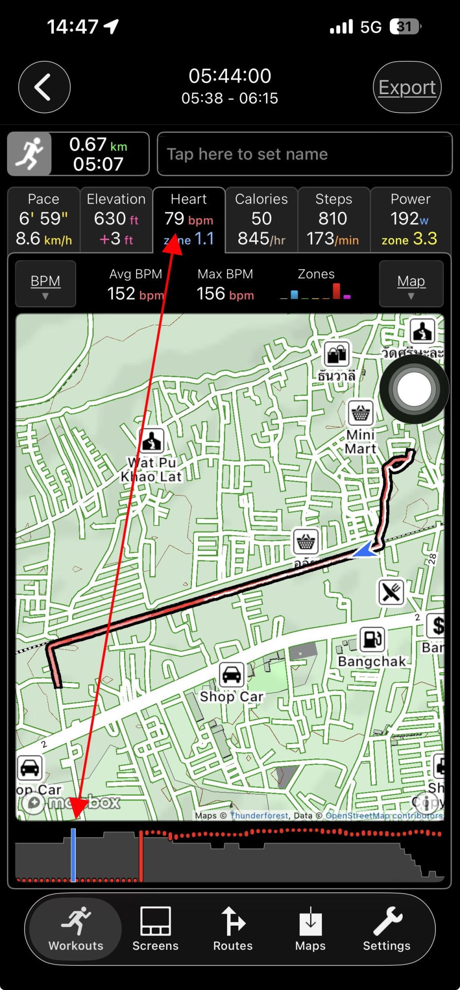

Strange Heart Rate Issue​
This on an Ultra 1 OS 26.1 WOD 6.2.5​
Low Power Mode is enabled for workouts, but Fewer GPS and Heart Rate Readings is not.
Note that I think this is a Watch problem and not a problem of WOD.
This is how I start all workouts:
  • Select the workout type
  • Open the workout on the START screen
  • Wait for a heart rate measurement to appear in the small space at the top
  • Start the workout

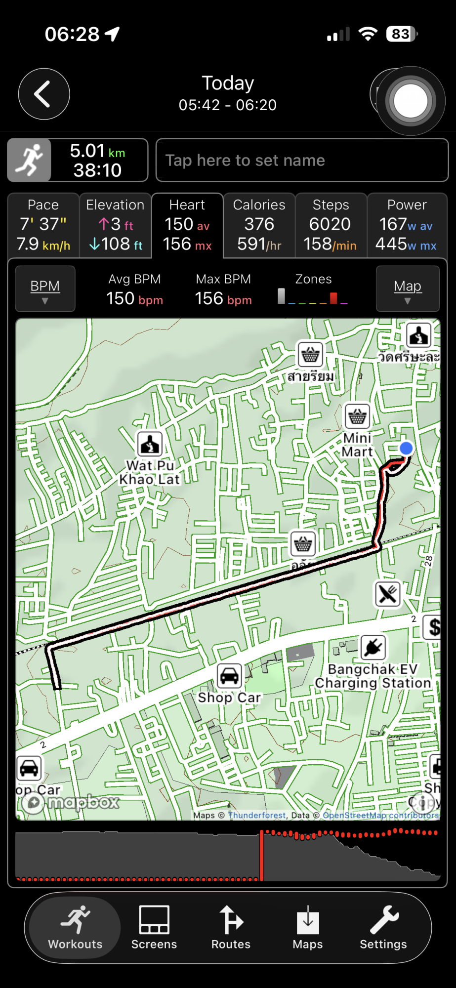

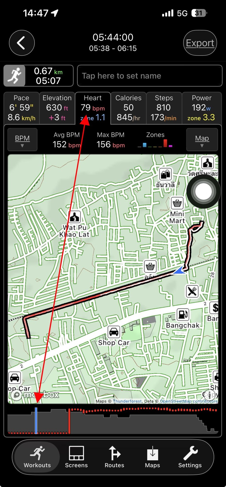

I just noticed that the heart rate shown in the small window is bonkers. My normal resting heart in the morning is about 47-55 bpm. But lately the bpm shown on the START screen is in the high 70s. Yesterday it was 79 which I rarely reach unless I'm really active. Anyway, I ignored it and started running. When I later looked at the workout stats I was surprised to see that the 79 bpm continued for the first ten minutes and then suddenly jumped up to a more normal 150+.
FWIW, I'm 76 years old and a 5K workout is about all I can manage these days.
I've attached a screenshot. Any ideas as to what's going on here?
Anyone else seeing this or, as usual, is it just me?

The heart rate not updating is a common issue with the sensor, especially if it is cold. It is getting better each year, so I think the hardware and/or software are improving but it is still a problem for many people.
Apple have some hints on how to help here: https://support.apple.com/en-us/HT207941#heartrate. I have also heard that wearing the watch on the other wrist can help for a few people, maybe because their blood vessels are closer to the surface on that other wrist.
However even these hints don't help for some people and then I recommend using an external heart rate monitor, which work in a very different way. They detect electrical impulses whereas the watch sensor beams a light into your wrist and detects heart beats from the reflections. However the effectiveness of this varies between people (tattoos, deeper blood vessels etc) and is also greatly affected by cold and also by motion. Some people only use an external monitor in the colder months and can get by in the warmer months, but a few people need it all year round.
I am glad that you realise that it's a watchOS issue. I sometimes get people who are convinced it is an issue with the app. I had one just now and I have learnt over the years that it's easier just to tell them how to get a refund for the app rather than waste time trying to convince them that it is out of the app's control.

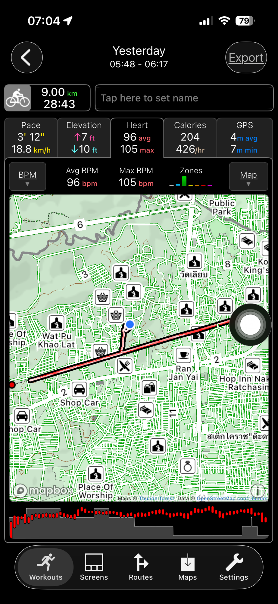

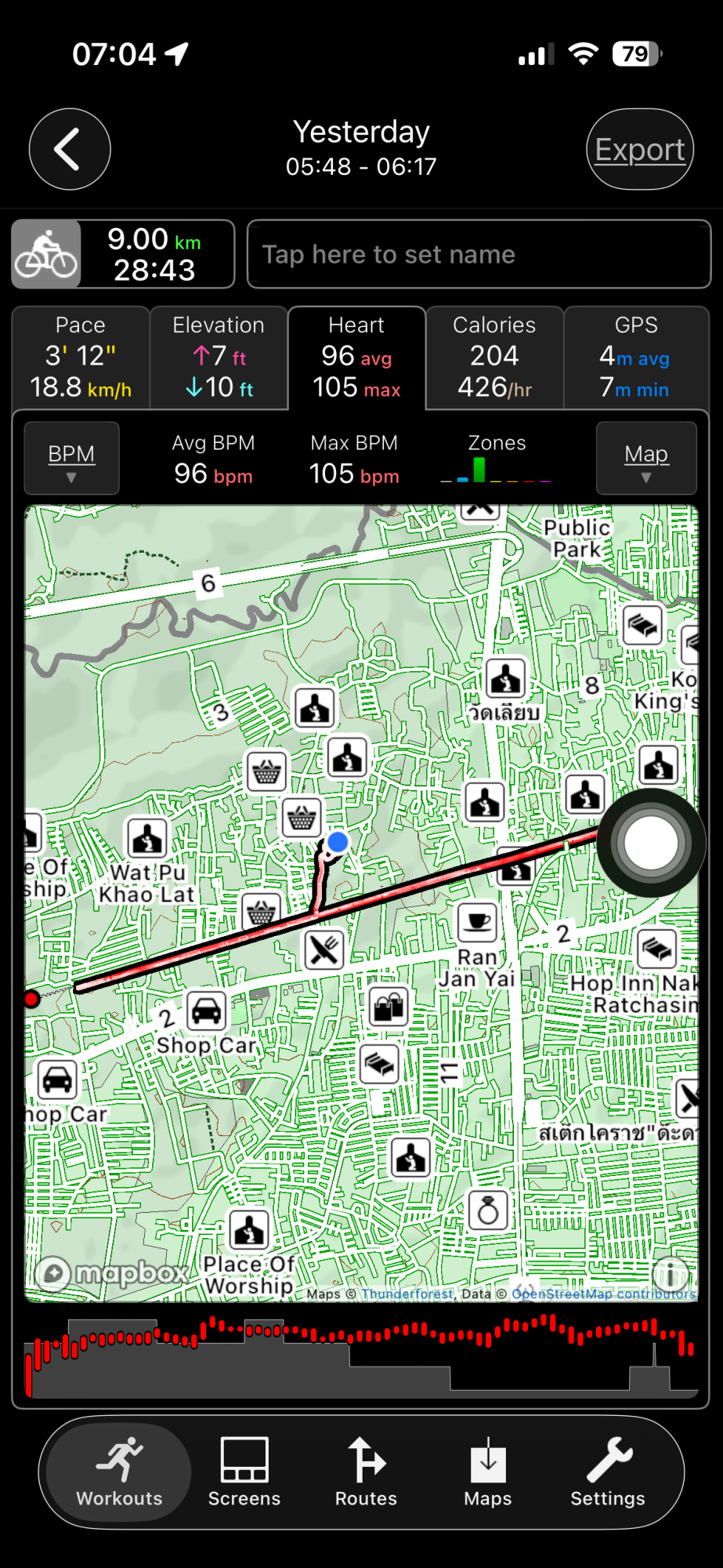

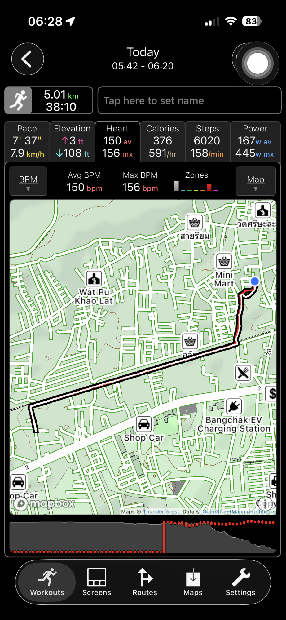

The weird thing is that it is only when running that the heart rate doesn't update. It updates normally when I do a cycling workout. When I ran this morning it was 24ºC (76ºF). Is that cold enough to cause a problem?
Hi, I haven't been here for a while, but I'm still with Apple Watch. Firstly, @cfc , please absolutely leave Stryd alone. I'm running the first version, currently inductively charged, and surprisingly, it has all the GTC-type indicators correct. But that's just this model. Secondly, if there's any beta version currently available, please add me. Thirdly, I'll write a bit more over the weekend, but thanks again for your work.
It is much harder for the sensor to get a lock when running than when cycling, because the latter is much smoother. When running the footsteps make it harder to pick up the heart beats.
This sometimes results in a phenomenon called 'cadence lock' where the sensor locks onto your footsteps and reads very high until it has locked onto the heart beats. That isn't what you are seeing (it just can't get a lock in your case) but cadence lock has been much more common this year than in the past, so I suspect Apple have changed something.
