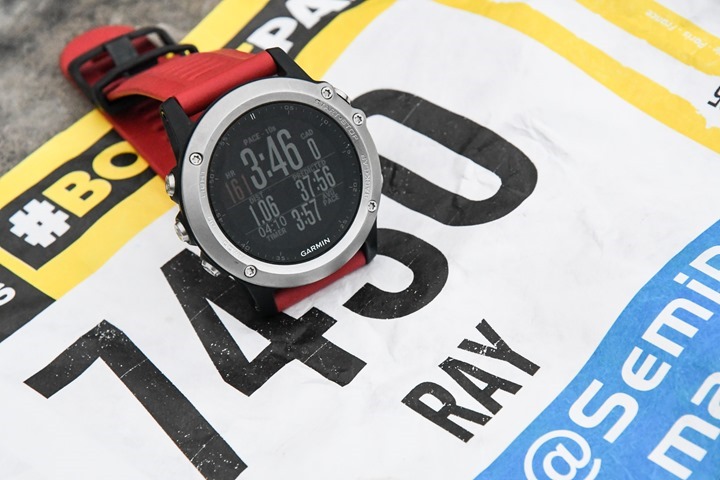

On Garmin there is an app that can do what rbart wants. It is great and I think I shared the link before, so nevermind...

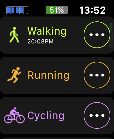

I have received my replacement watch and set up this awesome app again. That was a few tough days without WorkOutDoors. After using it for a few days again, there is still a bit of a delay until values update on app launch, but other than that it works great.
One thing I noticed however. I have the time set to 24hr in the app, and on my watch. What I haven't noticed before is that it says 20:08PM for my latest walk. That PM is a bit redundant. Is this a bug or is it intended?

On my watch I see a 12 hour clock with the AM/PM symbol, but I think it is dependent on the watch settings so I have changed it in the code to force a 12 hour clock and AM/PM symbol. Hopefully that will fix it. Thanks for spotting that.

Does the mentioned forced 12 hour clock mean that I can't have 24hr time in the app anymore, or that the AM/PM will only be forced for the 12 hr clock?

In terms of the clock time, I have played around with it a bit and decided to just let watchOS format it. This means that it should respect the settings that you have configured for the watch.
